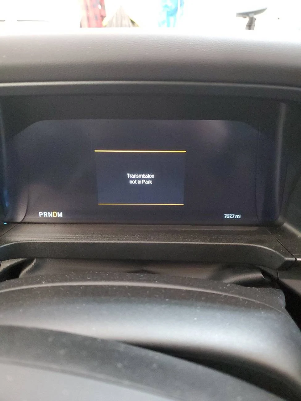

I just tried it on my 25 Lariat and this flashes on the display and the loud chime keeps sounding until you put it in park.
yep probably makes sense. Didn't 2025 lariat go from the short e-shifter to the tall mechanical one? The '24 lariat moves the shift knob from D to P before turning off the engine. But '25 shifter probably can't do that, gotta touch more buttons and levers I guess.
Yes manual tall shifter.
