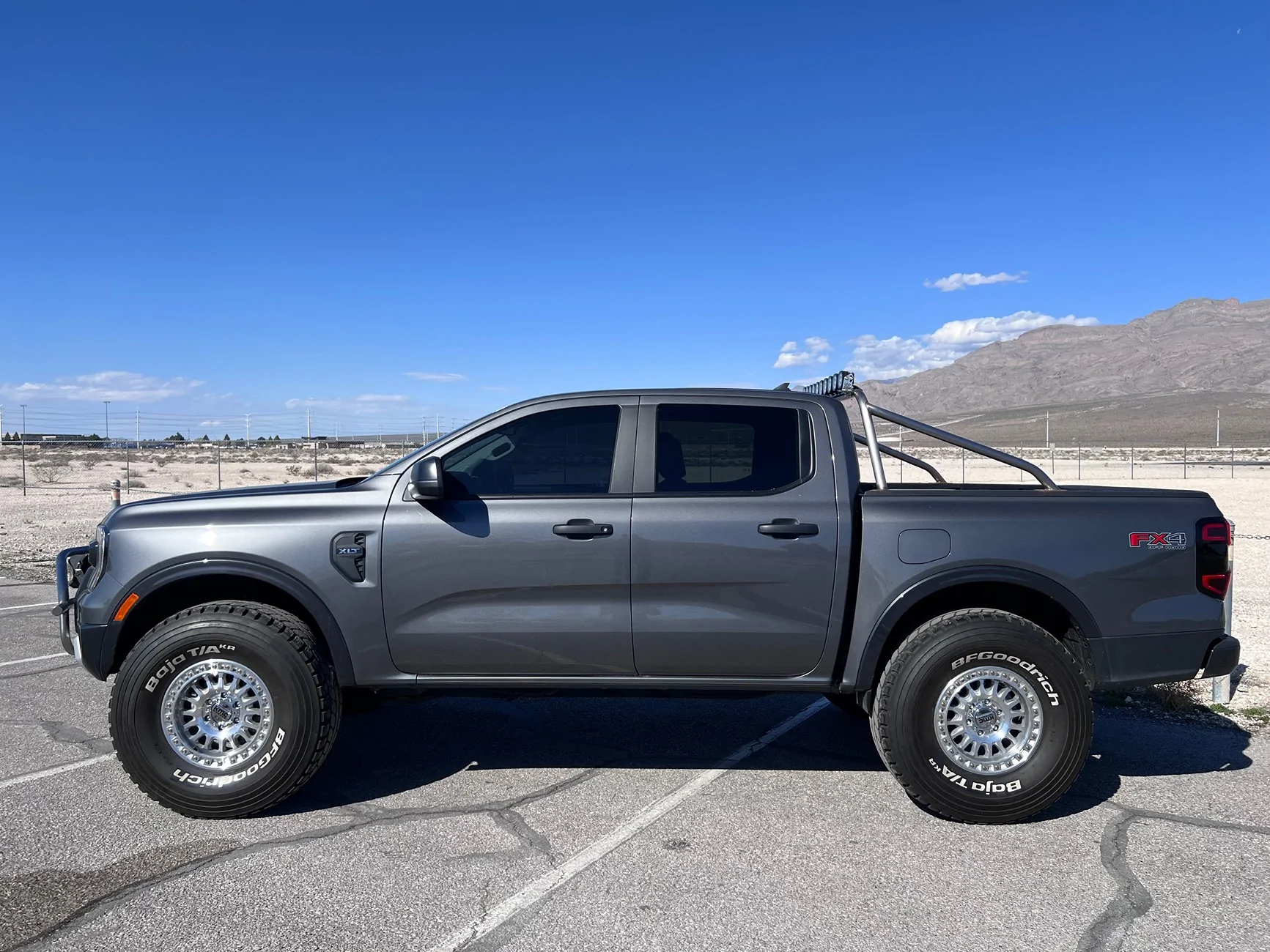

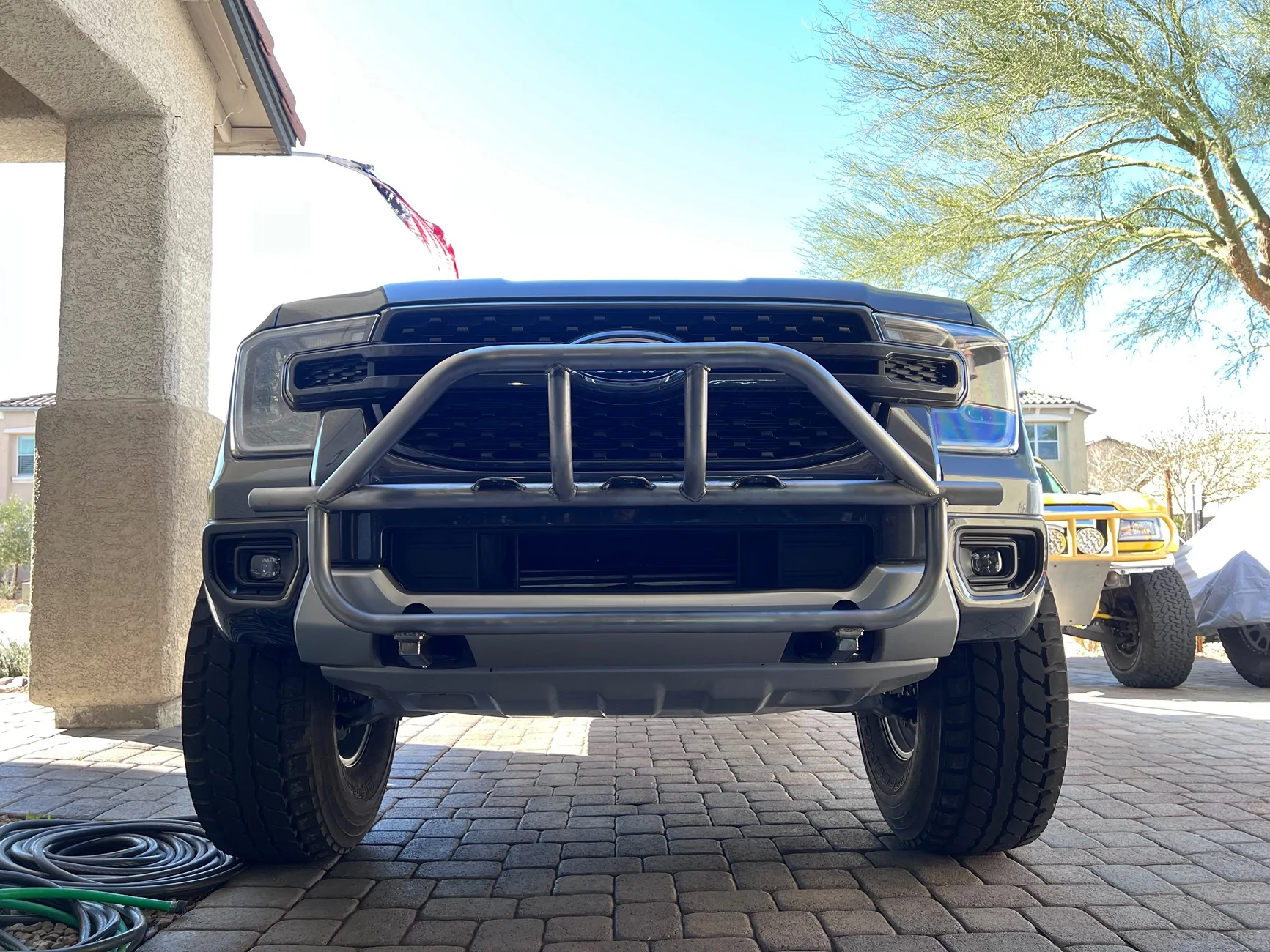

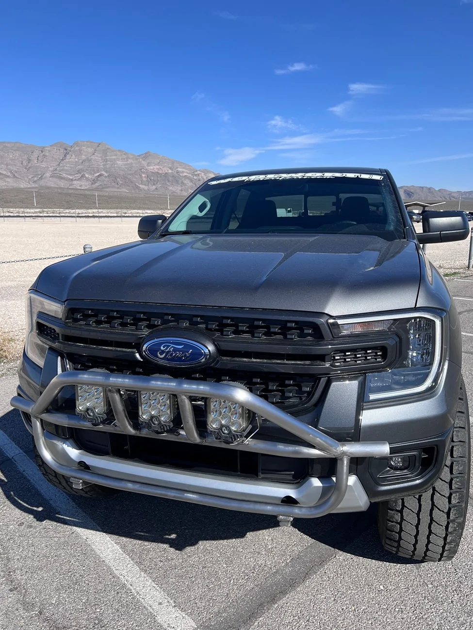

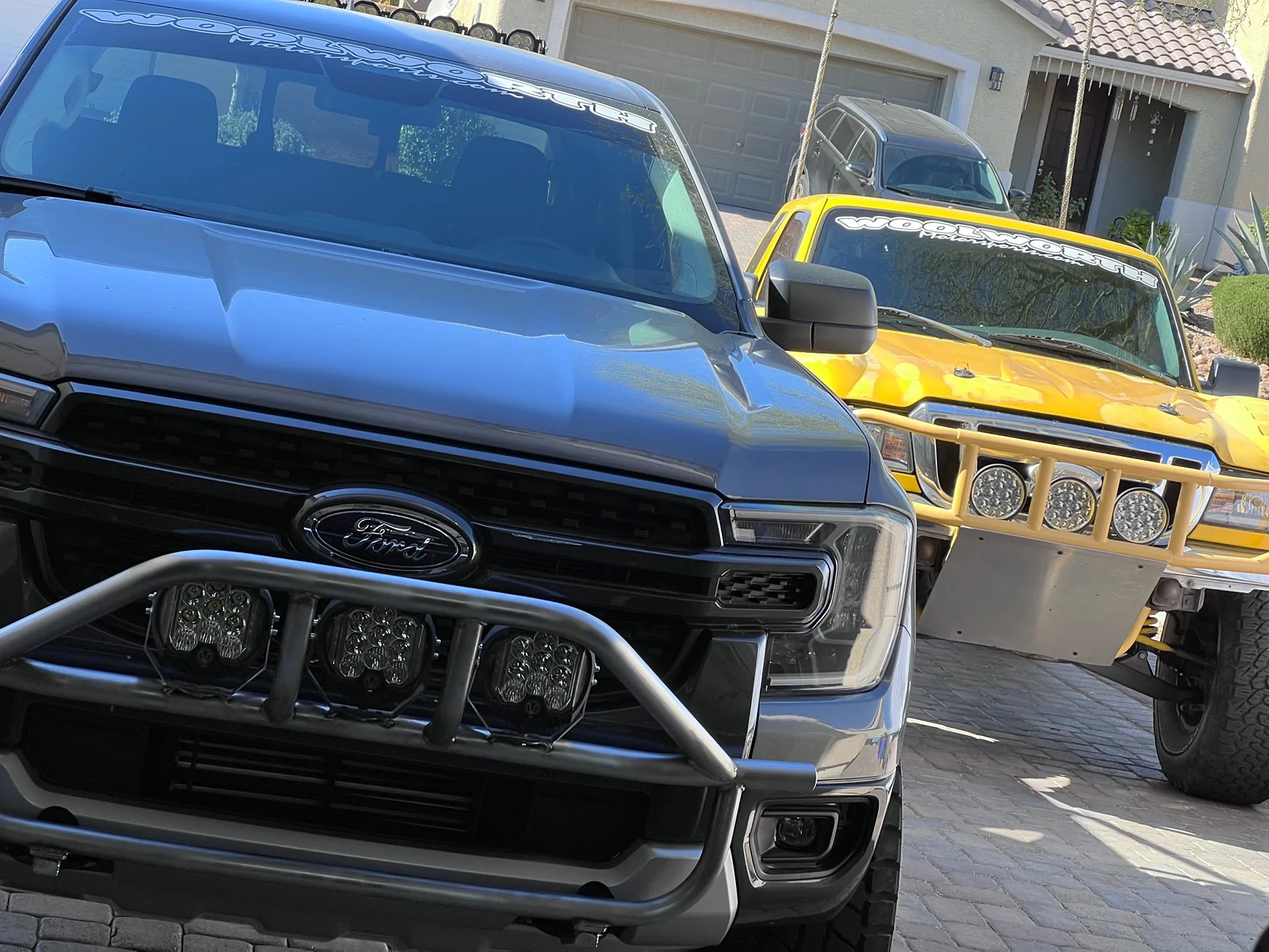

Minor lower front bumper plastic trimming. +25mm Kmc wheels. Bolt on front light bar with 7” Auxbeam lights. Bolt on rear sports bar with (10) 3” linkable light pods. Next on the chopping block is a rear bumper.

Looks awesome! Do you have a link to that front bull bar?

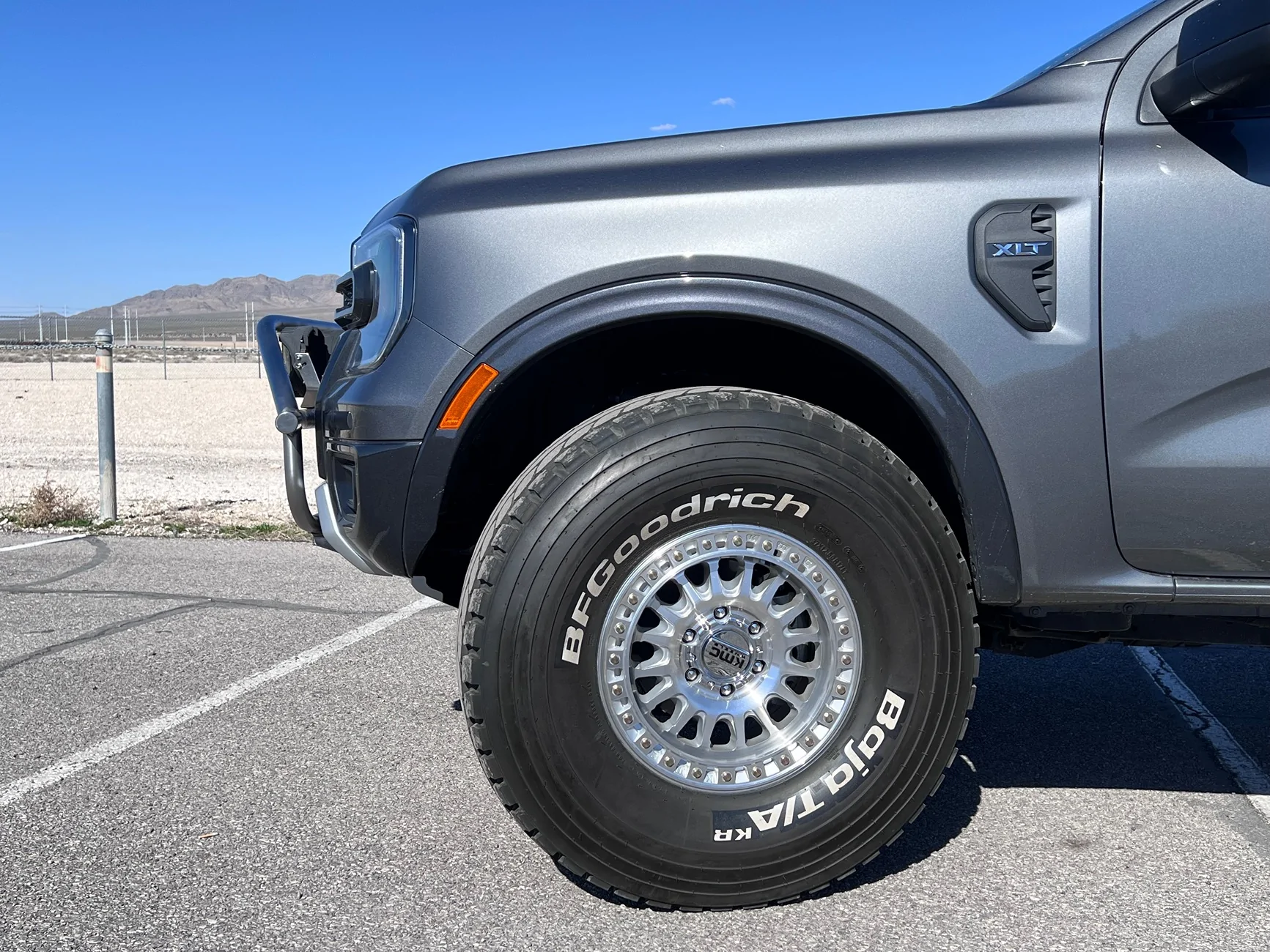

How is rubbing when turning front wheels? Would be very interesting to see a photo where tires are turned :)
Did you have to modify something behind front wheels?
I just removed the crash bars and the plastic honeycomb piece on lower firewall. A little bit of the bottom front bumper plastic. This is the only pic I have with the tire turned. I will get some better pics.

Looks pretty awesome. Did you have to change upper control arms with the 3” lift?
Are you looking at changing gear ratios to compensate for the 37” tires?
Has all the factory suspension componants. Just my 3” front spacer system. No need to change gear ratios with the ten speed transmission. I had 35’s on it first. Feels the same with the 37’s but with more ground clearance and better handling.
