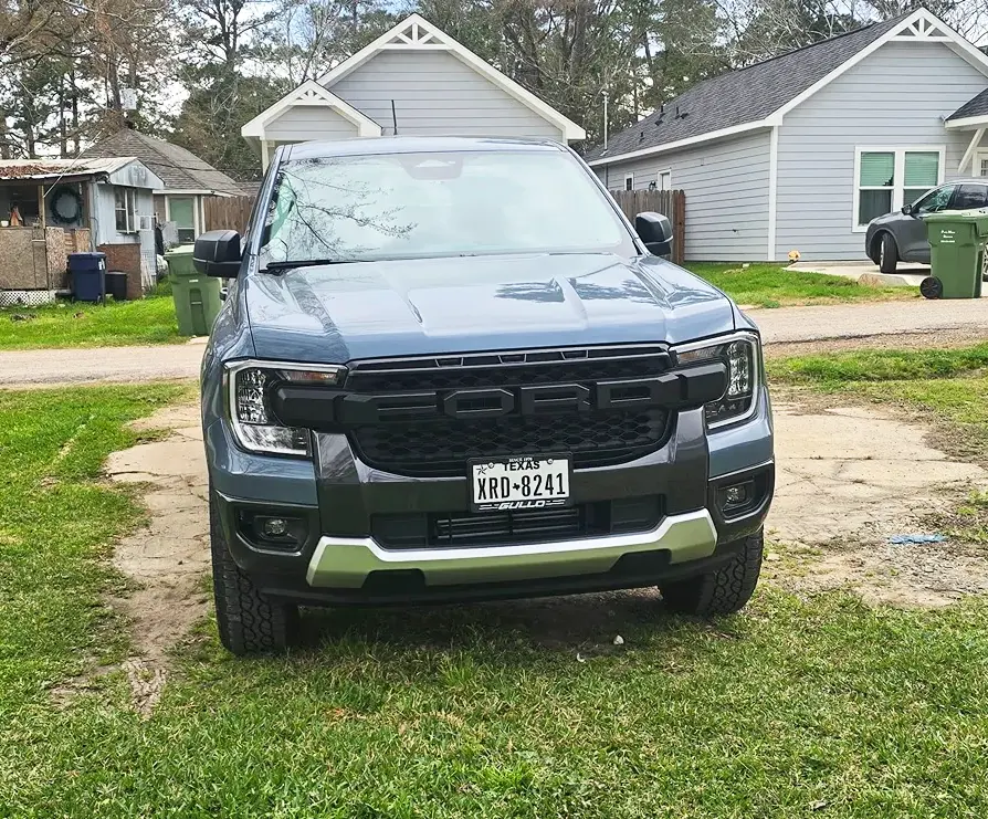

Ford Ranger Installed the Raptor style grille! 81799-55d0b12f85a7a93458d28d48d2c88327

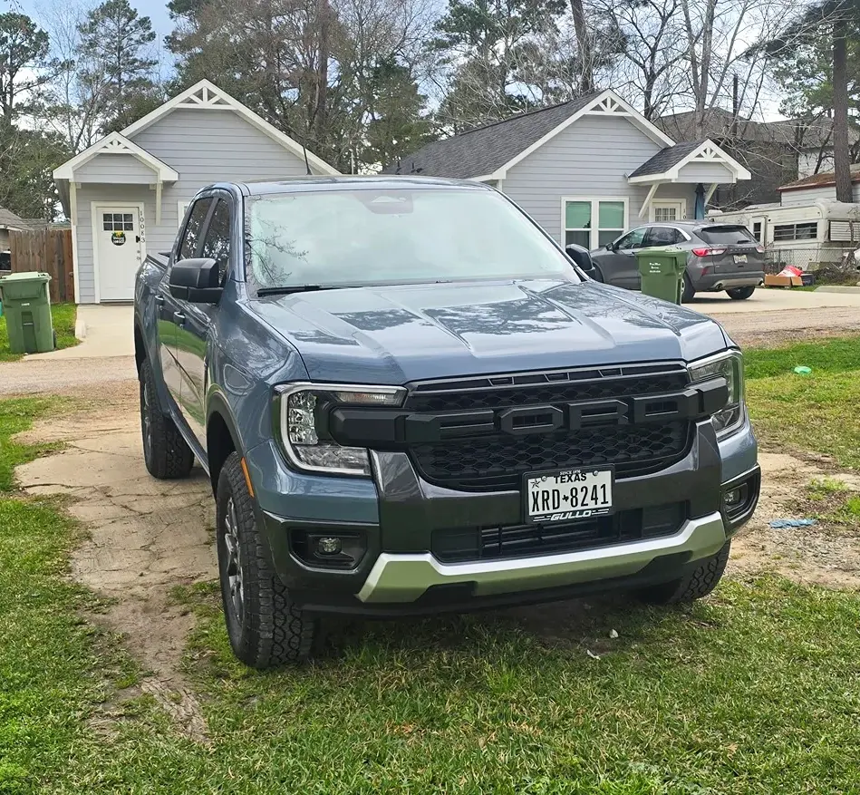

Ford Ranger Installed the Raptor style grille! 81797-2e1255465a6018ac0f6afe36c34c608c
Put it in last night while I was at work (diesel mechanic) and had some downtime.
I am really liking the look, I had thought about painting the FORD letters the same gloss black that is on a lot of the trim pieces on the truck, but I kind of like the contrast it has now.
Just waiting on the wiring harness from F150LEDs to connect the lights.

So was it 3 pieces????
And how badly did you damage the original grille?
And as a smart ass comment --- do you still have all your fingers?

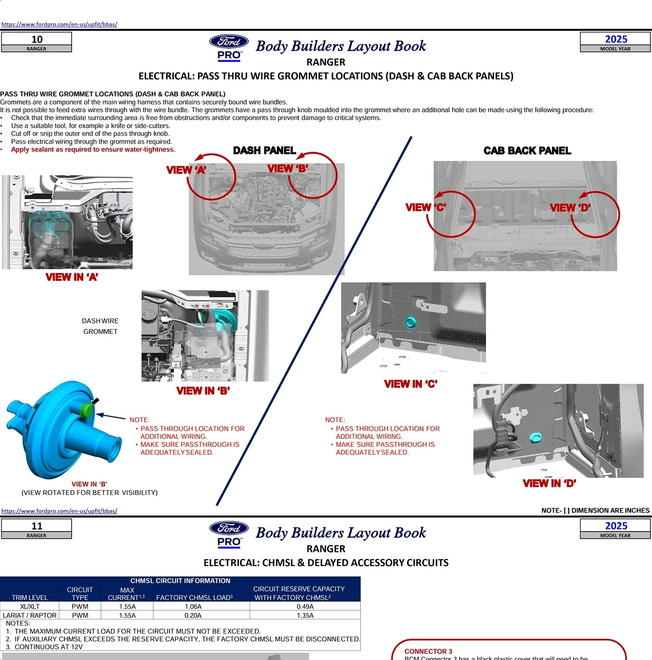

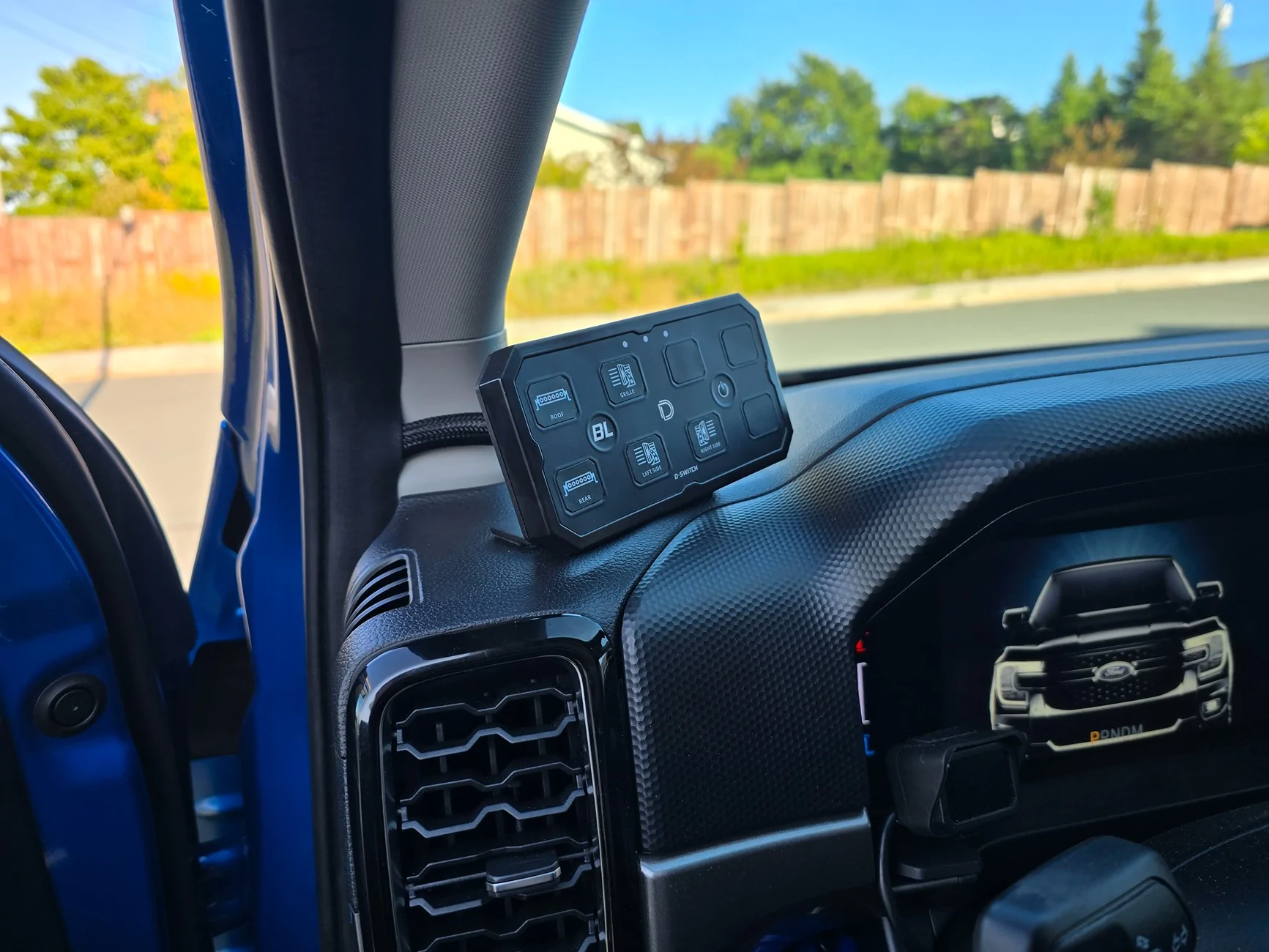

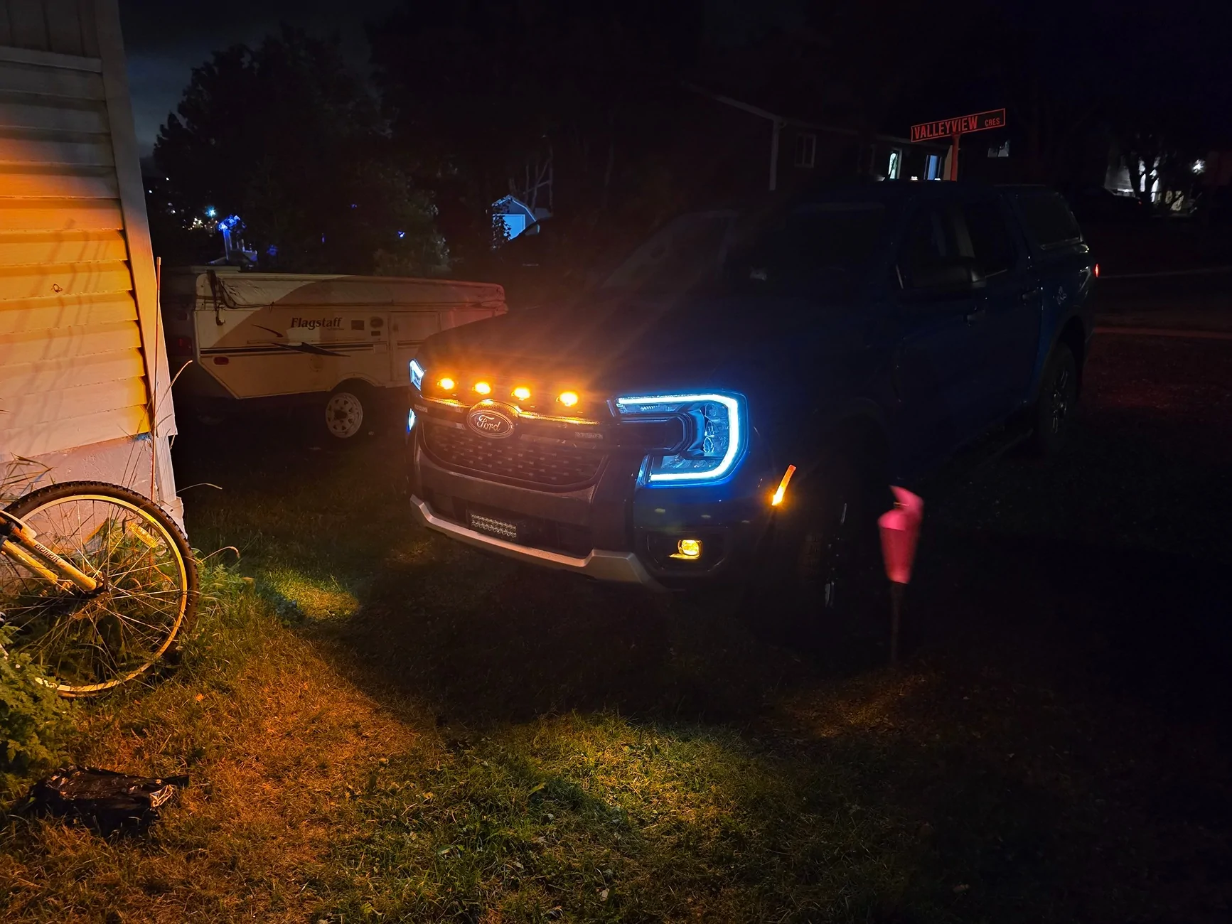

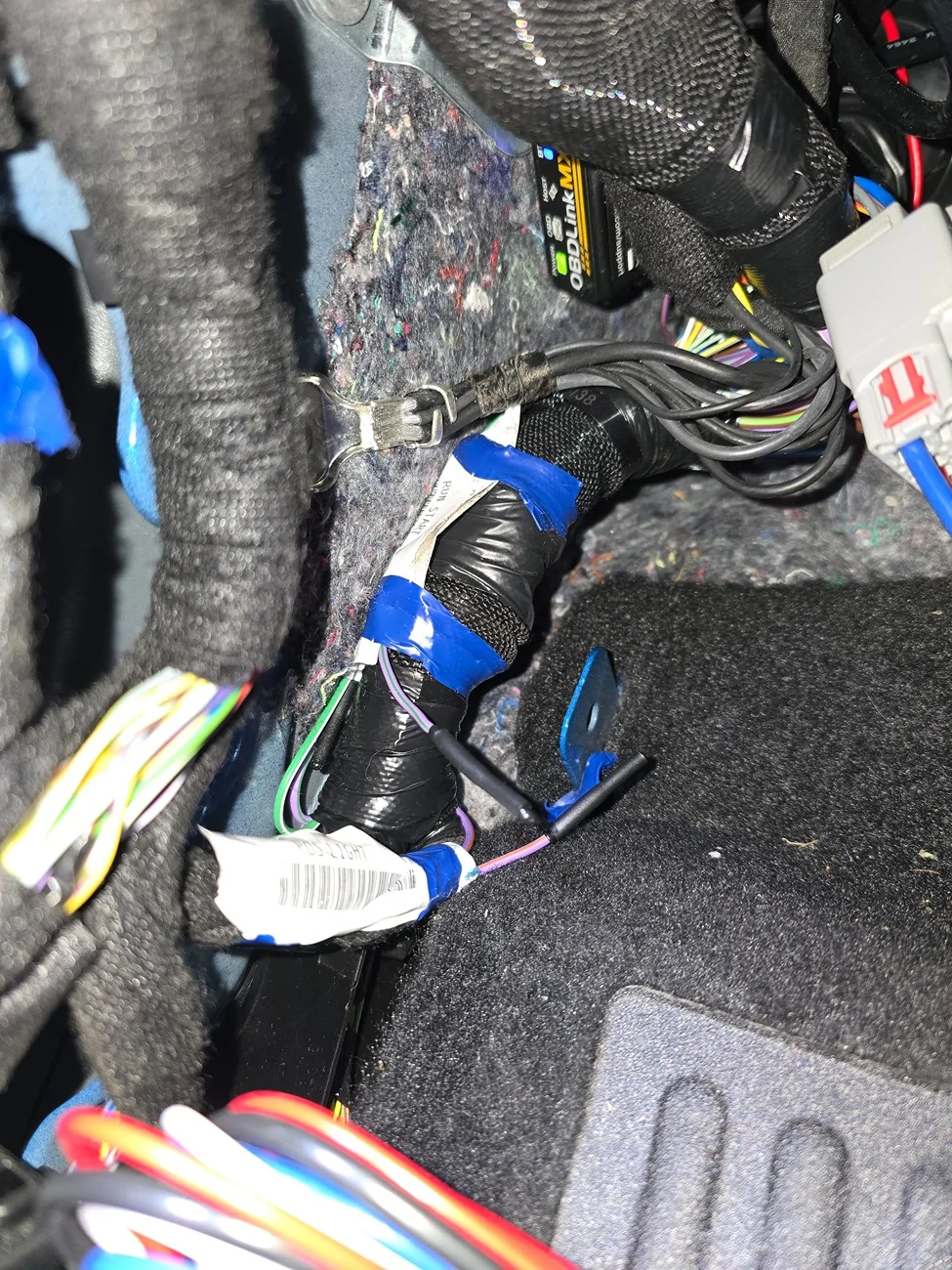

why buy a sepperate harness? ford provides 3 blunt cut wires under the bcm/trm behind the driver side kick panel, a ignition trigger, a marker light trigger, and a high beam trigger. run a wire out throught the use them to power htommet like they show, and use that the lights. they are powering my grill lights off the marker, and my Diode Dynamics D-Switch uses all 3. the ignition to turn on and off with the truck(besides being able to hit a bitton on keypad and use while truck is off) the high beam on 1 of the programable trigger wires to automatically turn on my light bar with my high beams. and the marker trigger to turn on night mode on the d switch(once I get my dd light bars, will tell the d-switch to turn on the back lighting on the bars/cubes) aswell and like I said turns on my grill lights, and the backlighting of my fog lights.

I was unaware of this! I already purchased the harness, however I will keep this information handy for future reference!
It was multiple pieces, the letters have to be put on (which is actually handy if you want to paint them), the lights have to be mounted in, and a few clips and trim pieces have to be attached, all of the hardware needed was included though.
The original grille is undamaged save for one of the bottom clips because for some reason my license plate bracket was riveted on and cannot be removed without removing the rivets, which I did not want to do.
Yes, I still have all my fingers, I'm a diesel mechanic so I have a bunch of tools already and am no stranger to doing stuff like this.
