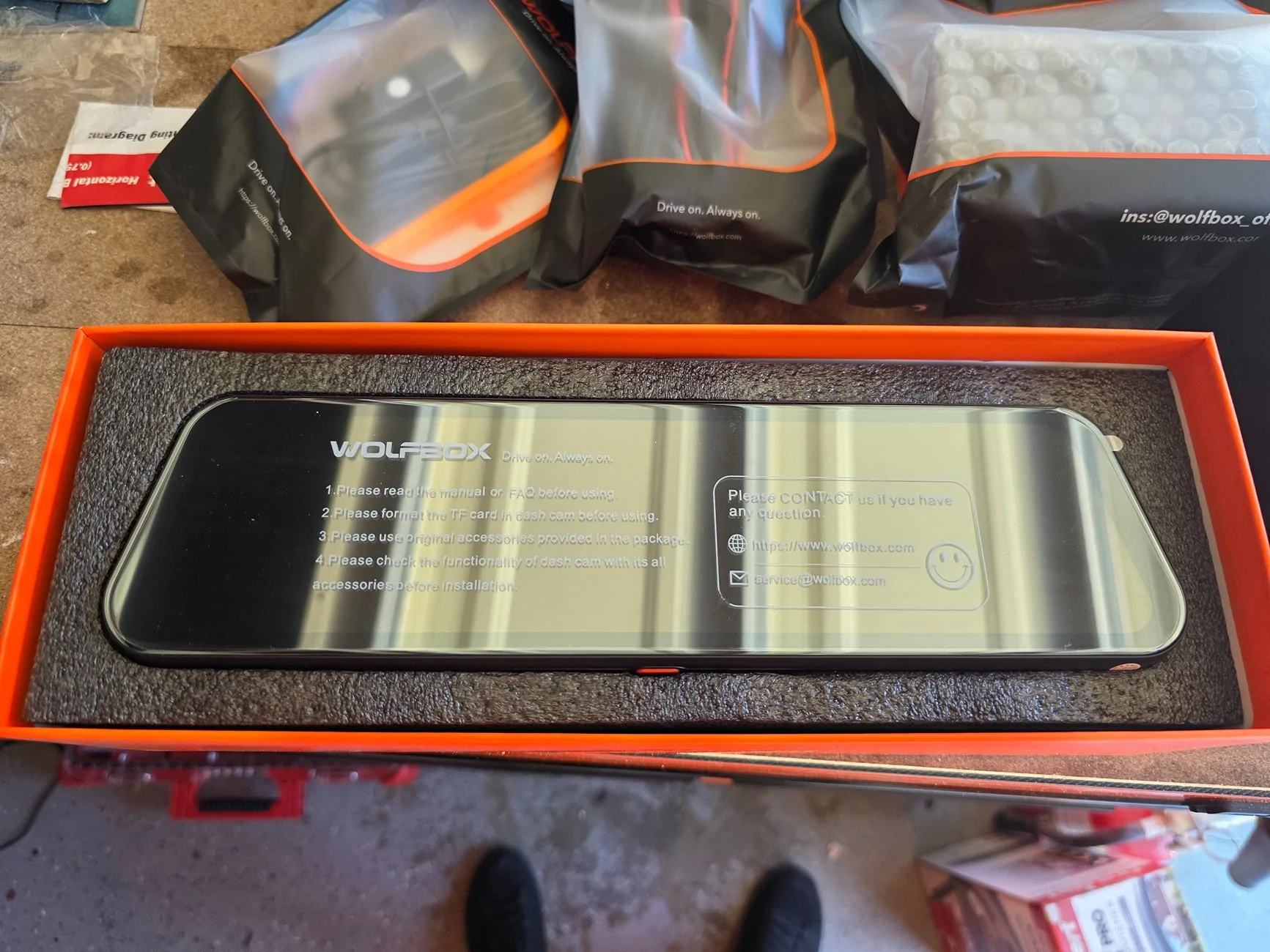

The Wolfbox came neatly packaged to prevent damage. Everything was individually packaged so it was easy to lay it all out and see what I needed to do.

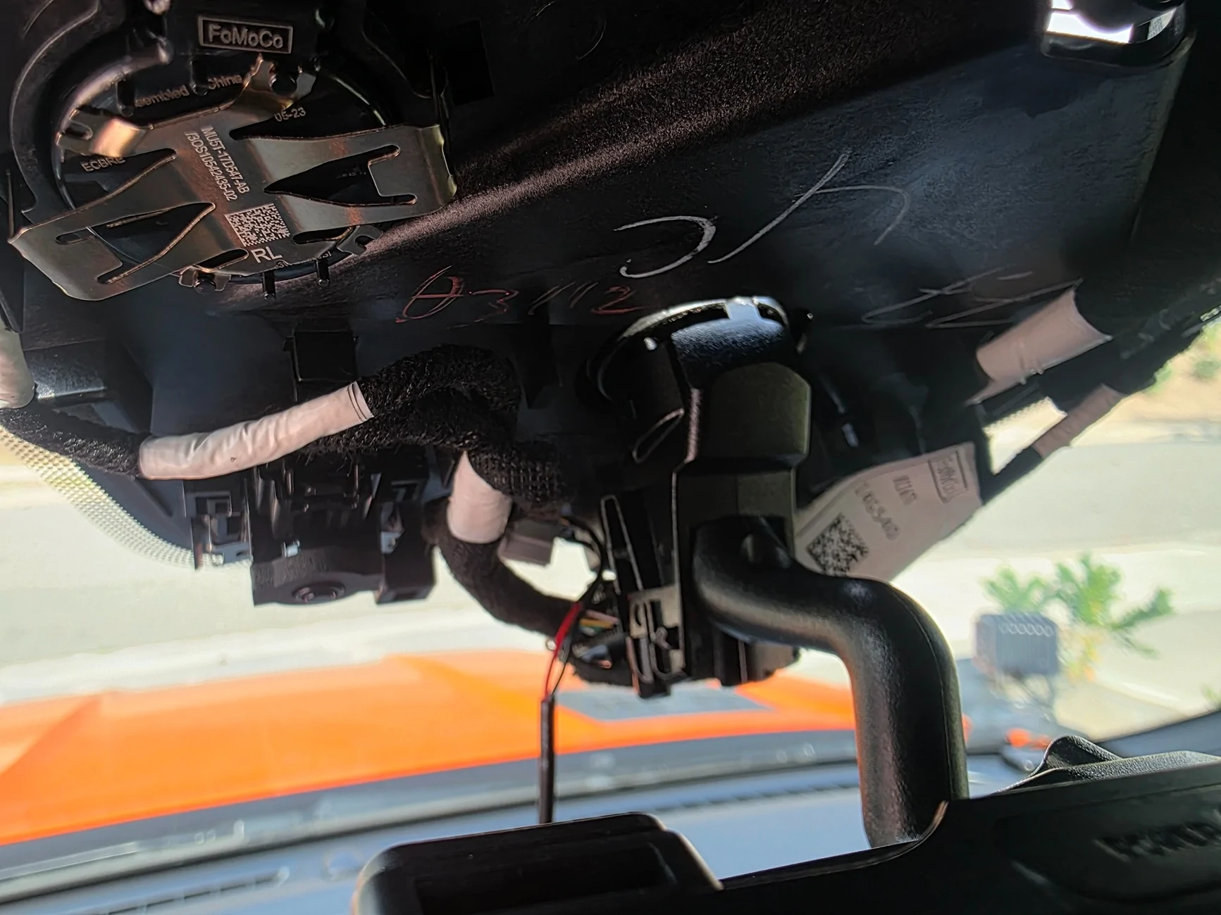

I started by remove the plastic casing behind the rear view mirror. It pulls right off without any tools.

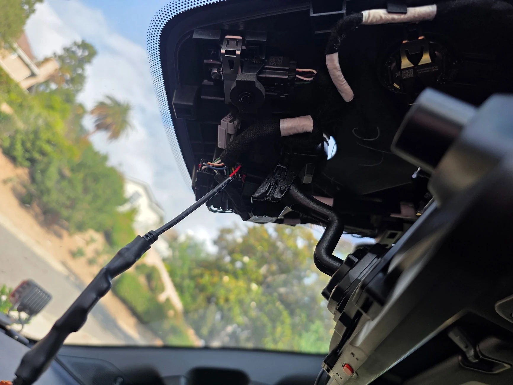

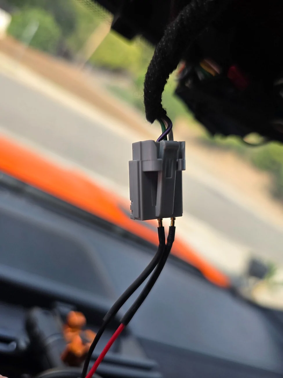

Since I planned on replacing the entire OEM mirror, I used an old mirror tap I had to plug in to the OEM 5 pin plug connected to the OEM Mirror.

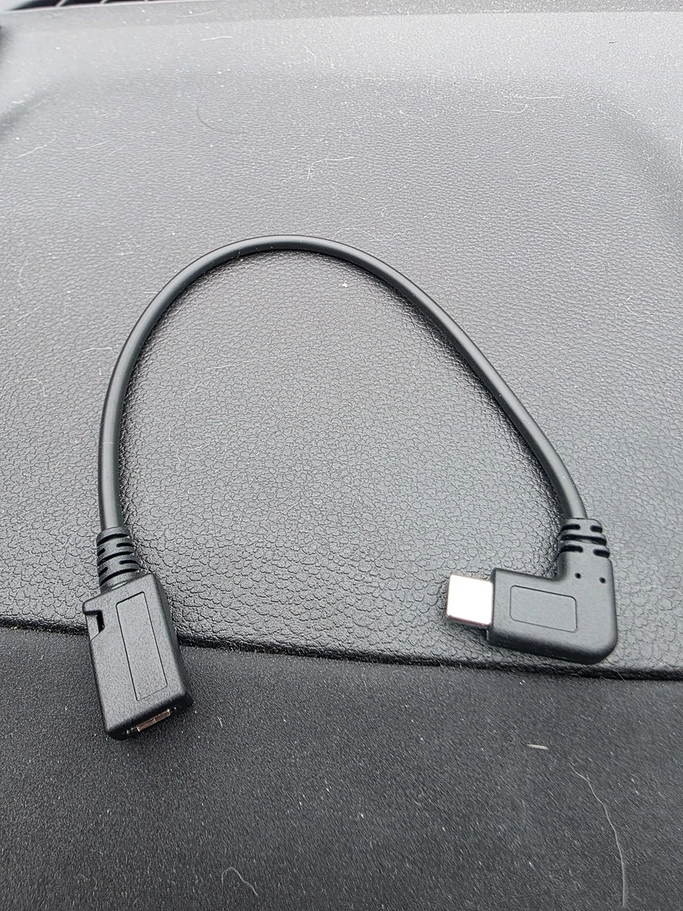

Unfortunately, My mirror tap is a Micro USB so I had to get an adapter.
If you're using a mirror tap, 12v power (red) will connect to the white wire, and ground (black) will connected to the black & purple wire.
If you're not replacing the OEM Mirror, you can still mirror tap these wires by inserting the pins from the same side as the source wires.

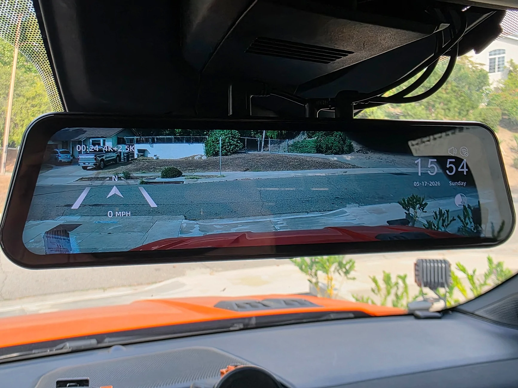

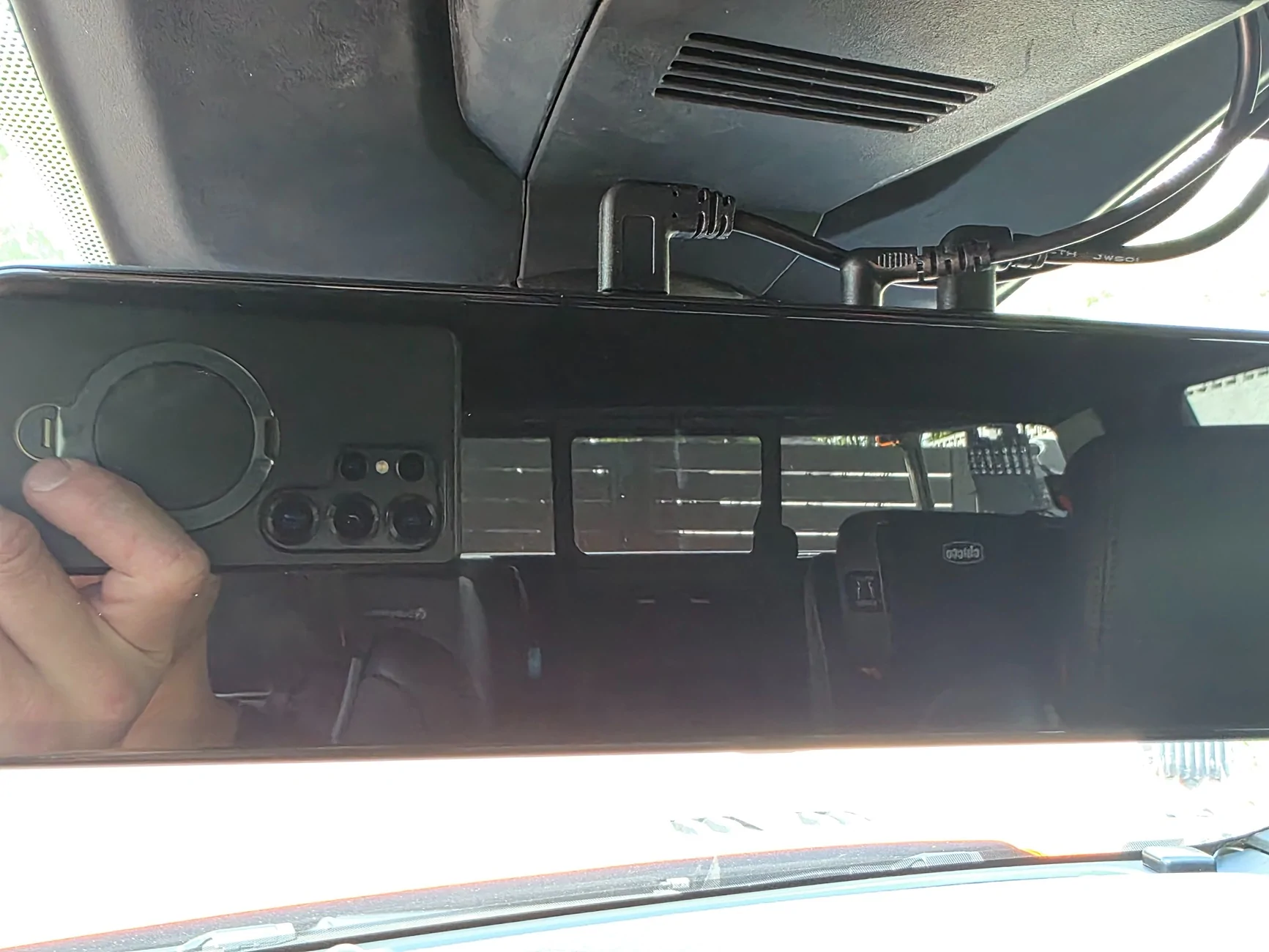

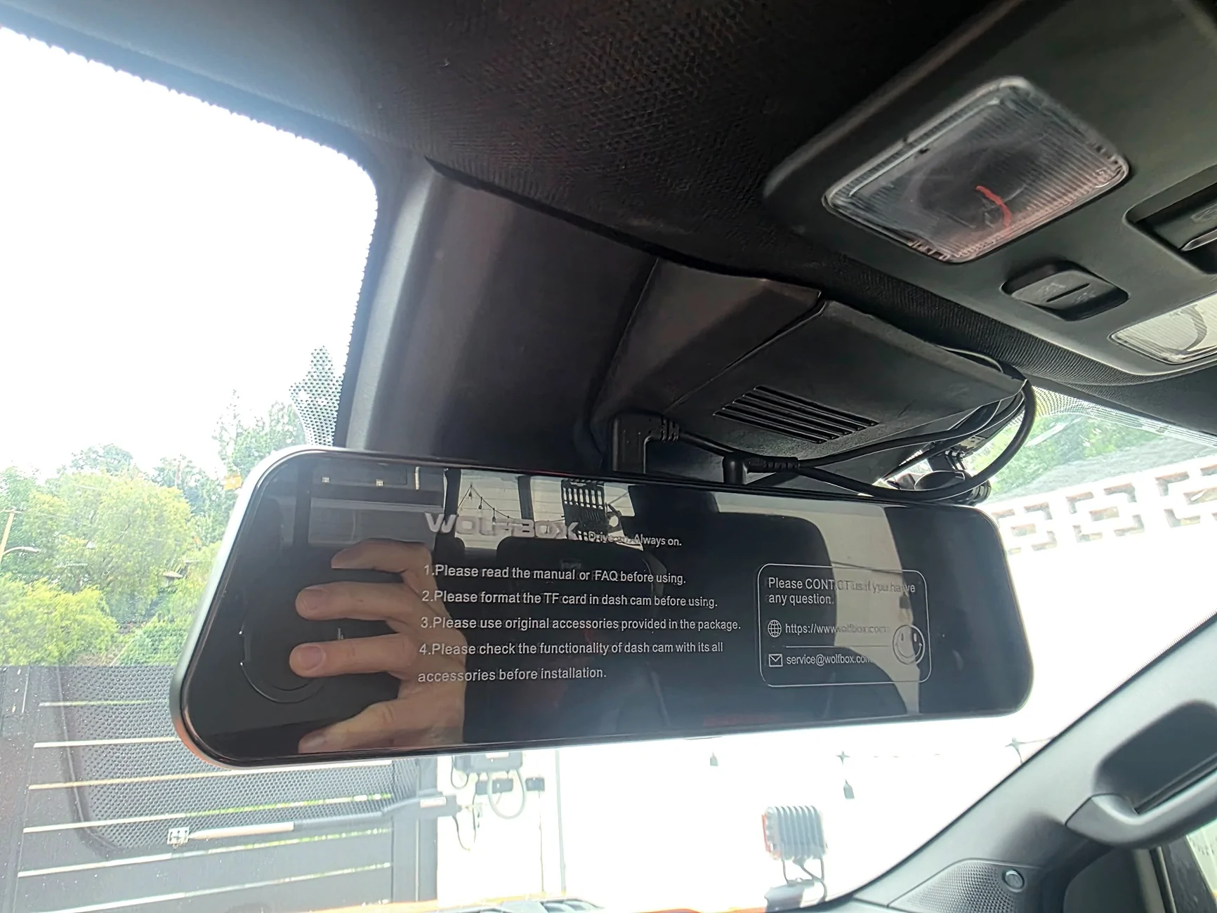

I used the provided rubber straps to install the Wolfbox right over the OEM mirror. It was a bit bulky for my liking but it is definitely easy to do.
Here is a side view.

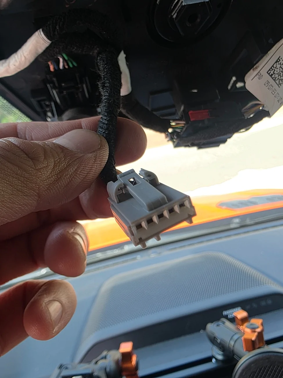

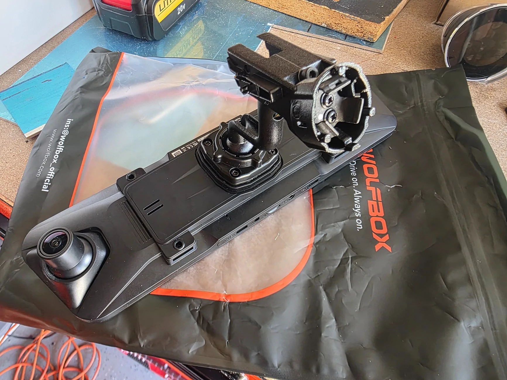

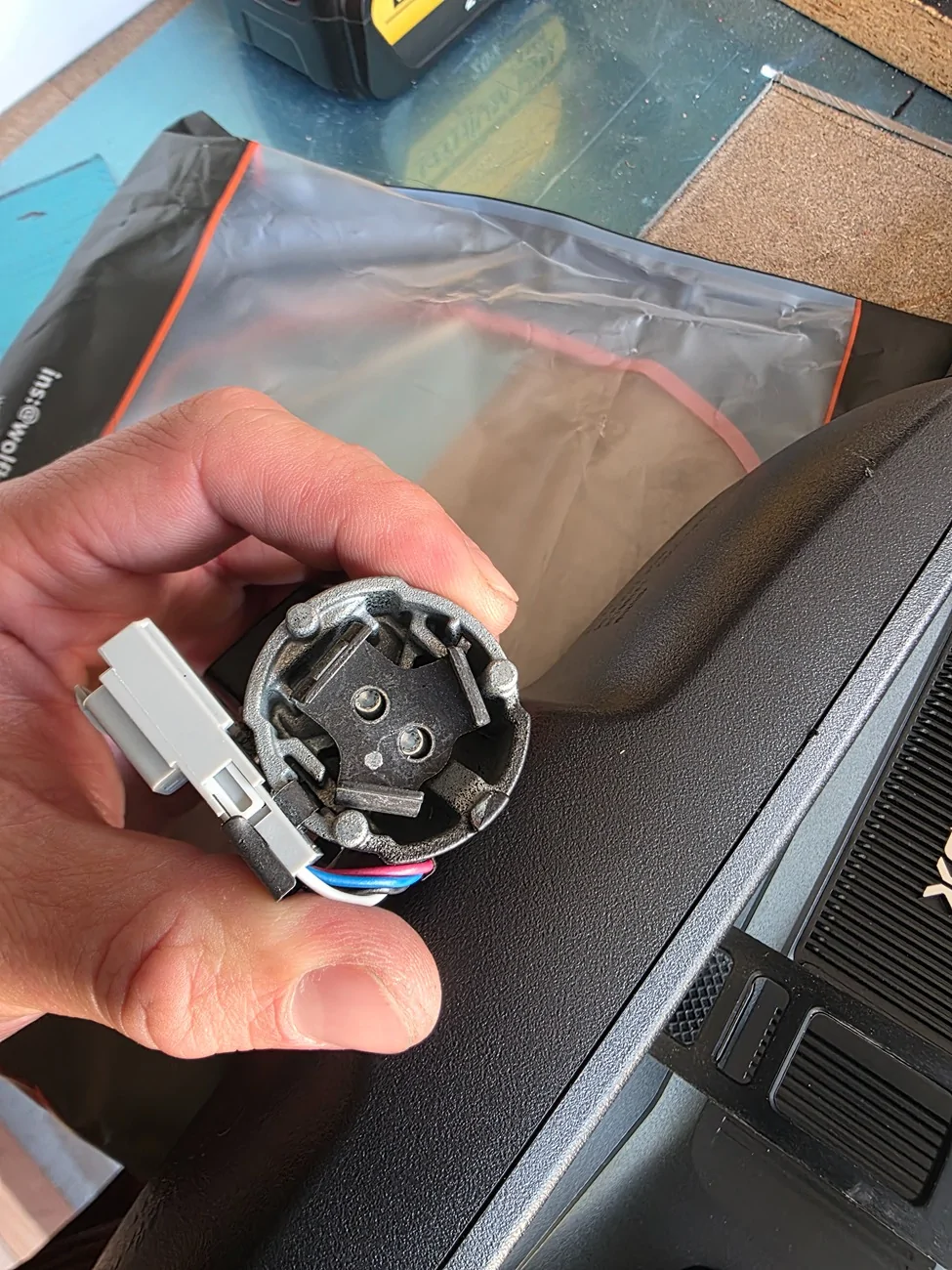

Once you remove the OEM plastic cover behind the rear view mirror and disconnect the plug, the OEM mirror just twists off pretty easily. You kind of have to twist and pull at the same time.
This is what the OEM attachment looks like. It requires 2 torx screw to remove. You will need to reuse it on the new mount. I bought the new mount via Ebay at this link. Make sure to order mount #48 by mentioning it in the comments.
https://www.ebay.com/itm/389438517756
I learned about it in a post by @SoCalMike .
Once you move the adapter over, it will look like this.
You can now attach the Wolfbox with the Ebay mount onto the OEM adapter. It takes a bit of work but I'd recommend you put it on and do a slight clockwise turn to align it.
Here is another angle.
We just slap the OEM plastic cover back on by pushing it straight on. Make sure it is aligned properly before or you'll bend the plastic pins. Next I ran the wire connecting the GPS to my dash from the right side along the headliner. Then I ran the wire connecting to the rear camera on the left side along the headliner. I ran it under the A-pillar cover and under the door jam weather stripping. The cover pulls right out with no tools. It only needs to come out slightly to drop the wire through.

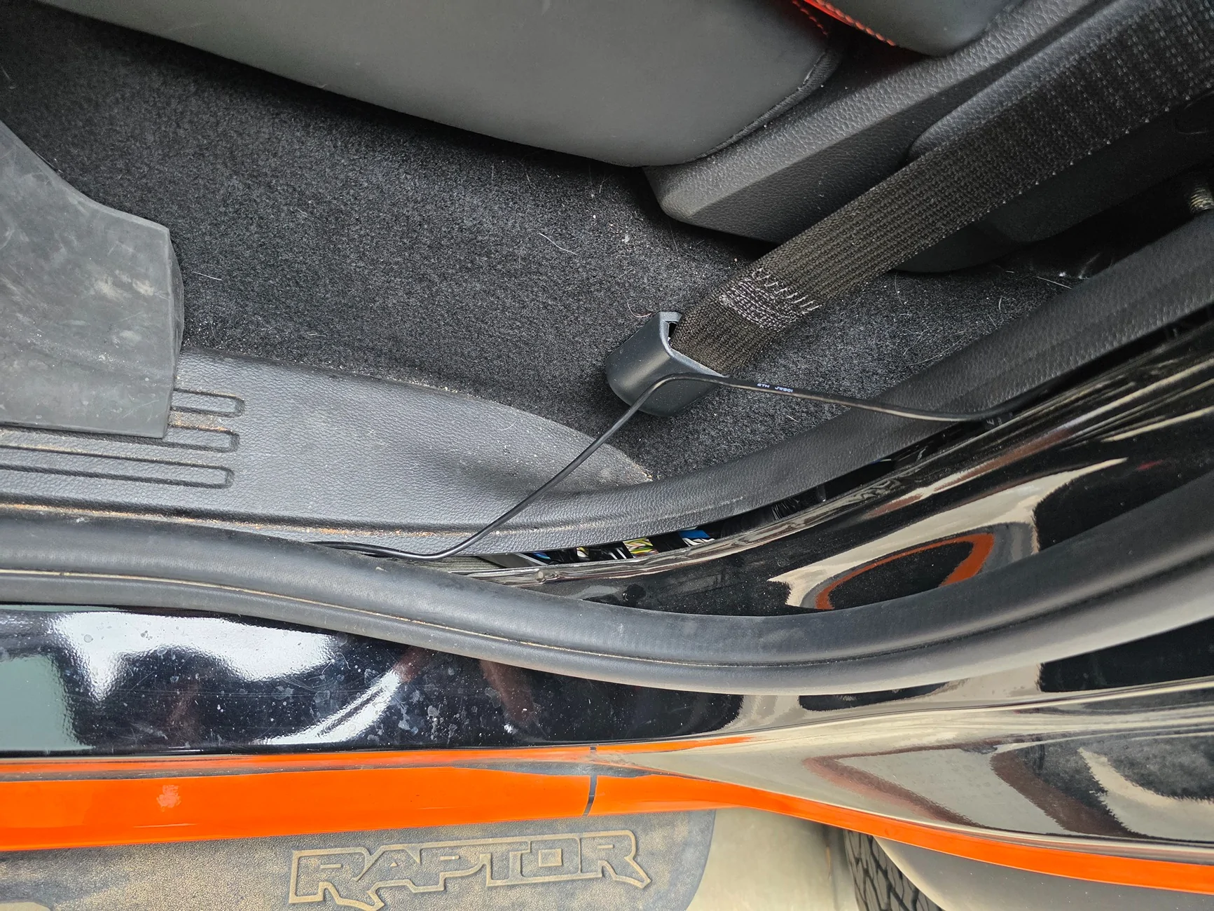

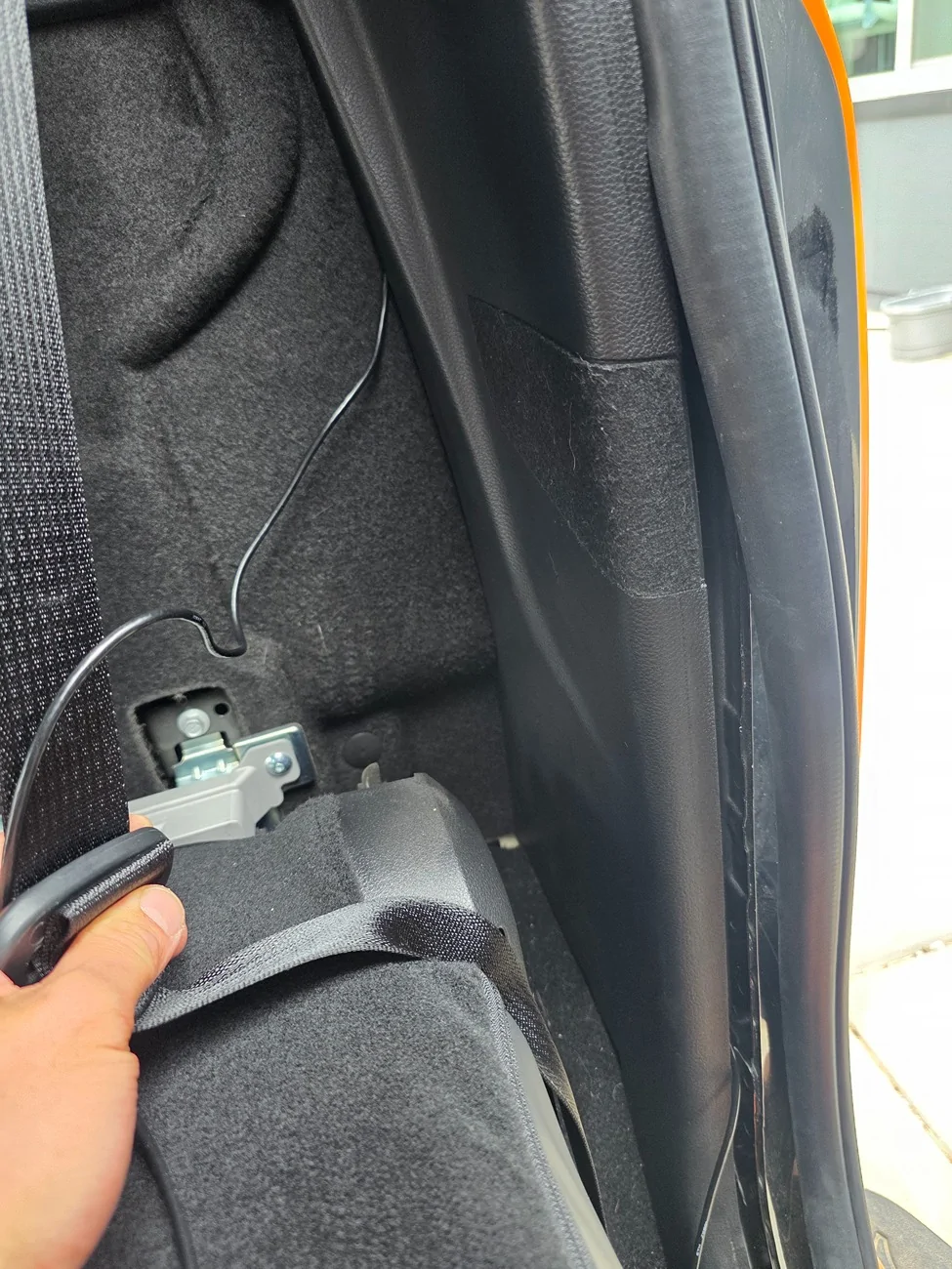

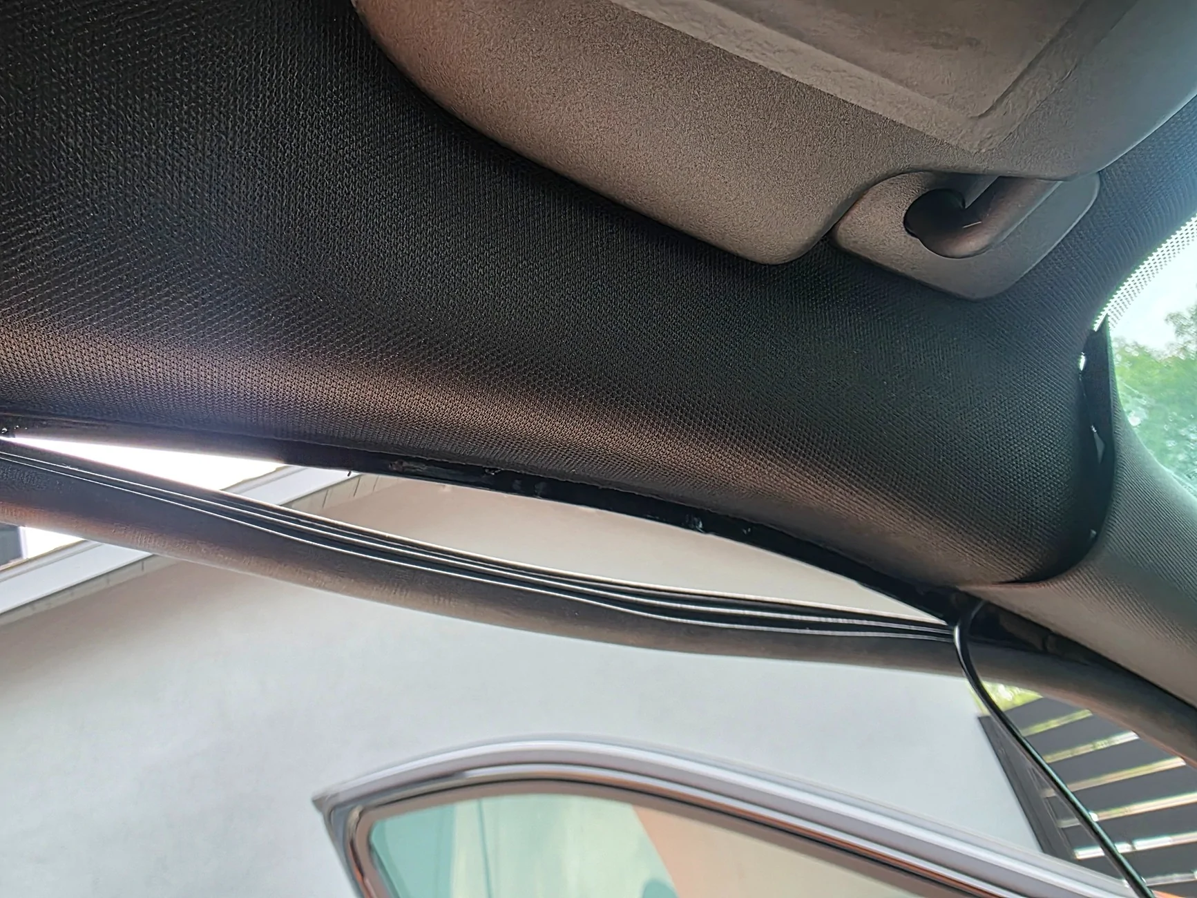

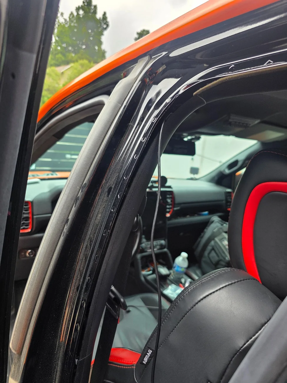

Then I ran the wire down the B-pillar and underneath the sill plate to the rear of the cab along the weather stripping.

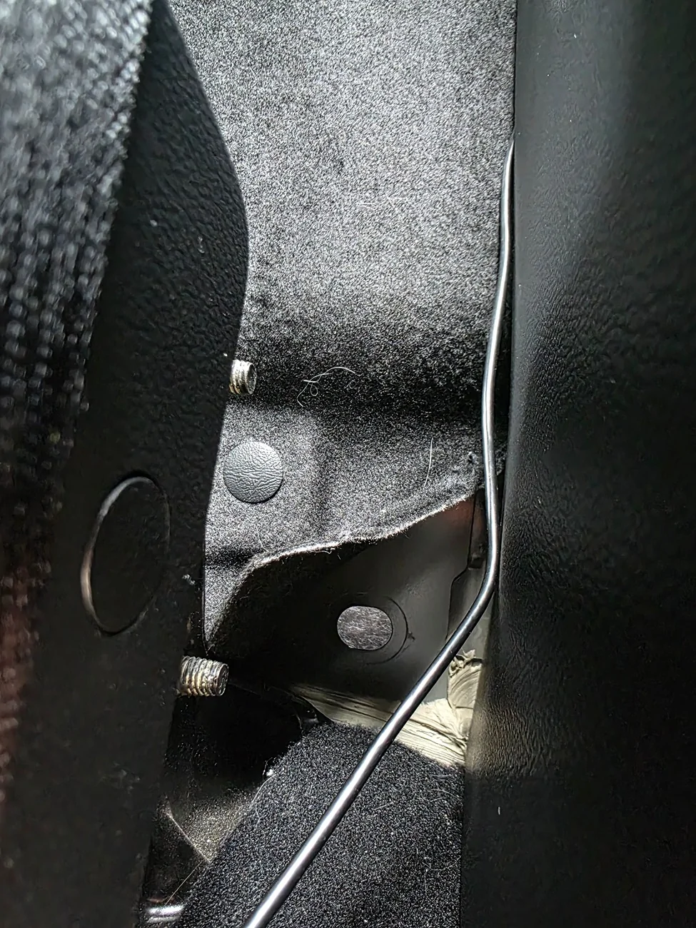

I ran the wire behind the C-Pillar plastic cover so the wires don't show at all. There is a rubber grommet in the back behind the carpet material. You can pull up a flap from the corner with some work and reveal the grommet. No cutting or removal is required. Only have to fold down the rear seats.

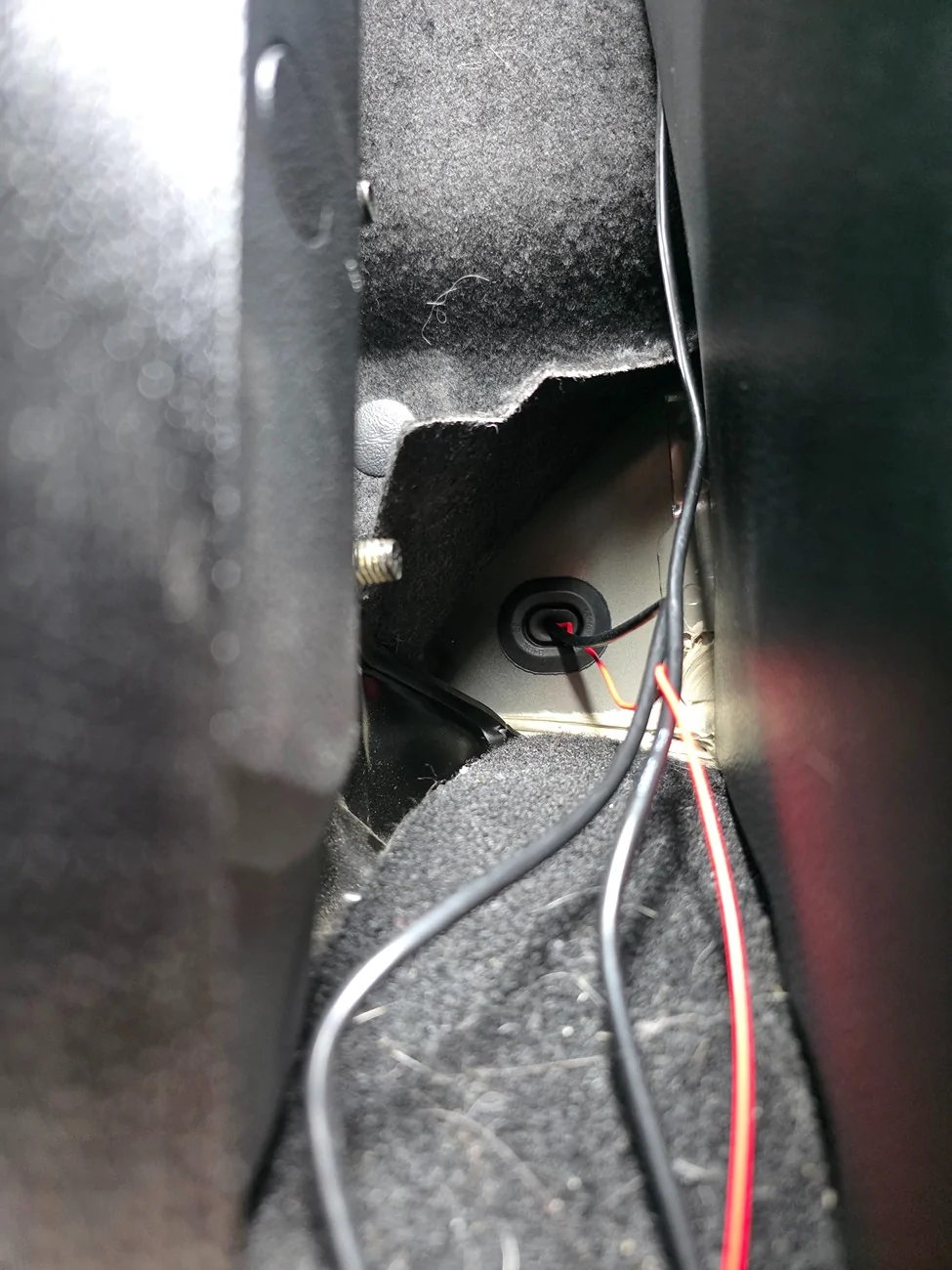

Here you can see the rear carpet lining corner peeled back and the rubber grommet removed.
I cut a slit in the rubber grommet and pushed the wiring through. The rubber grommet was able to pop back in with no issues.
After I ran the wires through, I had to use a Fish rod for electrical wires to retrieve it from the slit in between the cab and the bed. Make sure to tuck the carpet liner back before pushing the rear seats back.

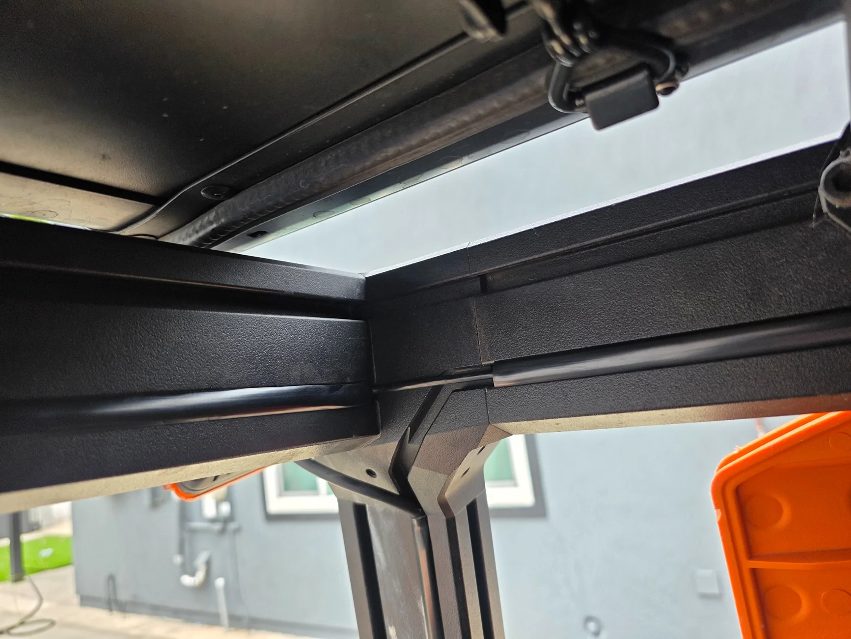

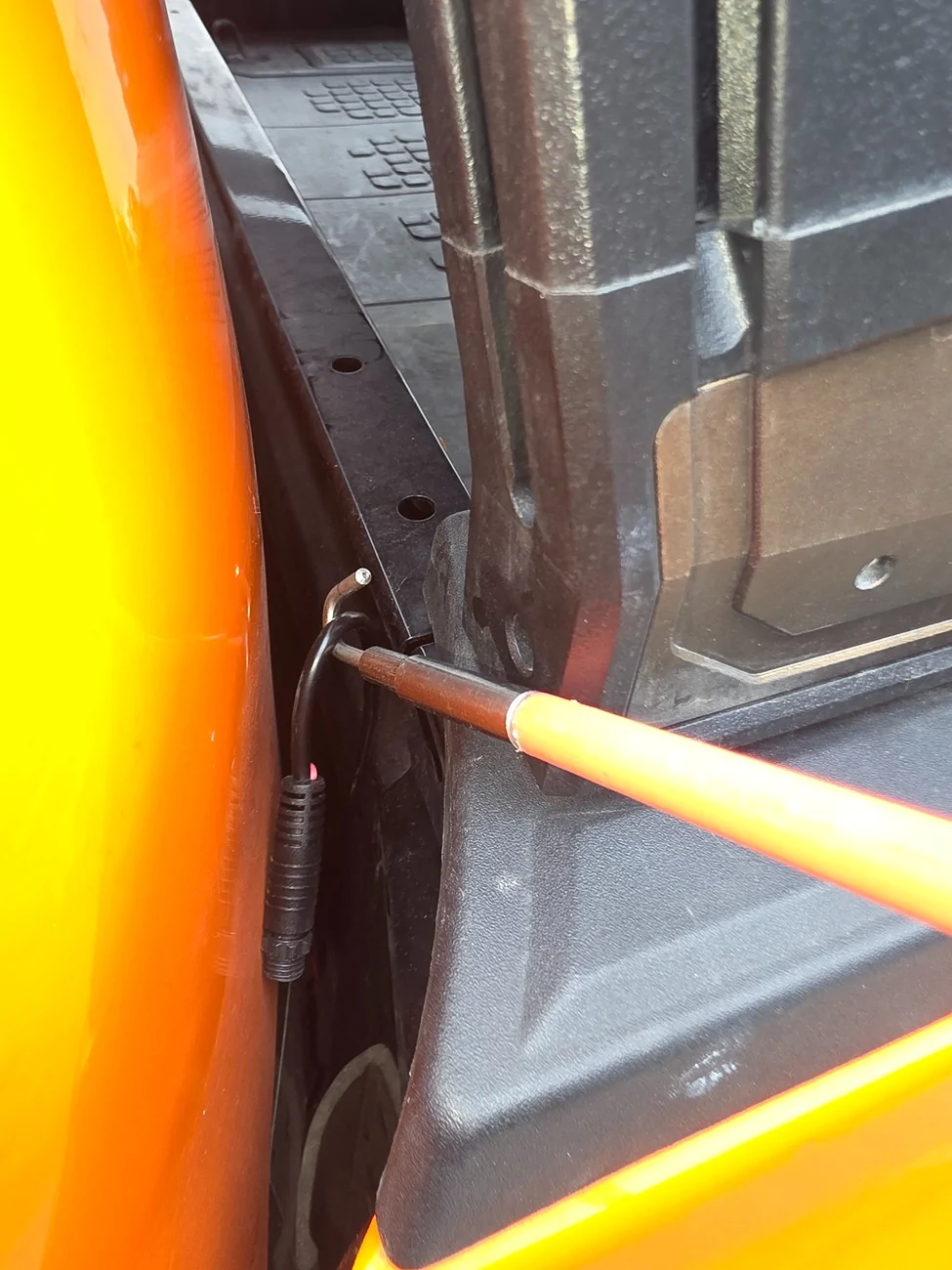

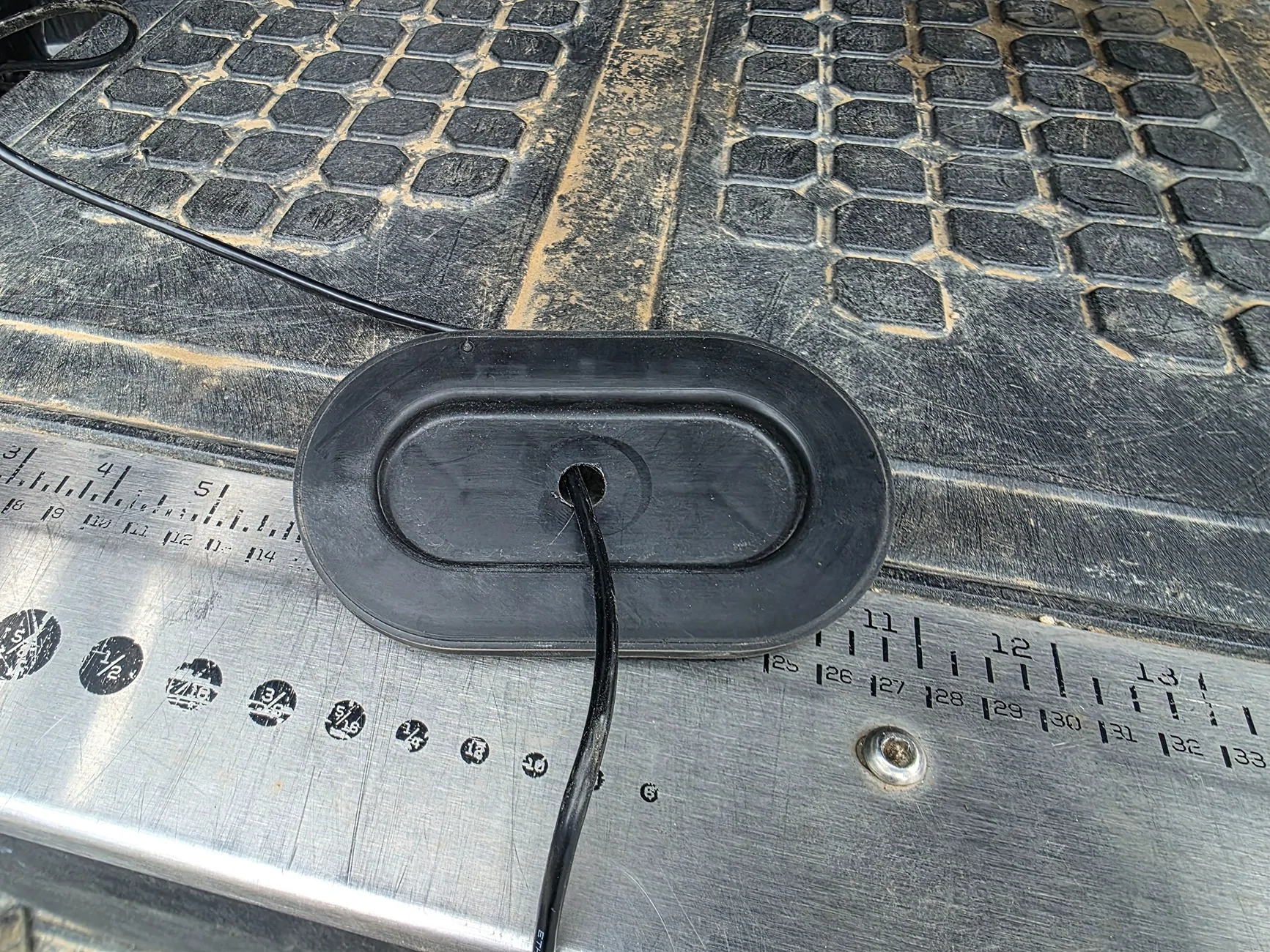

There is a plastic grommet in the bed of the truck on each side. I removed the grommet and drilled a hole to fit the wires before placing it back.
I have these dust protection seals for aluminum extrusions that I cut a slit through and ran the wires in. It tucks the wires away neatly. I ran the wire using this all the way to the rear.

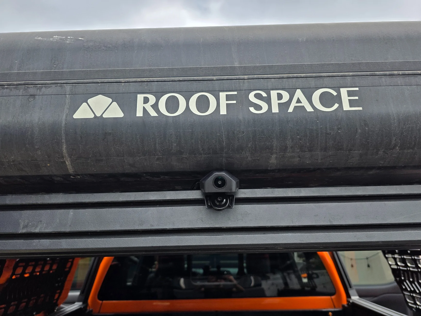

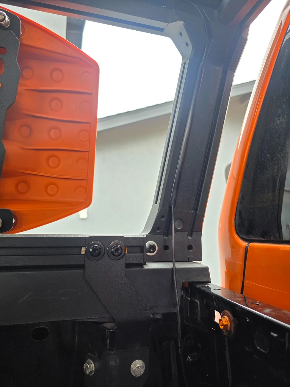

On the provided mount for the rear camera, I drilled out the hole enough to fit a M8 screw to mount it on my extrusion. I did not connect the reverse lights to the camera as I did not need the reverse function. We already have a proper backup camera on our RRaptors.

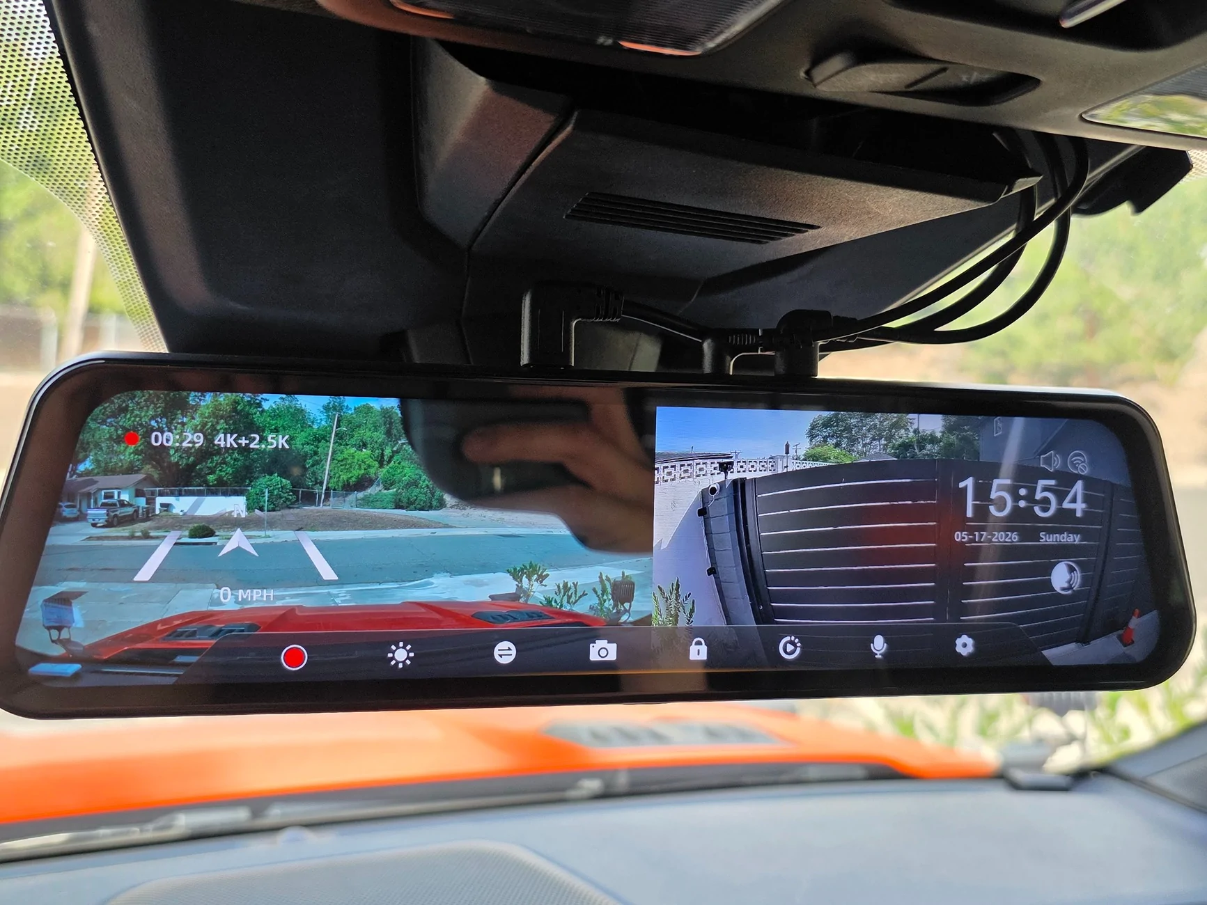

All that was left was to test the camera.
This was my view with a rear view mirror.
This is my view using the reverse camera. Much nicer.

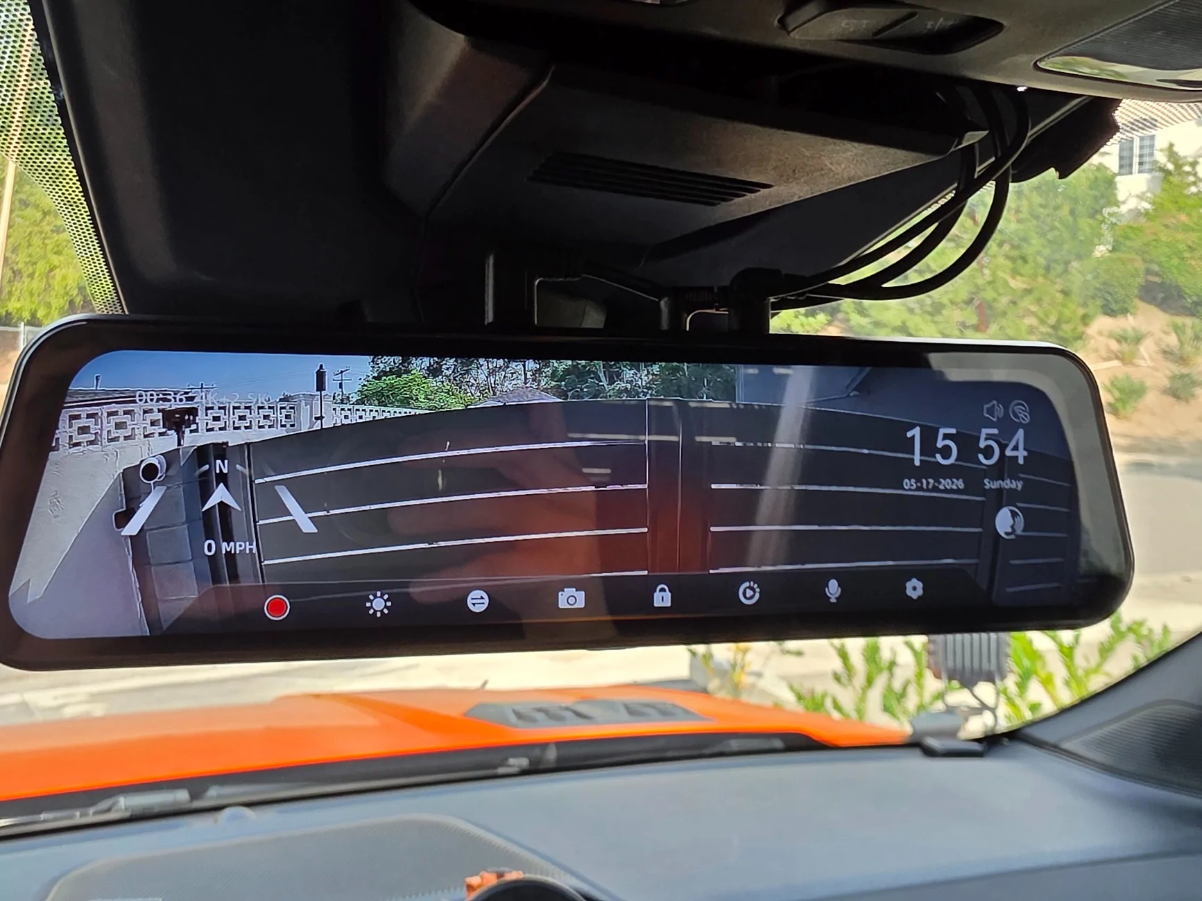

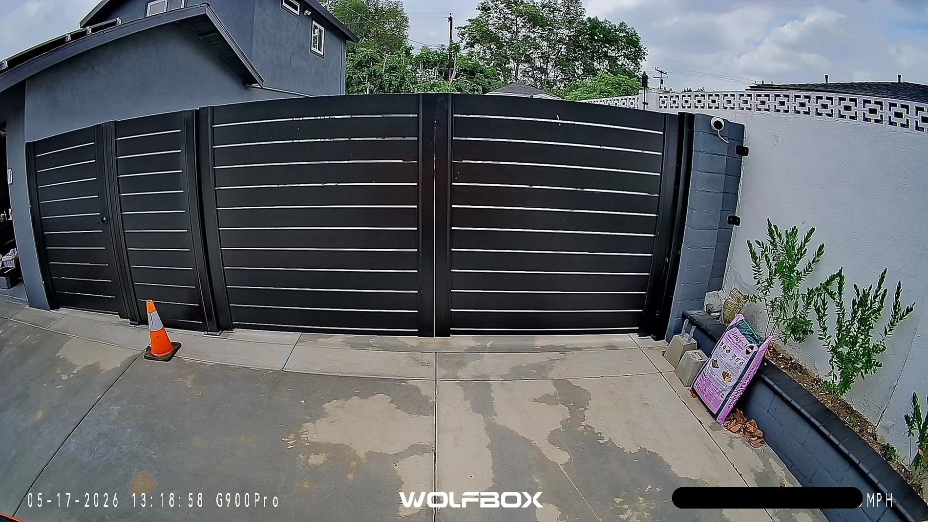

This is the full view pulled from the files. The mirror allows you to scroll up and down depending on what angle you wish to view.

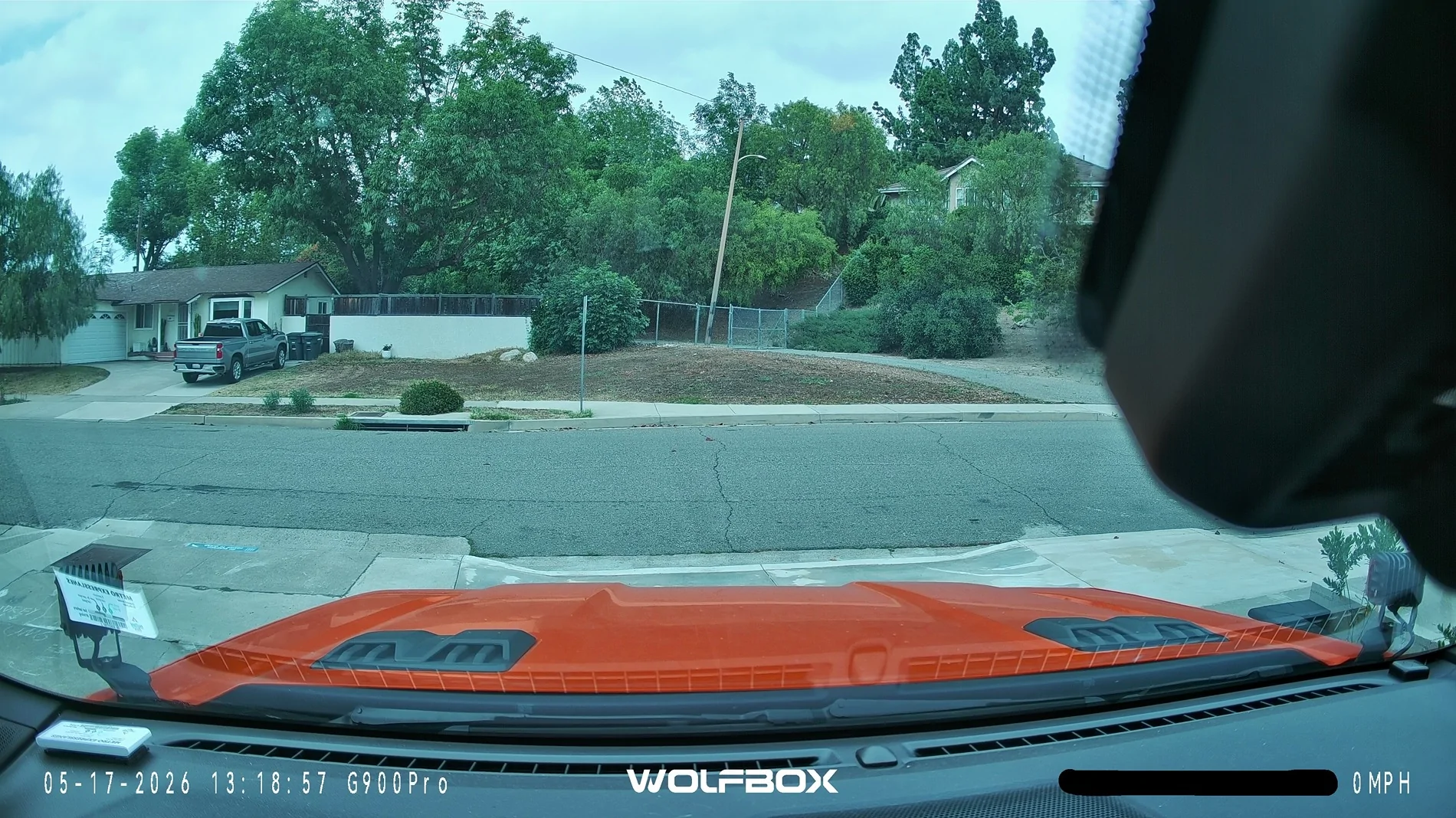

This is a snapshot of the front view vs the picture pulled from the files.

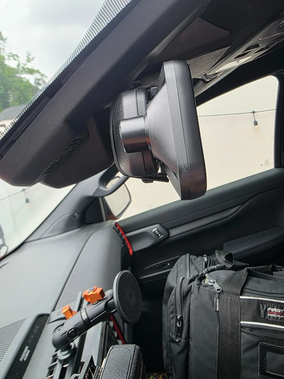

Unfortunately, due to the size of the plastic trimming and the angle of how the rear view mirror works, a portion of the video is blocked. It's a nice option that you can also see the front & rear at the same time.

The other issue I have is that the Ranger Raptor has a giant chunk of plastic in front of the rear view mirror and it's blocking a good portion of the front camera.

Great write up! Thank you for taking the time to do this. Just a thought. Take it for what you think it’s worth. The picture of the A pillar trim pulled back (pic 11 I think). That cable where it crosses from the head liner to the gap under the door weather stripping appears like it might interfere with or even block proper deployment of the side curtain air bag if its ever needed. I might be looking at it wrong though.
That's a good thing to note. I may pull the a pillar down more to see the exact location if the airbags. I have it tucked pretty close to the headliner rn.
if there is an interference it’ll be where the cable crosses to the door from the head liner. I ran mine along the bottom of the doors in the gap under the weather stripping after tying it off above the air bag to the A pillar wire way under that trim piece.

Nice work. What does that connector control for the factory mirror? I never considered replacing the whole mirror.
