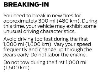

Interested in what the engine break in procedure is.
Critical Habitat
Feb 27, 2024
486
373
Twin Cities, MN
This is all the manual says about this. In the past I've been told to vary speeds (don't just set cruise and drive for hours at the same speed) for the initial break-in period. You can also ask the dealer to let you meet the service manager upon delivery and ask him/her.
Others might have more suggestions.
Pretty generic. I've had the good fortune of breaking a few new high performance motors. They all had their specific nuances but one constant has always been to vary the speed/gears early on and not to lug the motor. No towing under 1k miles is pretty standard across the Big 3 with trucks.
