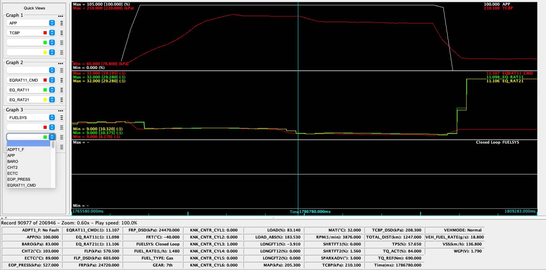

Fabulous Fabrication has hypothesized that the RR runs a closed loop fuel map, and makes adjustments to maintain its settings. They also showed that a cat-back exhaust does nothing other than add sound because Baja mode already makes the stock system essentially free-flow. Similarly, the intake did nothing but make more noise.
Unless the RR runs MAP fueling, that will adjust automatically to less restrictions and more air, we’ll have to wait for a tune to beat any performance fruit.
The RR indeed runs closed loop under WOT and most driving conditions. The two AFR sensors, one for each bank are also wideband sensors.
I would hypothesise that it is running a throttle mass flow (TMF) setup with the independent pre-throttle boost pressure (TCBP) sensor, post throttle MAP sensor, manifold temperature sensor and the known throttle body size. This would be awesome as it is a setup used to good effect in a few high end aftermarket sports DBW ECUs.
Ford Ranger Dynomotive hit 600 BHP at the wheels with 2024 Ranger Raptor (w/ ported heads)! 7th Gear WOT
