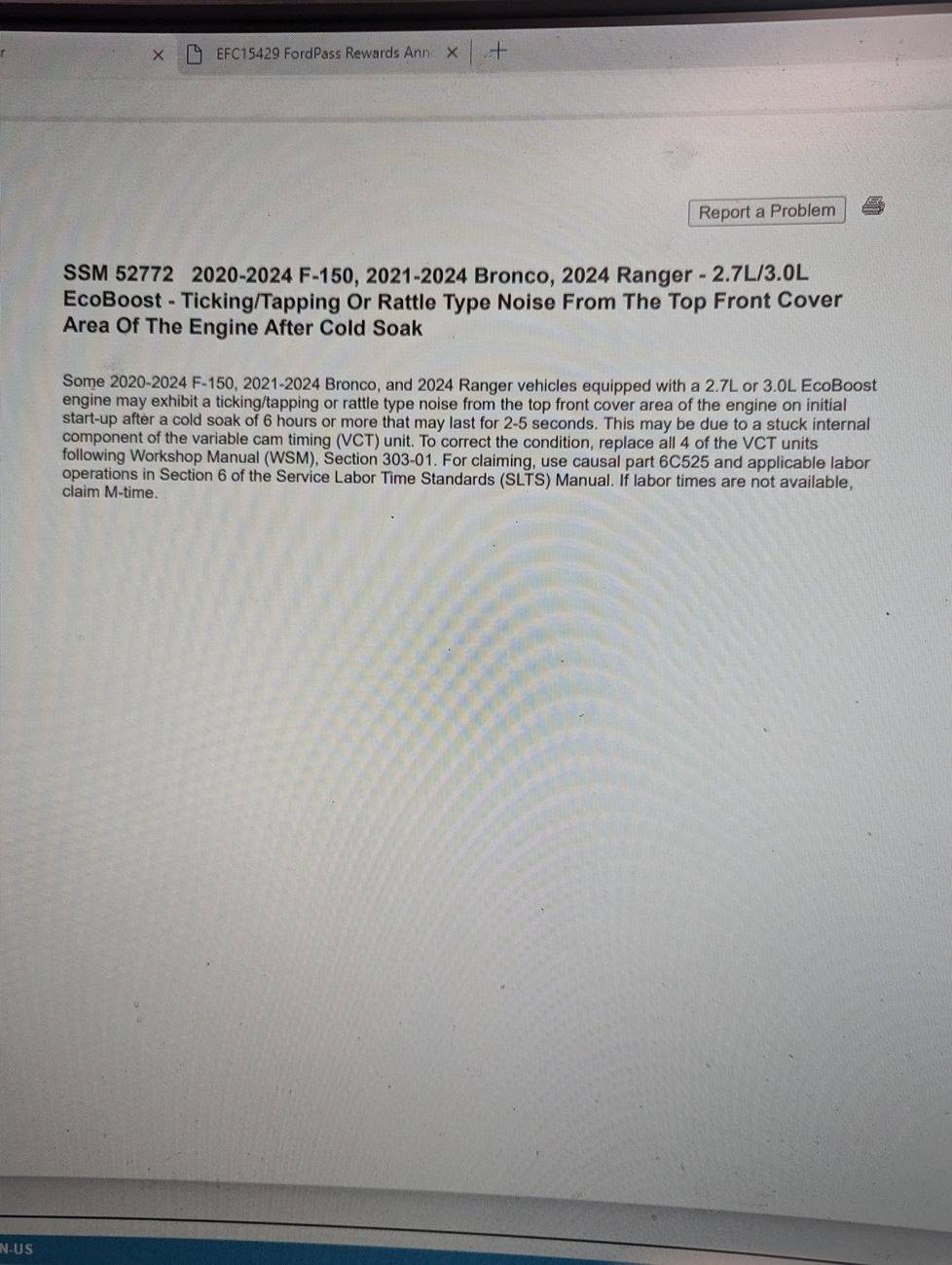

It's official. Let the games begin.
Glad to hear you are getting your issue rectified! Your issue was the one that worried me the most. It's also good to know FoMoCo is owning up to it! We all beat up Ford on here but give them credit for this one.......

Not opting in yet. I'm gonna wait until it starts back up. Plus I want to see if they are installing a different part number for the cams. No reason to go through it all for same marginal parts.

Give them credit? Really? They have had this cam phaser issue for YEARS now and it is still happening.

That's not the same issue as the cam phasers. Completely different issue and if you are on that recall I'm sure it's a motor swap.

Ok I gave up. Traded it back in. Could not sit an wait for total cam phaser melt down. Still not sure how Ford lets this known issue occur. But I'm out.

Why didn't you just let Ford try to fix it?

Exactly, they keep cranking out these engines and not fixing any of the problems they have year after year.
No point in having a repair done if they are just going to use the same garbage parts.
You can bet on the fact once they take your engine all apart it will never be the same. Leaks, rattles, broken tabs and clips.....its not a good situation.

Guess we'll see. I just dropped mine off for cam phaser replacement.
