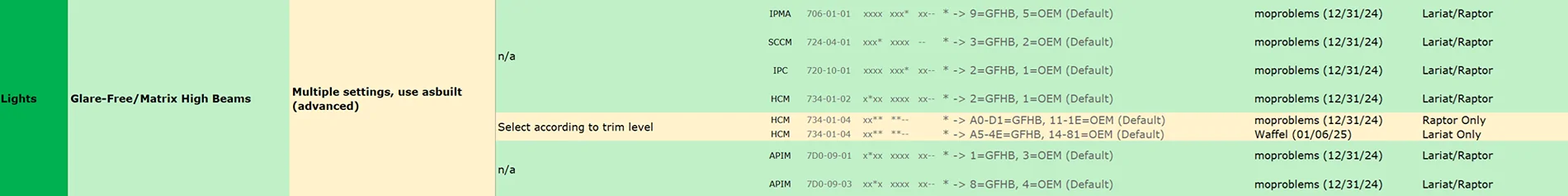

Did u enable the lights on the screen or Forscan?
Yes, there are a bunch of things required. I followed the community spreadsheet
The auto headlamp indicator will be either white or green to indicate “glare free” headlamps enabled, I don’t remember which. Someone on here can hopefully remember. You have to cycle through the high beams after activation in the touchscreen. The 3 modes are high beams off, high beams on, and glare free

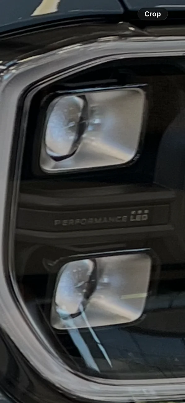

If they say The ford performance led or led ford performance (can’t remember) then yes.

Can you snap a photo or write down the part number on your lights? Either one works. There are several numbers posted on the housing. My passenger side is listed as N1WB-13E016-FE .
From what I can find this should fit all 2024-2026 models, but unsure if that doesn't take into account any removal of anti-glare tech.
how did you enable in FORScan? Thank you
Best to check the headlight housing for that specific badging but I believe I’ve read here that in MY25 or MY26 they stopped including the hardware support for the “matrix” capability in the US. My US market MY24 Lariat has it and it works with the Forscan changes documented.

I followed the rows in the FORScan community spreadsheet. Lots of different modules
Ford Ranger Active headlights on US Ranger Raptor? forscan_matrix_lights

So what's better- brighter Matrix or performance leds?
As I understand it, they are one and the same. The performance LEDs are what ranger raptors ship with, then from there you can enable the Matrix function if your year supports it.
From testing, there is no difference in brightness from the Normal Highbeams and the “matrix enabled” beams. Pattern is the same, except the matrix “bends” around other cars.
