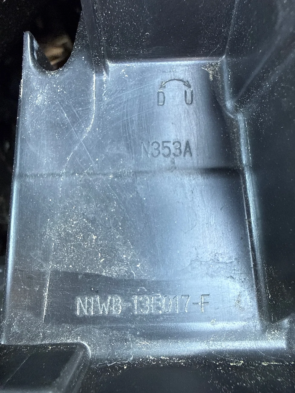

I've been trying to definitively figure this out. I enabled the matrix functionality on my 2026 and the infotainment screen shows it, but I haven't really been able to confirm with hardware or functionality
Can you snap a photo or write down the part number on your lights? Either one works. There are several numbers posted on the housing. My passenger side is listed as N1WB-13E016-FE .
From what I can find this should fit all 2024-2026 models, but unsure if that doesn't take into account any removal of anti-glare tech.
Shrek The Raptor
George
Apr 5, 2026
60
atlanta
No “e” for my 2024.
Driver N1WB-13E017-F
Passenger N1WB-13E016-F

I *think* those last letters after the dash are the version. I've seen -FC, -FD, and -FE. And now -F
But I also can't confirm
Guess I really just need to drive my ass around at night and just pay attention
