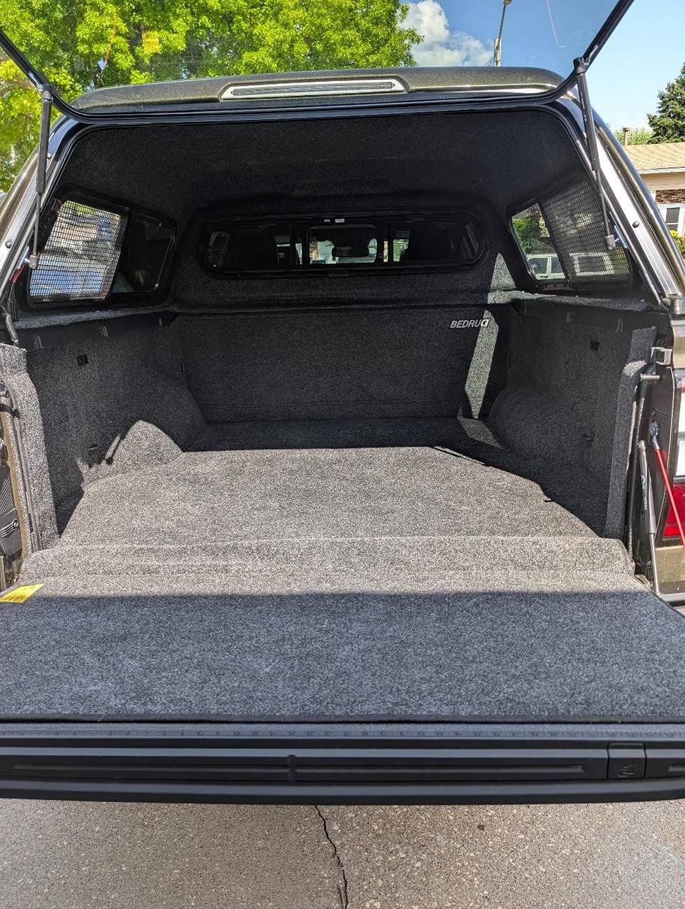

Not too bad install the mx4 took some tinkering to work correctly, still have a few adjustments but I am happy.
I recently installed the BedRug in my 2025 Raptor also (Shelter Green Baby!!). I did not completely cut away the flap over the outlet plug on the driver side of the box. I just cut a flap in it to be able to access the outlet but left the flap there as protection. Have to ask, why does yours have two flip up covers there? Mine only has one.
Additionally, I only cut slits to create a small flap for the cargo lights on either side. It stays folded down well enough but I can flip them back up if needed to protect the lights. (They don't really shed that much light anyway.)
You can see in the photo, I also put a LEER topper on mine. I wish I would have gotten the ARE. That's the one I have on my 2022 that is for sale and it seems like much better quality went into the accessories there on the ARE.
