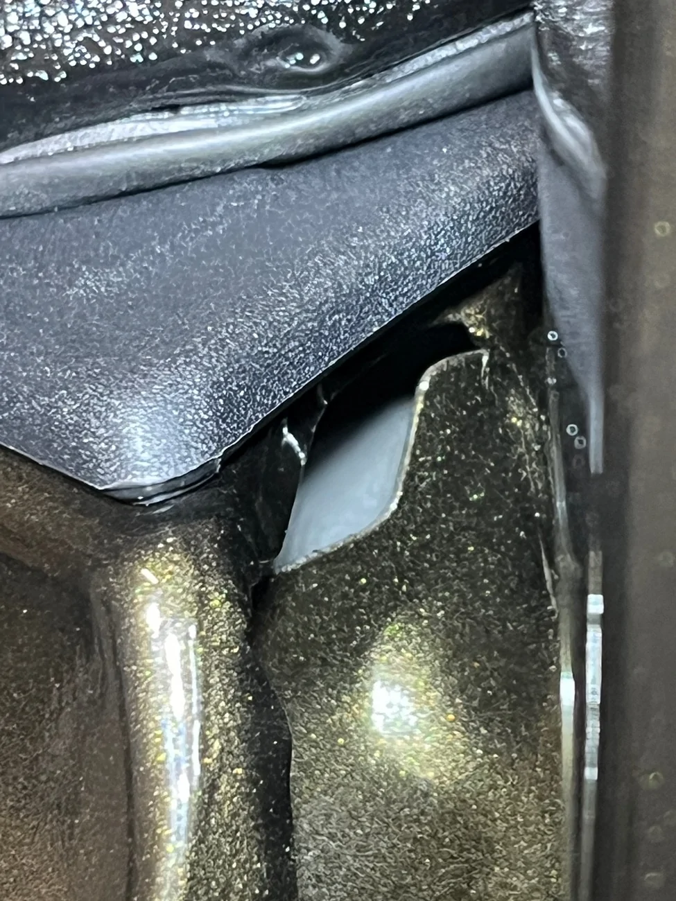

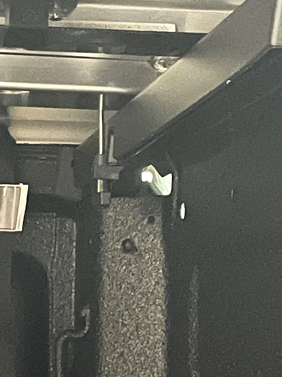

Here's a pick of the opening at the front of the bed by the cab. Water is easily going to go in there while washing the truck. It looks like it could be double-walled in that area, so water might just pass to the bed if its a heavy amount... But if light can pass through it, then so can water... In theory. :LOL:
