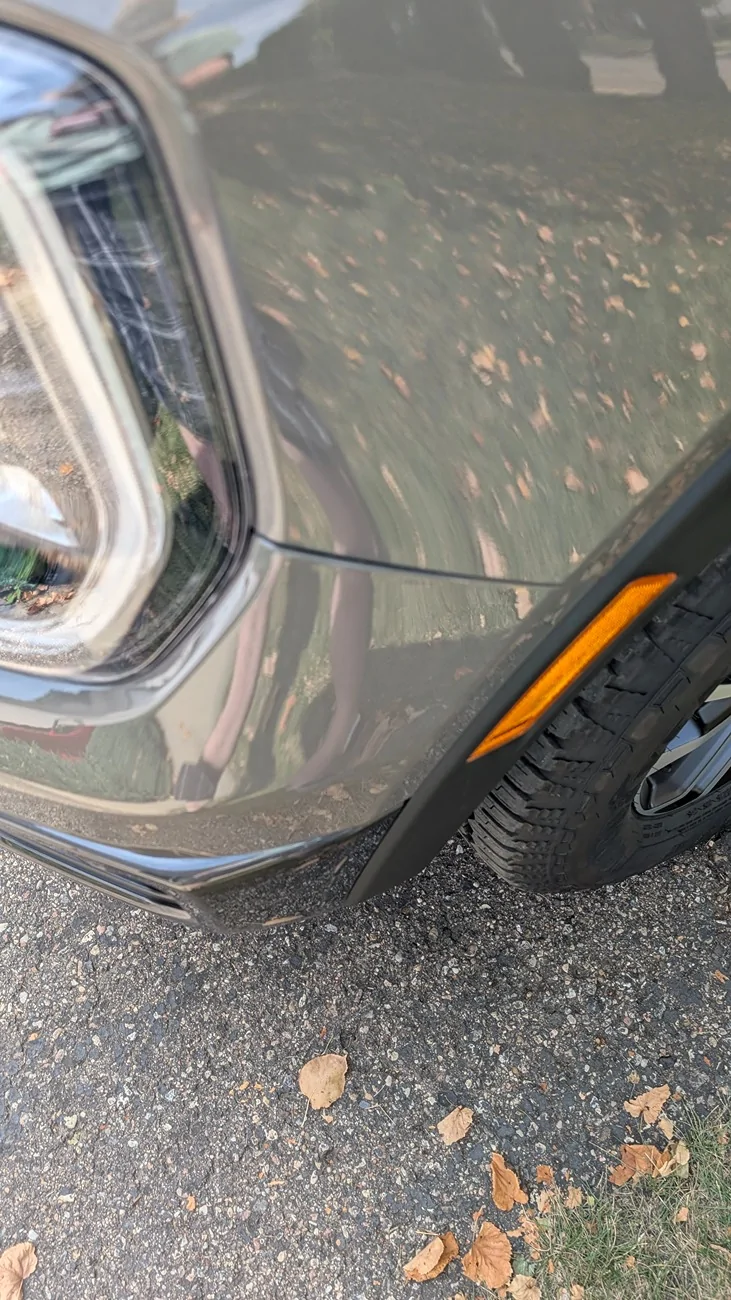

I'm late to the party on this!
25 Lariat.
So far the bumper has a noticable panel gap (seems like it's not clipped in properly, and continues to pop out)
Driver's side door has an annoying tick/rattle
Sun visors are really loose on the roof (feels like it's going to rip off the roof when unclipping to swing over the door)
the sunglasses holder seems like the driver's side hinge isn't sitting in place properly (holder has slop on the driver's side hinge and solid on passenger side)
And now I've noticed the tailgate doesn't sit flush to the body if closed normally, if I slam it it is flush but when you go to open it after slamming the handle feels awful and like it is about to break.
