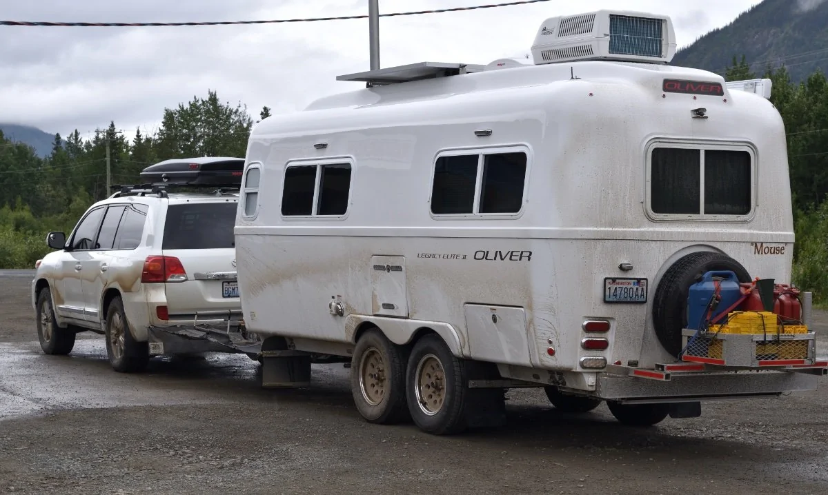

You did not mention trailer protection. That long a trip to AK will definitely wreck it. This is a guaranteed cure for road debris damage.:

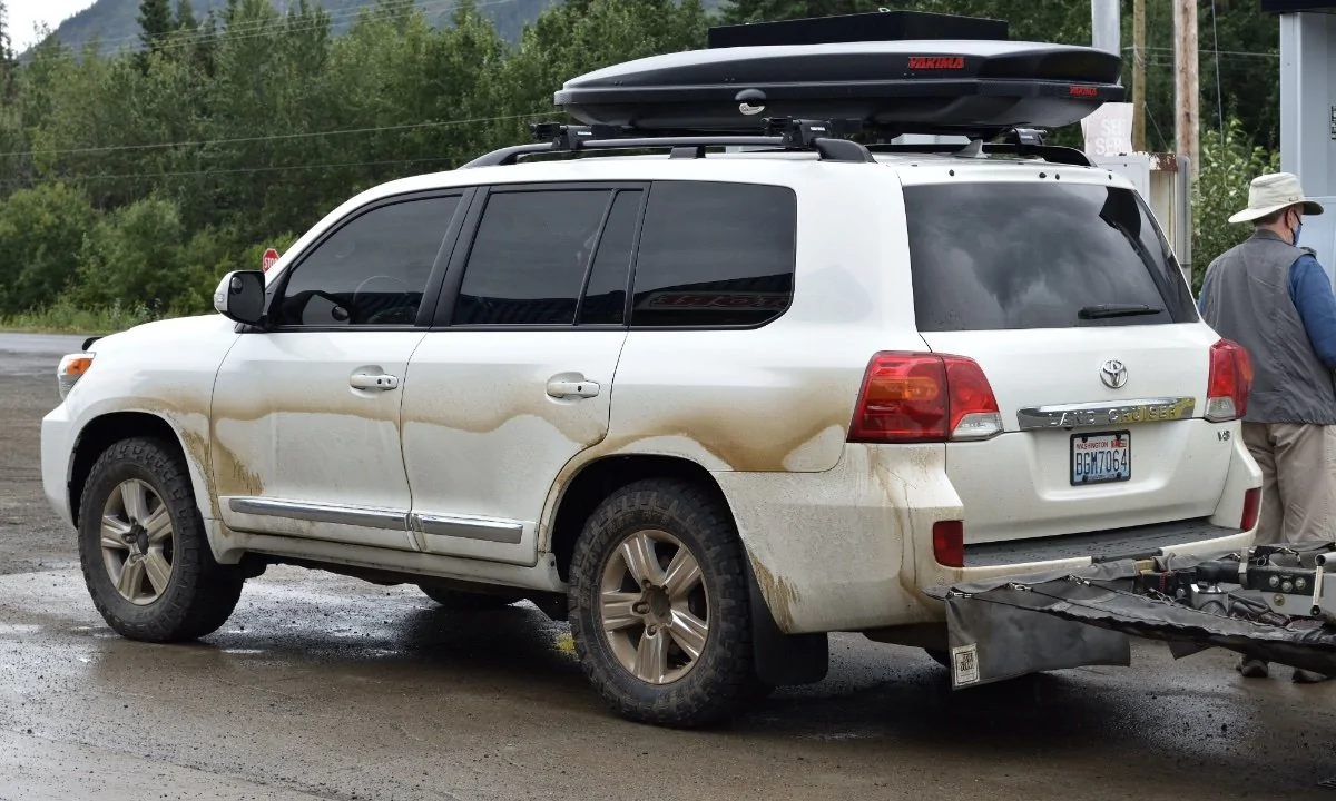

Rock Tamers are OK, make VERY sure that you adjust the sail angle so that they deflect debris downwards as per this video.
Adjust Rock Tamers angle
Be extremely careful on gravel roads or fresh chip seal, if they are too long they will touch the surface in a sudden dip and literally throw a rooster tail of rocks up onto your trailer. There is nothing you can do to prevent this except to slow way down. You can also attach two strips of rubber on TOP of the RT support bars that seal the bumper gap - that stops many of the wayward rocks from bouncing through those openings onto your tailgate and rear glass if you have a canopy, and it also helps to keep the flaps from rocking so much…. I have used Rock Tamers in the past, they are definitely better than stand alone truck flaps, but do not expect them to do much if you venture onto gravel roads.
