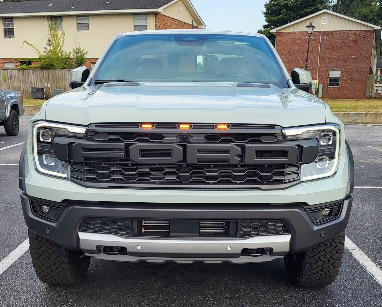

Link here.

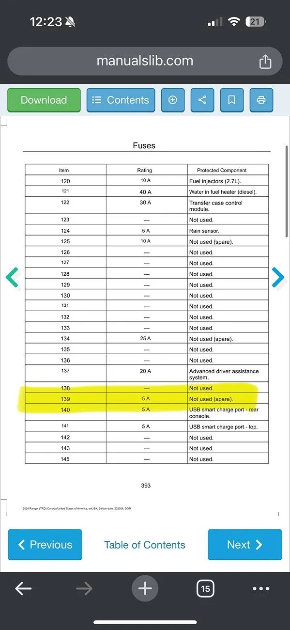

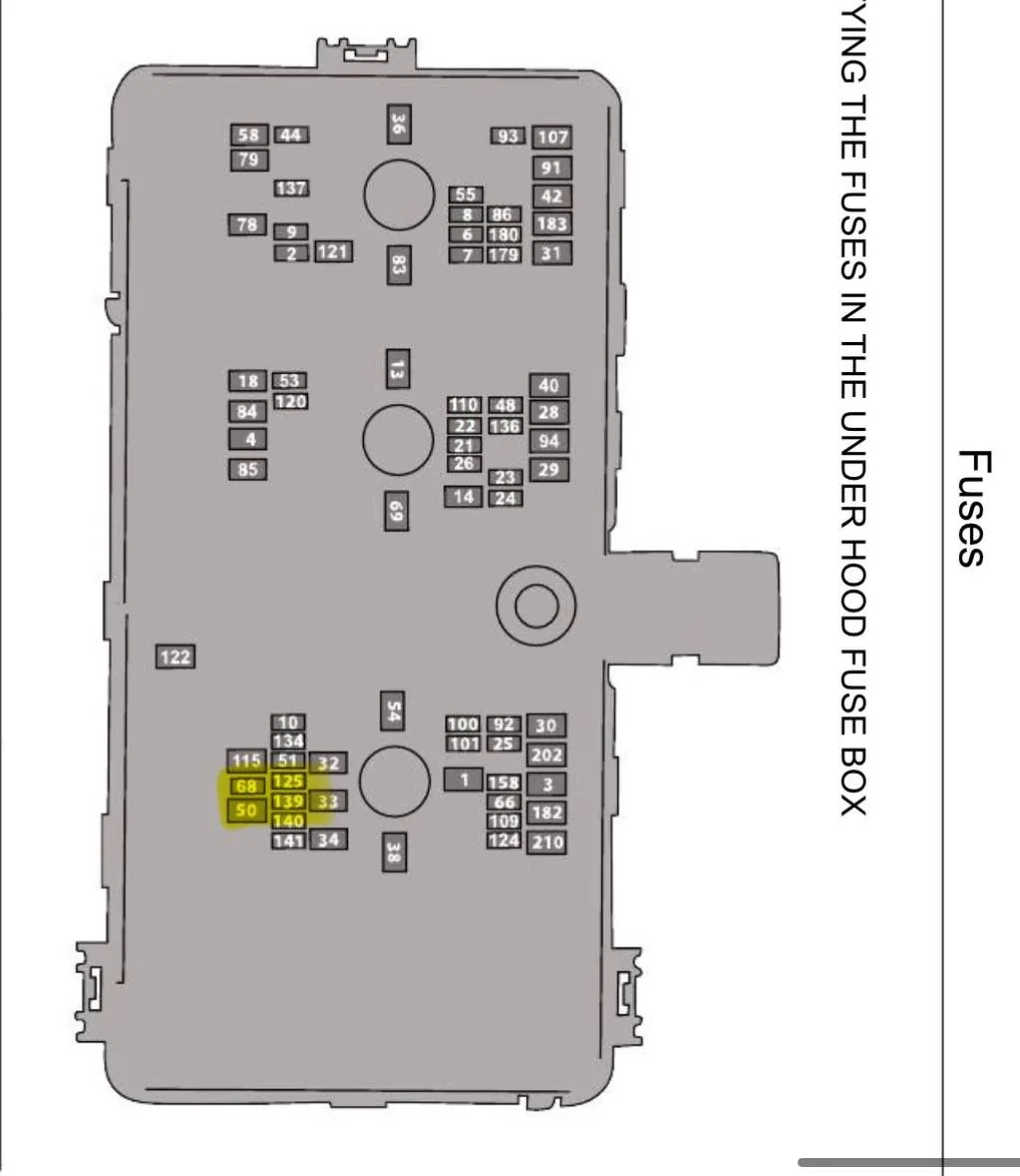

Doesn't come with instructions so some of the fasteners took some guess work, but it's honestly great and exactly what I was looking for. All the wiring is done in the harness for you and you just need to crimp a fuse tap on (fuse 139 under the hood) and then ground it.
Is fuse 139 for the parking lights?

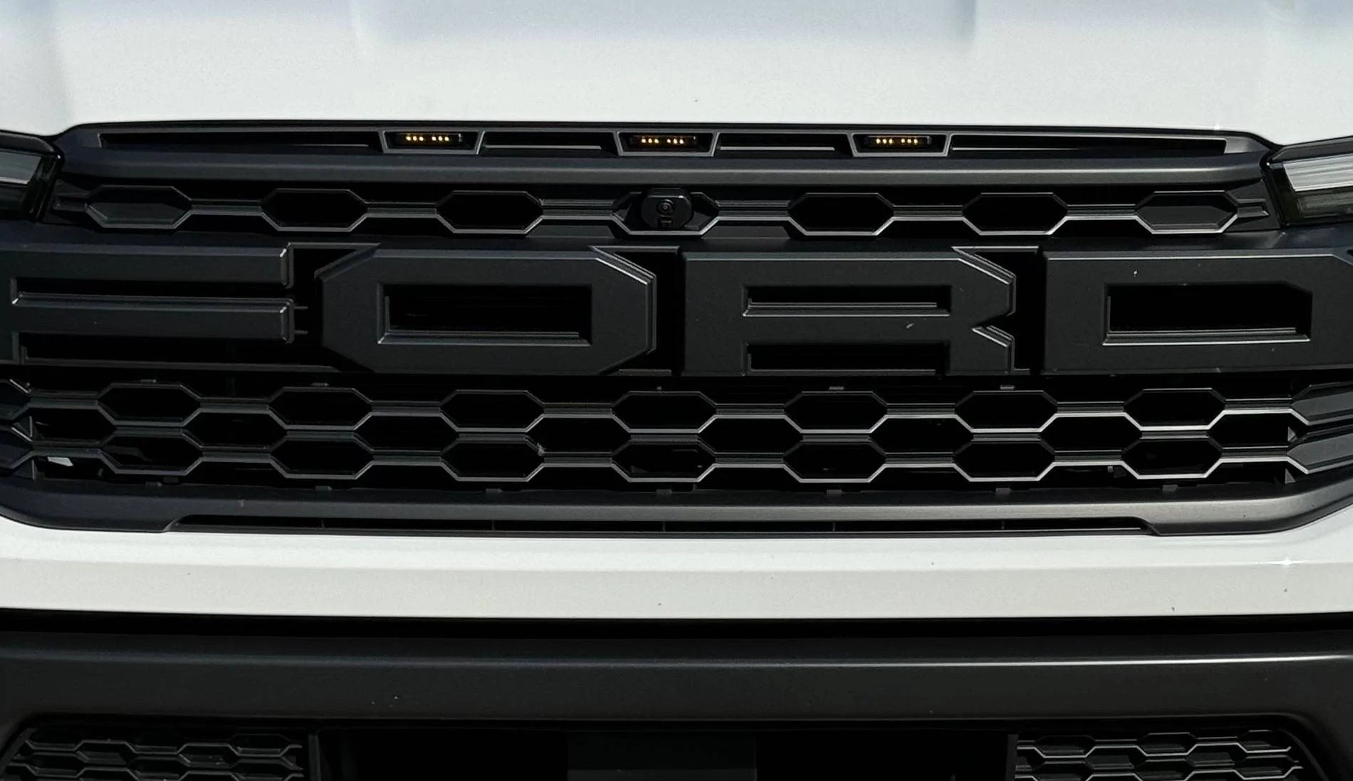

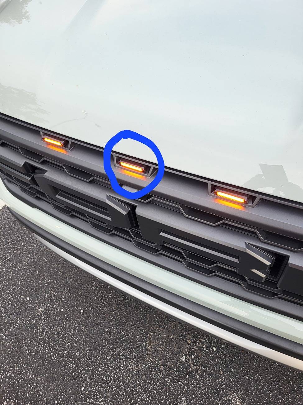

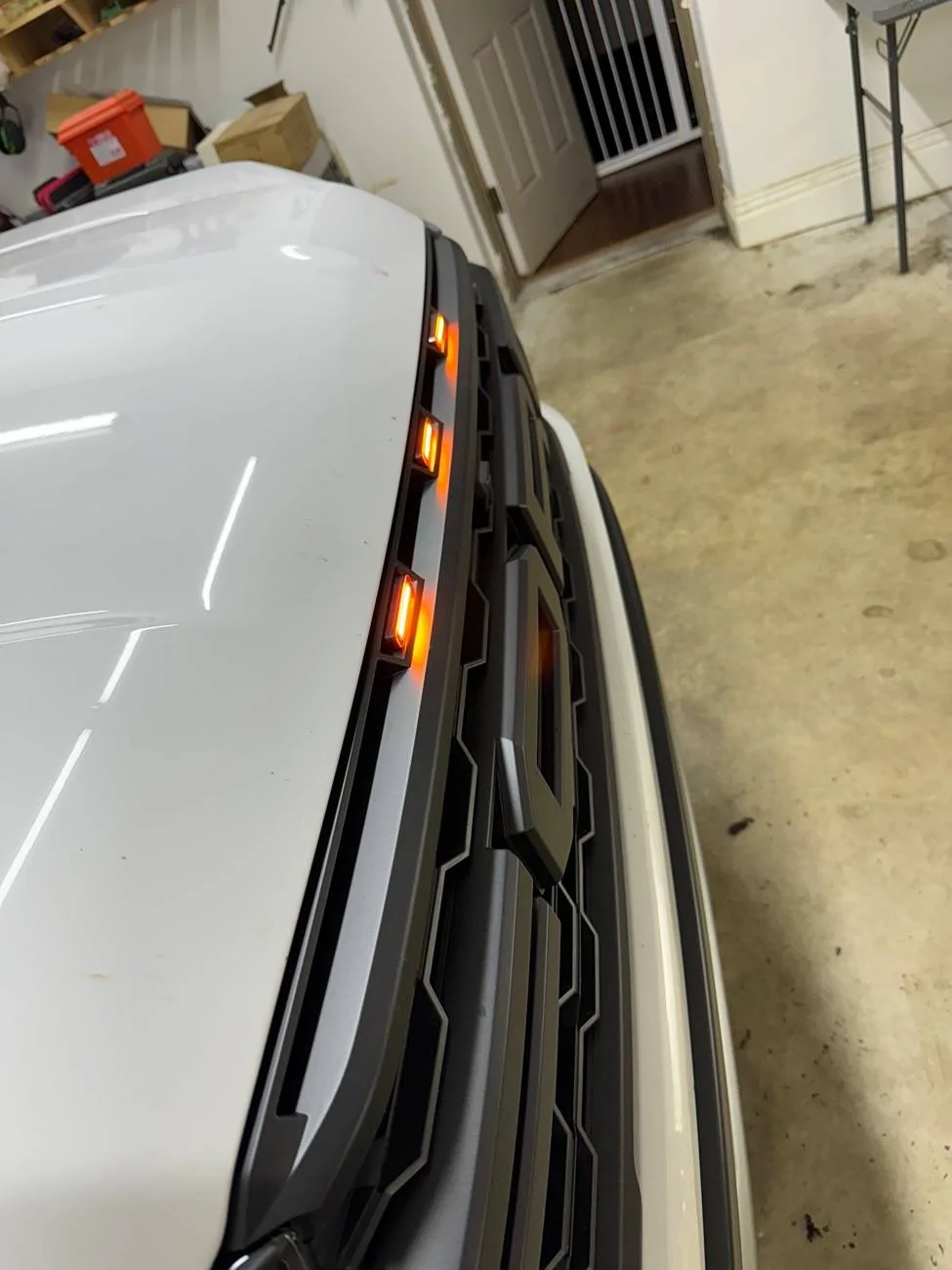

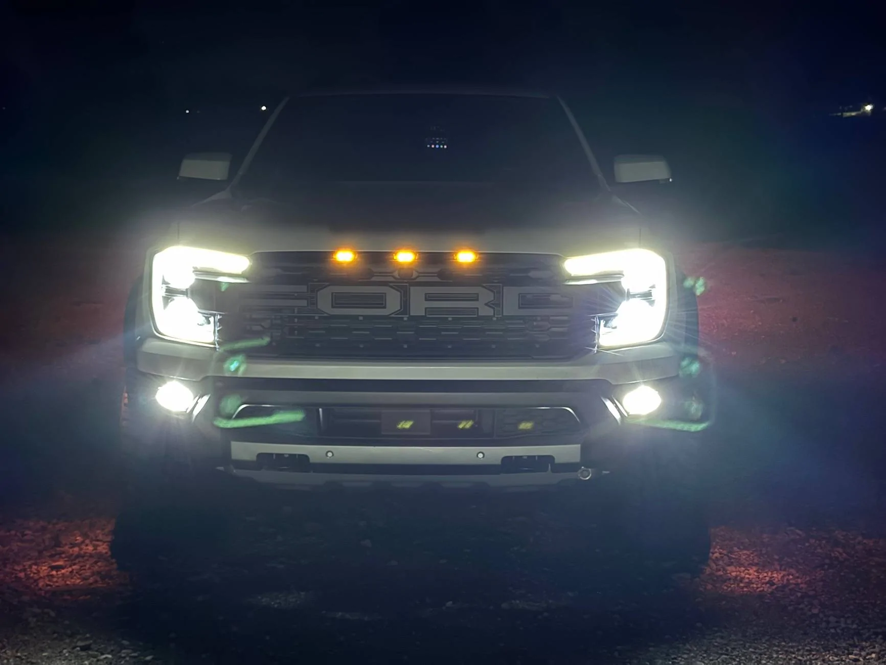

Looks great, I wish I could get lights like that for mine. I have the eBay lights in my grill now, just not very brights, and not crazy about seeing the led dots in mine. But it’s all I have been able to find.

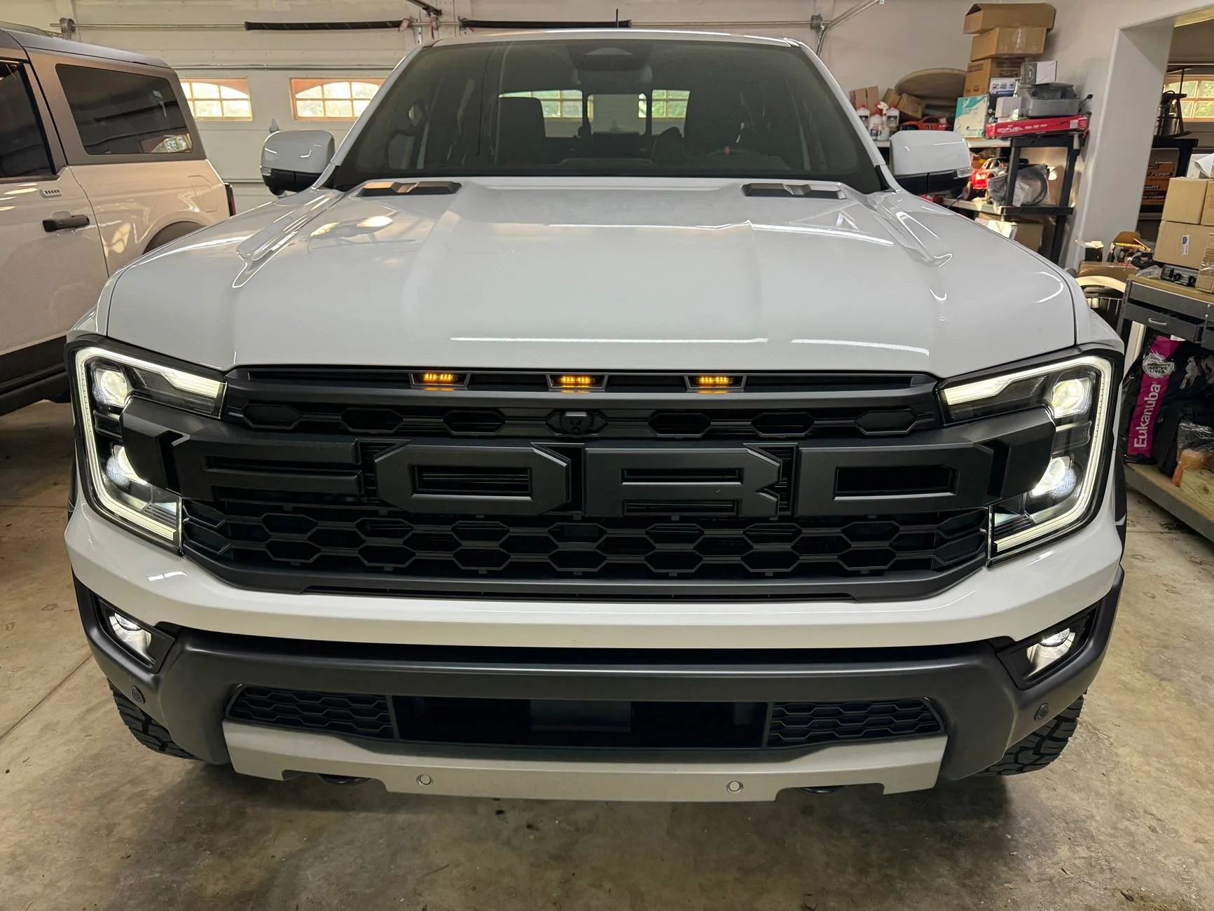

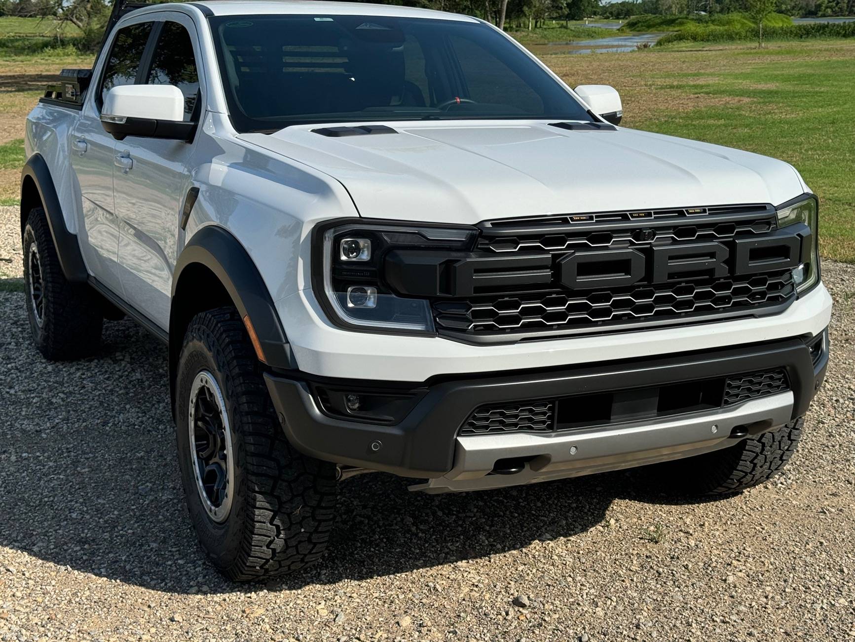

I am with mine. I got mine from F150 LED'S

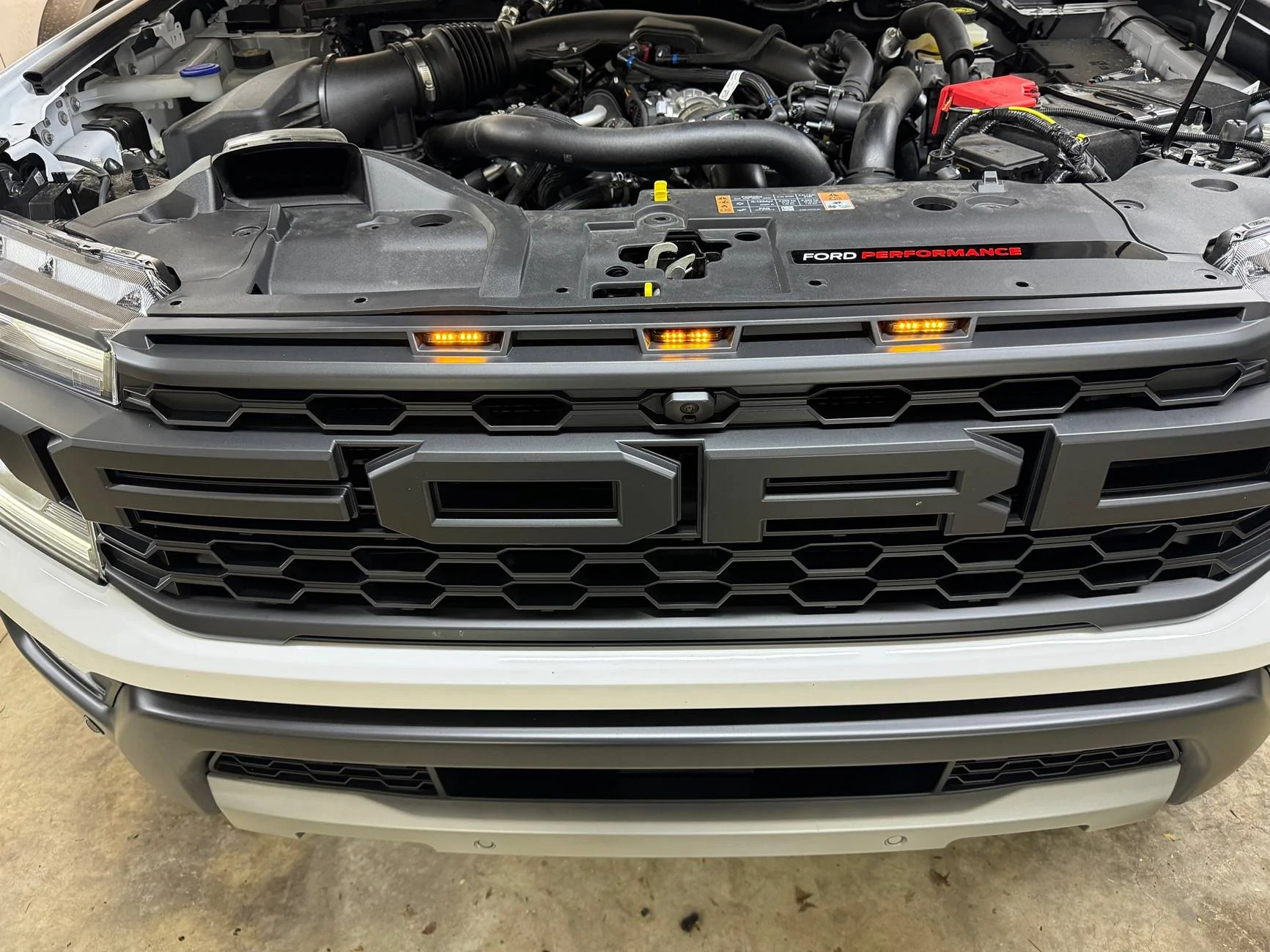

I got the same ones and for now I installed them to upfitter(aux) 1. But maybe I move to the parking lights. Like you I had to drill a pretty big hole from the back side to accommodate the plug but they look really good and they are very bright. I wanted to tuck them back into the opening a little more but decided that I would risk cutting too much grill, so they are where they are.

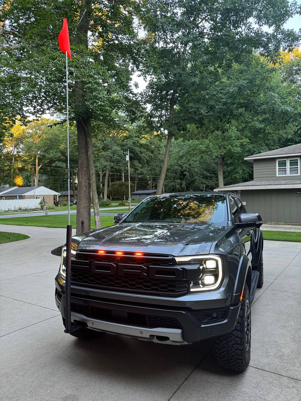

Exact same thoughts. Wished they tucked in a little more. Overall I am happy with them. They are very bright and look really good.

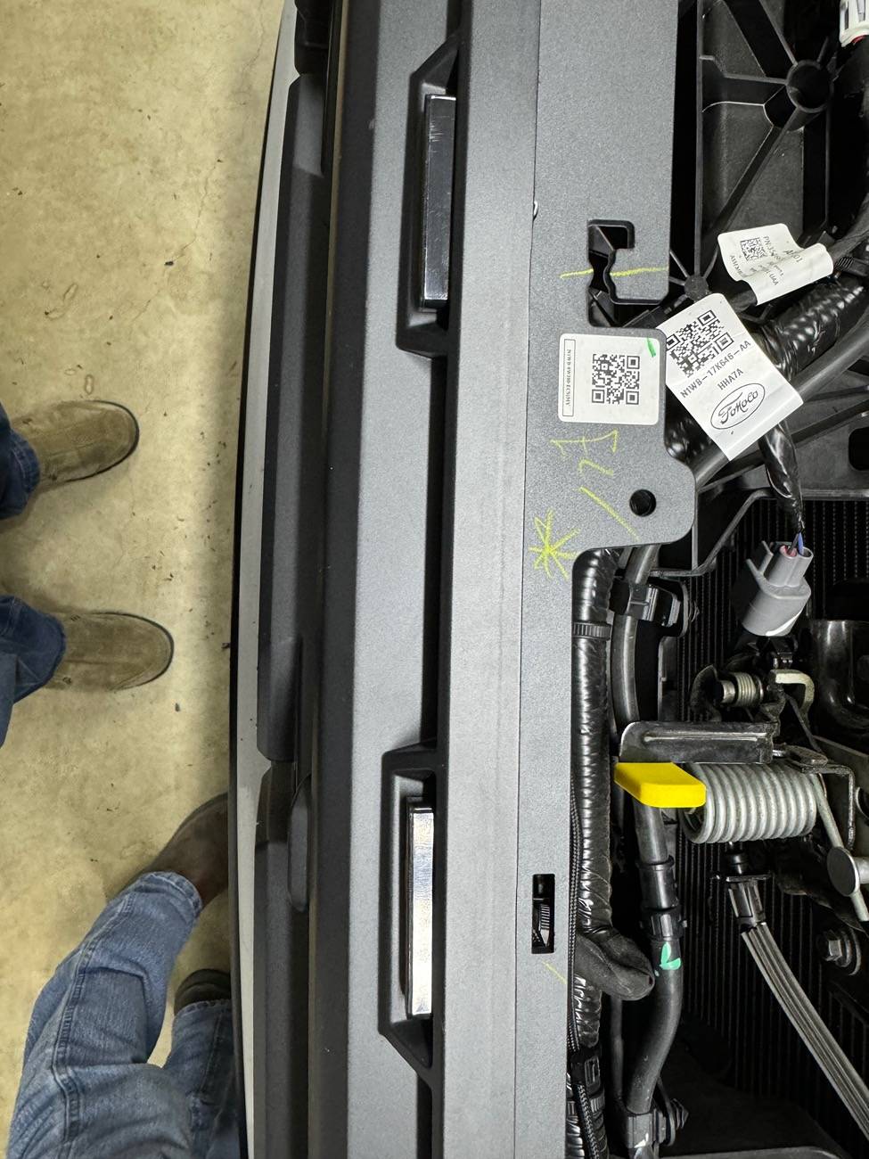

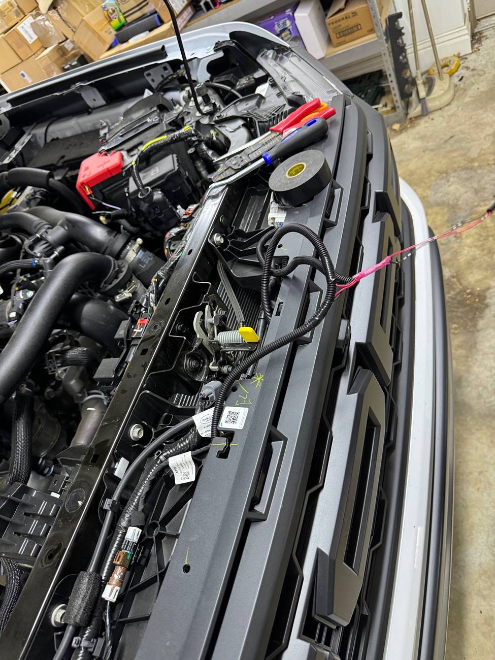

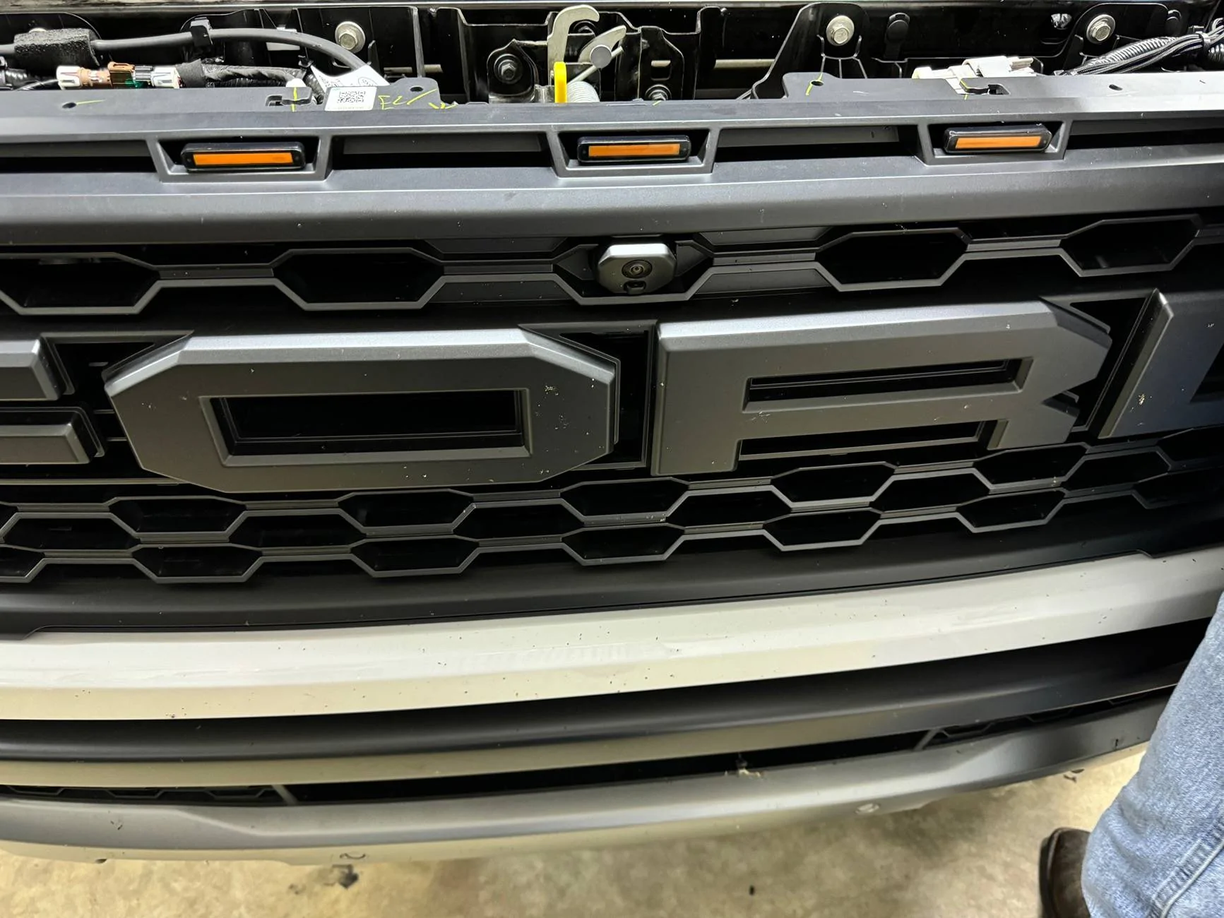

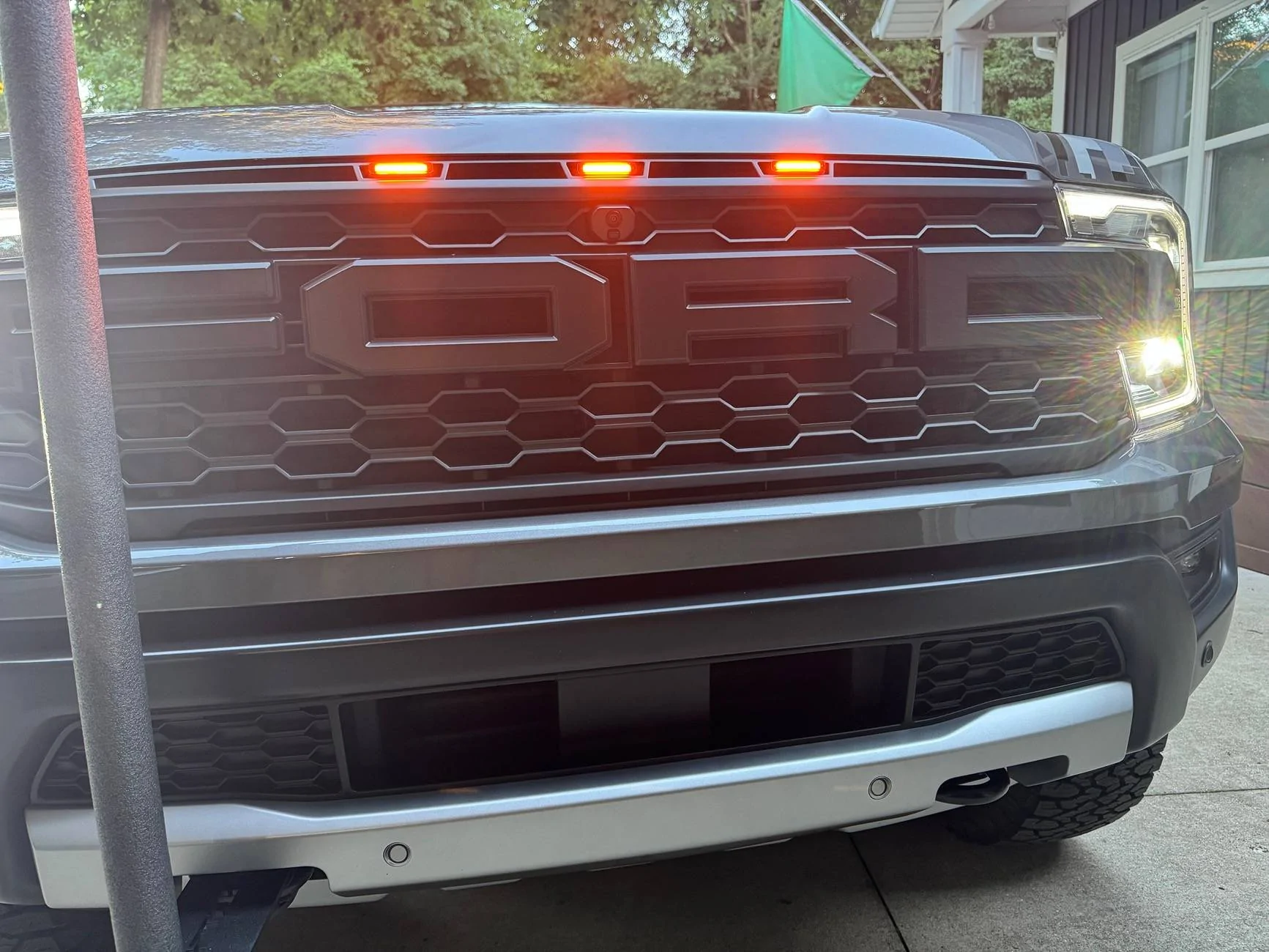

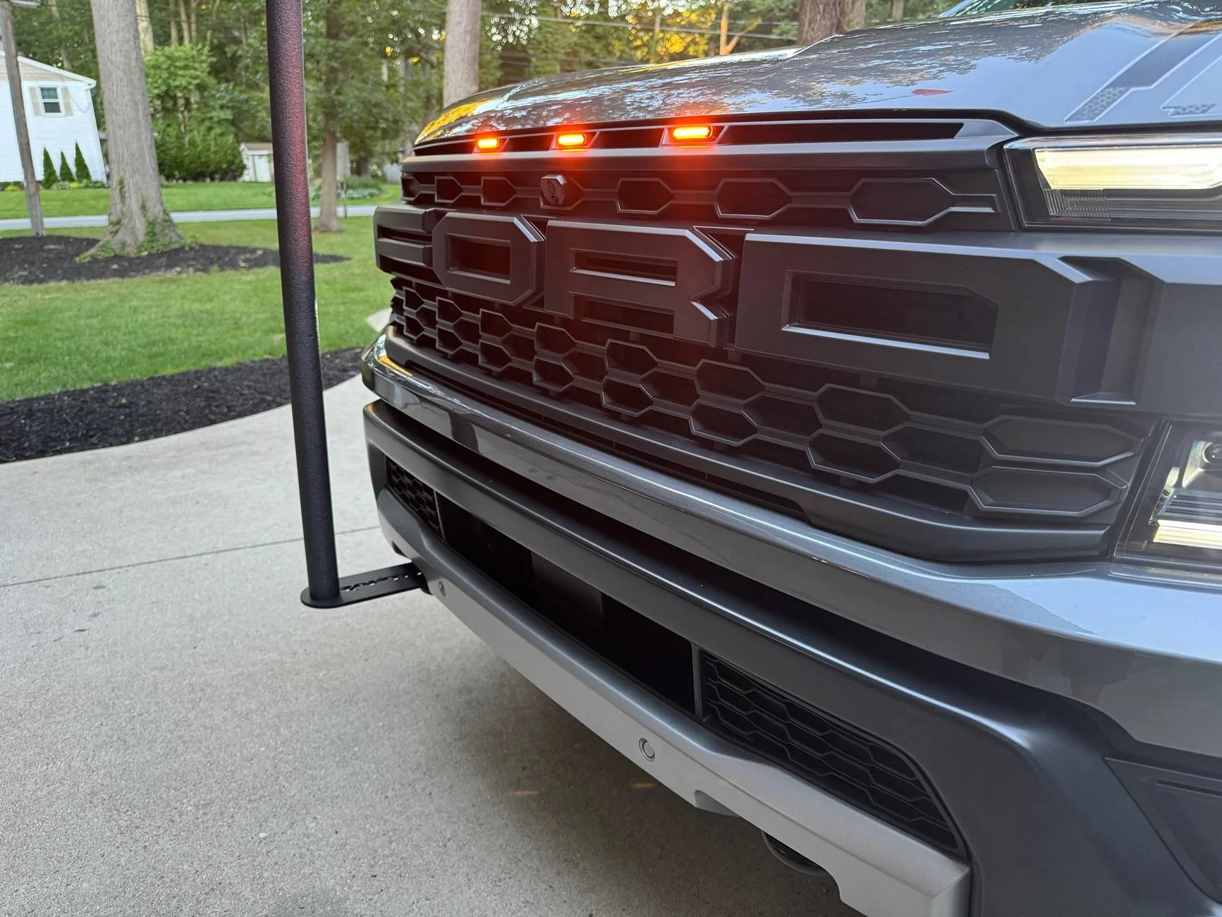

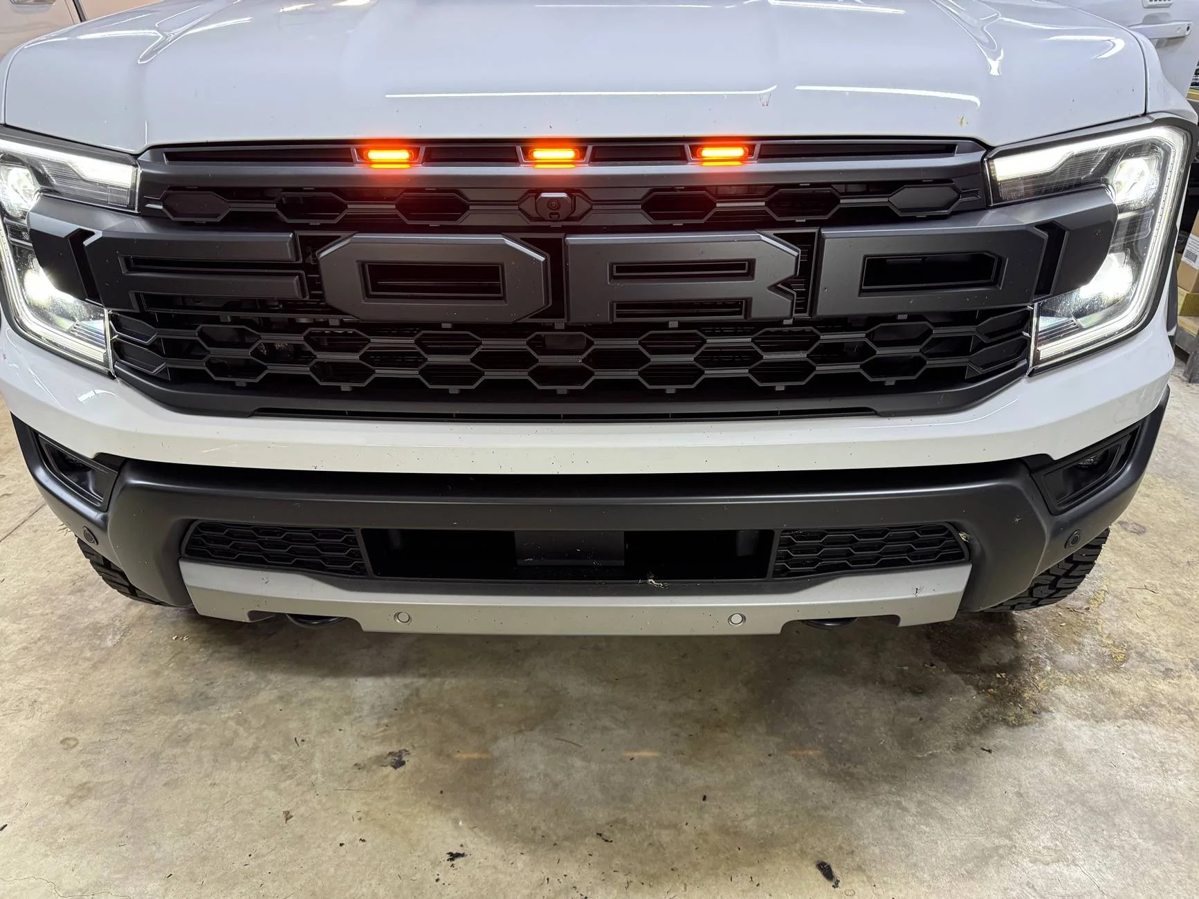

Here are photos of mine. From f150leds.com…
