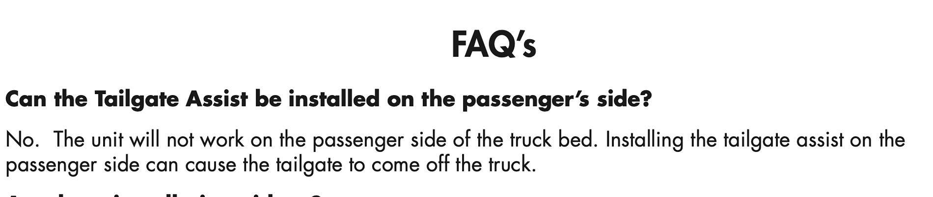

The 5G's didn't come with a strut, but the aftermarket ones explicitly tell you not to install one on both sides on their instruction sheets. I'm assuming it could bind when you try and close the tailgate?
Ford Ranger Anyone install second tailgate strut? Screenshot 2025-02-23 at 13.39.38
I didn't know that..thank you for the reply.
