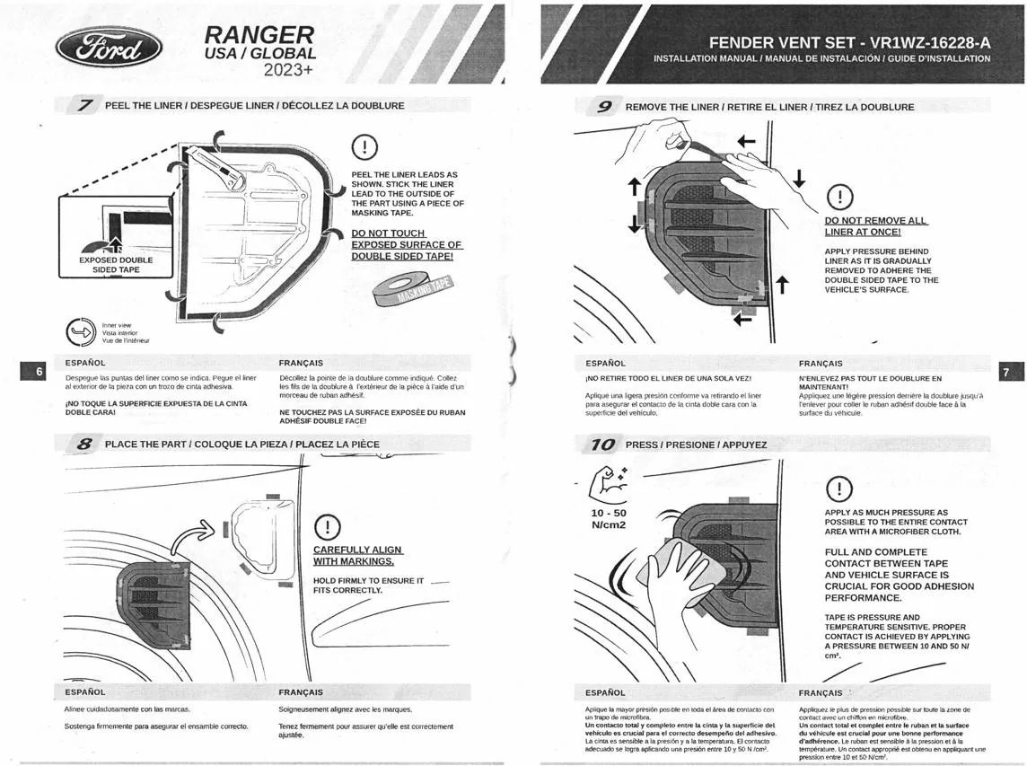

That's the reason I'm out on them. I like them but the original set clips in solid. These are 3M taped and much bigger. Not sure how well or how long they will last

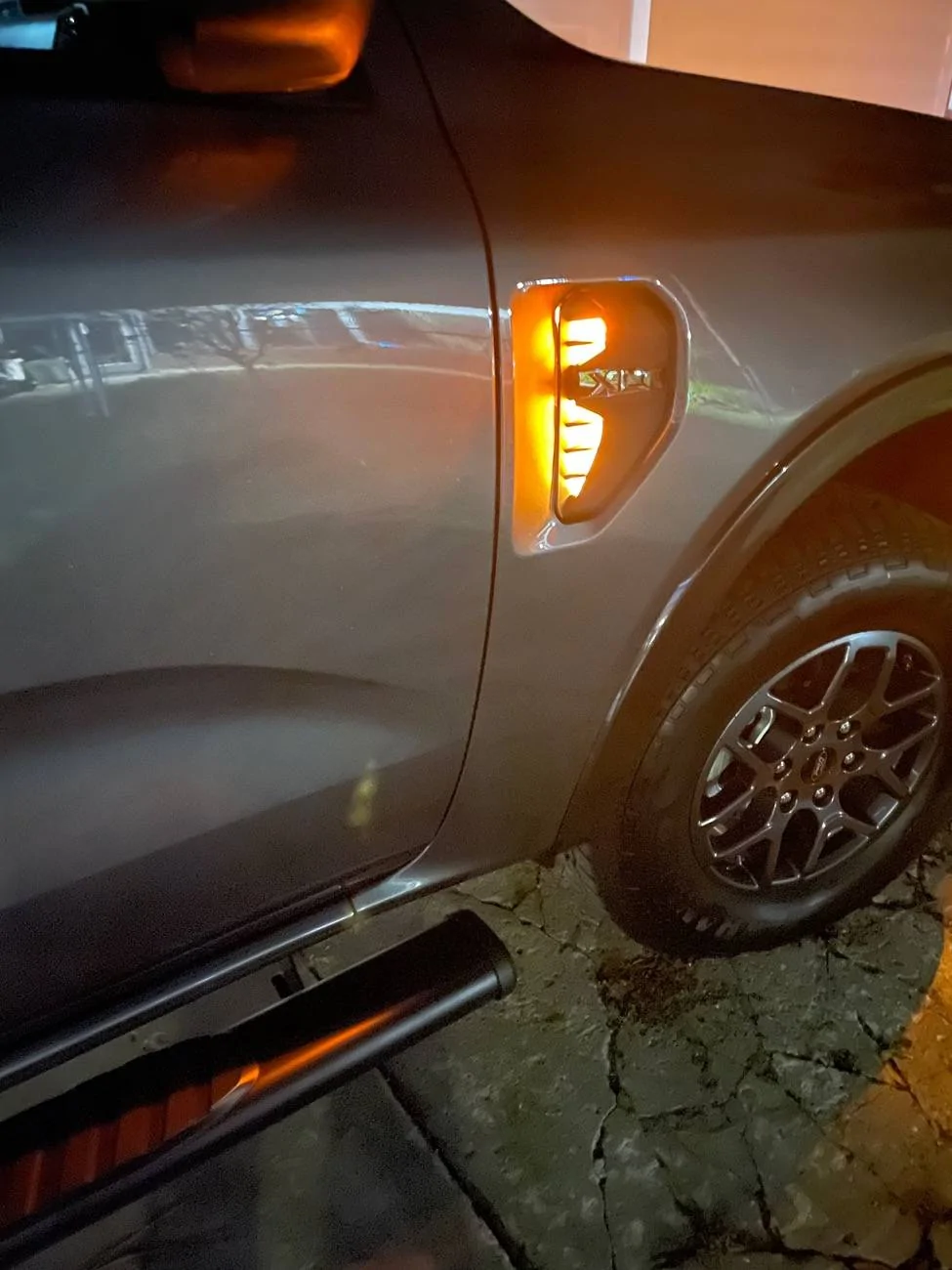

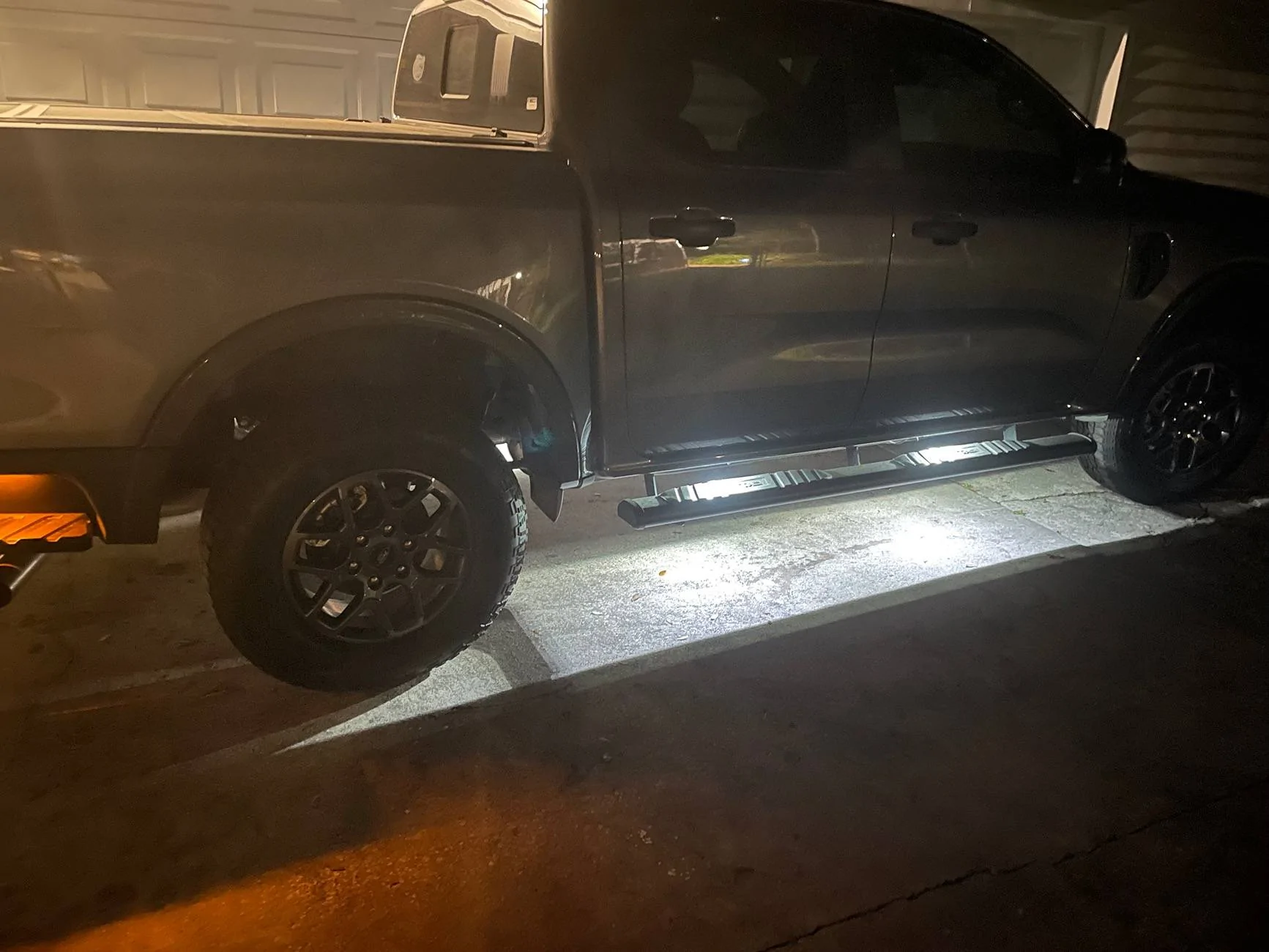

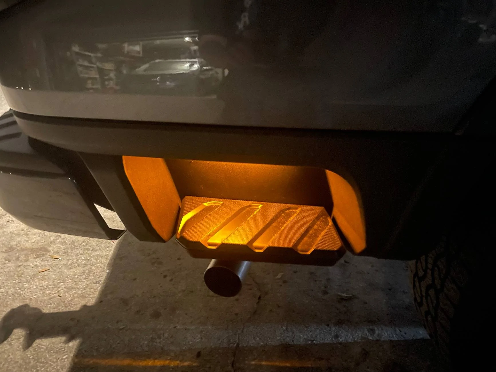

I suppose you could make them flash if hooked into the turn signal wires. I thought about using them as a power source for my bed side step lights. I hooked into my bed/puddle light circuit.
as to the “cheapness” of the original ones, I go through a car wash at least every other day and haven’t had any issues.
if you want them as marker and turn. you can get a diode Dynamics switchback module. I got one from my old build in my car that is in my trailer for the side markers. so they function as STT lights. markers and turn signals at night, and turn/brake in day time. then when backing up with 4 ways on the whole trailer flashes. you just got to tie the marker and turn output wires togeather. DD said that would work, when Ibasked them before I repurposed them for my trailer.

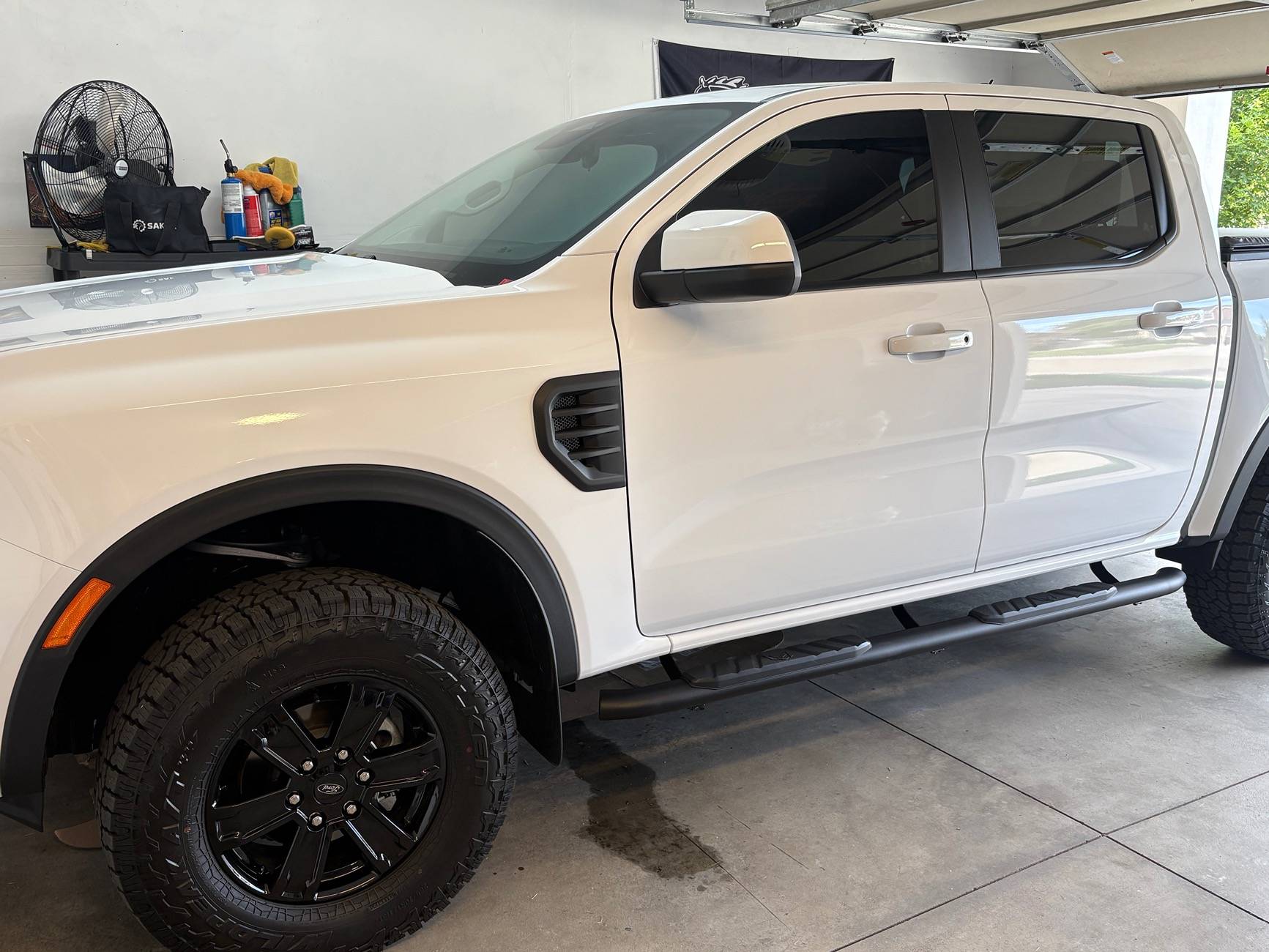

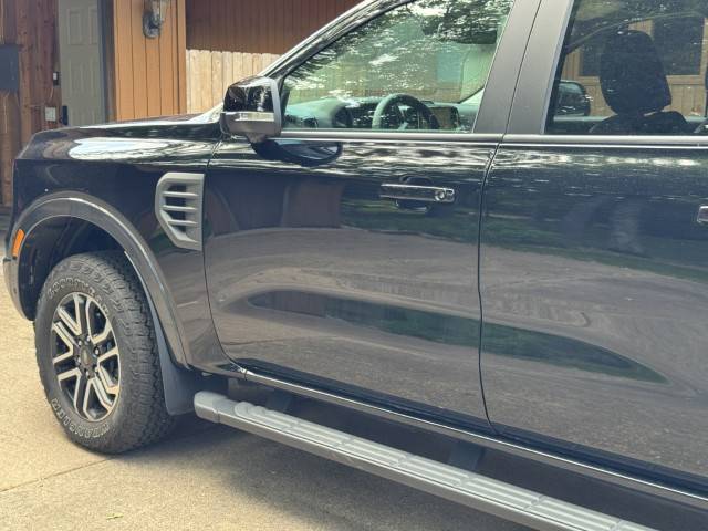

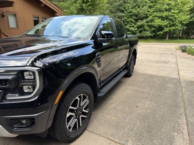

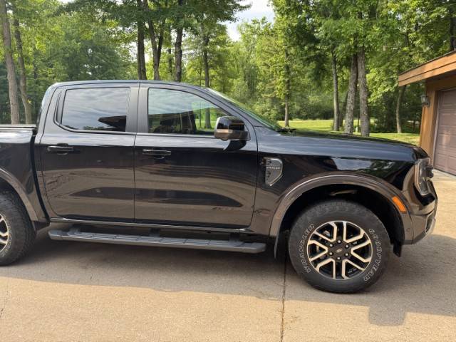

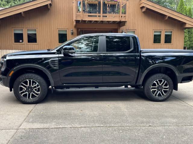

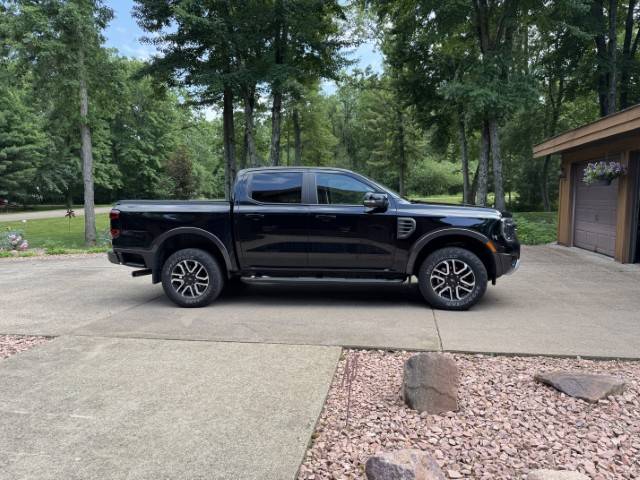

I finally installed these. Here are the before and after photos. It was super easy to do.
What do you all think? I'm on the fence.

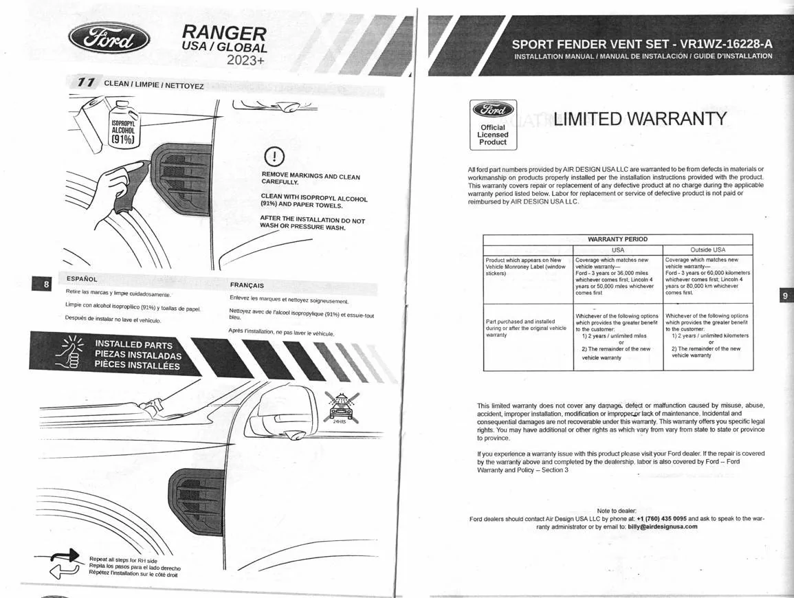

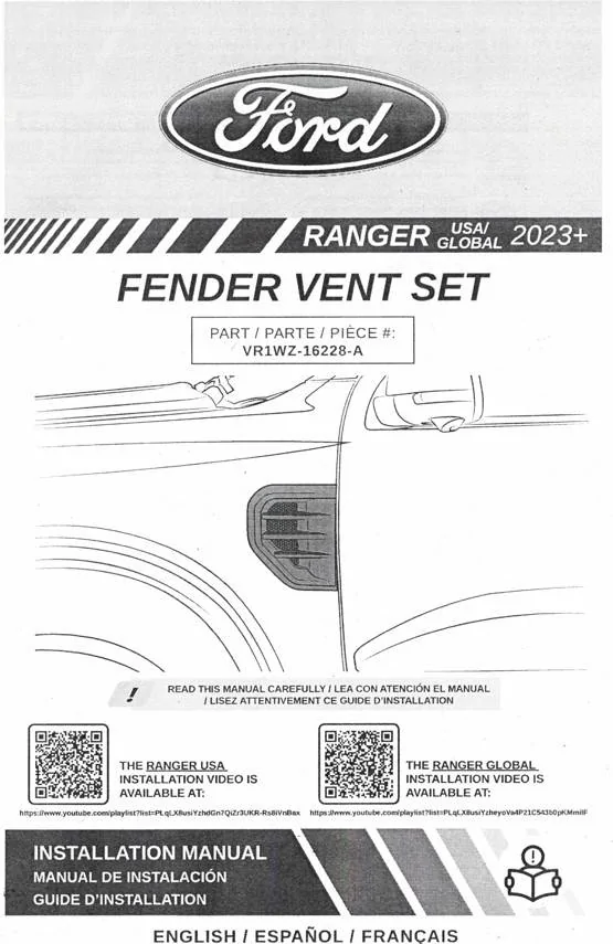

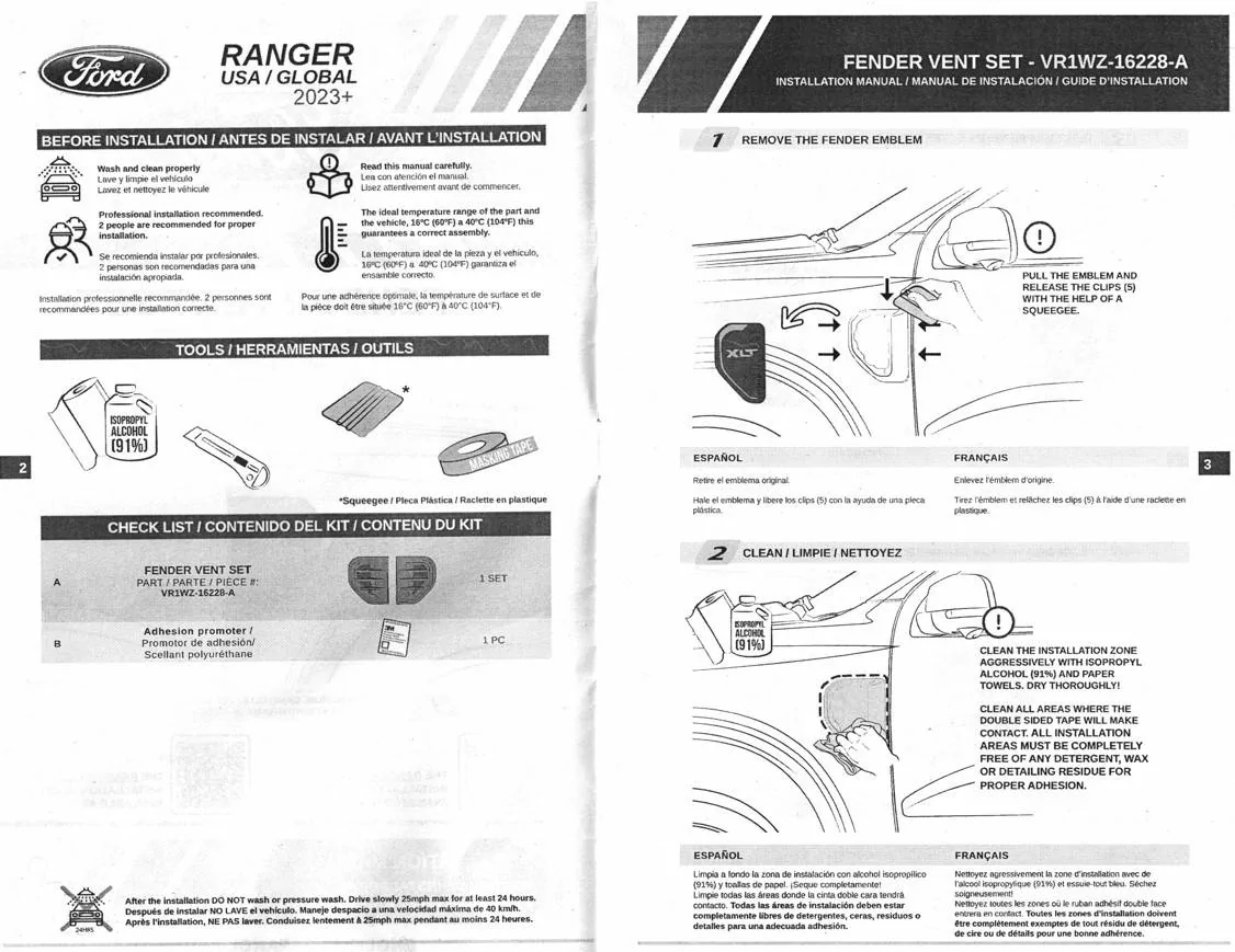

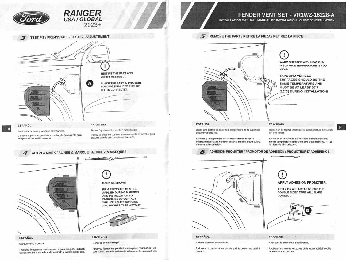

I installed them - pretty simple - they’re a little bigger than I anticipated but pretty happy with them
