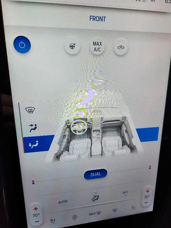

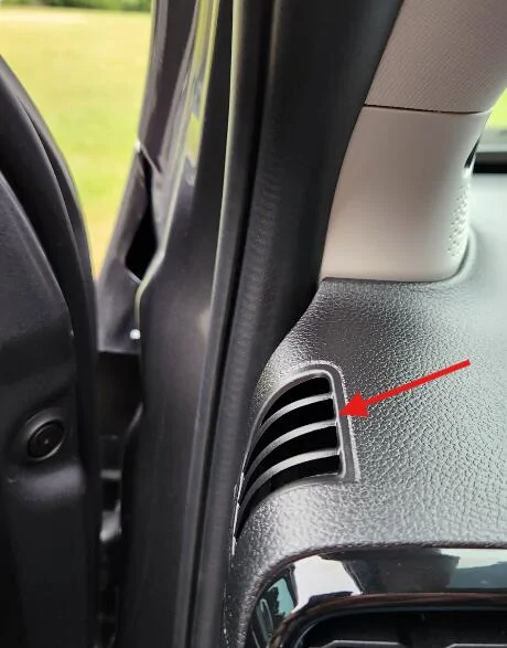

I just tested mine with the heat and cooling. My rear floor vents have very little air flow. I presume the only way to get air blowing out of the rear floor vents is to enable the floor setting as seen below. What seems odd to me is that when I set the air flow to the floor setting I have air blowing out of the door defogger vents too. ? Anybody else have that?

Not sure if anyone else is having this result when setting the mode to floor only. I'm going to reach out to Ford. It doesn't make sense that you set it to floor only mode and have high air pressure at the front floor vents and the front driver/passenger window defogger vents, and almost nothing at the rear floor.
I checked mine yesterday, its only with the floor setting as well to get movement out the rear vents. Its not much for sure, i do have the extenders to help get it out a bit further, but its still rather ridiculous.
Thanks Robert! Did you have substantial air blowing out of the side window "demister" or defogger vents?
As mentioned above, I also have the rear floor extenders and when selecting floor only, it’s barely pushing any air out of the rear. I do get some airflow out of the side window vents, but I think those are always somewhat active to keep the door windows from fogging.

I haven't reached out to Ford. I have deduced that the rear floor vents are not used based on the HVAC module programming. WHen the outside ambient temperature is high it will prioritize putting cool air higher in the cab, so the cool air will drop, which is good for air circulation to better bring the cab to a set temperature. The rear floor vents are likely only utilized for heat.
