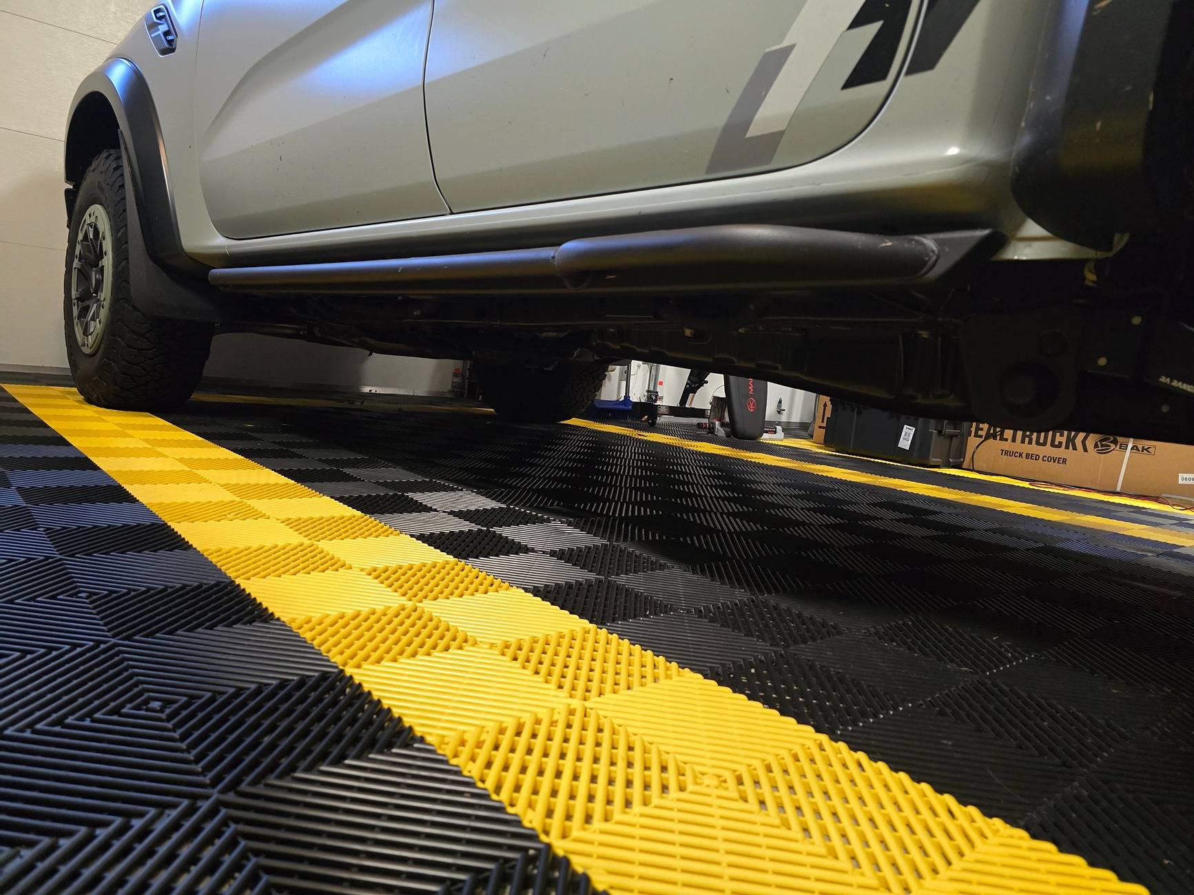

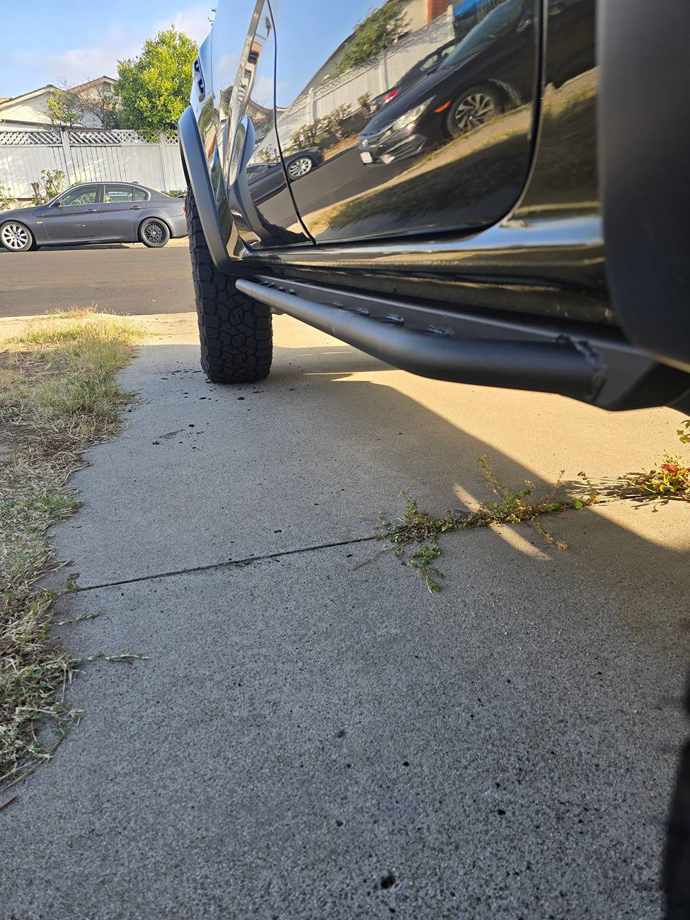

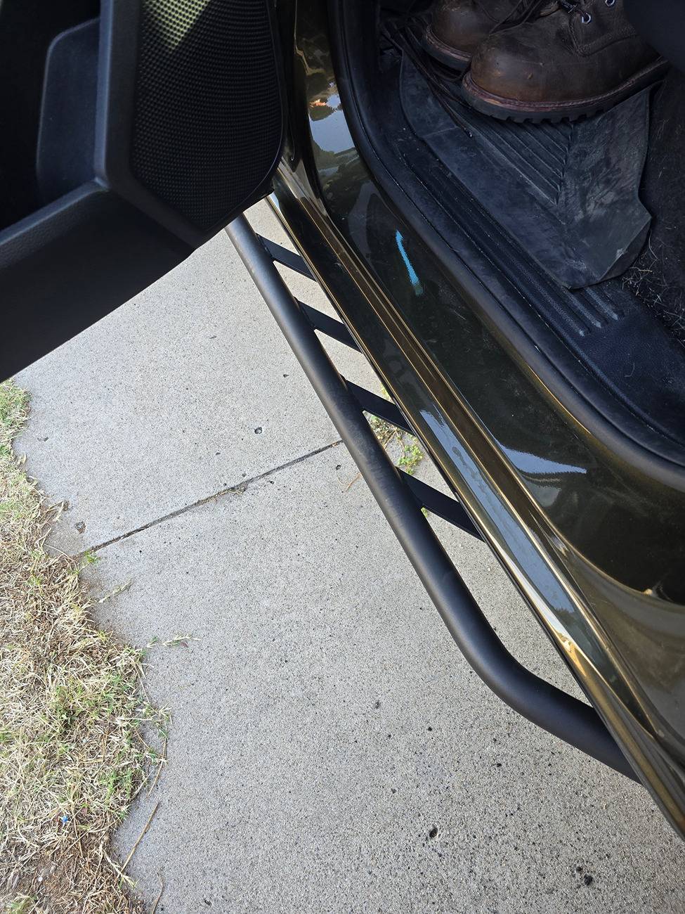

Installed my Rocky Road sliders today. Same 6 bolts as factory running boards, and 6 additional drilled holes and bolts for a 'heavy-duty' install that can theoretically take the weight of the truck. Fitup was flawless. Removed the OEM running boards and installed these in about an hour. Very easy. We'll see how it does off road.

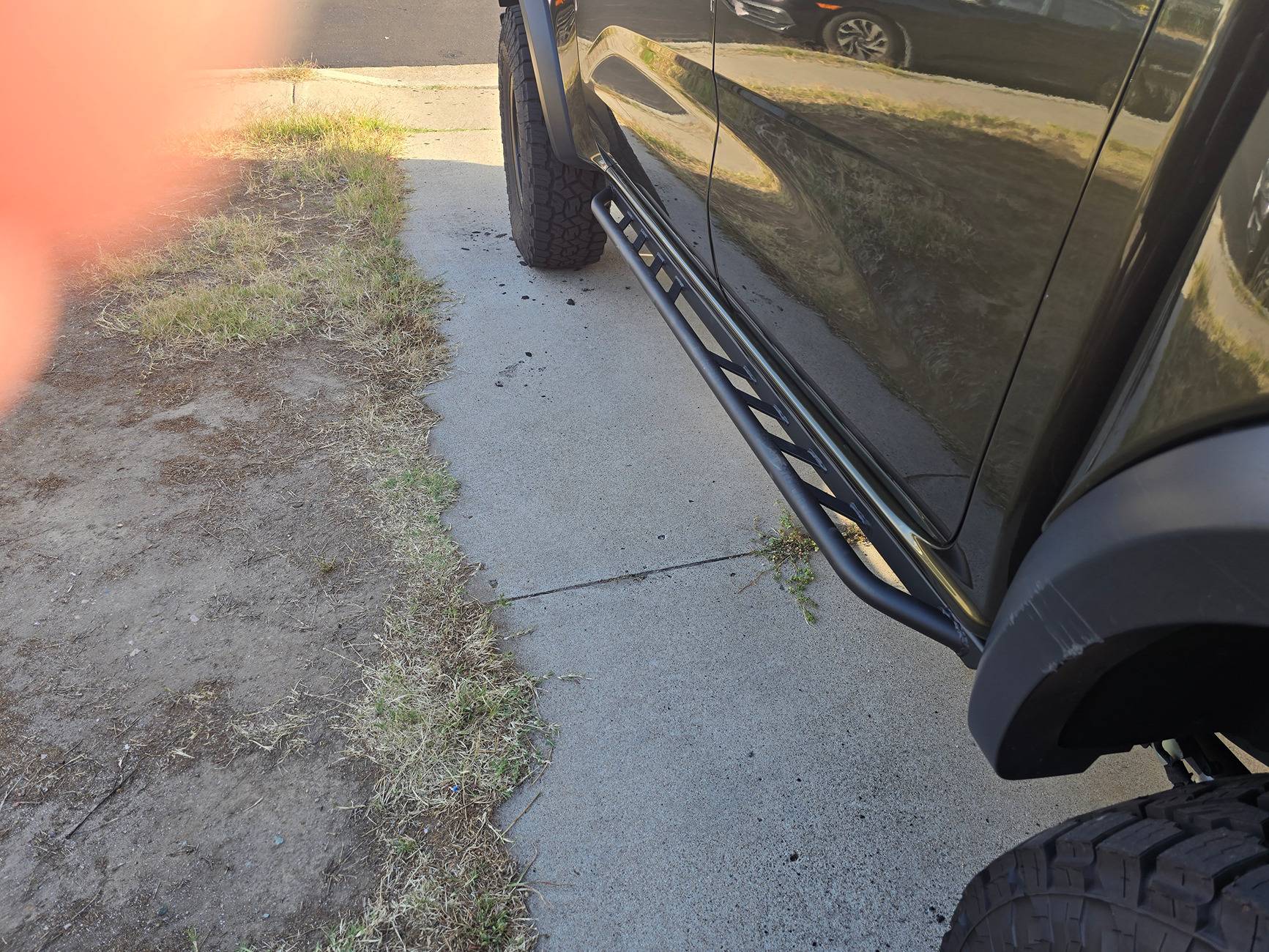

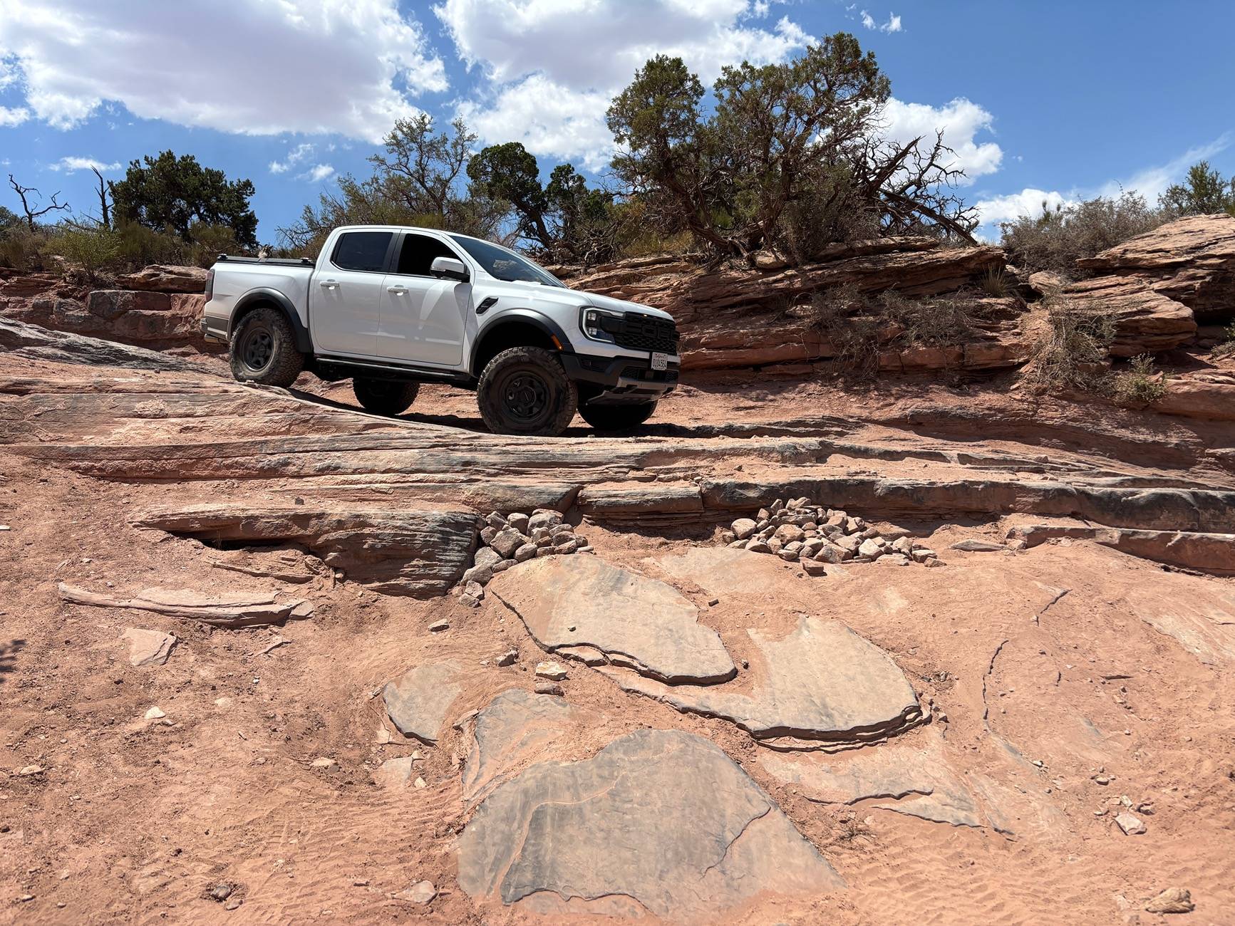

Tested mine thoroughly in Moab a couple weeks ago. Held up great, super solid.
I have the Super Sliders with the optional rock crusher package.
Had a set of these on my Grand Cherokee before I bought the RR and those held up great as well. The 2015 Grand Cherokee doesn’t have a frame, so that’s why I trusted they would be okay on my truck since there’s such a controversy over frame mounted vs. pinch weld mounted.

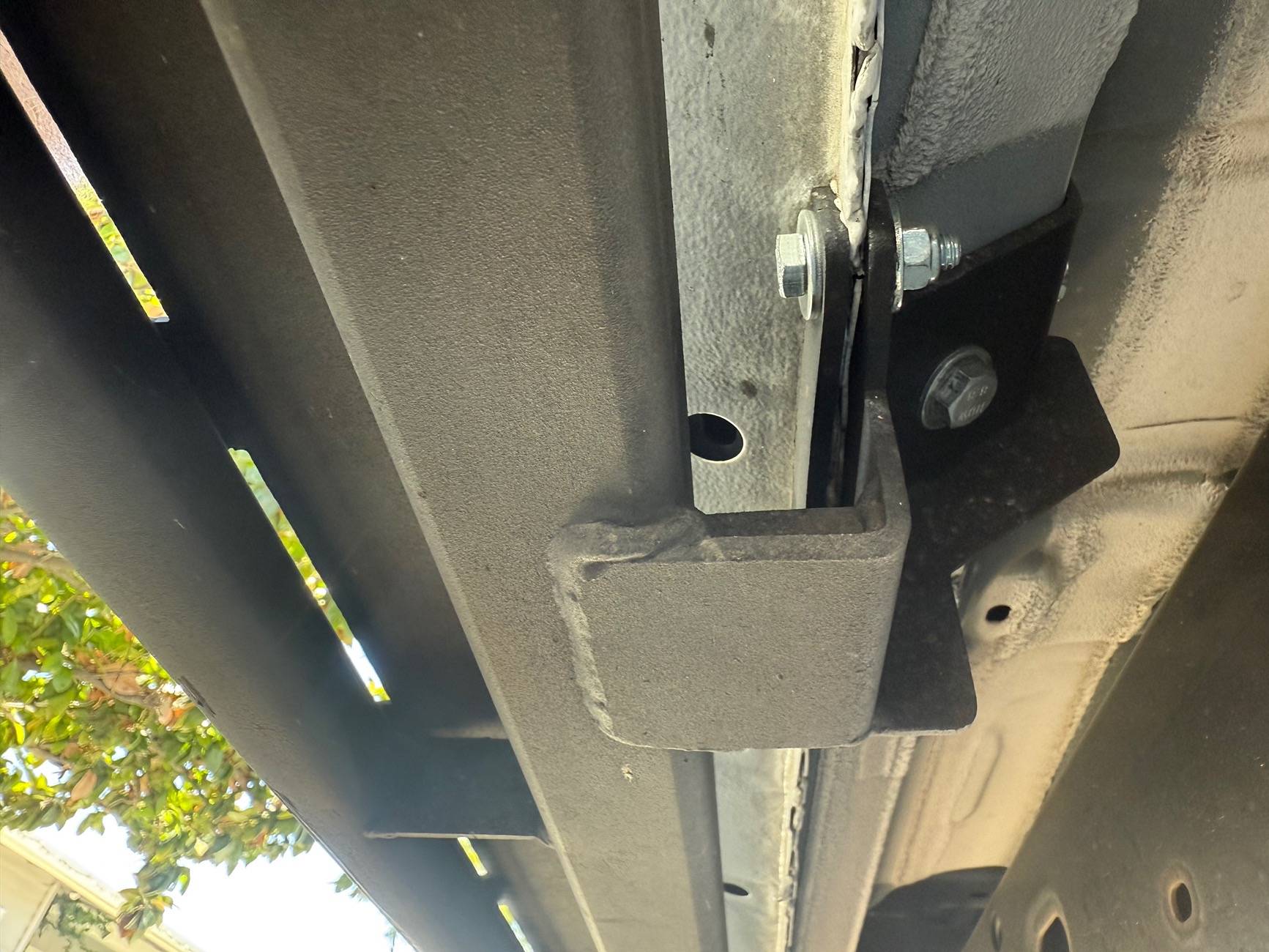

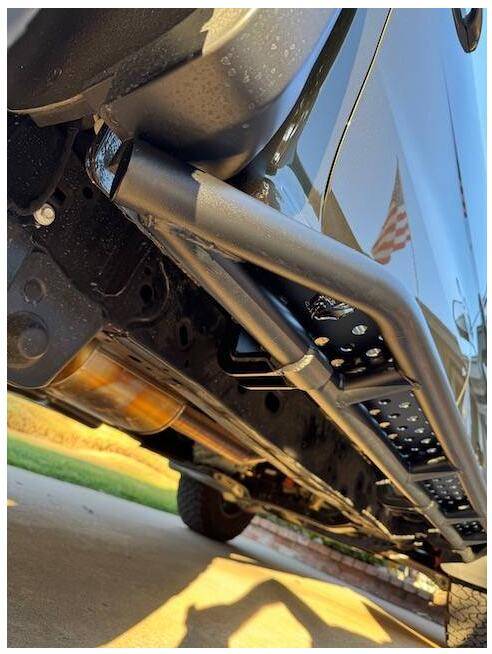

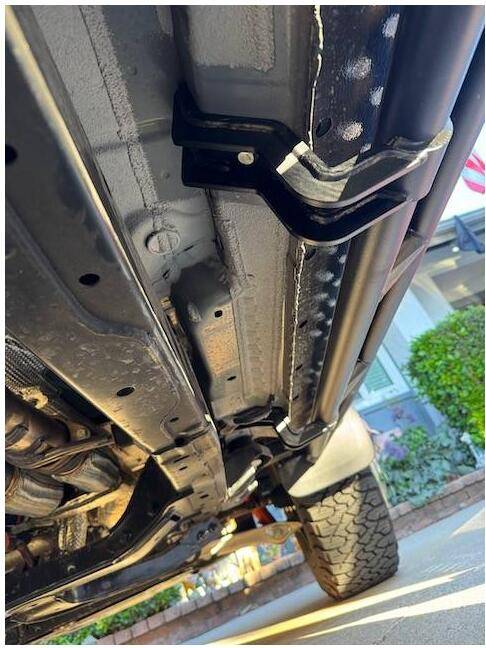

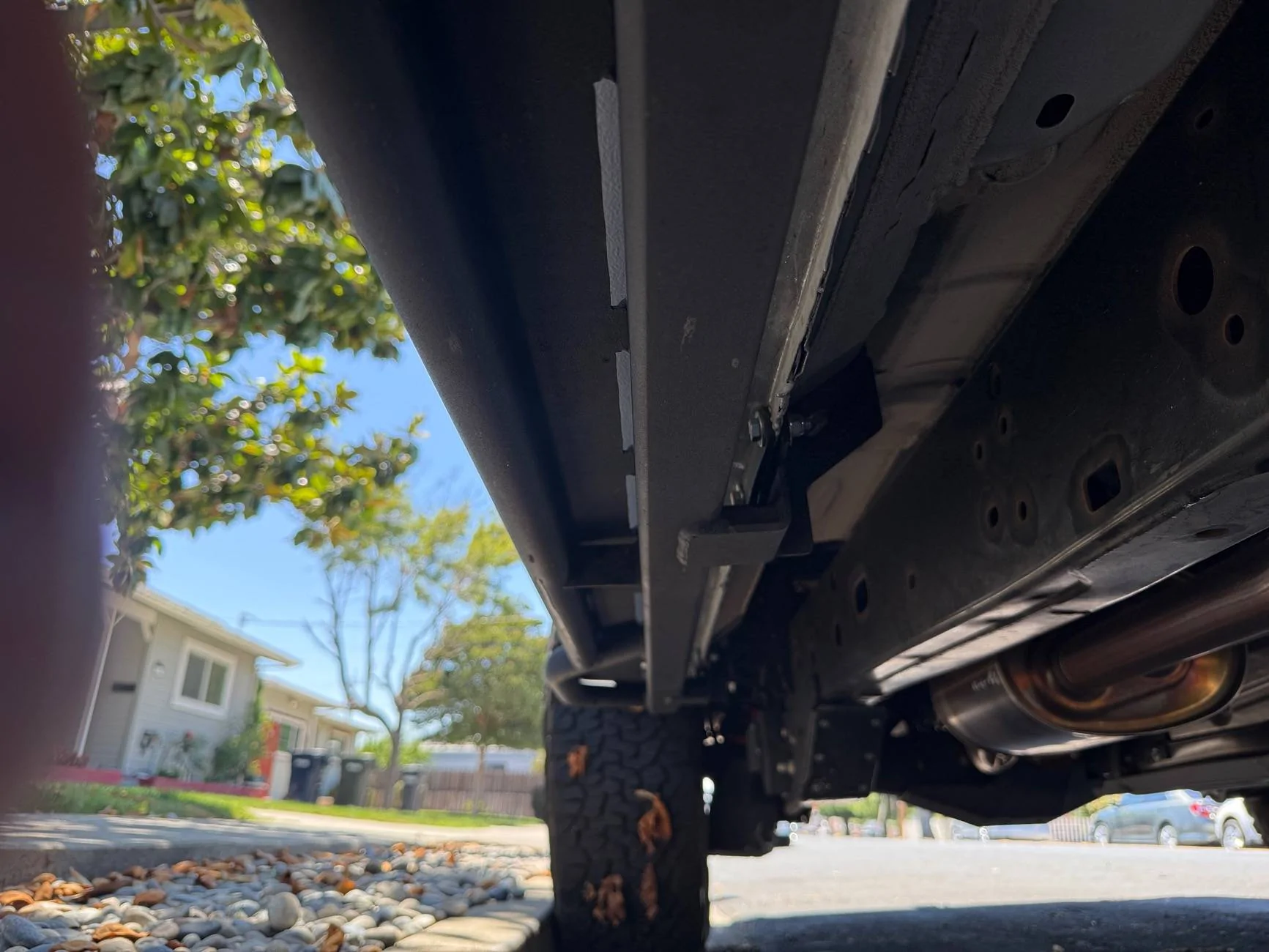

Would one of you that have these installed take a picture of how the main tube is mounted to the vehicle. Not where (body) but how the bracket on the body is mounted to the slider itself. I'm deciding between these and the Goat Fab sliders.
On the Goat Fab sliders I don't like how the bracket is under the main tube. I feel like that could get hung up. Thanks to @pappacrunch for the pictures of the Goat Fab sliders.

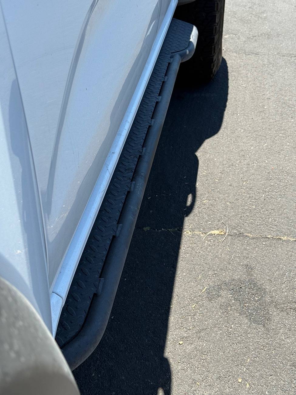

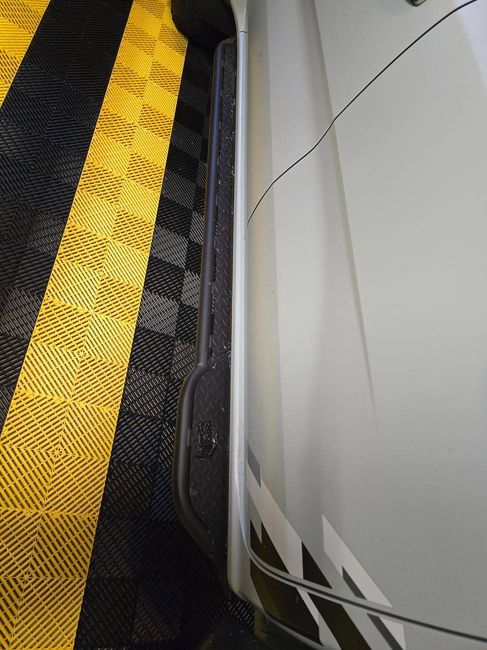

I made a mistake earlier, these are the Rocky Road Kicker Sliders with full cover panel and rock crusher package. Not “super” sliders. They don’t stick out as far as the stock running boards, but so far it hasn’t been an issue.

Thank you for the pics. I can't believe both companies would mount like that, or is it just me?

I parked and slid on mine in Moab several times and it felt really solid.
I had a set of these on my Grand Cherokee and they worked great.
Only comment I have is I wish they were a little wider, closer to the width of the stock running boards.
Since I am not a fabricator, nor do I know how to weld, I went with what I have had experience with and what I thought was the best available at the time.
