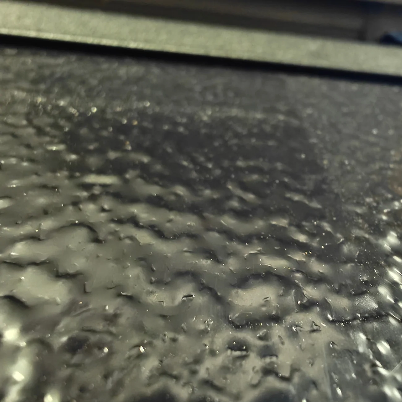

I ordered the Bakflip early on, I think it was the 2 and it was not correctly made so it went back and I went another route! The panels were not thick enough to fill the rails they were put in. A gap existed on both sides! Not a flat surface. I had one on my F150 why I tried them.
Ford Ranger Bakflip MX4 Gen 3 Cover Troubleshooting IMG20250801125140
