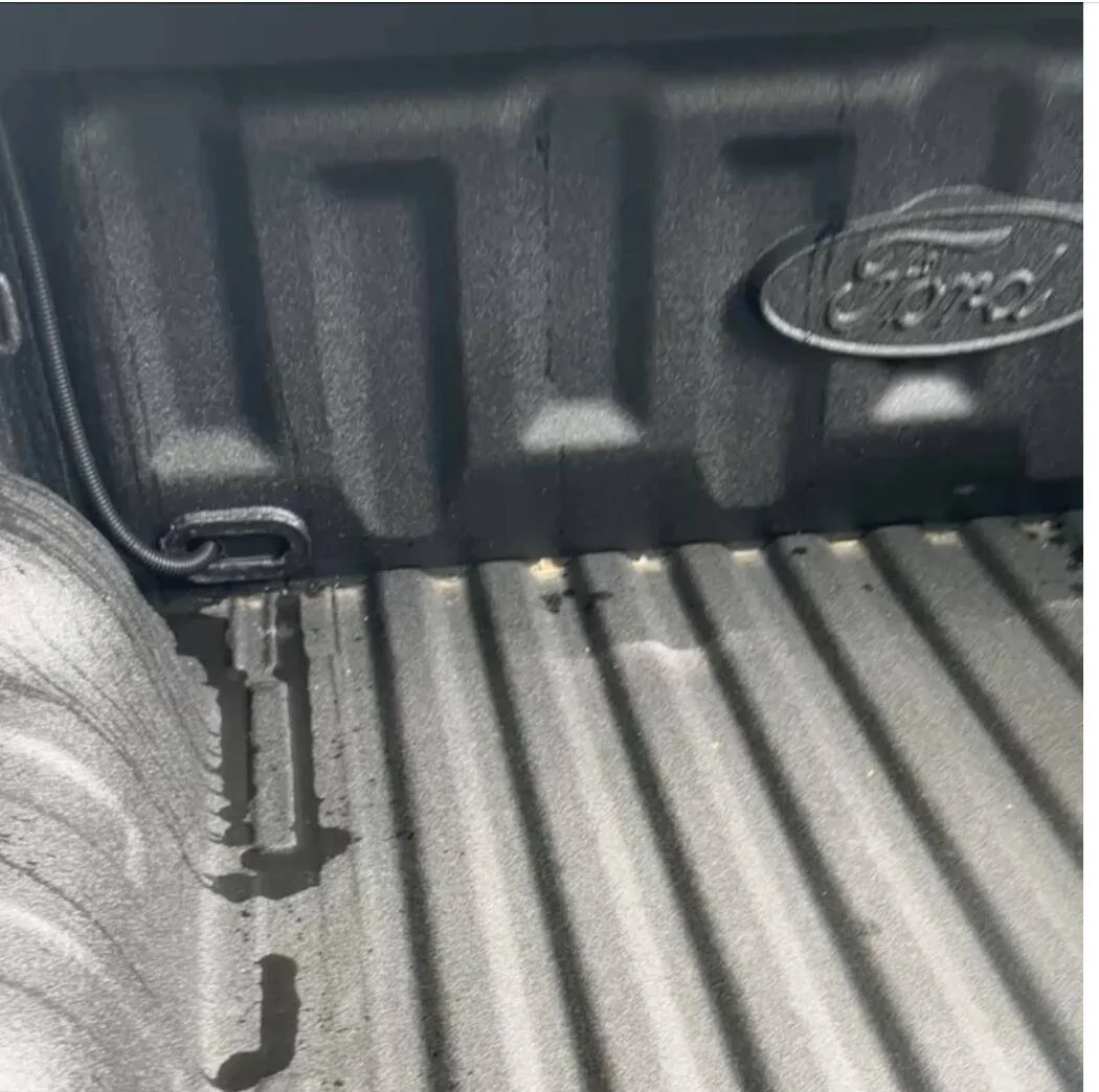

I have an aftermarket spray in bed liner. Where did you run the drain hoses with this bed cover? My Bakflip MX4 just arrived today. Thanks!

My spray in liner is from Ford. At the front of the bed(bottom left and right) you can remove the plugs(?) and replace them with the ones that come with the liner(I got mine from Ford but I think yours is just about the same). Then run the hose out through them.
Ford Ranger Installed Ford Branded BAKFlip MX4 Tonneau Cover on XLT FX4 Ranger Screenshot 2024-07-11 at 5.48.28 PM
was there any issues when you removed the plugs? my bed is also sprayed on from the factory but i'm worried if try to take off the plugs it will mess up the surrounding bed spray.
Not if you are careful. The plugs are sprayed like the rest of the bed so I used a sharp knife to cut around the edge before I removed them. It didn't seem to harm the sprayed on bed liner. The spray on the plastic plug did come off easily So I took the edge part(see photo) and glued it to the new plugs that came with cover. The cut out to run the tube through was a bit big so I used a rubber grommet to give it a tight fit. I hope I explain that ok?
perfect, thanks for the tips.
