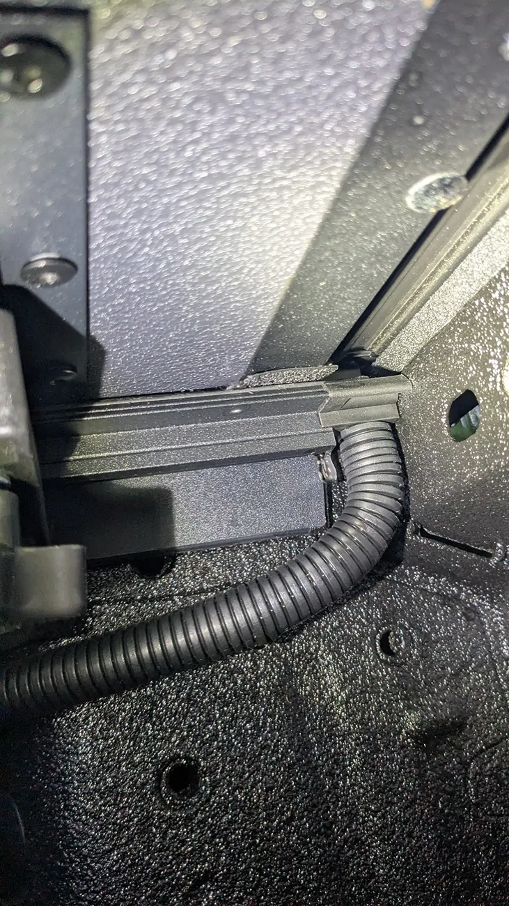

1. Randomly leaking at the back two corners closest to the bulkhead (PHOTO 1). It was leaking from somewhere on the tonneau cover that I couldn't quite tell, then dripping onto the drain hoses and down those. That one I can honestly live with it since it's at the back corners where it should drain out the bed anyway...

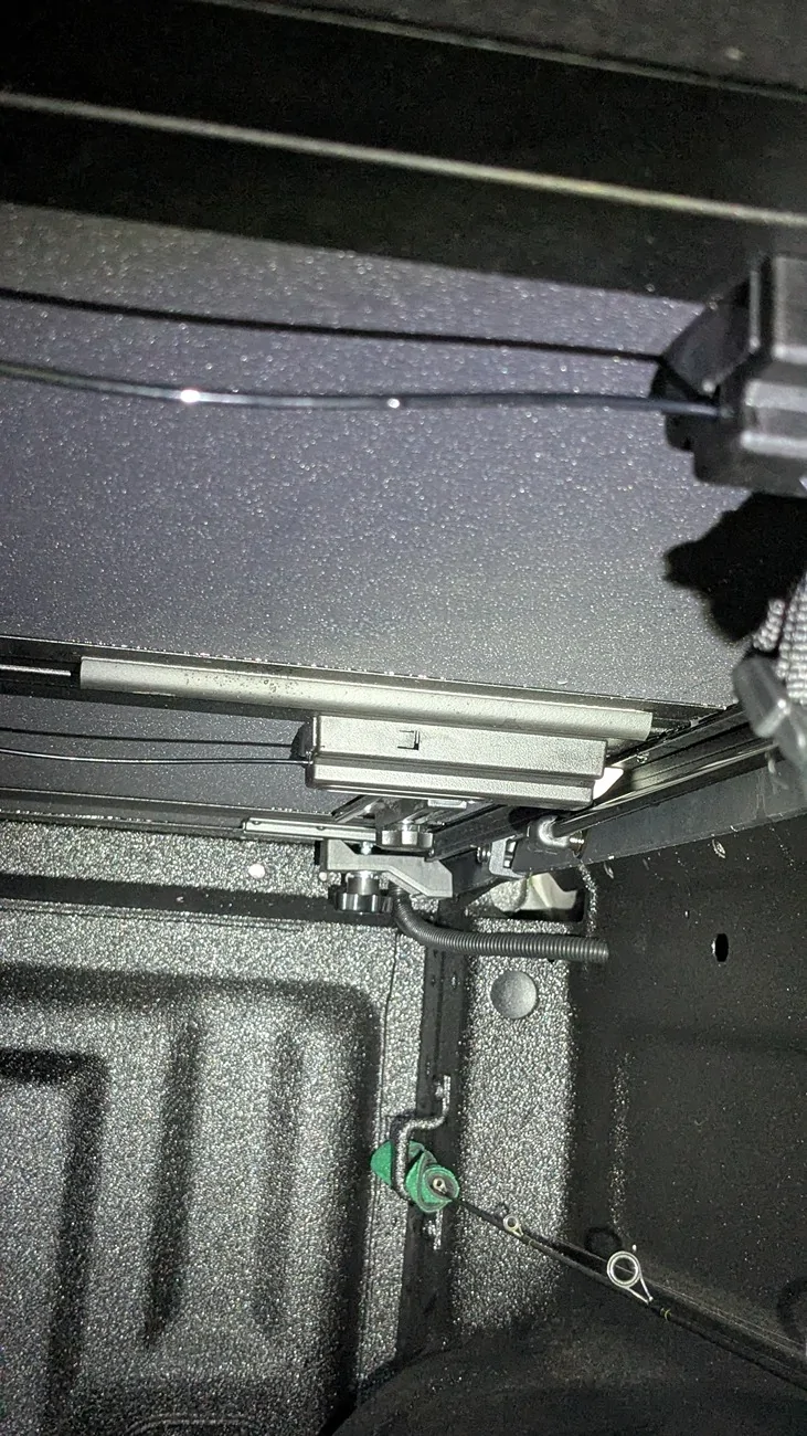

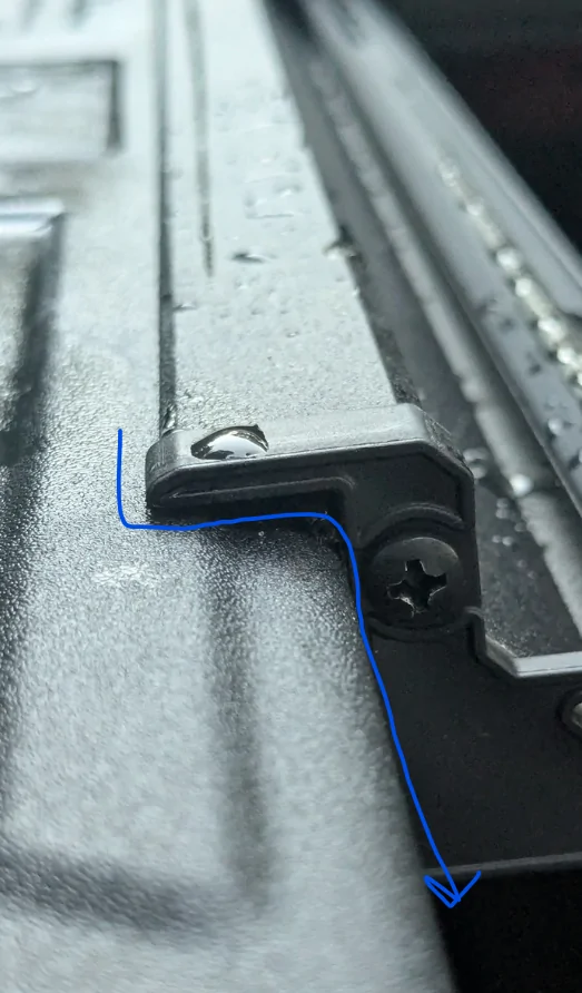

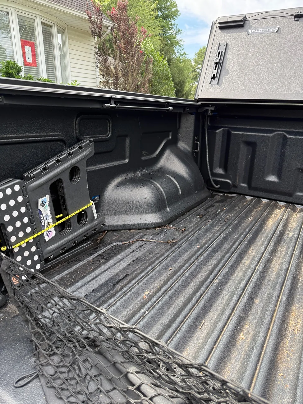

2. Leaking between the rail and bed rail covers (PHOTO 2). This one shocked me but I was able to completely confirm it. There is a very thin foam gasket where the rails meet the bed, but apparently it isn't enough. It seemed most prevalent where the bed rail cannot fully be flush against the bed rail covers, as they have raised areas. The leaks were mostly coming from where there was a gap between the raised areas and the water was making it's way through the gap, and down into the bed behind the rails. Only thing I can think to do here is uninstall the rails, and find a thicker foam gasket tape to put onto the rail and compress that as I reinstall...
In the photo I tried to outline how it is leaking with a photo from the end of the rail. Just to be clear, it is NOT leaking at the end of the rail but across the entire rail at various sections. Photo just to help illustrate it.

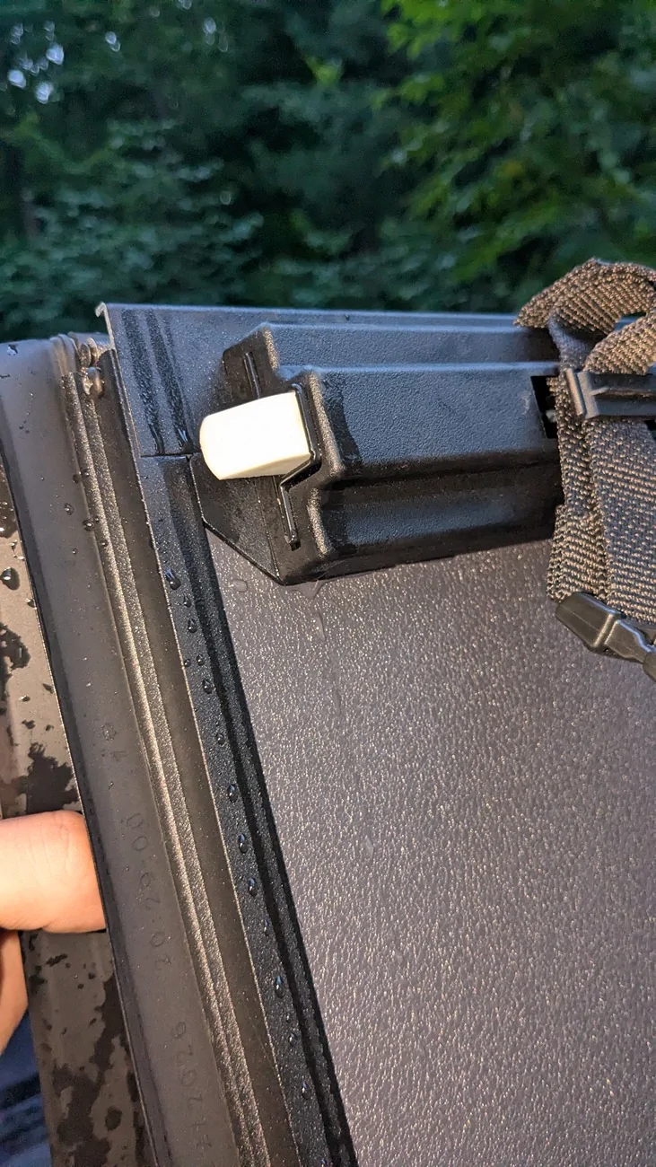

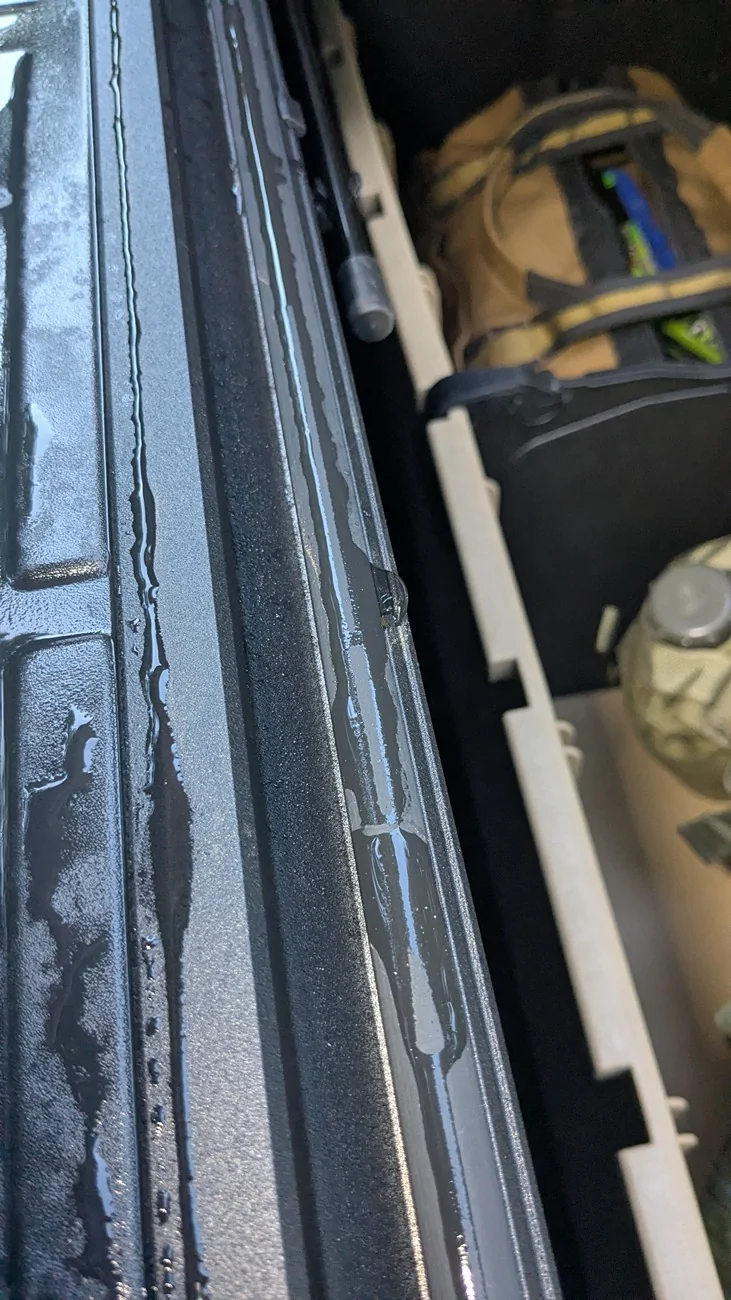

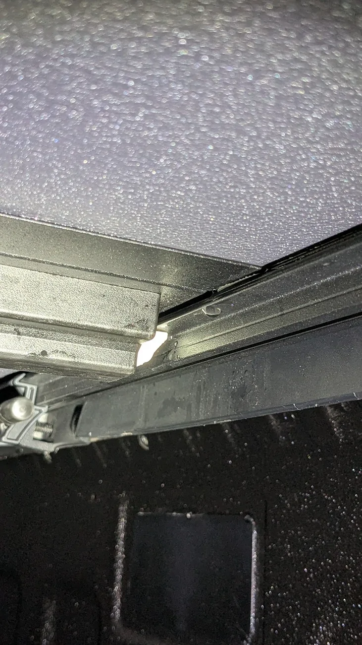

3. Actually leaking past the rubber seal on the top of the rail where the rail meets the tonneau cover panel when closed (PHOTOs 3 and 4). This was the most shocking. If you look inside when the tonneau is shut, the panel does not sit tight at the hinges against that rubber seal. As a result, when a lot of water goes into the rail drains it seems to exit out this opening at each seal instead of staying sealed and moving down the drains. This is what made me originally think it was the seams themselves leaking when it actually is not: the water is just running out that hinge opening, hitting the seams and latches, and running down those. Unfortunately this one seems just like a design flaw rather than a defect in my cover specifically. Also seems like it would only be an issue during heavy rain when the drain rails can't keep up. Think like a small gutter during a big storm overflows: it's overflowing out the gap.
So that is where I'm at. Leak 1 (near bulkhead) seems minor and I can live with. Leak 2 (between bedrail covers) I may be able to fix myself if I can find the right foam gasket tape. But Leak 3 unfortunately seems inevitable.
I think my fix will be to focus on Leak 2 and uninstall the rails (again), get some proper foam gasket tape and seal where the rails meet the bed, and reinstall.

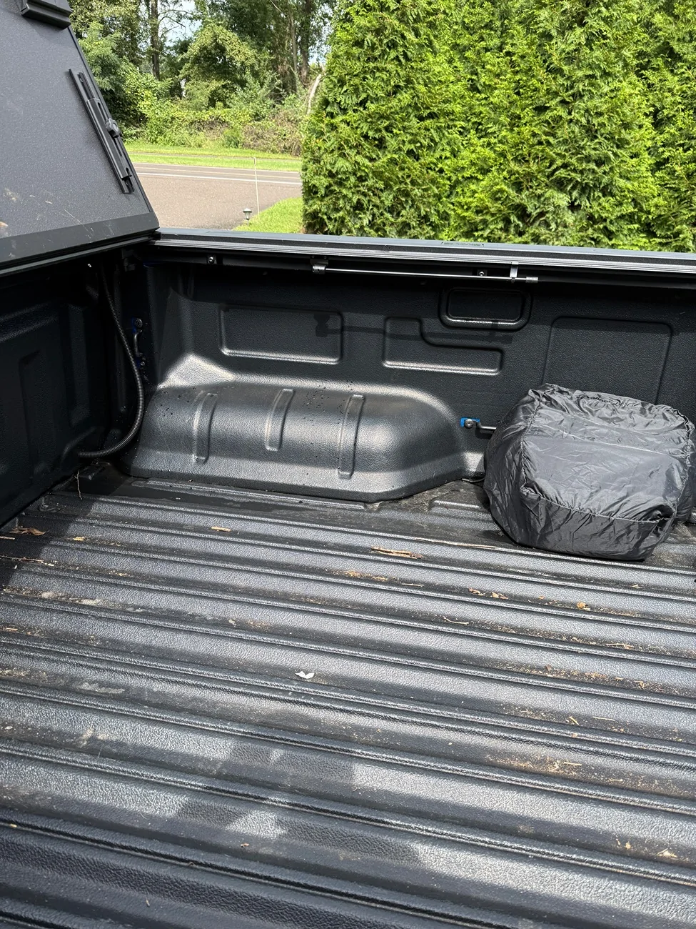

It rained here last night and I got water on both sides. That's while parked; I never moved.

My leakage is strictly on the sides.
