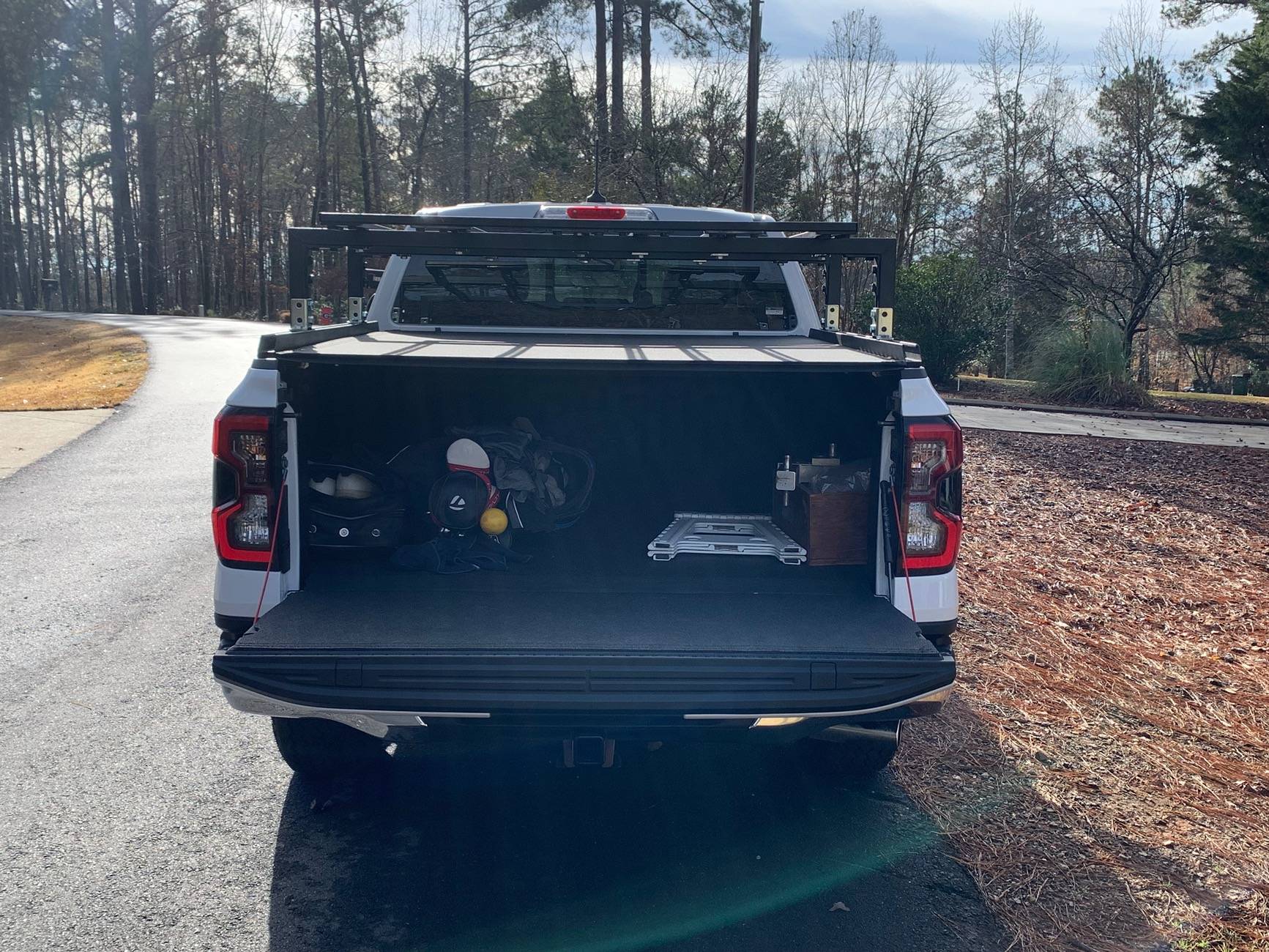

mine does not leak at all. However, I spent a lot of time plugging all the holes and installing a tail gate seal.
Does your tonneau cover say Raptor on it? Is it a retractable cover?
GLW
May 26, 2024
477
536
Missouri
I added the Raptor badging to a retrax xr pro cover.

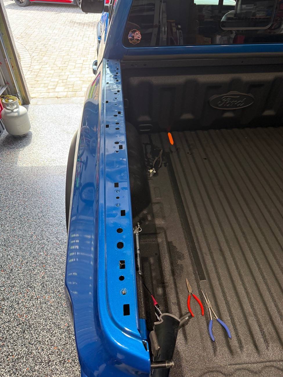

This is why the Rangers bed gets wet. It’s best to take the plastic covers off and seal all the holes with vinyl.
It will still leak water through the stake pocket caps and some through the sides of the trim even after sealing all those holes.
I've found using (neutral curing) silicone on the stake pocket caps and between the outside plastic trim and top of the bed, eliminates the need to seal all those holes.

So you do not need to remove the bed caps to do this? Just squirt it up under the outside edge of the caps and around the stake pocket caps?
D. Sampson
Dana
Jun 10, 2024
81
79
Albuquerque, New Mexico
2024 Ranger Raptor - Shelter Green Metallic
That's what I did and it worked. I used blue painters tape - masked the trim pieces and masked the top edge of the bed, and carefully applied neutral curing black silicone in the gap. I then carefully filled the gaps in the 6 stake pocket caps.
I also used Gorilla Waterproof patch and seal tape for the larger openings at the front left and right sides near the bulkhead - one large strip each side on the inside, and one strip on the outside. I also have a seal kit for the tailgate (just the Keko - has worked fine for me so far). My tonneau covers the stake pockets as well, so that's aided to keep water out.

I have the tonneau from the thread linked below. There's pictures of mine in that thread, if you zoom in you can see the black silicone between the trim and bed. The gorilla tape isn't visible, it's way up near the bulkhead covering the large openings on the left and right. Some people say they've shoved a tennis ball in the openings to prevent water and dust from coming in.
