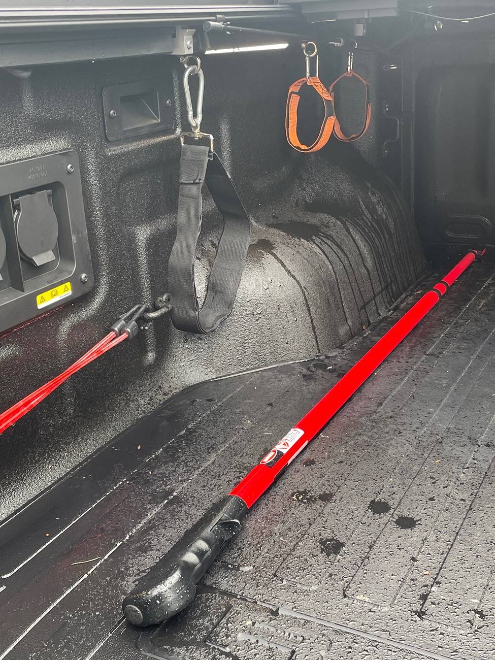

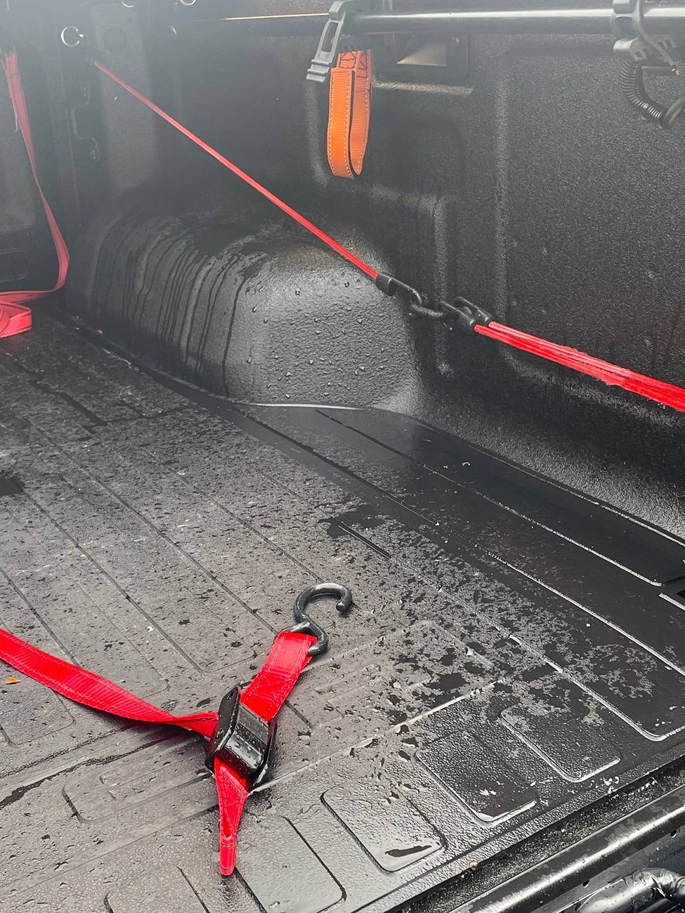

As I mentioned, I have the Rev folding from FORD, I took these pictures this morning after 2 hours of heavy rain and right after I went through a high pressure car wash. I would call this pretty minor and I haven’t done anything yet to seal the bed.
I would call that pretty major.

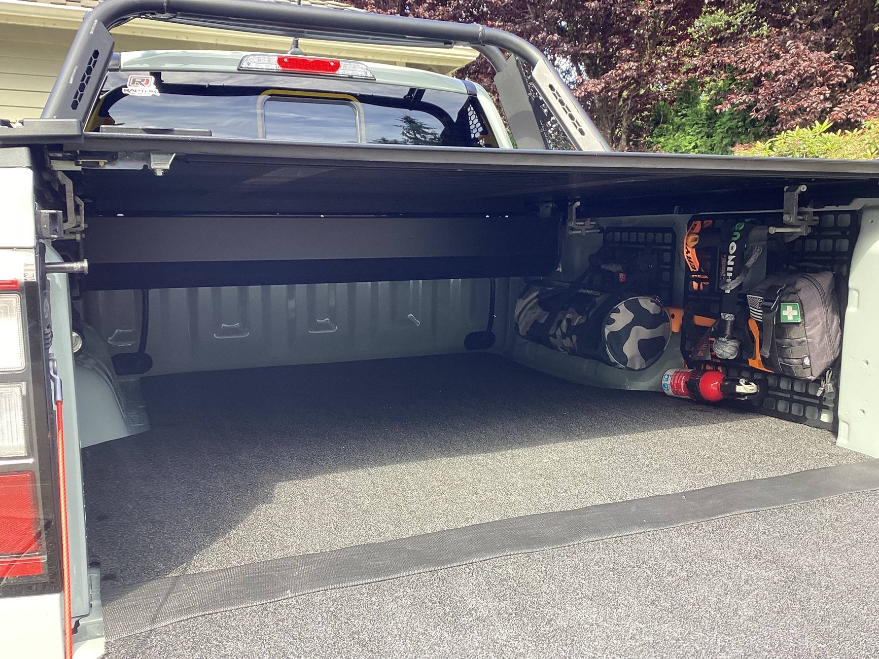

MichBadger
Jul 7, 2024
SE Michigan
2024 Ranger Rapto
Thank you for posting these pictures. I believe that we have the exact same cover, branded with different names. I could post my pictures that look the same, or slightly worse. I agree that a lot of what you are showing is from the stake pockets and plastic cap not being sealed. My issue is that the I can show a fairly steady stream of water coming from the mechanisms and joints of the cover. As we had an all day rain again yesterday, I did more study and realized that some of the flock tape near the joints appears to be a weep path to draw water past the side seals, towards the mechanism. I will remove that, and see how much it improves.
Again, for me, I'd prefer a solution that is significantly more dry. To the point I can put my golf clubs or a soft suitcase or duffle bag back there and I don't have to put it in a dry bag. Obviously, my expectations are different, and maybe unrealistic, but I'd like to figure out something better than what I have now.

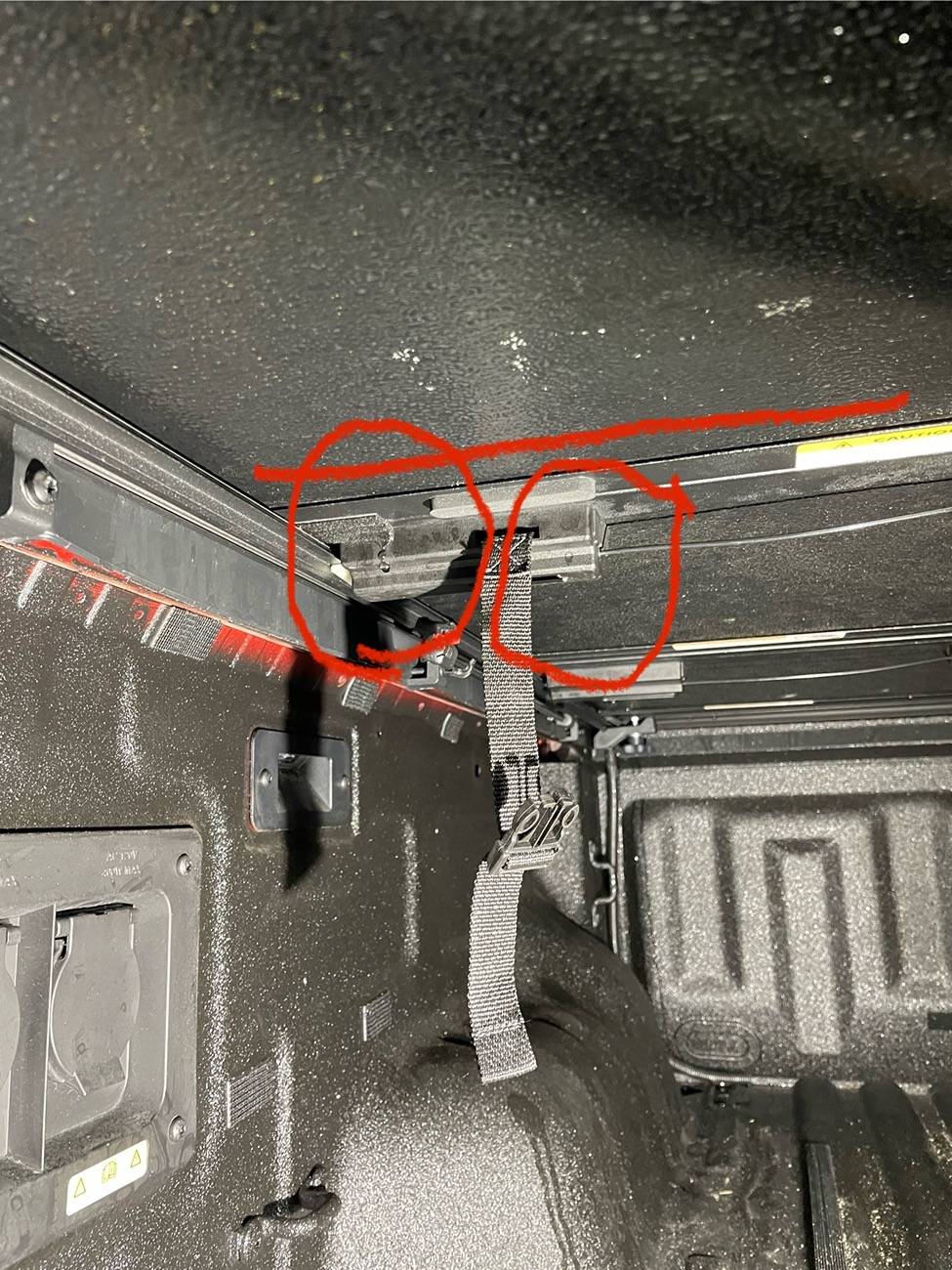

Bill
Nov 4, 2024
McCormick, SC
2024 Ford Ranger Lariat FX4, 2021 Mazda Miata GT RF
Retired Engineer
Like others have said, I would get with your cover manufacturer to start with if water is leaking through the panels. One area not mentioned is the bed caps are not level, they are sloped at the front and back which can present an issue when installing the cover rails where they contact the bed caps. I had to install an extra piece of weatherstripping along the edge of the bed caps to seal where the rails make contact. I purchased weatherstripping that was 5/16 wide by 1/4 tall. This solved the issue with water leaking from the under the cover rails. I have the TruXedo Sentry CT cover, but I would think most covers only have rail weatherstripping that is less than 1/8 inch thick based on the various other covers I‘ve had. Also, the stake pockets leak water and need to be sealed. If you put a straight edge on the bed caps you will see about a 1/4 inch gap at the front and back.
I had a trifold cover in the past where the water got under the aluminum and soaked the styrofoam and ruined the cover. So I definitely would try to handle this while the cover is under warranty.
Noticed you have a sprayed in bed liner, I installed the Bed Rug impact mat which closely matches the color scheme of the sprayed in bed liner. I’m comfortable putting my golf clubs in the back with the impact mat installed. Mostly have the golf clubs in the back when we travel.
Good luck solving the water intrusion issue and have fun golfing.
