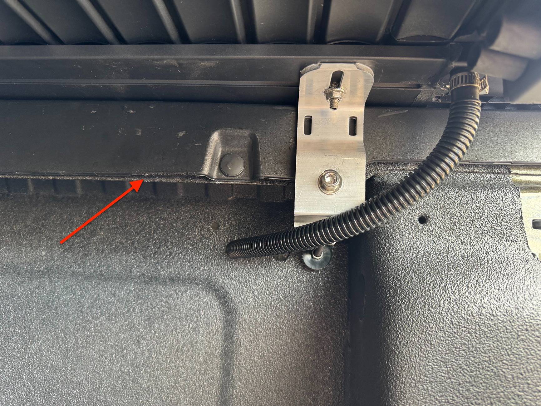

Ok thanks again. So with doing this you didnt have to plug the other smaller holes inside the bed? I have read others have filled those holes with rubber grommets.
Hey there - I didn't do anything beyond what I described, no grommets. If the stake bed caps and the sides are sealed, nothing is going to leak down to the holes. If the holes are filled with grommets, but the stake bed caps are leaking above them, water is still going to get in. The problem with only filling the holes is the inside of the plastic bed trim is not sealed on the inside of the truck bed. In my opinion the stake bed caps must be sealed. Here's a picture with the arrow showing the inside gap that will leak if only the holes are filled/covered but the stake bed caps are not sealed.

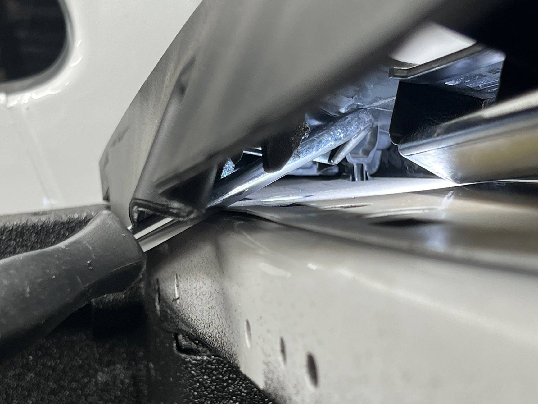

This is why the Rangers bed gets wet. It’s best to take the plastic covers off and seal all the holes with vinyl.
How did you get the 2 front plastic prongs closest to the bulkhead?
