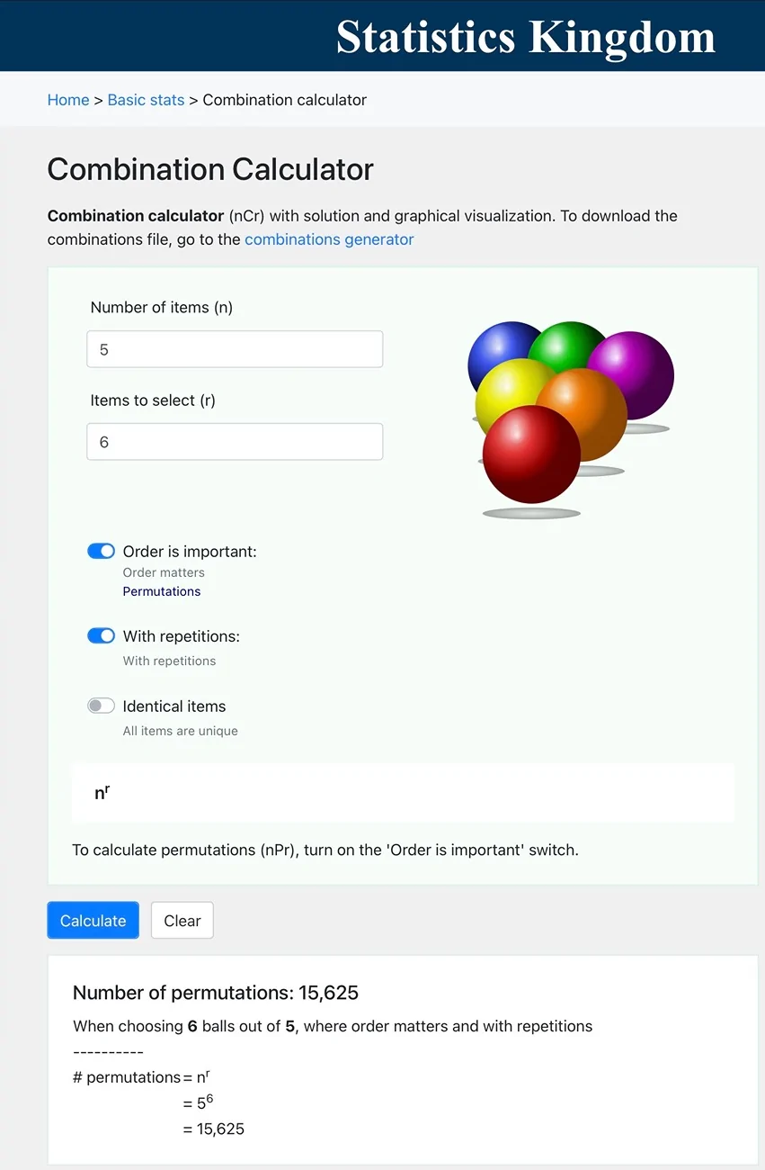

Ah, yes. I figured for 5 numbers, instead of 6. So, 5^6, not 5^5.
EDIT:
My code is only 5 digits long, so I was right, unless other have 6 digits codes.
mine has 5 you were right.

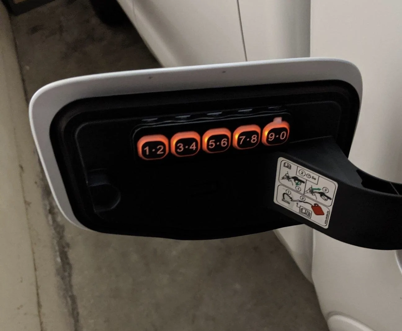

all the ranger6g use a wireless keypad that can be mounted anywhere. I believe in 24 it could be ordered from the factory. 25 was dealer installed. The default is the drivers door but you could ask for pillar or in my gas door.

Also, once the battery dies on this thing guess what? It's not user replaceable because the thing is sealed. I'm sure someone with find a way to hack it by then. I'm not paying $400 for a new cheapo plastic stick-on keypad. One of Ford's worst ideas ever. I also asked them to install the new one inside the fuel door..so I don't have to look at it. lol
