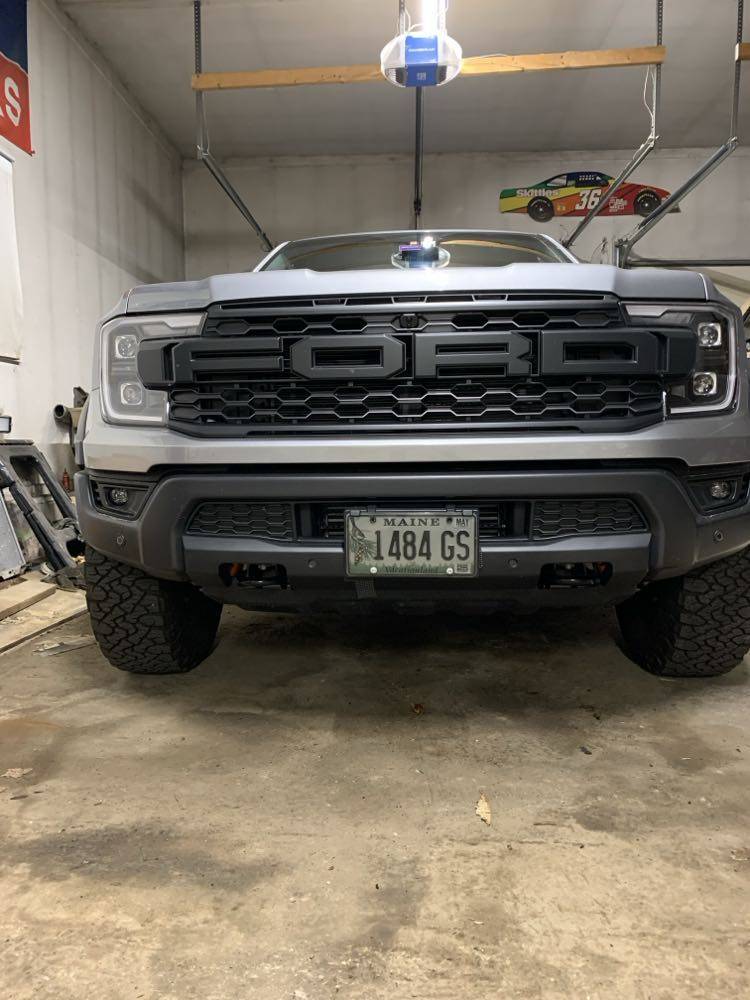

I did both mods to my Raptor. I PTM'd the skid plate and bumper trim to match the bumper and I did the license plate bracket flip mod. IMO both mods looked better than stock but my license plate bracket flip mod didn't work as planned. It blocked the front collision assist sensor so my front collision assist and adaptive cruise didn't work. :(

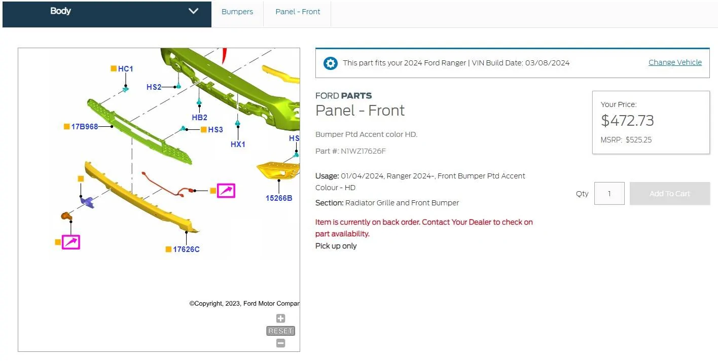

Looks much better matched, wish Ford sold that piece already matched to the bumper. I am going to research the part number for a price but probably having it painted will be cheapest way.
The plate looks better lower too, too bad it screws with the sensors....

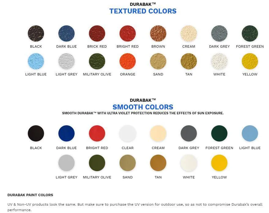

This might be fun on a bash plate, running boards, or valence, or even a DIY bedliner or fender flares.
I'm not sure I'd tackle removing the valence myself - lots of stuff there for me to screw up.
Their Gallery shows some pretty interesting projects. The projects show what colors used and some were mixed to get a different color/
Ford Ranger color change to silver front bumper lower valance panel 1717723705602-ya
Durabak™ Paint Colors | Textured & Smooth | Durabak (durabakcompany.com)
What brand and color paint did you use?
Someone on this forum said it was Boulder Grey (paint code JNV) so I went with that. There's a couple of the local part stores around here that mix paint and put it in spray cans. The first store was clueless when they saw a 3 digit paint code. The 2nd store did a bunch of leg work and was able to find it. The problem is most colors they mix and put in spray cans has clear coat mixed in. I top coated it with some flat clear coat and got a good match.
