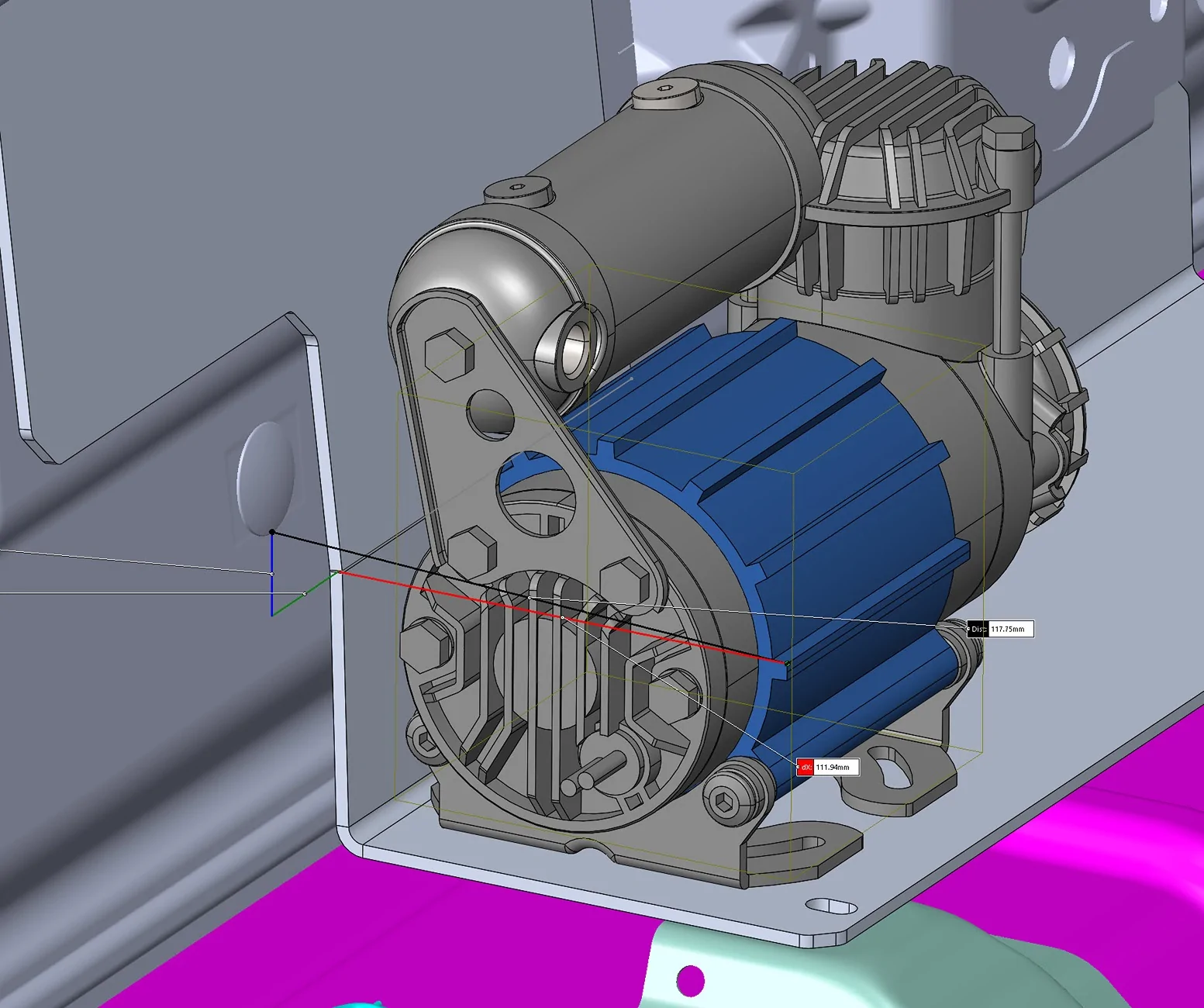

This would be pretty cool, if there was enough room for it. I could even make the back flange of this MOLLE pattern so you could attach air tools/hose/etc.
We need about 120mm (4.75") from the back wall to the back of the seat to fit the ARB single.

This may also be possible! I have our Rear Seat Delete drawn to almost exactly where the back of the seat is and at this location, the compressor clears the seat.
We would only be able to do this for the new ARB Dual Brushless Compressor, though. If you notice in the model I used here in the video, the output for the compressor would be buried in the seat. That output will rotate slightly, so it may be possible, but the new brushless compressor has the fitting on one end and is a little more flexible with mounting.

I'm super curious about the brushless fitting. It is packaged a little tighter than the brushed compressor. I'll probably make one and throw it into ours to see if we can get it to fit.

I should've been more specific with the compressor, but the ARB brushless was the one I had in mind when I posted earlier.
Alternative mounting options for compressors is a good idea, for me at least.

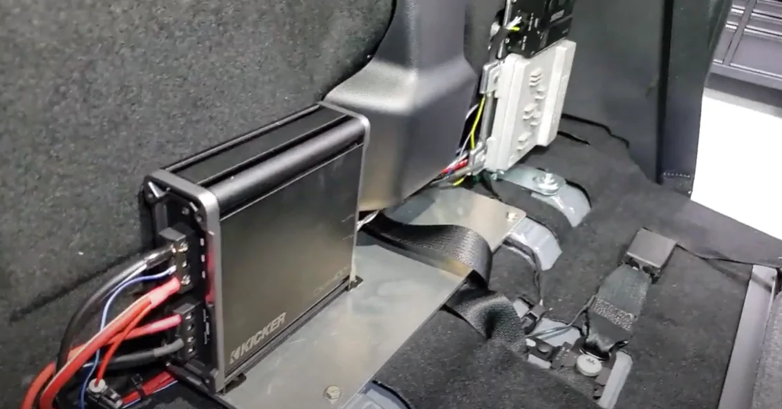

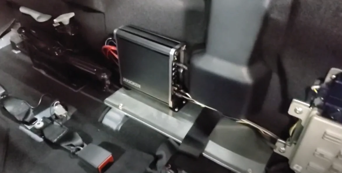

Shout out to American Adventure Lab @AdventureLab for building a custom amp rack for me while they were bringing the rear seat delete to market. Awesome quality and exceptional customer service!

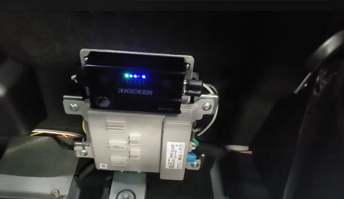

Definitely a nice bracket. I made something similar out of flat stock that anyone could do in the garage. 1/4" thick aluminum so it could be tapped for threads. It bolts down to the old subwoofer holes and is very sturdy. I made a smaller plate for the LOC that mounts it right above the factory amp. If your amp allows for end brackets like the Kicker this would be a good option.
