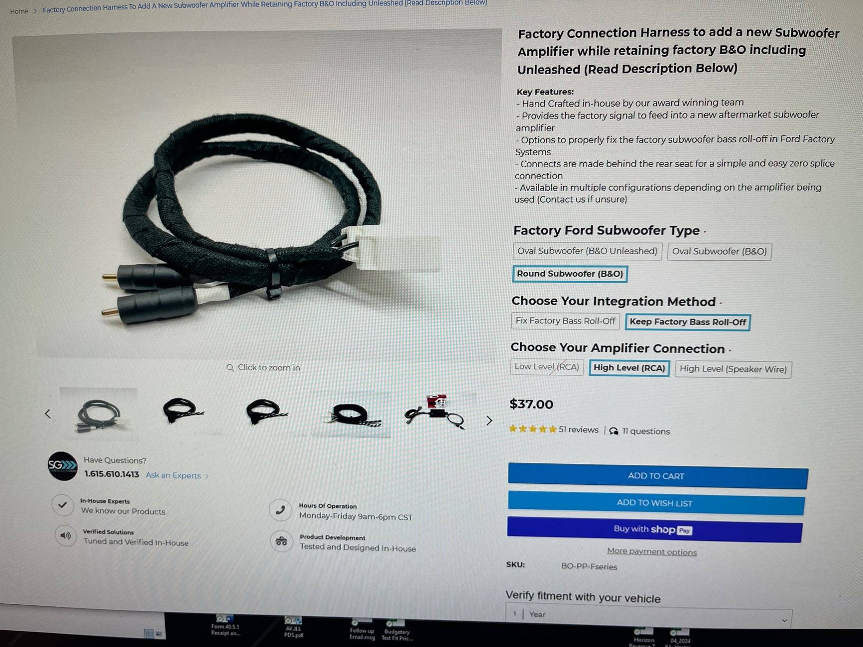

Interesting! I was guessing that the the signal coming from the factory amp would be speaker level output (since it's going to the factory "sub") and that a LOC (whether in an amp or separate) would be needed to convert to a pre-amp signal, but I didn't realize it wouldn't be a full range signal. Why would they not have a full range signal feeding the existing factory sub? Have you done any sound measurements to show we aren't getting a frequency response below 40hz? That would be a little disappointing. It would be a shame to miss the 20-40hz band. That being said, the stealthbox volume (.37 I think) is a bit low for the JL 10TW3 I was planning on putting in. That sub's frequency response gets down to 24hz in a larger .5 sealed box and has an F3 of 40hz.... so I'm not sure that I could have expected anything in the 20-30hz range anyway. I actually debated getting out the fiberglass and making my own box that uses some of the extra volume the stealthbox is missing. I'm not familiar with MoBridge. I'll check it out.
The full ranges have a low pass filter that fully trails off by 40hz or so. You don't notice it much, but on some stuff that goes really low it can be disappointing where the response just stops. However these small 10's don't have that much response down low anyways. Outside of that, it works great. The TW1 really has enough power to rattle the hell out of every piece of trim in the truck. Treatment is a must, and consider bolting the box to the floor. TW3 is going to be much tighter and better all around, but I don't know if you could actually get enough volume out of that space to make it work effectively. Mine is currently tuned at -10db.
Mobridge would help as you could do your own correction, but I'd recommend replacing the doors and doing a treatment at the same time. I'd like to get there, but not quite yet.
Do understand you aren't pulling the signal from the subwoofer output on the factory amp, it's coming from the front doors. The factory sub output rolls off above about 18 or so to protect the speaker, if it didn't we could use that signal instead. Also, do not unplug the factory subwoofer if you like how the factory chimes / turn signals come out of the amplified speaker. It will error out the amp and those will instead be played by the backup speaker in the cluster.

thanks for all the tips, truly appreciated. Looks like my Aussie sub box will be arriving in the coming days. I’ve got the Kicker Key500.1, JL 10TW1, sound deadening mats, and bass knob on standby for the install. I also have the Sounds Good Stereo adapter. Since I have the Key amp, I opted for the “Factory Connection Harness to add a new Subwoofer Amplifier while retaining factory B&O”. But I haven’t seen any close up pics of the stock amp or how this white harness makes the connection. This is the only unknown for me on the install. Any insight? As you mentioned I’d prefer to keep the stock sub in place.

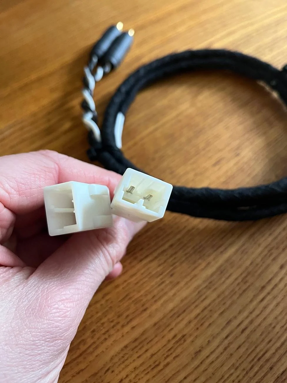

Unfortunately, you bought the wrong jumper harness. You need this : https://soundsgoodstereo.com/produc...67S_58zR7VJj9Q.PQdJue#judgeme_product_reviews

What the heck! THANK YOU! How did you find that? I looked through all the harnesses and never saw that. Also didn't expect a specific harness to that amp... just expected either bare wire to solder or RCA connection. Don't get me wrong, I'm thankful there are harnesses to buy, but that website is really confusing. Did you get this jumper harness? Does it allow the factory sub to stay in place? I wish the website had a photo of it.

Nevermind - I think I get it now. this is not the correct jumper for the full range signal to the doors. I should have called them before I bought the first harness. Seemed straightforward at the time, but I was wrong haha. I'm glad I asked the question before I got into the install and found out the hard way.
