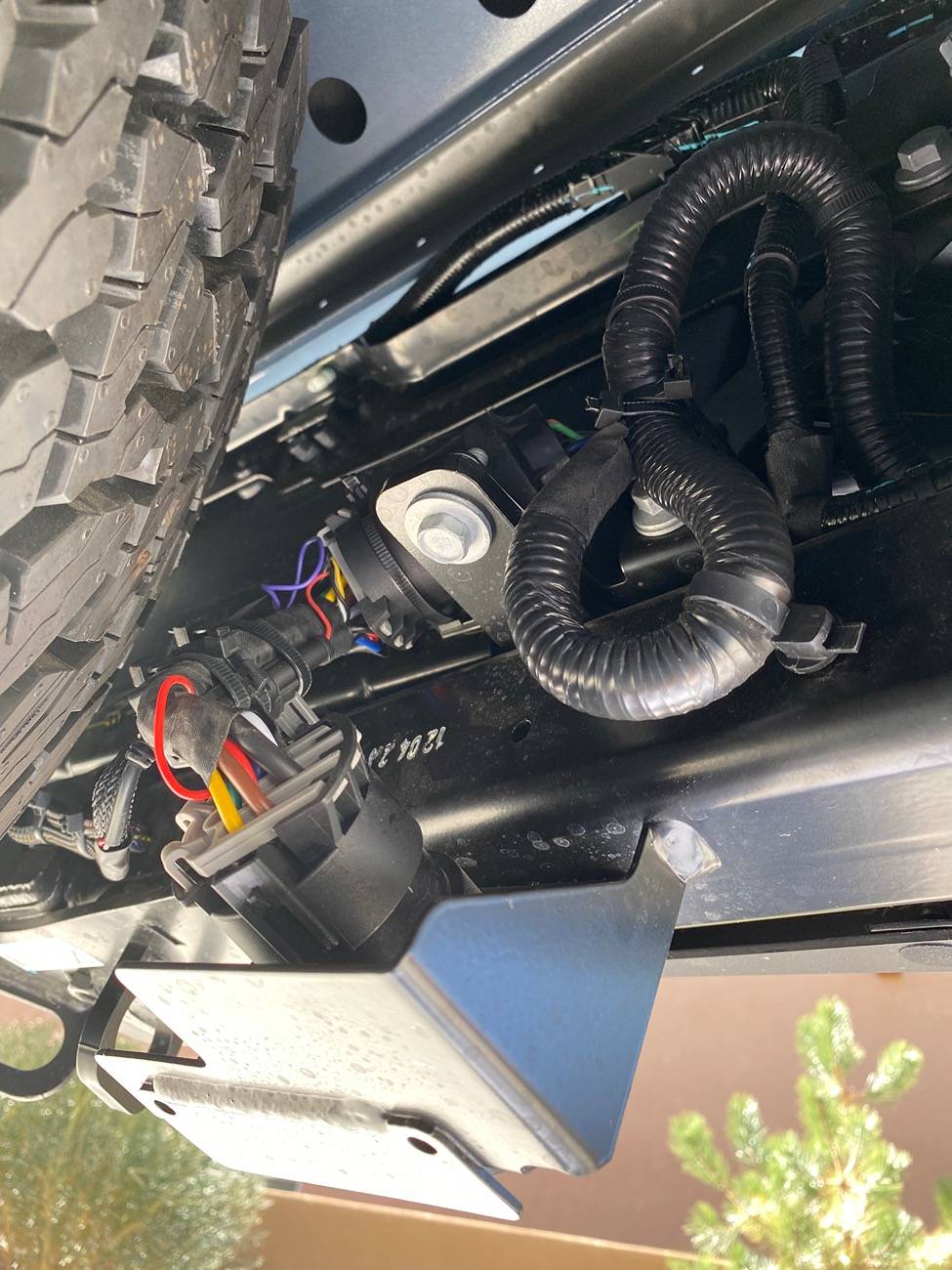

Finally got the RR up on the dealer's lift for an oil change, and my friend/tech showed me how to unclip the trailer plug in unit and push it out of the bumper, allowing easy access to the wiring plug so the pigtail could be installed. Took it home and finished the install. I had already removed the plastic tab on the plug for the wires so it fit thru the back hole in the hitch receiver. It all works just fine, with no hyperflash ( my unit is the plain jane without connection to the brake lights). Everything seems well constructed, so I am pleased with this purchase. I dropped the spare for easier access and aired up the spare while it was right in front of me .. Lol. The hardest part of dropping the spare was figuring out how to remove the bumper plug. Had to use pliers to yank it out once it was turned to the unlock position. I also used a 1/2 drive with a 12 point spline/square socket to drop and raise the tire. Made it a ton faster and easier. Thanks to all of you that got this system figured out. Warning to all yet to install, there is almost no room between the spare and the wires/plugs. Whatever you do to secure the wiring will not look pretty.

Easy hook up but you need to cut off the two small tabs on the receiver plug with side cutters, to get it thru the hole at the back of the hitch receiver. You also need more than the two small wire ties provided, to properly tie up the wiring harness.

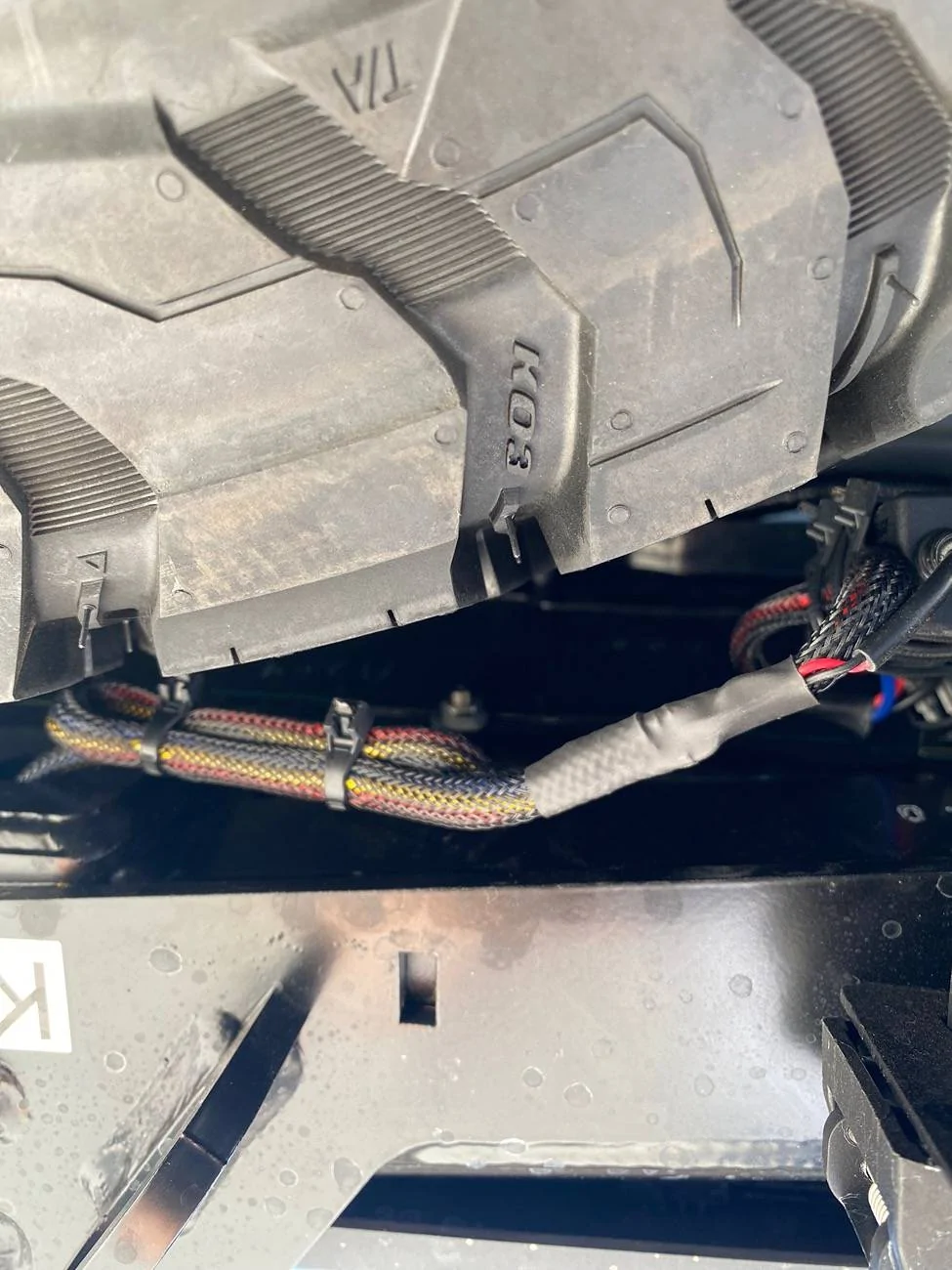

Spare tire must come down to gain access to the rear of the receiver hitch. Doesn’t have to be removed, it just rests on the ground. Good time to check the spare tire pressure as well.
I lifted everything above the OEM plug and secured it to one of the metal tabs where bumper recess, plastic cover attached to. To properly secure the wiring harness it needs 5 medium length wire ties minimum. If it’s not properly secured, it will come in direct contact with the spare.

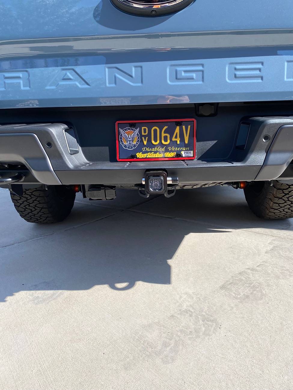

It’s quite bright and at night lights up the back of the RR. The one I purchased supplies; running, brake, reverse light, functions.
I also opted to cut out the tabs and utilized my lockable receiver pin. This is an install option. Without the lockable receiver pin, anyone can easily remove the light from the receiver hitch and separate it from the wiring harness. I used a Drexel tool with a sanding thimble and a cut off tool. Made a clean job of it. Pin fits nice and snug no rattling or noise.

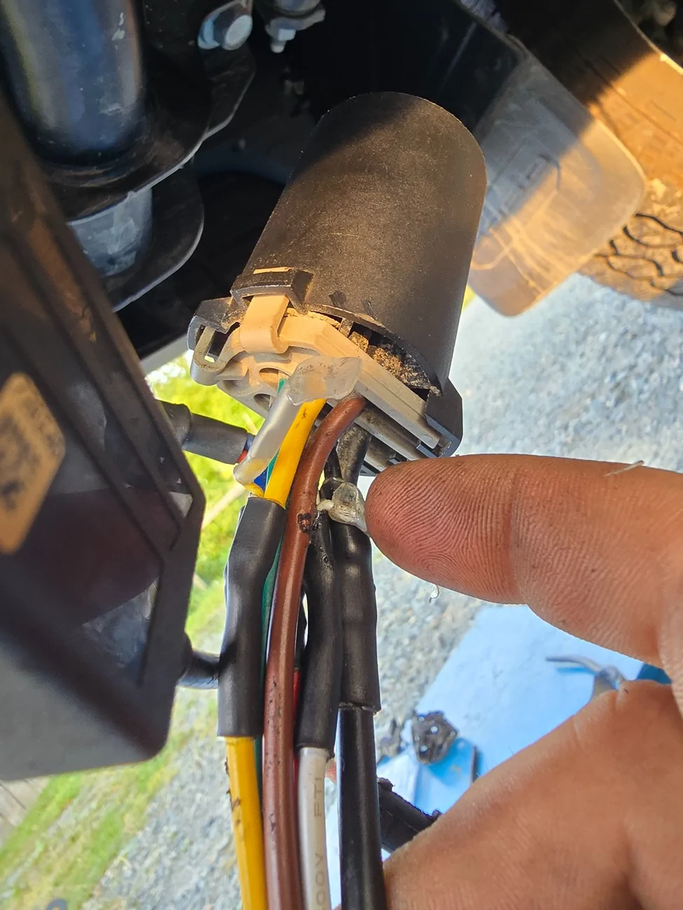

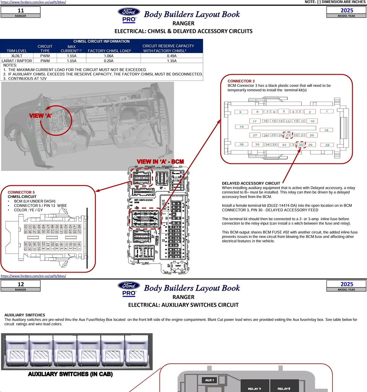

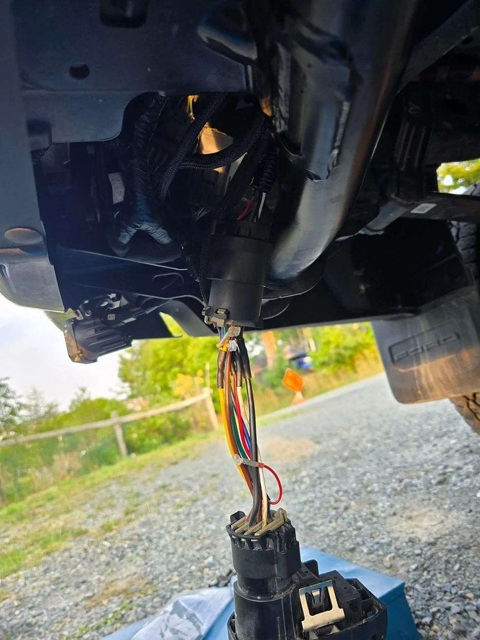

before I found the body builder guide(upfitter guide) I was getting the trailer light errors. but then I found the upfitter guide where ut states to tap the wire at the bcm and run it back, I was getting a cap installed, so I tapped the 3rd brake wire from the bcm. ran a wire back to trailer plug, where the dd harness was, and I cut the left and right stop/turn wires off the dd traiker harness, and put them on the bcm wire, functions perfectly. the trailer harness still gives me my marker, and ground, and reverse.
