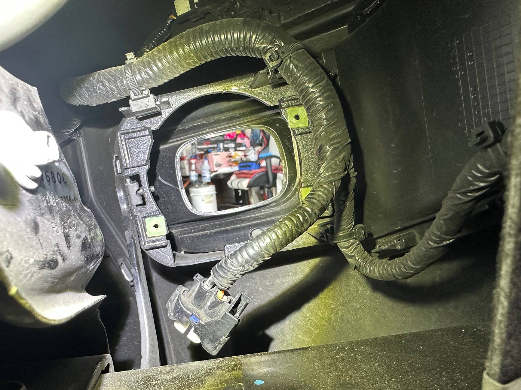

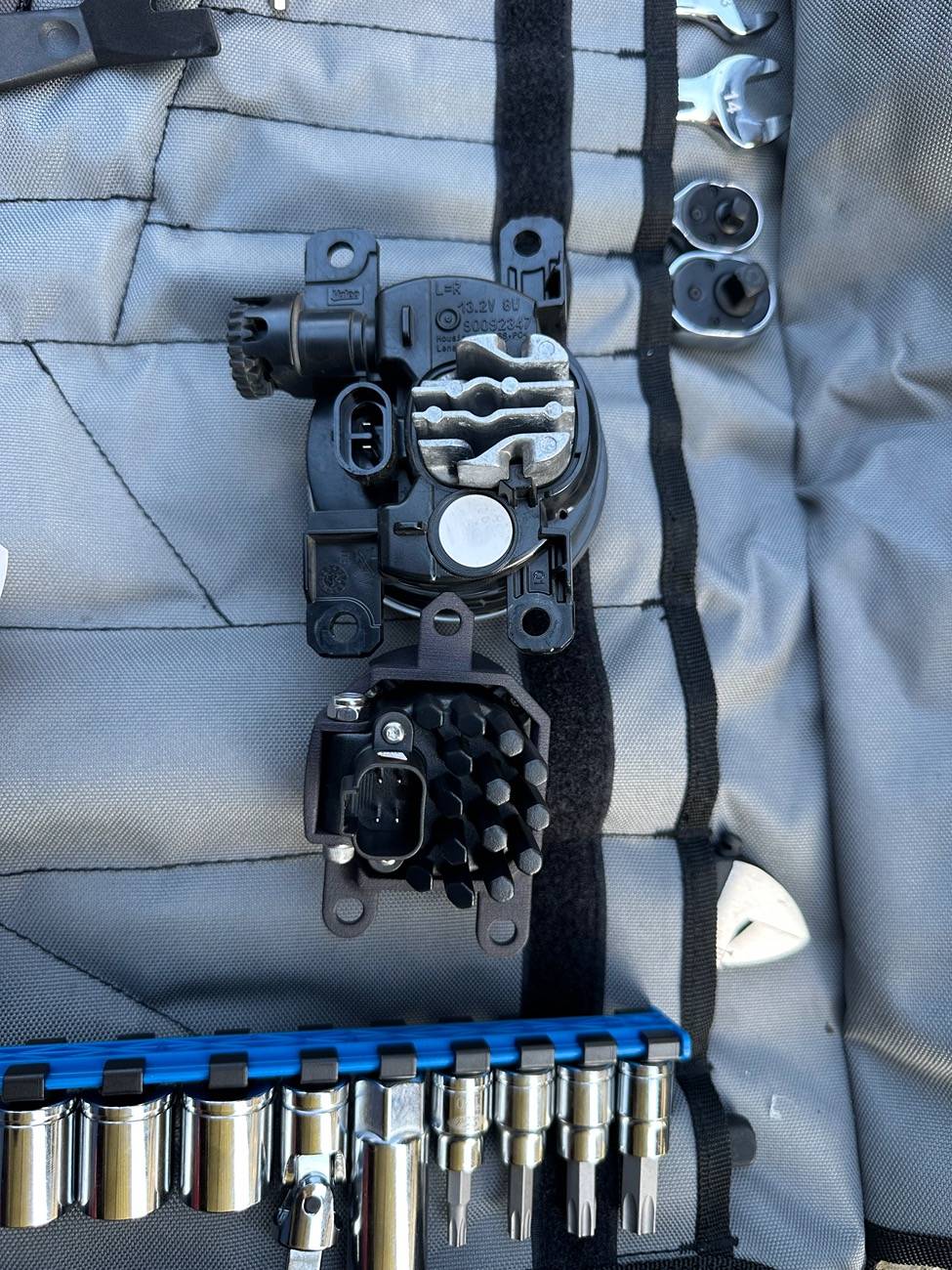

Ok, just took the time to install. I started with the passenger side and just turned the wheels all the way to the right. It took me about 20 minutes to do that side. I realized that I took too many screws out thinking I needed more space.
When I got to the driver's side, I turned the wheels all the way to the left and only removed the plastic air duct(see picture). That was enough room to get to the three screws holding in the fog light. This side only took me about 5 minutes.
The only complaint I have is that there's no way to check leveling when installing. There's a hinge in the mount for the light but once you tighten it down and mount it, there's no way to adjust it unless you take everything apart again. I won't be able to check beam pattern until it's dark tonight. Fingers crossed I did it right the first time.

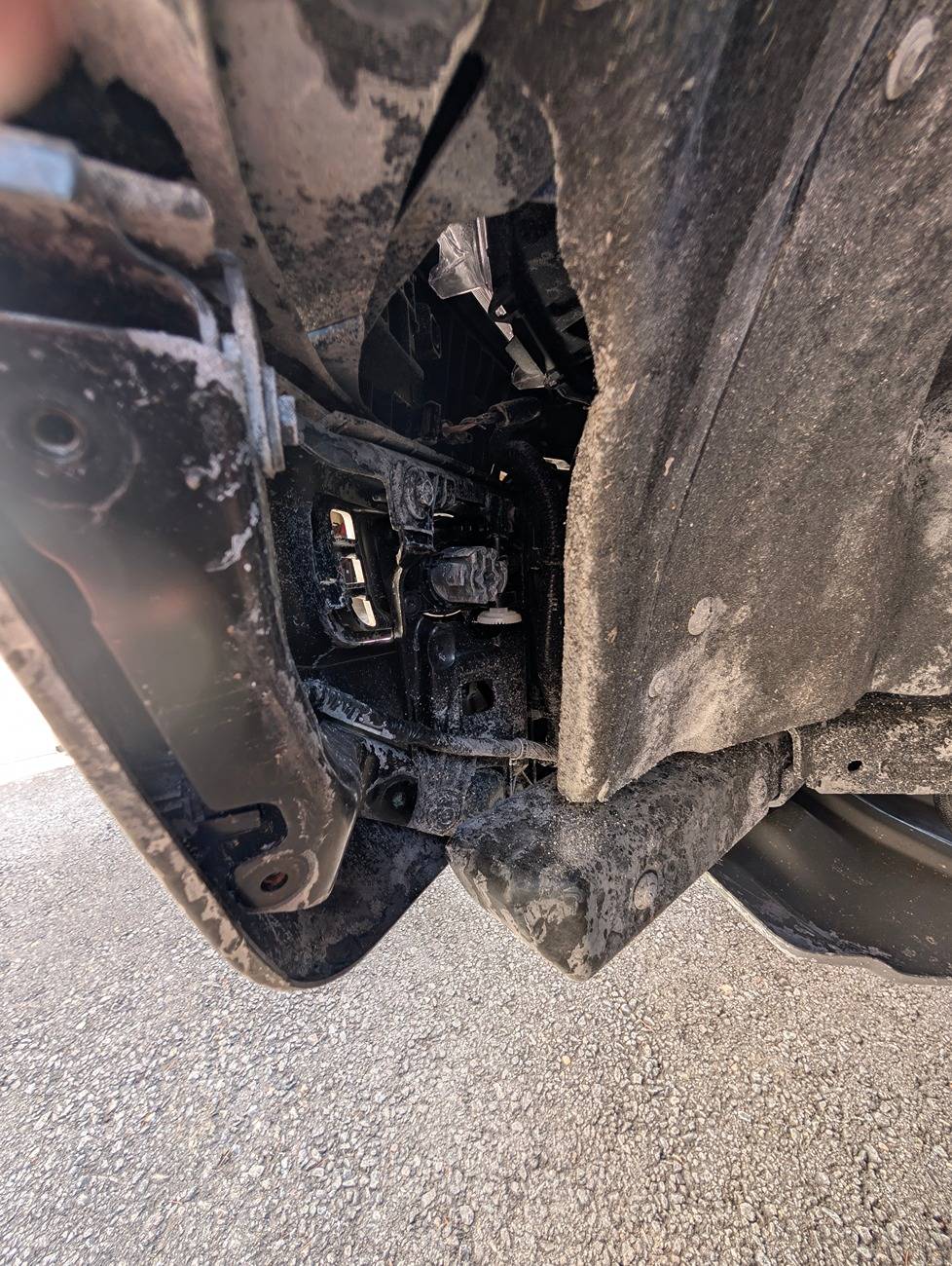

So i currently have a 2024 Lariat, went to install my diode dynamics. Pulled the OEM fog lights out, and the bracket provided by diode dynamic doesn’t seem to match up.. any advice on this? Am i doing something wrong here?
see pics attached
see pics attached

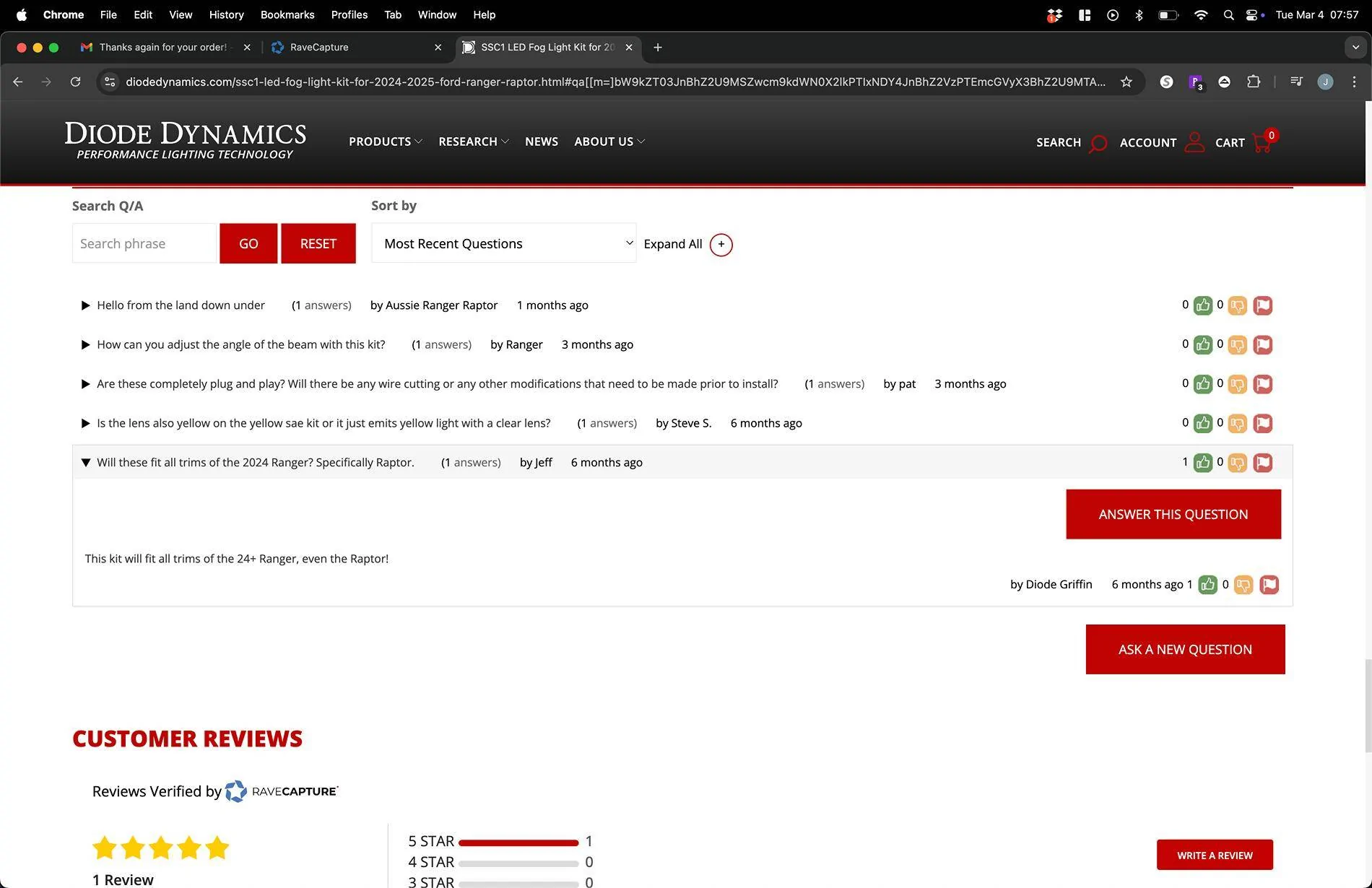

They wont fit; return them
Their website is inaccurate as is their employee who commented in the FAQ section.
Thanks for validating my initial thought, we’ll see how this return process goes
let my experience be a cautionary tale for non raptor folks lol
i probably should have posted earlier; i've got the RMA label here and just need to package mine up...just remind them that their website says they fit if you get trouble...
