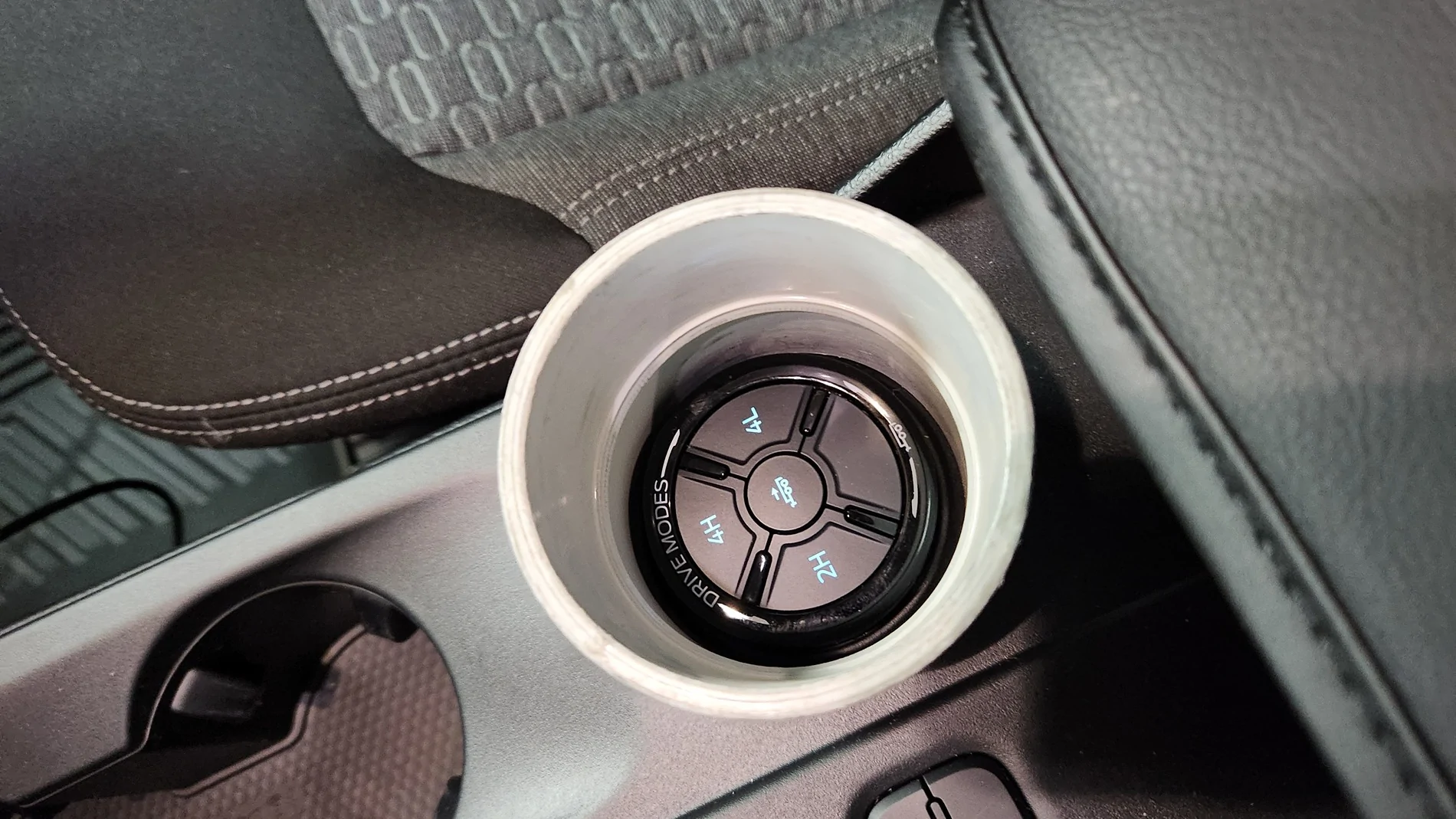

Yes. Depth is the concern. I measured 70mm across from the outer edge of the enclosing plastic ring with a depth of 25mm, rounded slightly up, for clearance. Maybe Monstrum or Butler Creek has them or can custom make one. Someone might have a Ranger at one of these manufacturers and do a laser measurement.

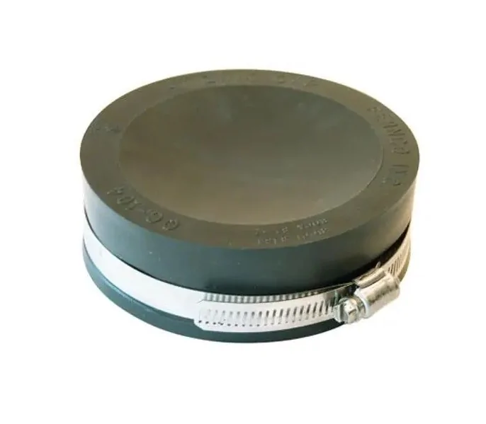

A 2.5" PVC or ABS pipe has an OD of 73.025mm meaning a 2.5" coupling, cap or rubber Fernco "qwik cap" would fit. A fernco cap comes pretty short and by removing the clamp could just be placed over the knob. You could even leave it in place and just squeeze it when changing drive modes.
https://www.google.com/search?q=fernco+2.5"+pipe+cap&oq=fernco+2.5"+pipe+cap&gs_lcrp=EgZjaHJvbWUyBggAEEUYOTIHCAEQIRigATIHCAIQIRigATIHCAMQIRigATIHCAQQIRigATIHCAUQIRigATIHCAYQIRiPAjIHCAcQIRiPAtIBCTg3NTVqMGoxNagCCLACAfEFVaHeu6hYqqc&sourceid=chrome&ie=UTF-8
Ford Ranger Drive selection knob cover (so the dog dosen't put it in 4wd) 2.5 fernco
edit: looks like the only 2.5" Fernco is this end cap

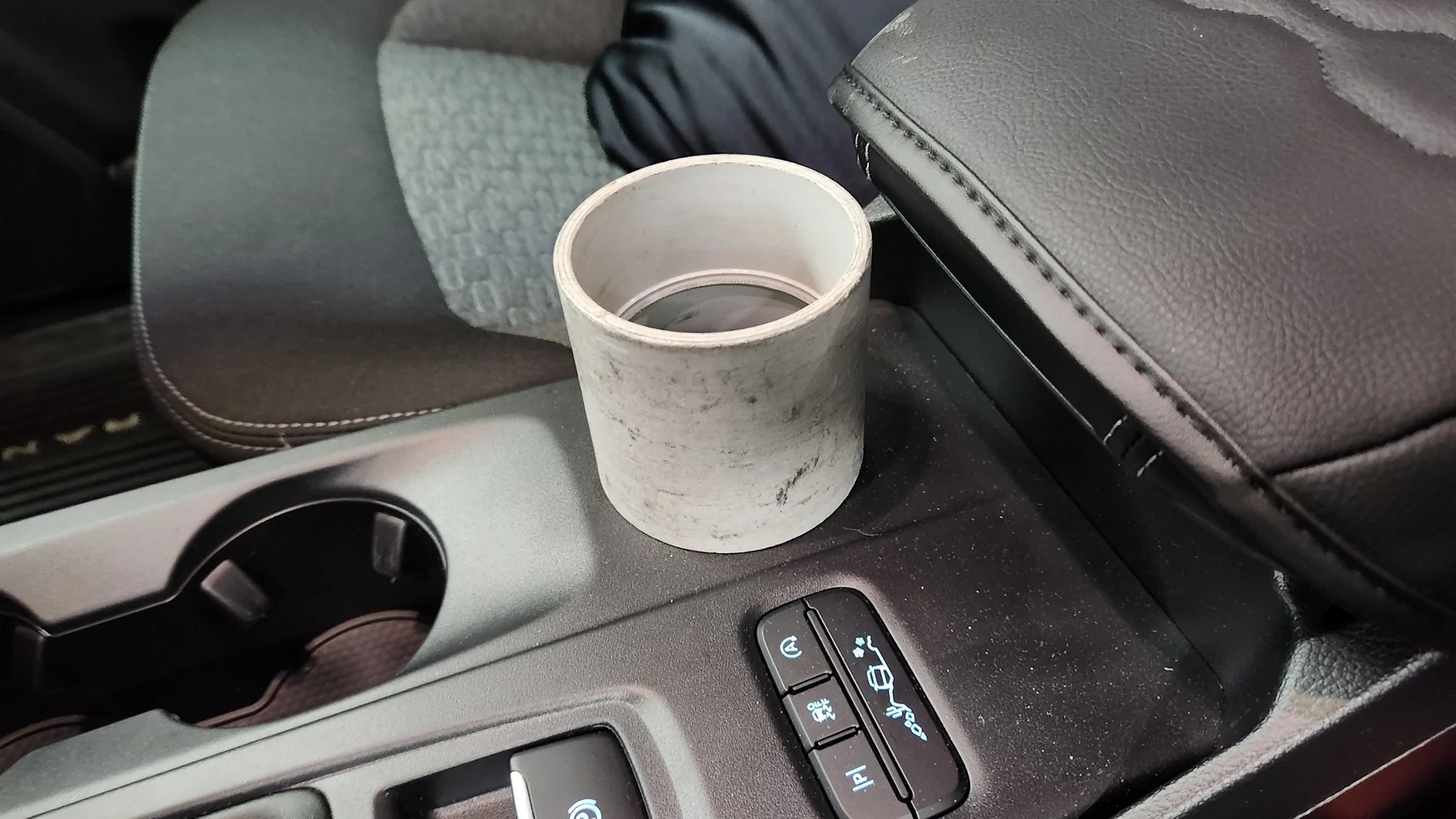

So the 2.5" coupling fits nicely over the knob which means any 2.5" pipe cap that you can find will work since all 2.5" pipe is the same outside diameter of 73.025 mm and the fittings are made to accommodate that size whether they are ABS, PVC, rubber or a coupling/cap all will work. The one in the pics happens to be a 2.5" gray PVC coupling.

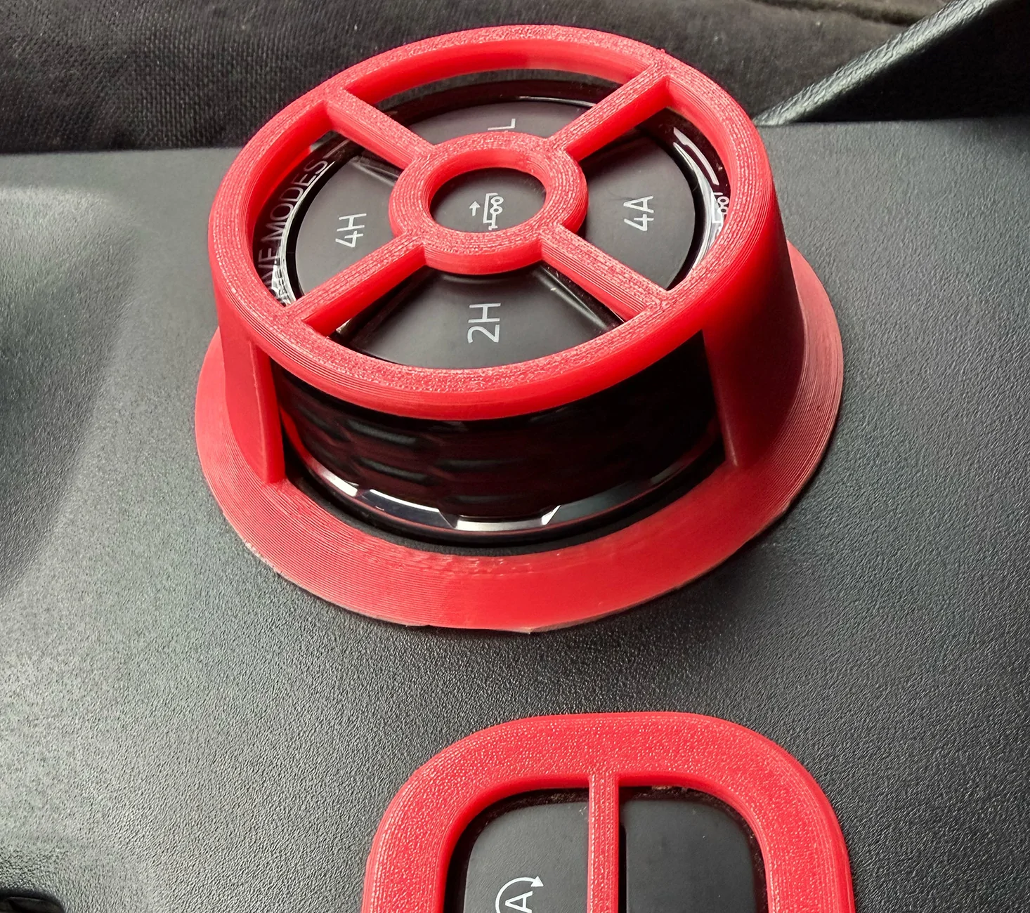

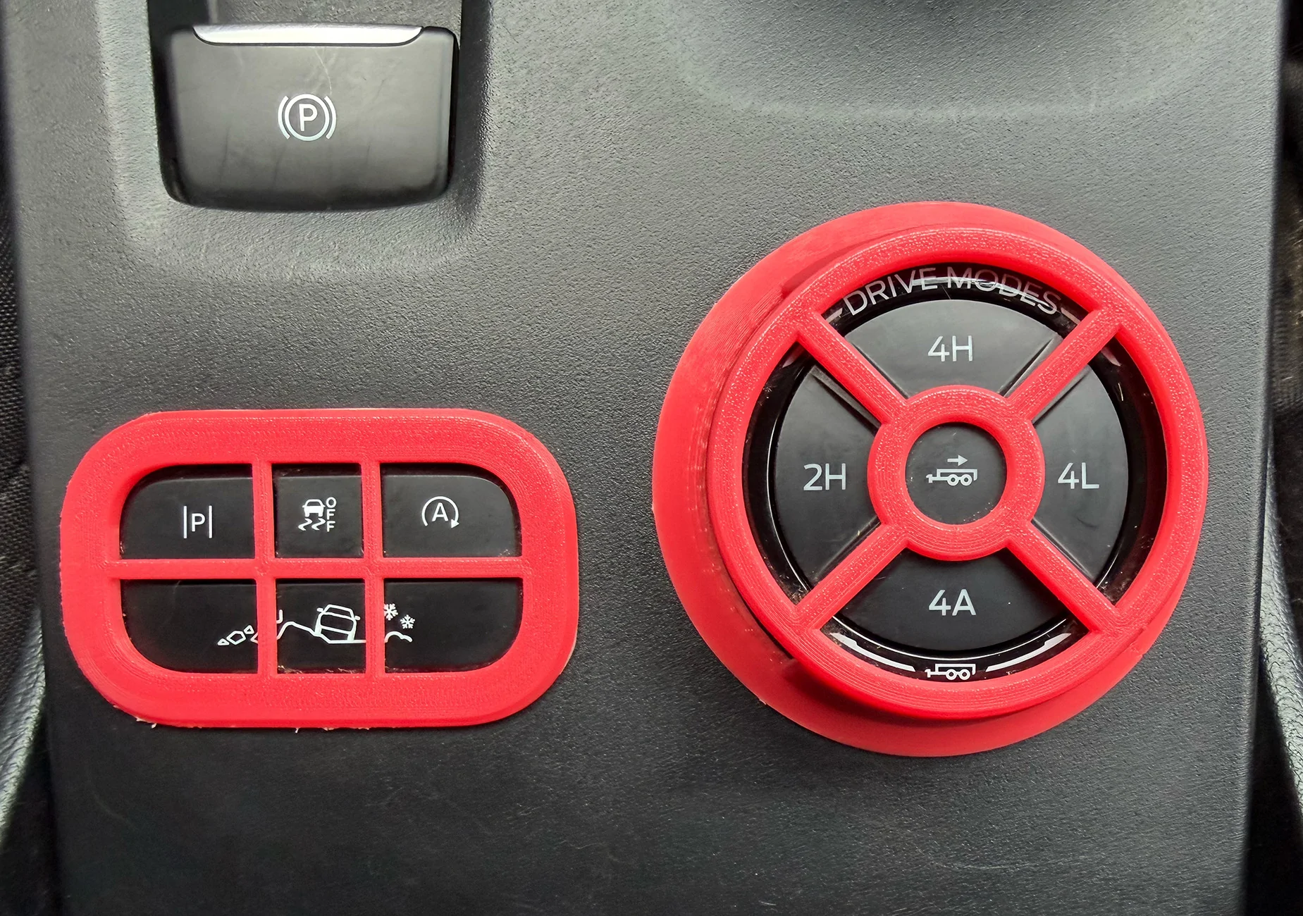

Here's my 3D printed solution. PETG filament, as PLA might deform at really hot summer day interior cabin temps.
Ford Ranger Drive selection knob cover (so the dog dosen't put it in 4wd) Button-Cover-To
Ford Ranger Drive selection knob cover (so the dog dosen't put it in 4wd) Button-Cover-Sid
I used picture hanging strips to mount them. Pretty tedious cutting out the slim pieces to mostly follow the curve at the base of the covers, but it holds them in place very securely, and they still come off without residue or damage.
With the buttons still exposed, and the side cutouts for the mode wheel, the controls are still completely usable. They don't entirely eliminate dog induced activation, but it's now very rare compared to very common before.
