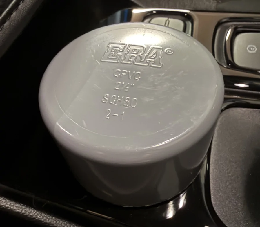

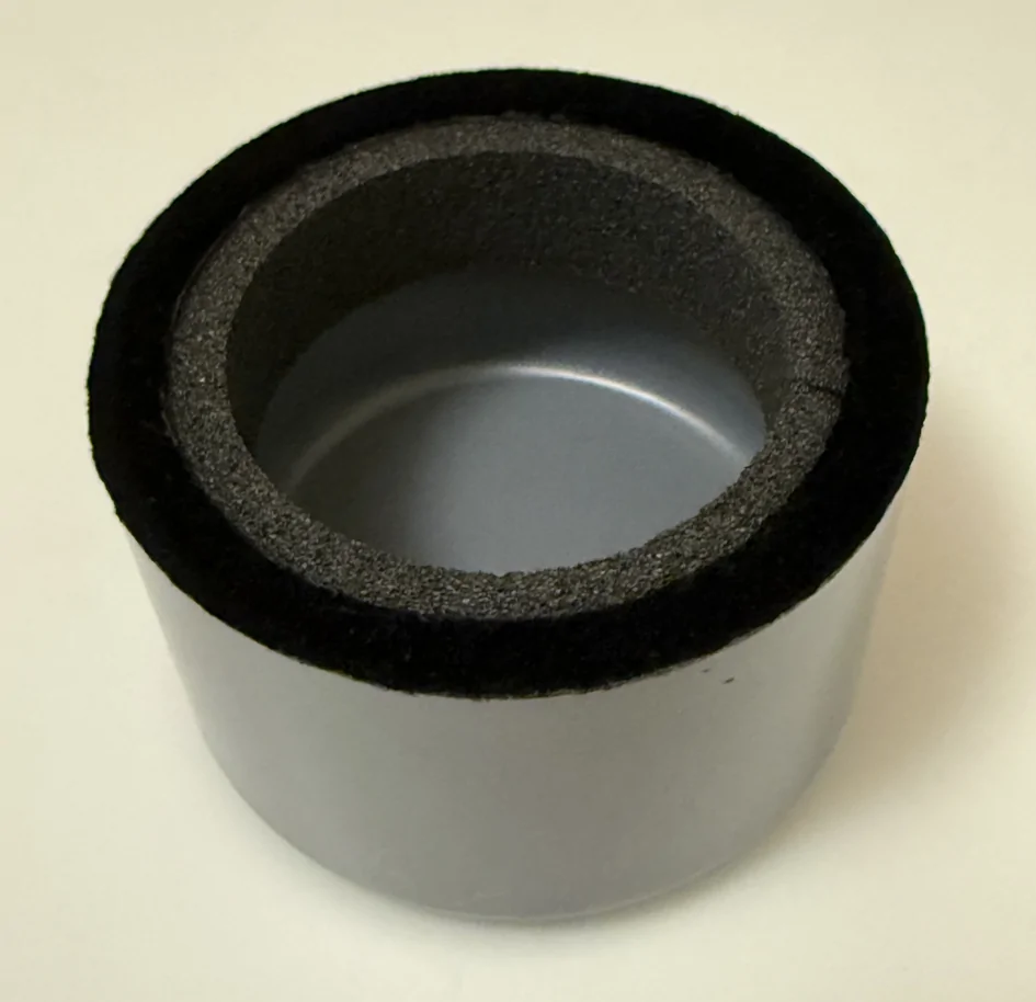

Puppy kept trying to put my truck into 4x4. I couldn't find a manufactured solution that I liked, and didn't want anything permanent. So, I created my own puppy proof drive mode selector shield. A Schd 80 2 1/2" pipe cap, adhesive backed felt and foam weather stripping. It's over-kill, but it stays in place, there's no lateral movement, and it won't scuff my center console.
Ford Ranger Drive selection knob cover (so the dog dosen't put it in 4wd) Cover 1
Ford Ranger Drive selection knob cover (so the dog dosen't put it in 4wd) Cover 2

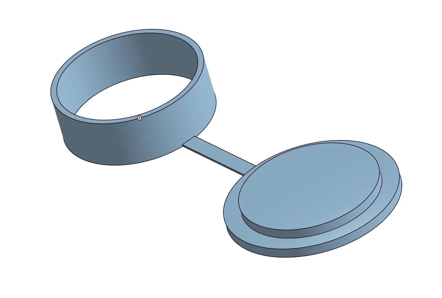

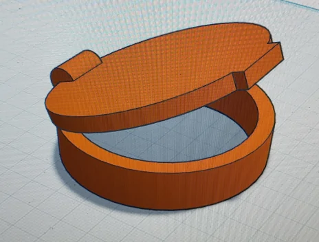

Perhaps something like this mock-up
not a bad idea. I imagine Fido won’t be able to turn the knob so make it flush fit with the knob so it will still turn
id design it like this for printing.
Ford Ranger Drive selection knob cover (so the dog dosen't put it in 4wd) IMG_3600

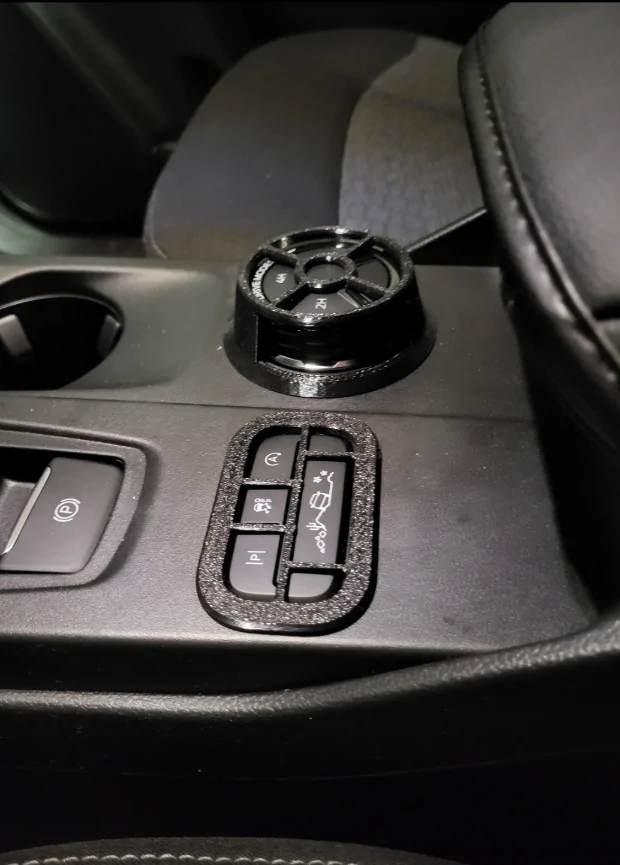

Another design shared with me. I just modded the buttons cover a little. Just placed in picture to see how they would work.
Ford Ranger Drive selection knob cover (so the dog dosen't put it in 4wd) Screenshot_20260307_214848_Photos
