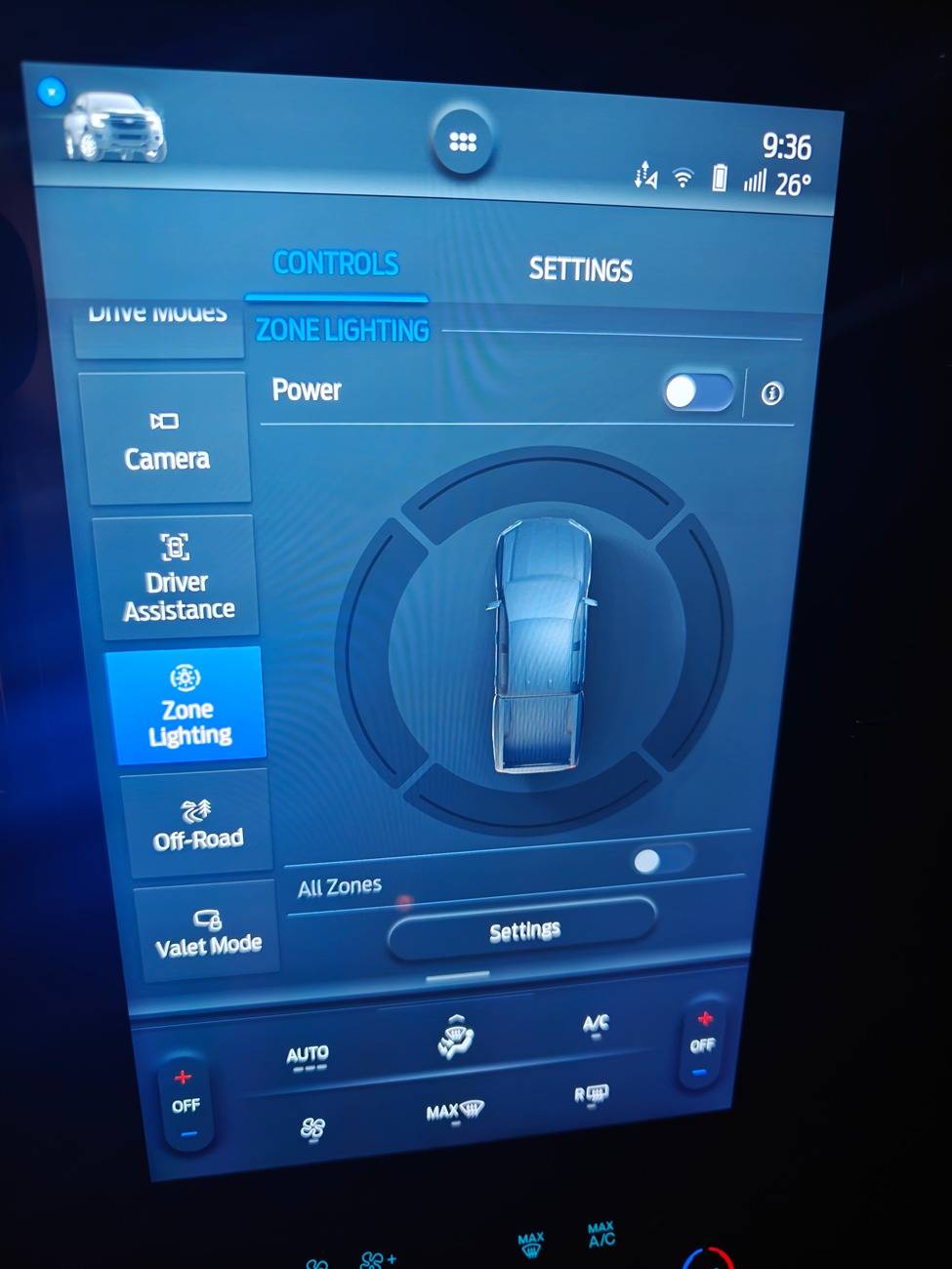

hi, Im trying to enable zone light using forscan on my 2022 ranger wildtrak,somehow I was able to put the zone lighting feature on the screen, but any button including the power just doest work.
I did some research that one of the F150 owners had the same problem, he solved it by changing some value under BCM 726-84-02, well I did the same thing and still it just doest work.
i hope someone could help me with this.
many thanks!!!

Were you able to figure this out? Can you please share how you are able to show/enable zone lighting settings in the menu?

I cant figure it out. Its still not functional.
To show the sone lighting in the memu, all you need to do is to enable the 360 lighting option under APIM (non as build).

Did you enable in BCM as well?
