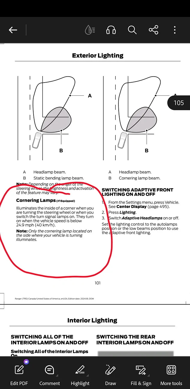

It's supposed to do that! It's a cool feature that provides additional cornering light when turning. If you turn your foglights on then both just stay on regardless of steering wheel position

I disabled that crap in FORScan. but its the cornering lamps. The non led projector trucks (halogen/led reflector)use the fogs, the projector trucks have a cornering lamp in the headlight.
Ford Ranger Fog Light Anomaly? Screenshot_20260915_082654_Adobe Acrobat

Yes, the raptors and lariats (‘24 and ‘25) with projector headlights have a dedicated cornering lamp built in, while the xl, xlt, and ‘26 lariats with reflector headlamps light one fog lamp in low speed corners.
