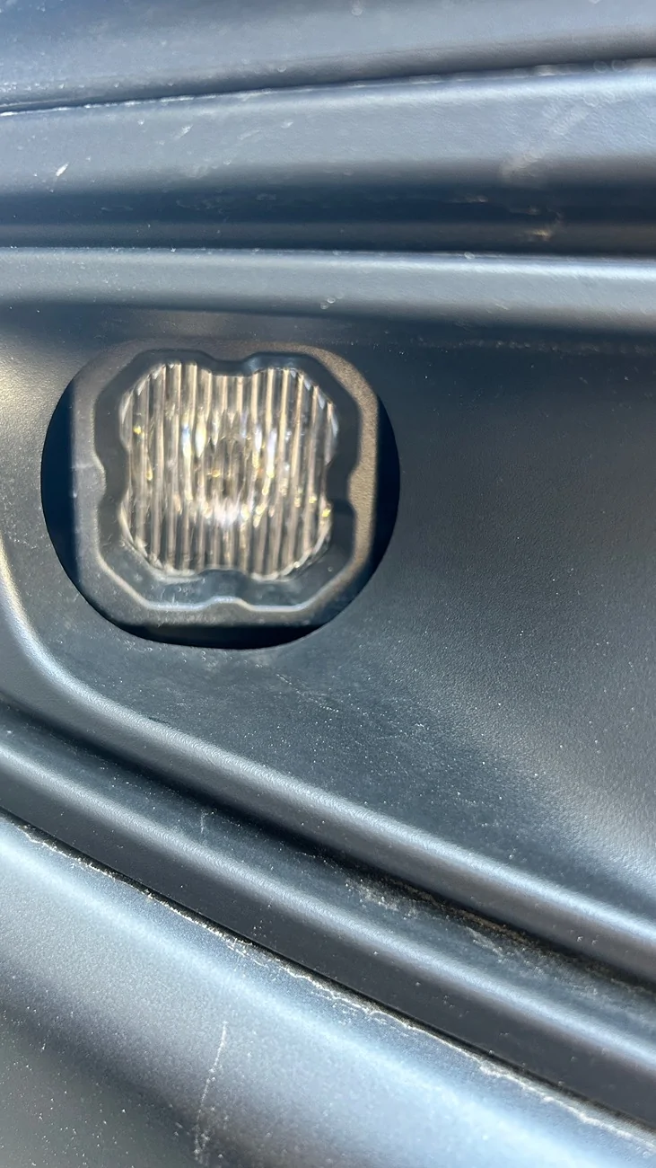

Installed the DD SS1 lights in white. My personal opinion….not super impressed. The light housing is square so there are gaps around the light after installation, they are brighter but not mind blowing at all. 🤷🏼‍♂️
Wow! Not cool. My dd3 ambers fit and adjust perfect. They were truly awesome. Thanks for the heads up.

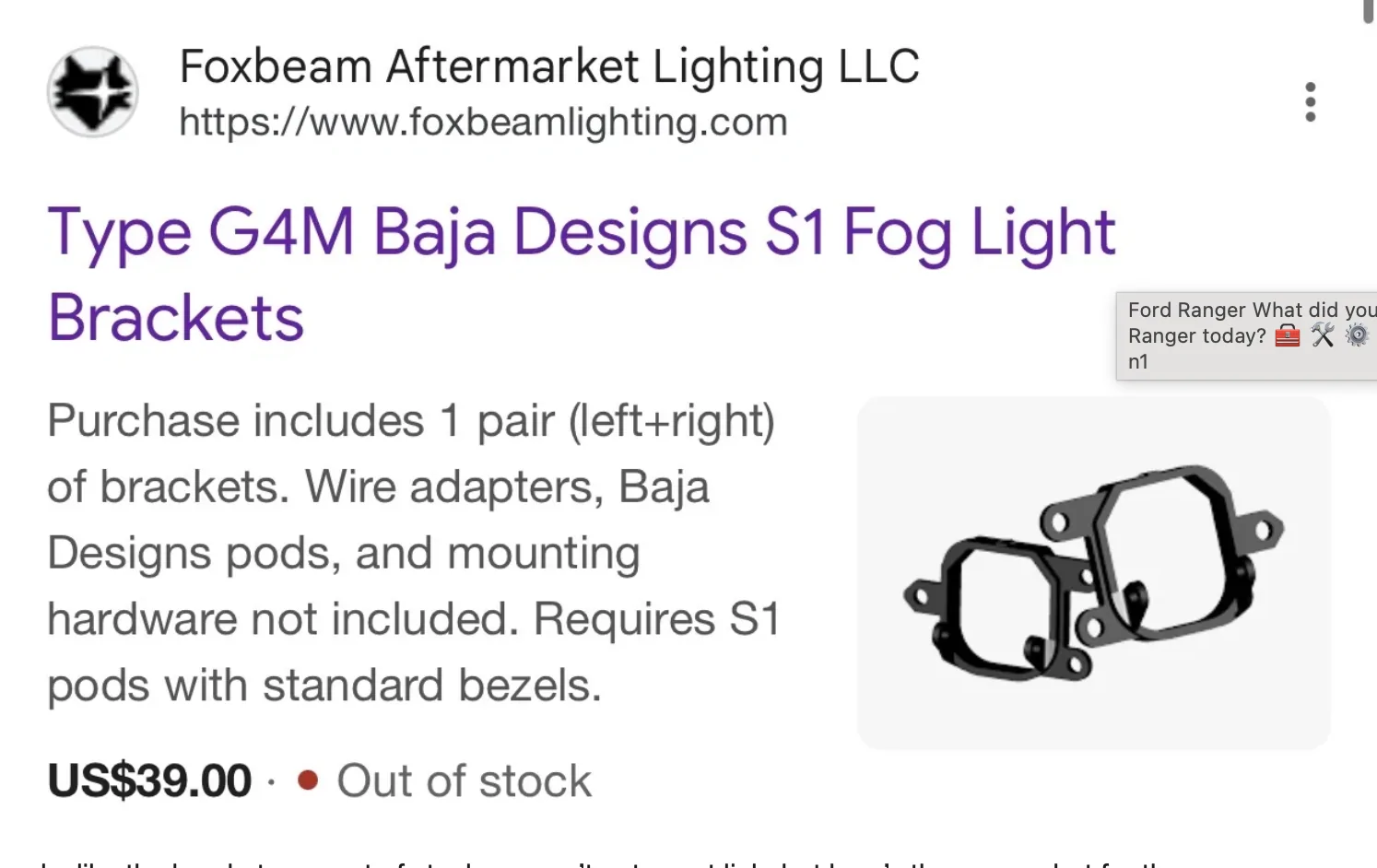

I installed Baja s1’s and they’ve been awesome so far. Used Foxbeam bracket and spv parts adapter to make them plug and play with oem harness and switch

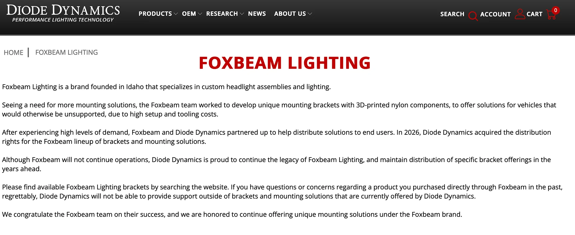

However, it doesn't look the bracket exists any more, and neither does FoxBeams website which is odd. I guess they went out of business and got taken over by diode dynamics... I attached a screenshot of the bracket I got from them, and a screenshot of what is says on DD website now. From what I can see the Diode Dynamic fog light kit that comes with their light still uses the bracket from fox beam, but their lights are not as powerful as BDs.

Diode Dynamics confirmed that they do not carry any of foxbeams products that were related to other manufacturers. That being said they let me order just the bracket for the SSC1, I am going to be the guinea pig and see if I can get those brackets to work with the Baja S1's. If not 3D printer go BRRR, might offer them for other members depending on my success. Thanks for your reply!
