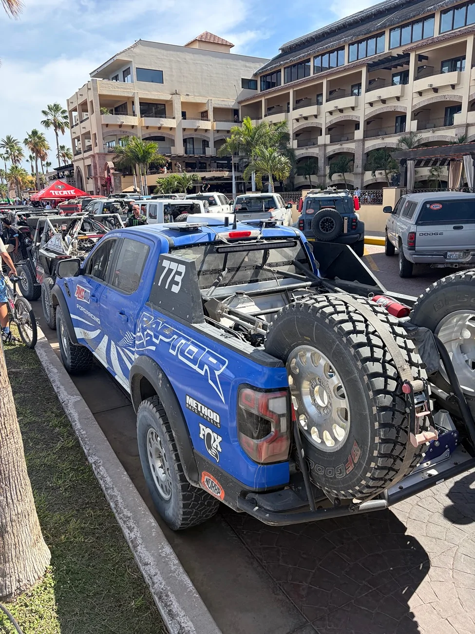

We just finished stage 4 today & spotted the Ford Performance Ranger Raptor behind us at the finish line party… 😁

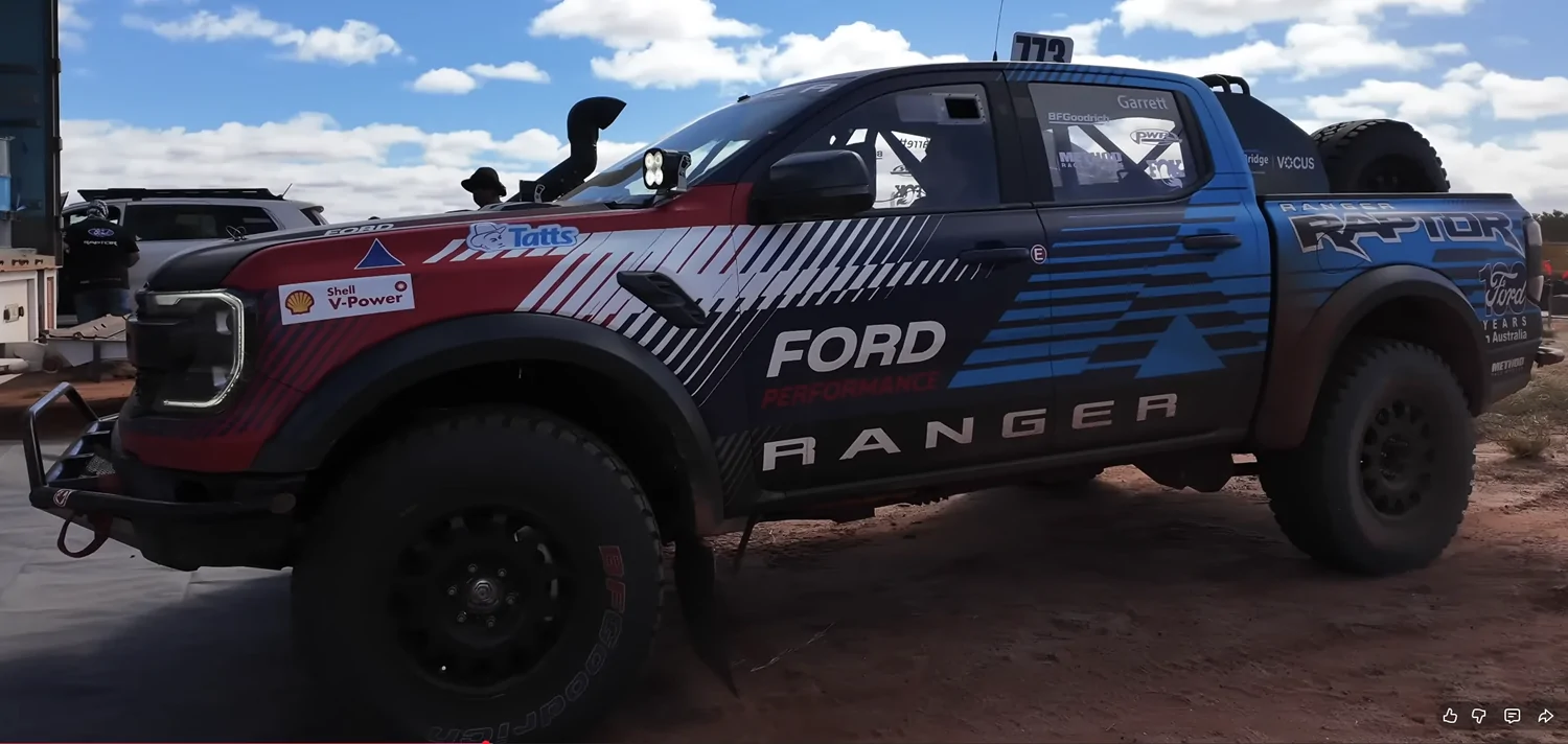

I see they stuck with the non-street legal race spec BFG tires in 35x12.5in. The first time they did Baja and Finke, they had DOT legal 315/70R17 KO2's, but in 2025 they switched to race spec tires (not street legal) and not surprisingly they did better that year, taking two class wins.
Hard to tell from the pics, but there is not much rake on that setup, maybe 1" at most, I know they use adjustable perch collars up front since the rules don't allow lifts but do allow for pre-load adjustment to compensate for the added weight of safety / race gear and to accomodate larger tires. They can also trim fenders, but can't replace shocks or chassis parts to lift.
I'm still thinking of doing a 1" front strut spacer, no lift in rear and running 285/75R17's (plus upgraded tie rods) as a "near 315/70" setup. But man those 35x12 + MR207's gotta be HEAVY. That's a 30lb forged wheel and I don't want to know what the true 35" race spec tire weighs...I know the driver in 2024 in the video said he actually preferred the stock chase truck over the race truck, wondering if they ever got the suspension sorted out of if he just learned to live with it?
BTW, it looks like the truck took a nasty hit to the rear passenger rocker, right by the fender. Huge dent there, good thing there's no passengers in rear because I don't think that door is gonna open!
BTW, that's not the actual RR Race truck that won Finke, must be another build. No Snorkel, different colors.

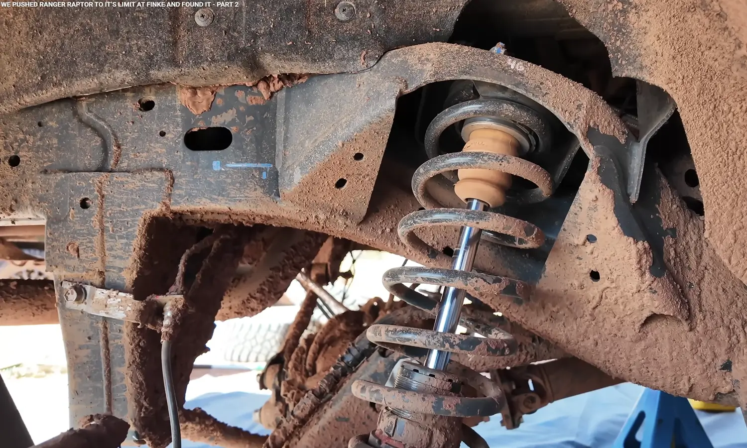

The 2.5" Fox Live valves have threaded bodies to allow for pre-load adjustment, since the spring rate is higher due to pre-load, they used limit straps to prevent harsh top-outs that would potentially damage the stock shocks from the additional preload and mass of the tires.
Other than the straps and threaded bodes / perch collars, they are STOCK 2.5" Fox Live valves. If anyone is saying the 2.5" "overheat" or you need cooler running shocks, I call B. S.
Running Finke, Ty said the fronts never got past 108F and the rears 120F, he noted that they stayed running cool. So, if you need cooler running shocks than the factory 2.5" Fox...I guess you're pushing your RR harder than the race truck at Finke or Baja....good luck!

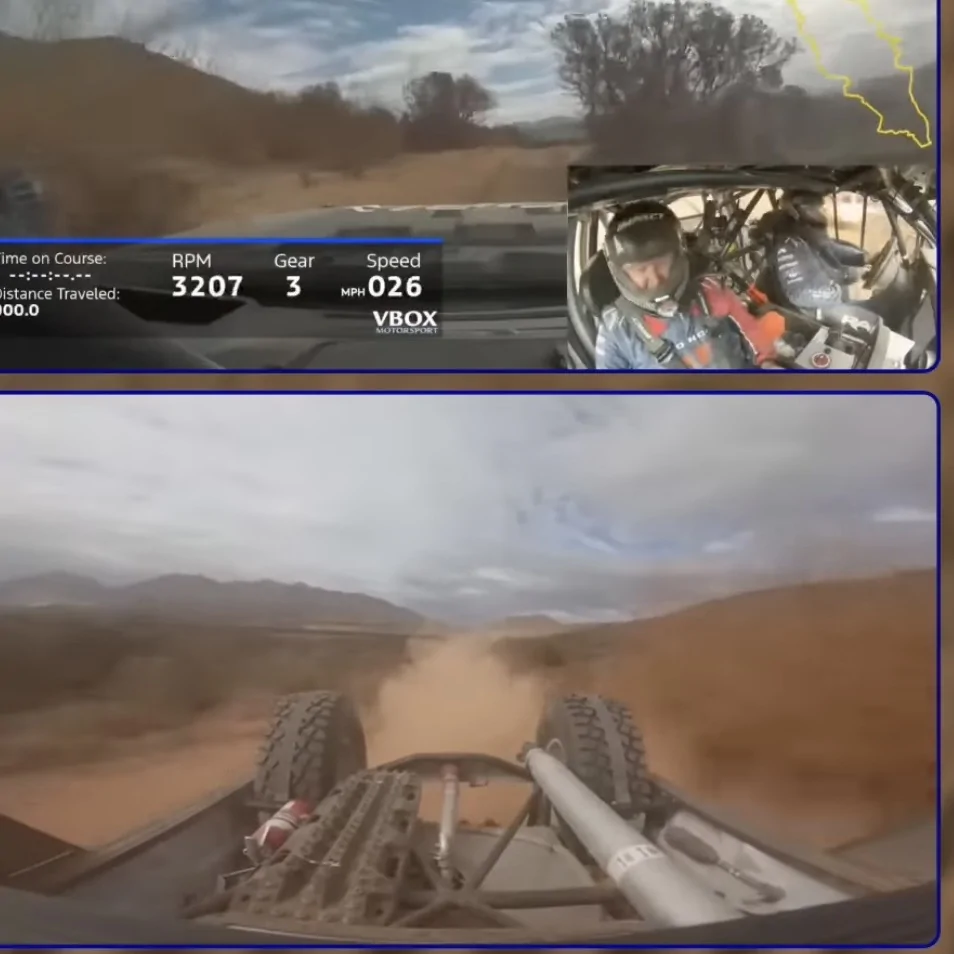

Some cool snap shots I got from their 4k 2025 video on Finke (Part 2):
Ford Ranger Ford Performance Ranger Raptor @ NORRA 1000 (Stage4) 1778505355205-5i
Ford Ranger Ford Performance Ranger Raptor @ NORRA 1000 (Stage4) 1778505404471-v5
Stock IC and ECU calibration (per class rules).

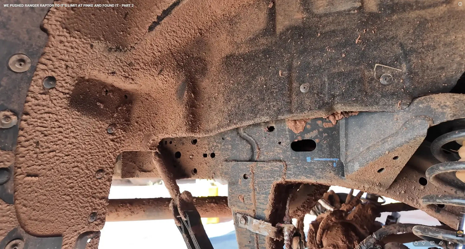

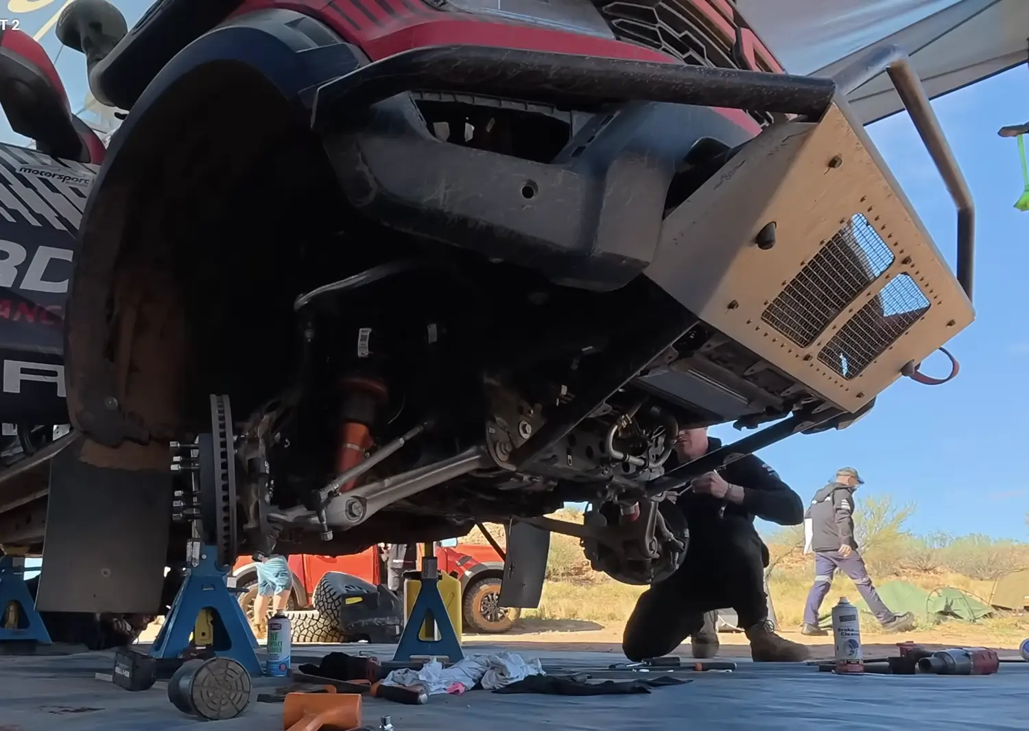

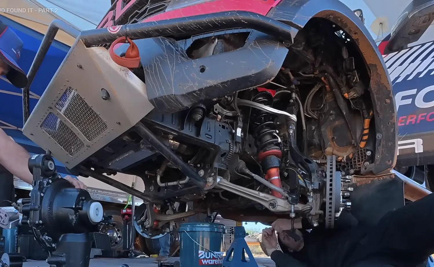

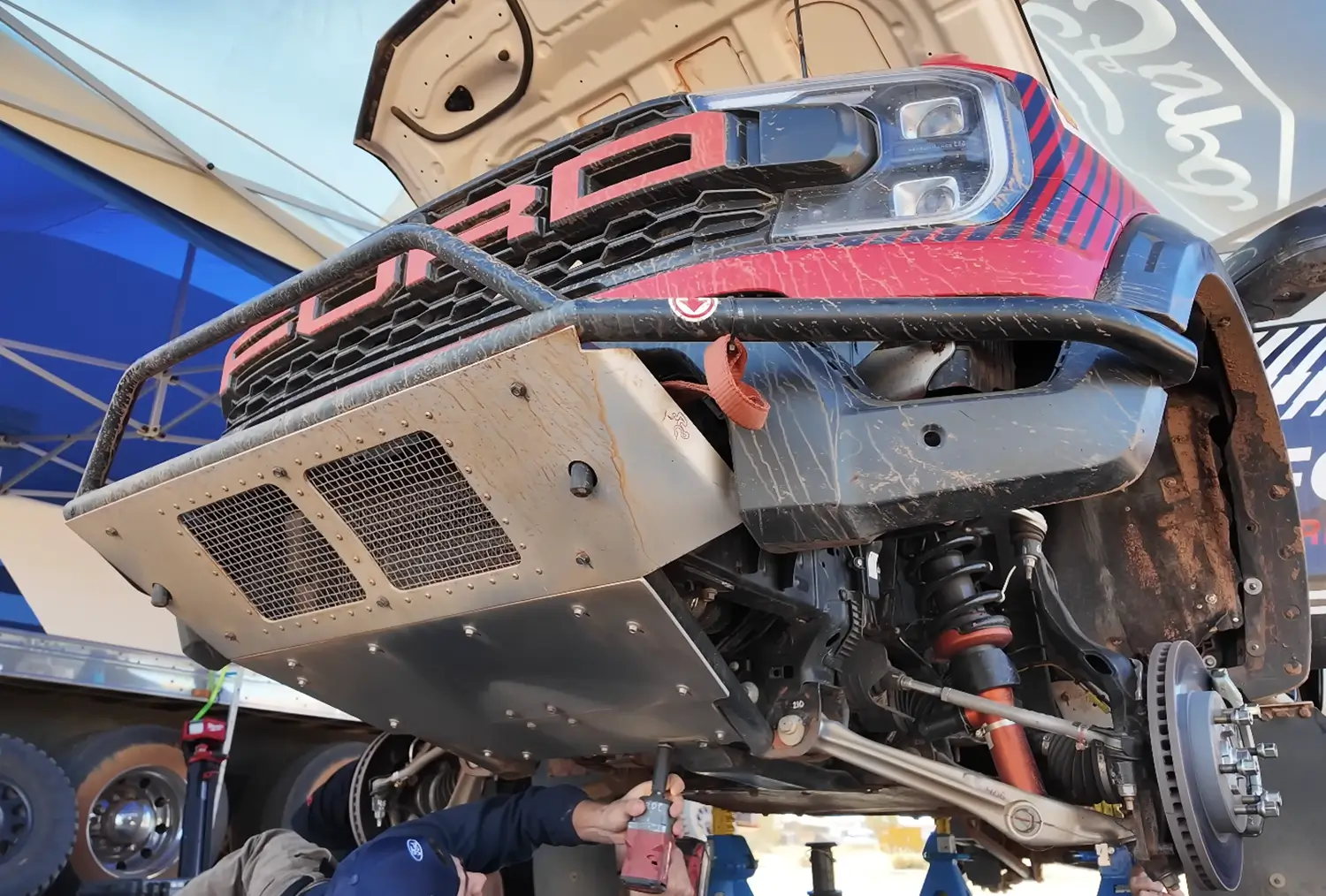

Now the big question on everyone's mind, how did they clear 35x12.5's on the front with only a perch collar? Simple: 1. Fender modification and 2. perch collar will limit travel more, so they may have only gotten 9" or 8" etc. of travel with the perch collar for pre-load adjustment.
Between the collar and fender liner being cut out considerably, it cleared 35x12.5 race tires.
Ford Ranger Ford Performance Ranger Raptor @ NORRA 1000 (Stage4) 1778505699654-5n

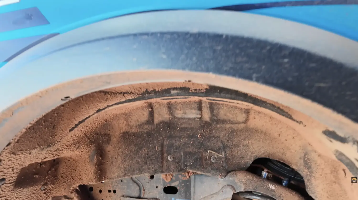

You can see the fender liner being all cut up, but the actual fender flare did not get modified as best I can see, just the inner fender liner. Here is a photo of the front with the fender liner removed when they were replacing the front diff that gave out at Finke in 2025 (whoops are brutal on the drive train):

RRaptorscallion0331
Colin
May 6, 2026
34
Hey Lion I really appreciate your summation of their mods! I don’t know what video I saw but at one point it showed the F150 Raptor bed view
I see the tires, the fire extinguisher, mat trax, what looks like a spare drive shaft, and one more smaller driveshaft in the middle?
My question is do you happen to know what kind of spares or recovery gear the Ranger Raptor had/has for any of their races?

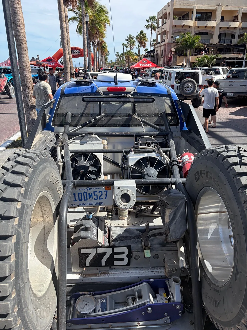

Finally back in the office / found a shot I took of the bed. There are 3 extra coolers in the back, one for oil and AT - the third one I didn't see it's spec. (Plus fast fill w/fuel cell)
I'll add that when I took a quick look under it, there were def. limit straps front and rear. Tie rods, UCA etc. all were factory oem. ( I didn't notice a perch collar, but it could have been there and I just didn't think to "see" it. ) . The rear was oem w/dif skid and some shock debris protectors mounted.
Oh yea - that rear door - nobody is riding in back, the rear pass seat was stripped out - safety cage and fresh air systems were residing back there.

I dont think they have any recovery gear that I know of. Any chase trucks for the Ranger Superduty would have that. I think their concern is more about parts failing from inpact and shock loads from high speed impacts and particualry the whoops at Fink which are brutal on drive trains.
In 2025 he said they passed at least 10 trophy trucks and buggies that broke down and several UTVs (assuming stuff like Can Ams etc.), the RR made it!
Spares are both the 35x12.5 race tires, but im not sure what compound they are running, I'd imagine same as whats on the truck.
They do have a jack and tools and im sure nuts / bolts for parts they expect might break.

Btw, if you look carefully at the front, the snapshot where the fender liner is removed while they were swapping the diff, I see zero evidence of any trimming of the fender flare.
But the actual fender liner looks pretty cut up to clear, my guess us they trimmed it up whenever it was rubving and maybe fabbed some brackets to push it up higher.

On the rear of the spares there were lug nuts individually zip-tied to the safety chassis. (which I thought was pretty smart fysa. )
