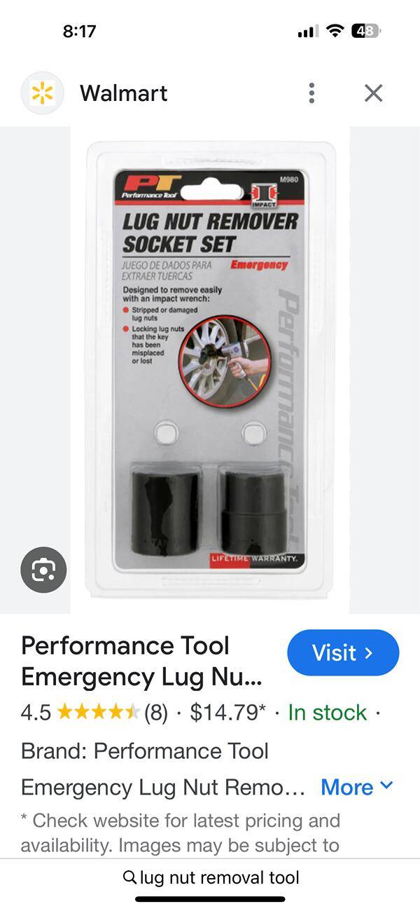

Ford lug nuts are what stopped me from ever using wheel locks again.
had a swollen ford nut round off and was stranded. Could not drive it with rim on the car.
fast forward kid and auto store had me use this. They are reverse threaded and lock once it bottoms out. No rim damage!
It damages the nut but will remove one.
kid also told me his gang friends used em to swipe rims off exotic cars including locks in seconds
Ford Ranger Ford stock Lug Nuts IMG_6899
