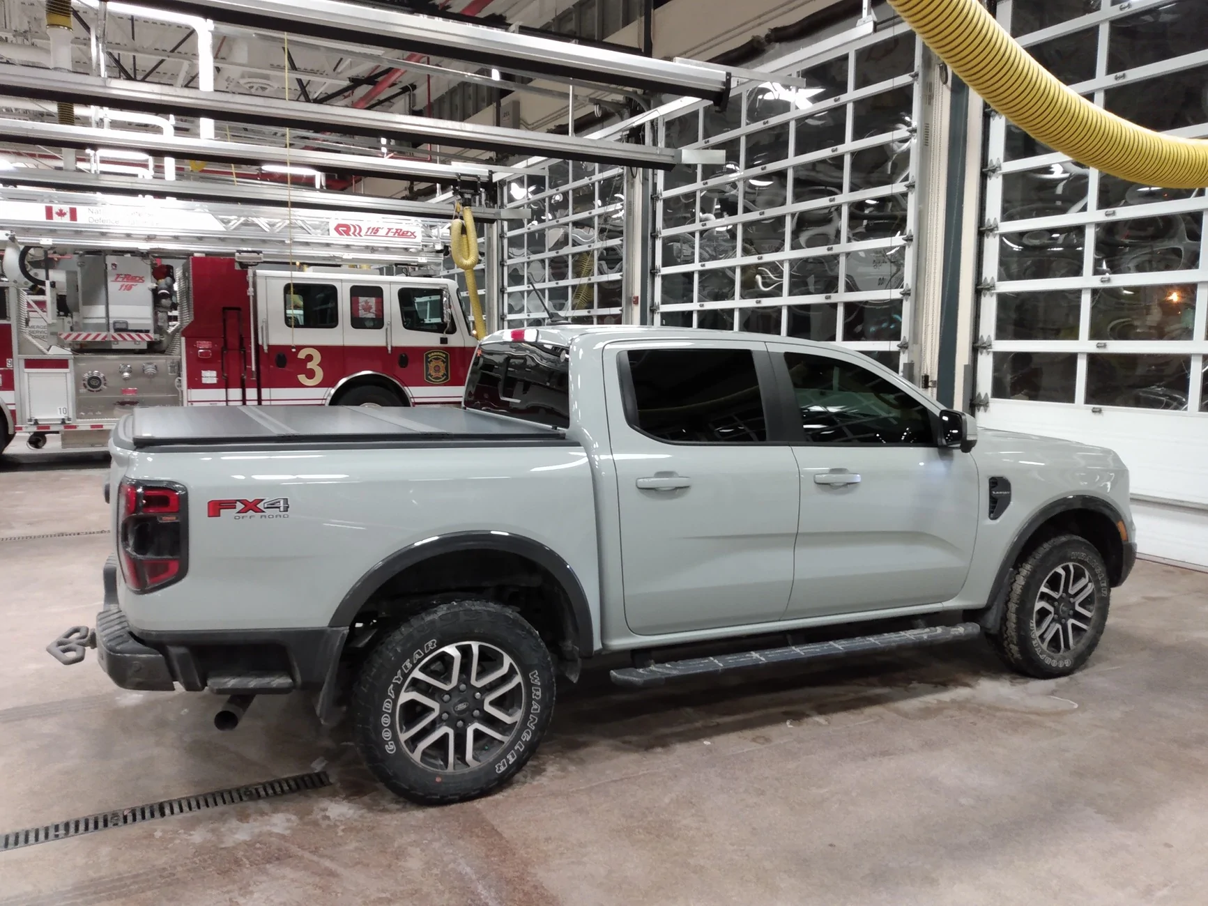

I was imagining what it would be like to change a tire at night with black lug nuts.
I stuck with chrome, one piece.
I added a half inch spacer with silver extended lug nuts. What is the torque on the lug nuts? I read 100 ft lbs and I also read 150 ft lbs. What have you heard or read?

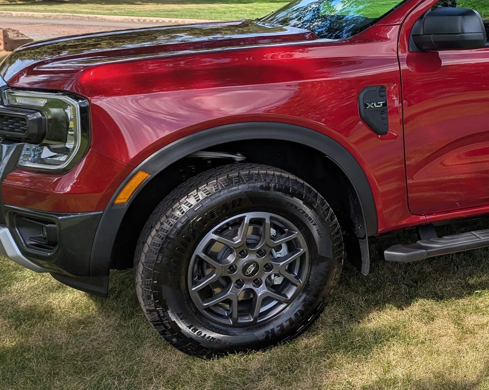

My truck came with lug nuts and in SoCal I don't worry about them seizing, so I'm running OEMs and a thicker wallet.

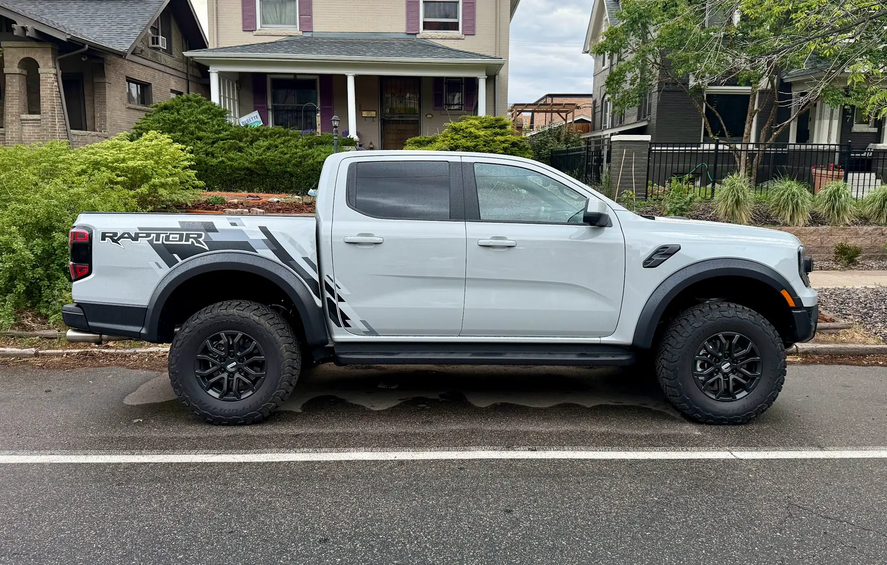

Ford Ranger What color are your lug nuts rraptor_leveled__post_settle_passenger_sid
OE non-beadlock Raptor wheels with black Gorilla nuts

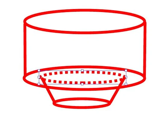

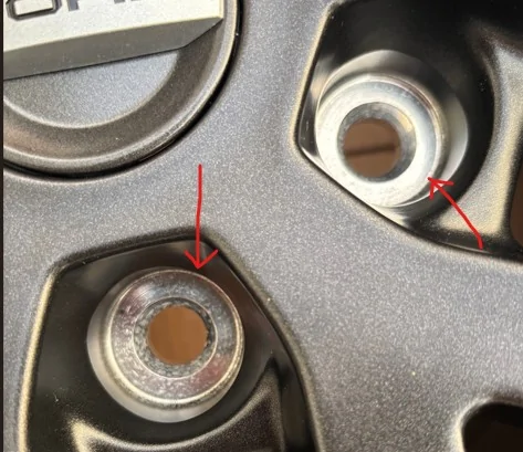

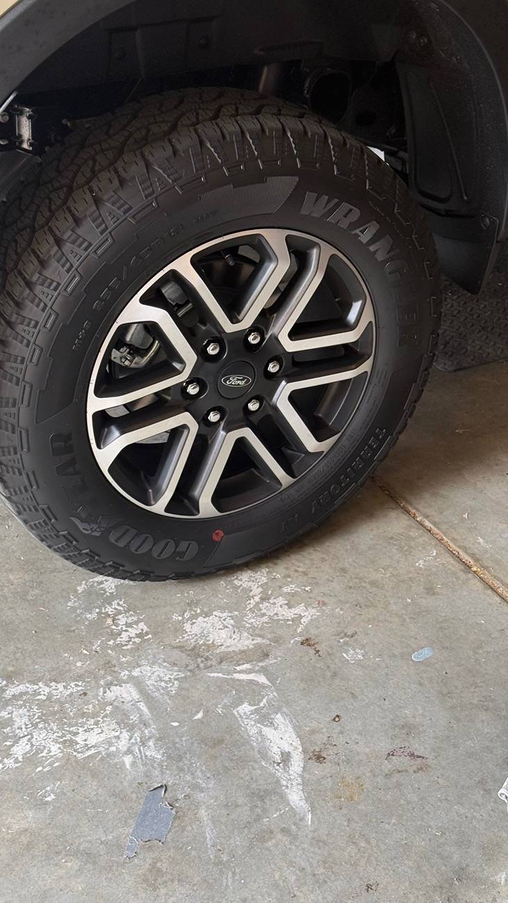

Thank you for all the feedback. Another issue has come up.
The other day I got a good look at the wheels and was examining the lug holes. I am try to determine what lug nuts these rims need. I have attached a drawing of the lug holes. The primary hole is a straight cylinder. At the bottom is a flat ring and then a smaller cone shaped hole. If you have these wheels, what lug nuts fits it?
Ford Ranger What color are your lug nuts Lug Hol
Ford Ranger What color are your lug nuts Flat lug nut hol

The inner (bore) hole shouldn't be cone shaped all the way thru the bore to back of wheel, if you were to measure the diameter where the cone starts, the diameter of where cone ends, and the distance between those points, the cone angle could be calculated which is very likely to be 60deg.
