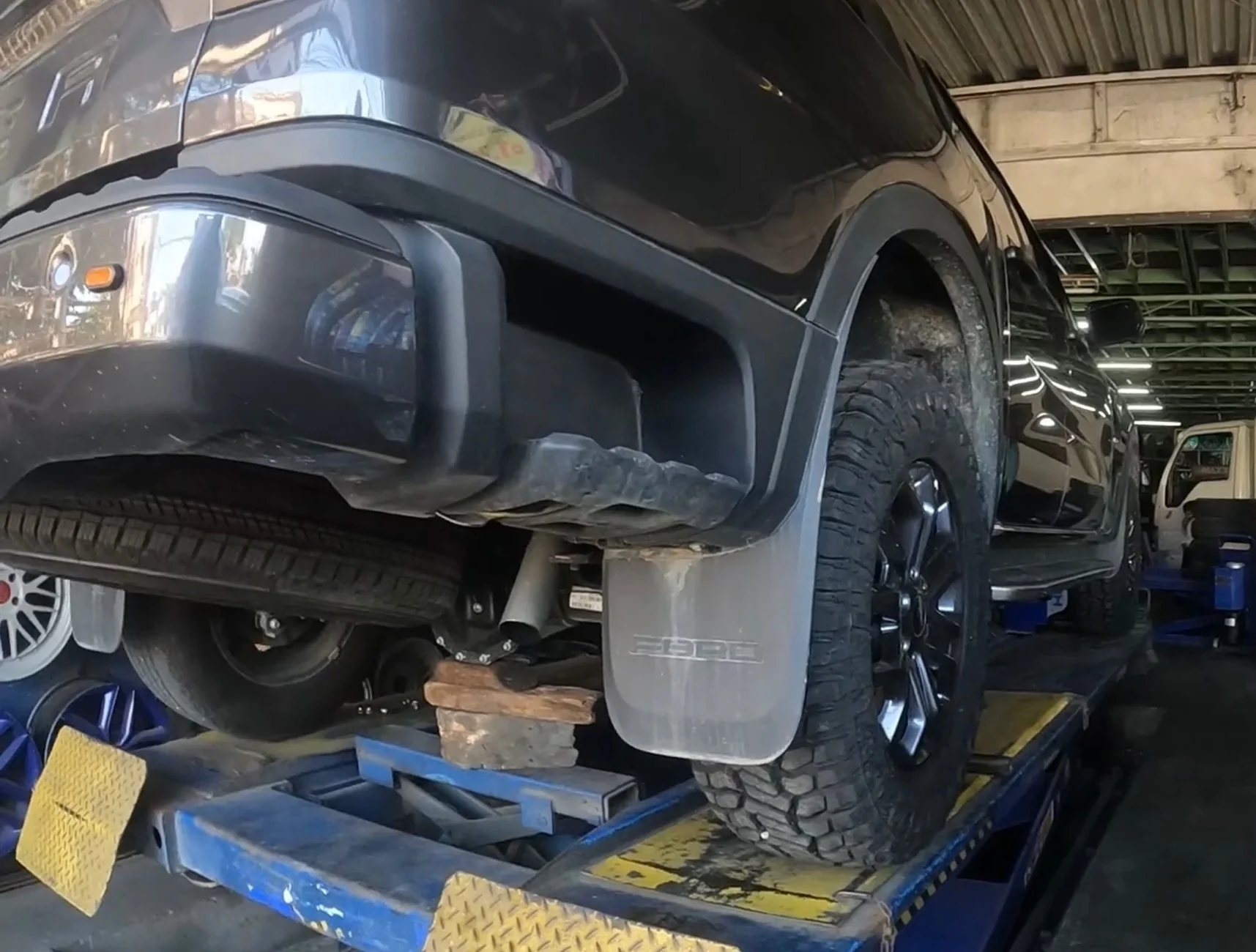

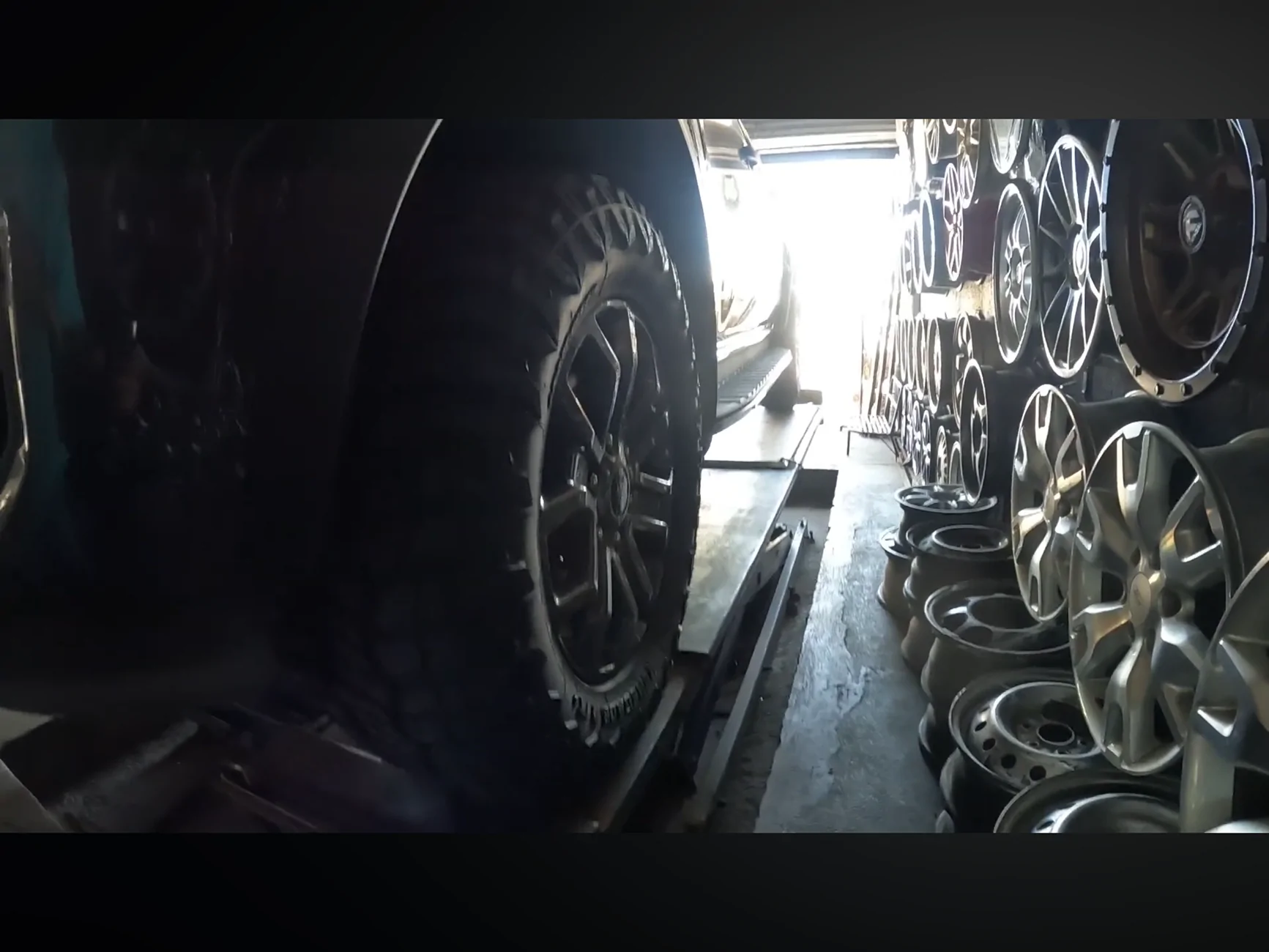

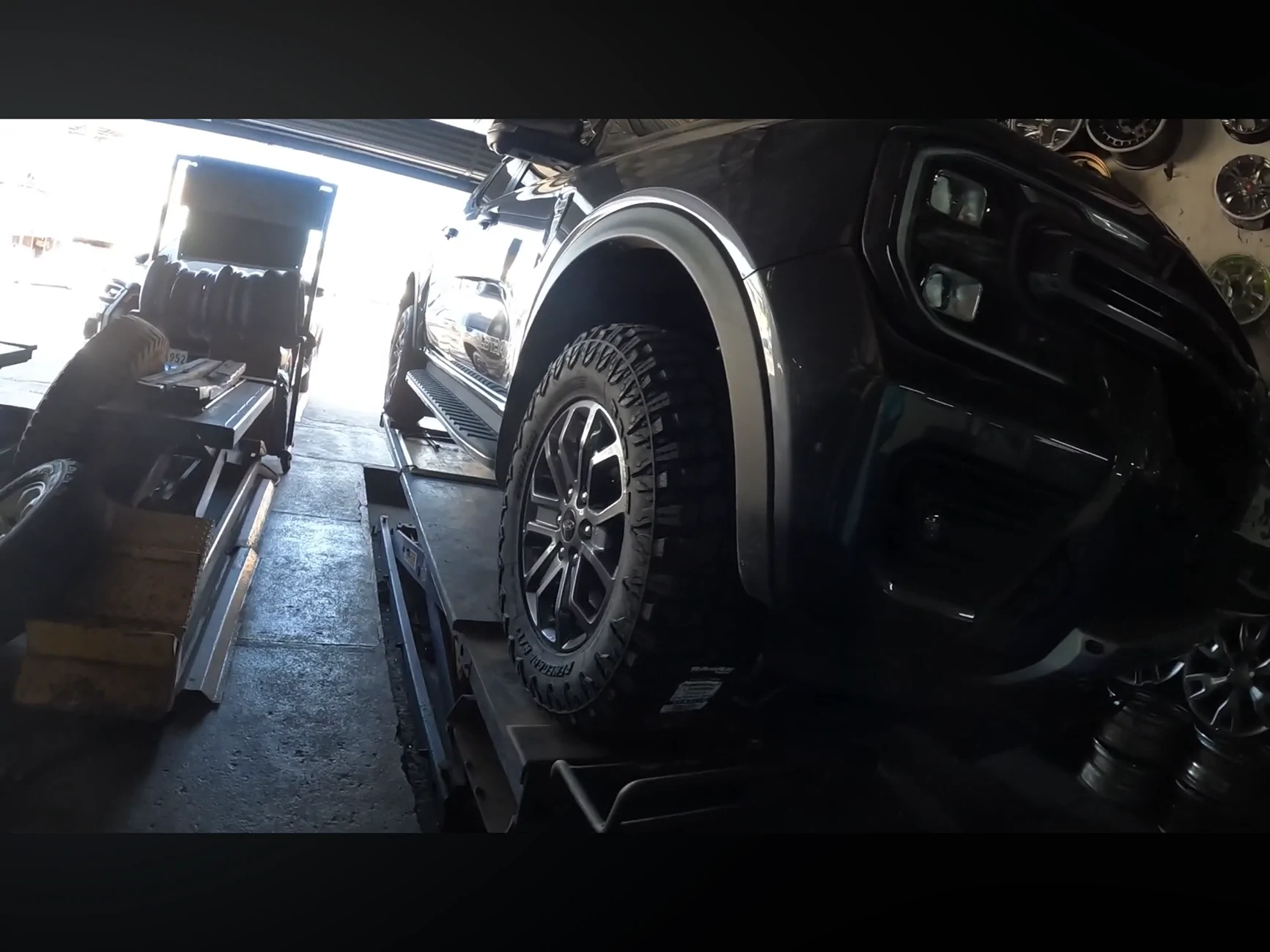

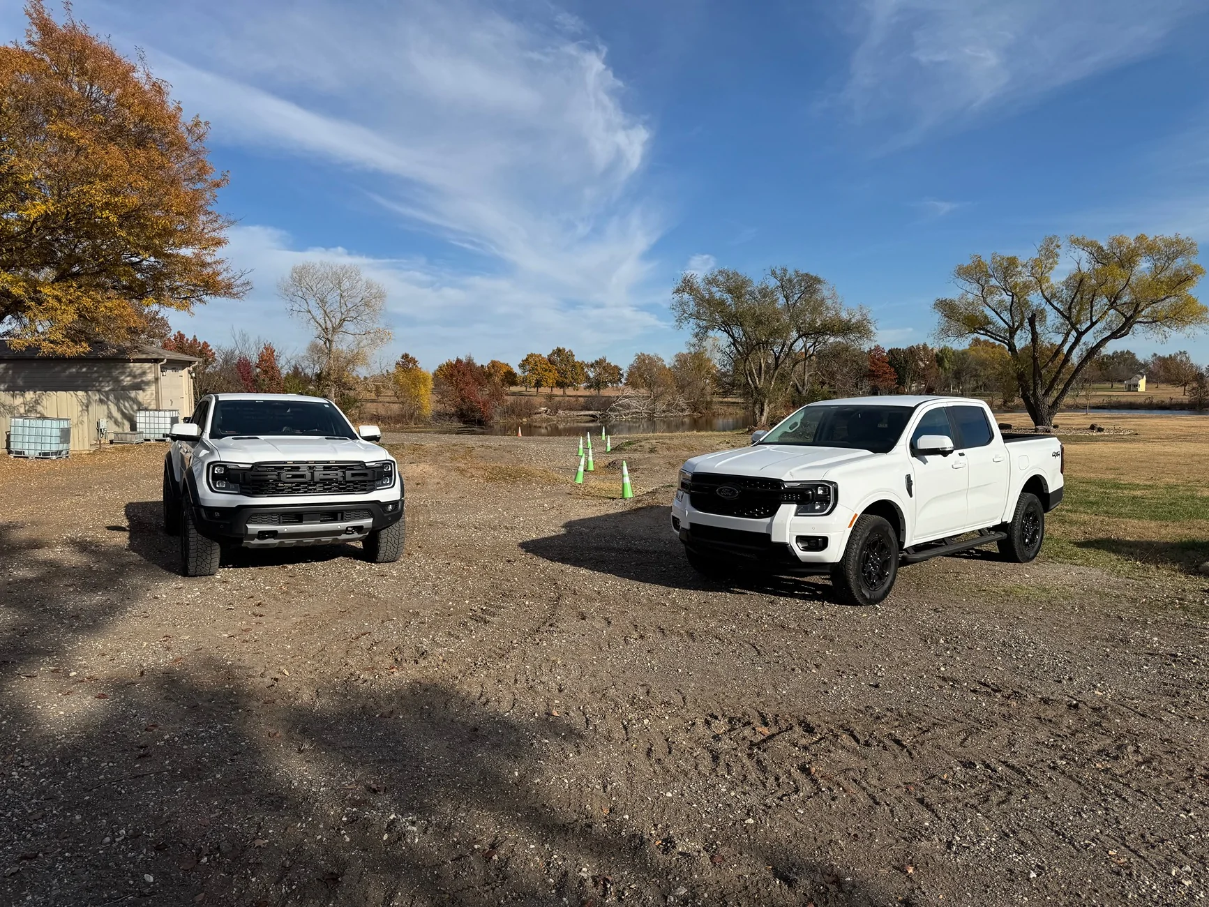

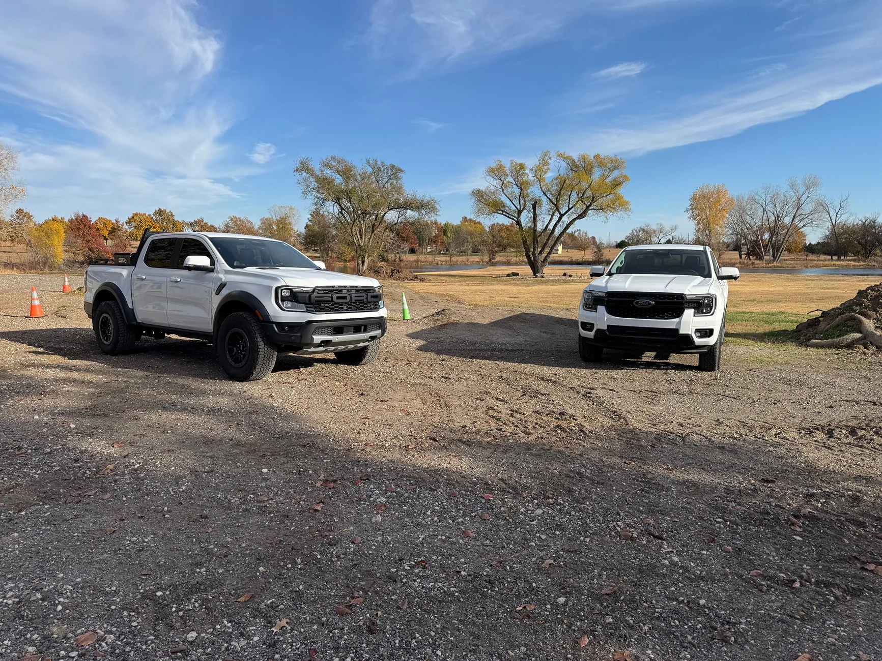

Put some stock Ranger Raptor wheels on one of the Lariat's tonight.
17x8.5 +55 wheels with BFG KO3s 285/70R17s .
Super tight with the UCAs. But they do clear.
Well they clear once we popped the rim lip balance wrights off. lol
Looks great on the truck IMO. They seem to be going to work. We, may need to have the fronts re-balanced with static weights. Lol

Here is wheel weights that were rubbing slightly on the control arms.
We heard the weights hitting just backing out of the garage. No high speed stuff.
Popped these off and rub resolved.
Ford Ranger What is the largest tire for a 100% stock 4x4 with Stock wheels? IMG_5321
Ford Ranger What is the largest tire for a 100% stock 4x4 with Stock wheels? IMG_5320
Ford Ranger What is the largest tire for a 100% stock 4x4 with Stock wheels? IMG_5322
Now there is a slight fender liner rub at full lock when backing up. No liner rub at full lock going forward. Overall fit much better then I expected. I didn’t think they would fit at all on a totally stock truck. A thin spacer might be a good to to put on there, but it will cause the fender liner rub to increase a bit.

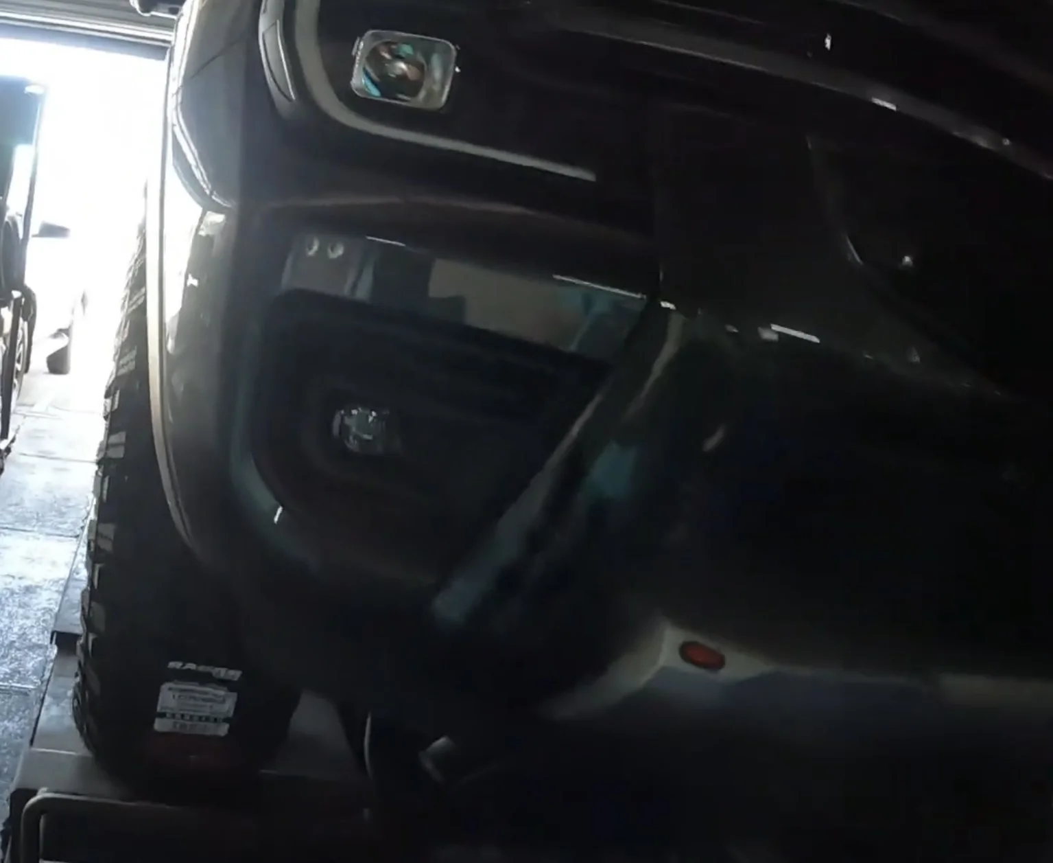

Maxxis Razr AT811 285/70R17 on Raptor wheels, and these seem to be a bit wider than the the BF's, as they rubbed on the UCA. I could rotate the tire by hand, but constant touching on the tire.
Put on 6mm spacers and that did the trick.

We did the Raptor wheel and BFG on a Lariat and it is super tight.
Had to pull the inner wheel weights off to clear the UCA, the BFG tire is narrow for a 285 so we cleared the tires fine but the Raptor wheel is 1/2 inch wider than the stock non-raptor wheels and with both wheels being a +55 offset that is what pushed the wheel weights into contact with the UCA. Other than having to pull the wheel weights off, we have not had any other issues with this setup.

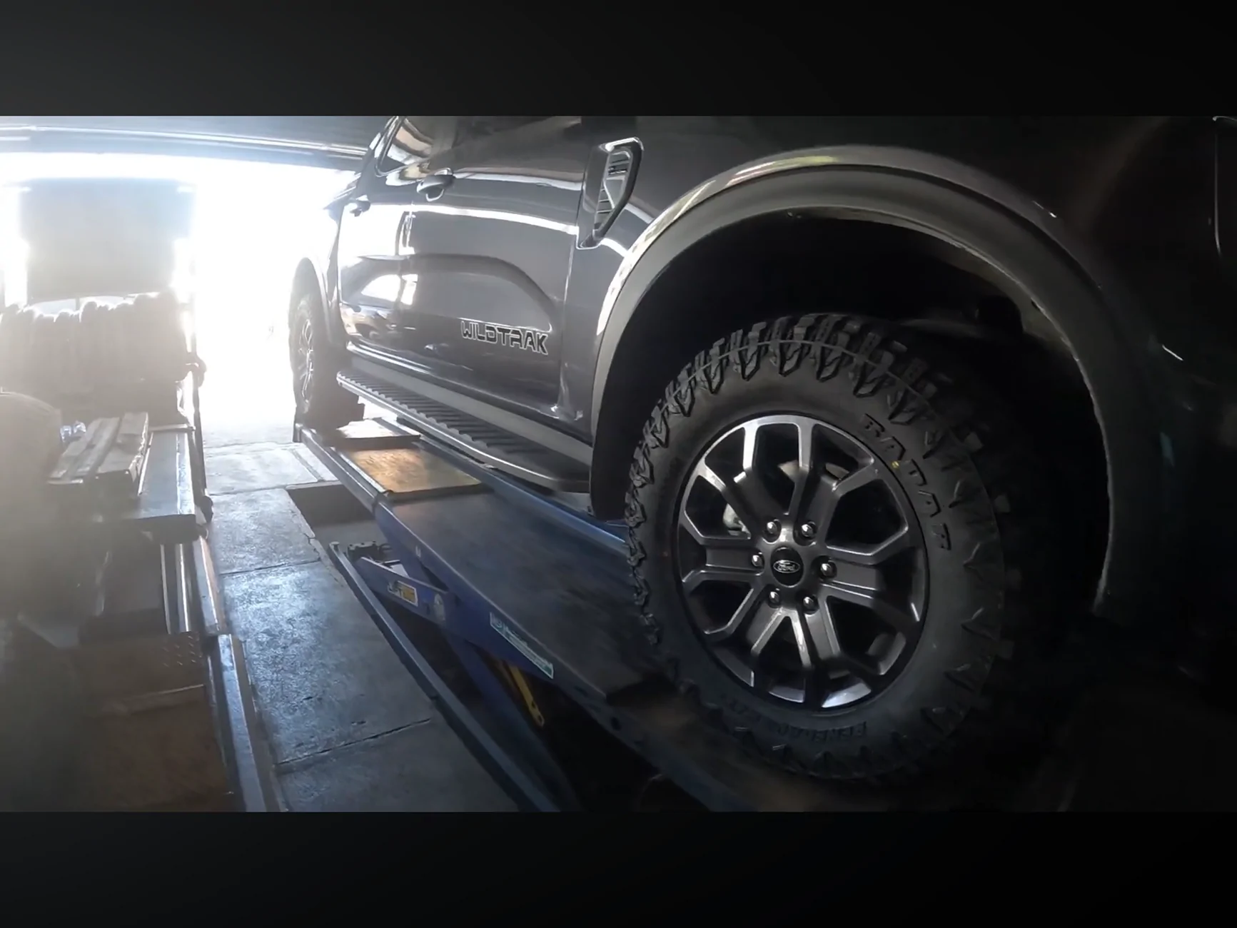

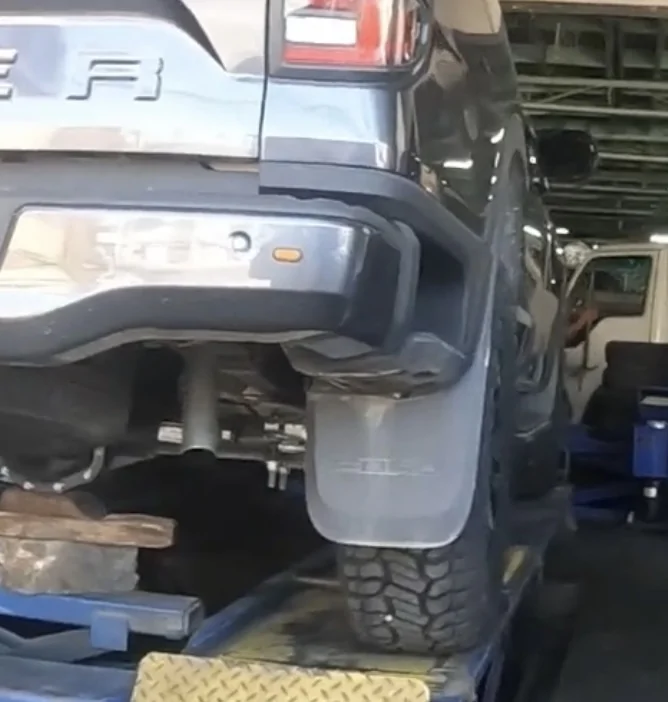

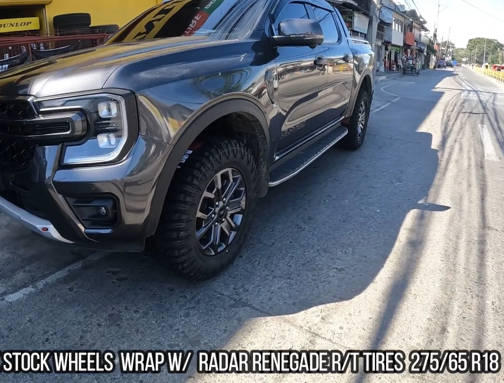

Stock Wheel spec 18x7.5 with a +55 offset.
‘Stock tire P255/65R18 that’s a 31x10 tire
Best I can tell from the research I have done so far is that a 275 is going to be max width and clear the UCAs without spacers on stock +55 offset wheels.
I am thinking this might be largest tire I can go and have 0 rub issues on a 100% stock truck on a stock wheel.
This is the tire I am thinking about putting on these trucks.
The P275/65R18 is a 32x11 tire
That’s an 1 inch taller and an 1 inch wider then the OEM tire size.
Is anyone running a 275/65R18 on their truck with stock wheels and no lift or wheel spacers?
Would love to see pics of that combo.
Thoughts or other ideas or combos that are larger then stock that work on a stock truck?
Somone else did the same upgrade and still swears there's no rubbing. 275 /65/
