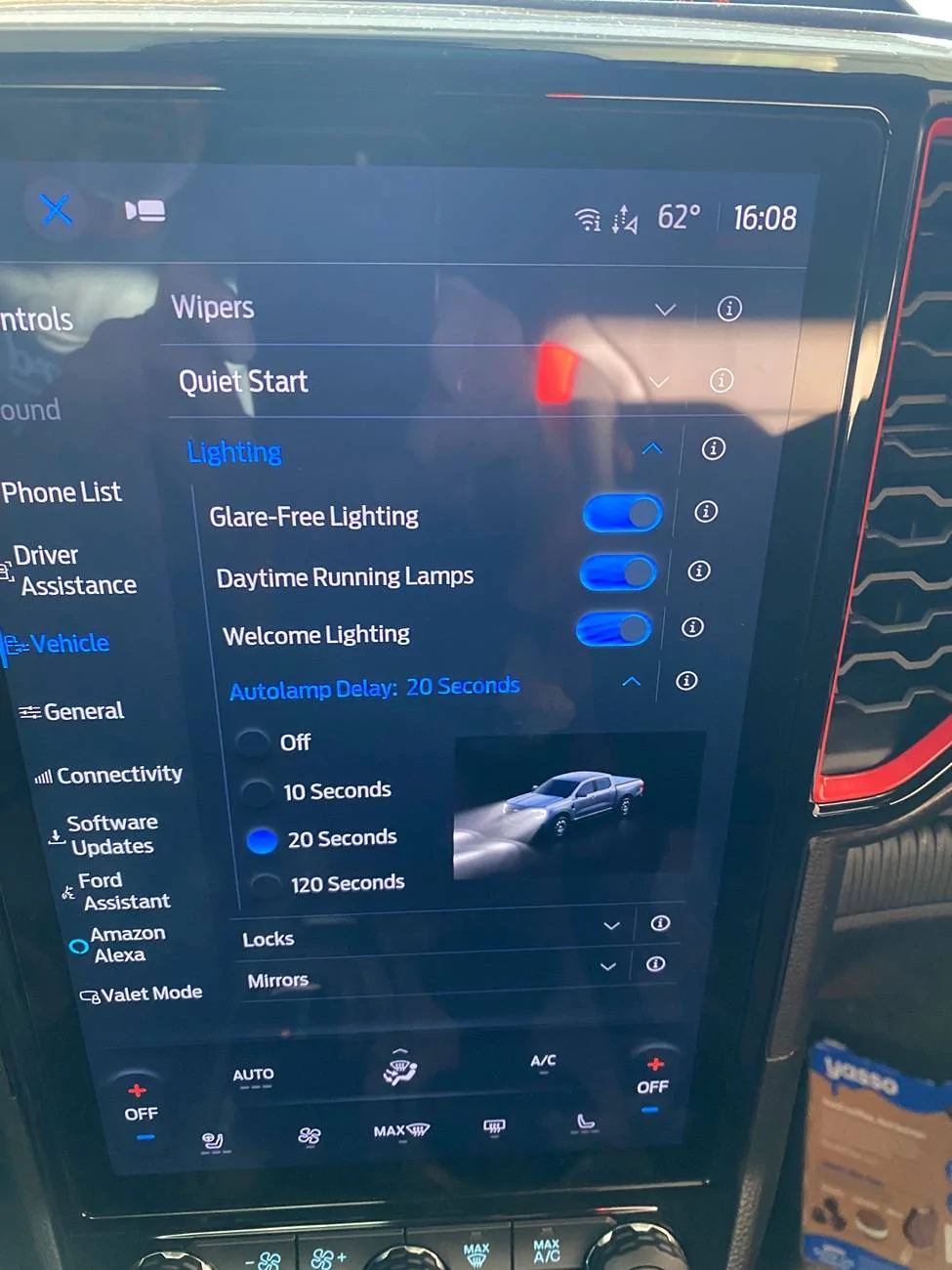

Alright, here we are, Lariat friends. I got some information from a Polish dealer on a Wildtrak X. This is verified working on a 2024 Lariat and ONLY Lariat. Save your As-Built information before you go messing with stuff. Craig please add or I also submitted an access request.
2024 Ranger Lariat, Glare-Free Headlights
ModuleAddressChanges
IPMA706-01-01xxxx-xxx9-xxxx
SCCM724-04-01xxx3-xxxx-xx
IPC720-10-01xxxx-xxx2-xxxx
HCM734-01-02x2xx-xxxx-xxxx
HCM734-01-04xxA5-4Exx
APIM7D0-09-01x1xx-xxxx-xxxx
APIM7D0-09-03xx8x-xxxx-xxxx

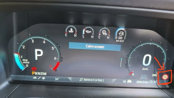

I have checked through forscan to get sign recognition on the speedometer but it didn’t work. Is there any way to activate it similar to the attachment picture.
Ford Ranger FORScan NA Ranger 6th Gen (2024+) Crowdsourced Spreadsheet IMG_2415

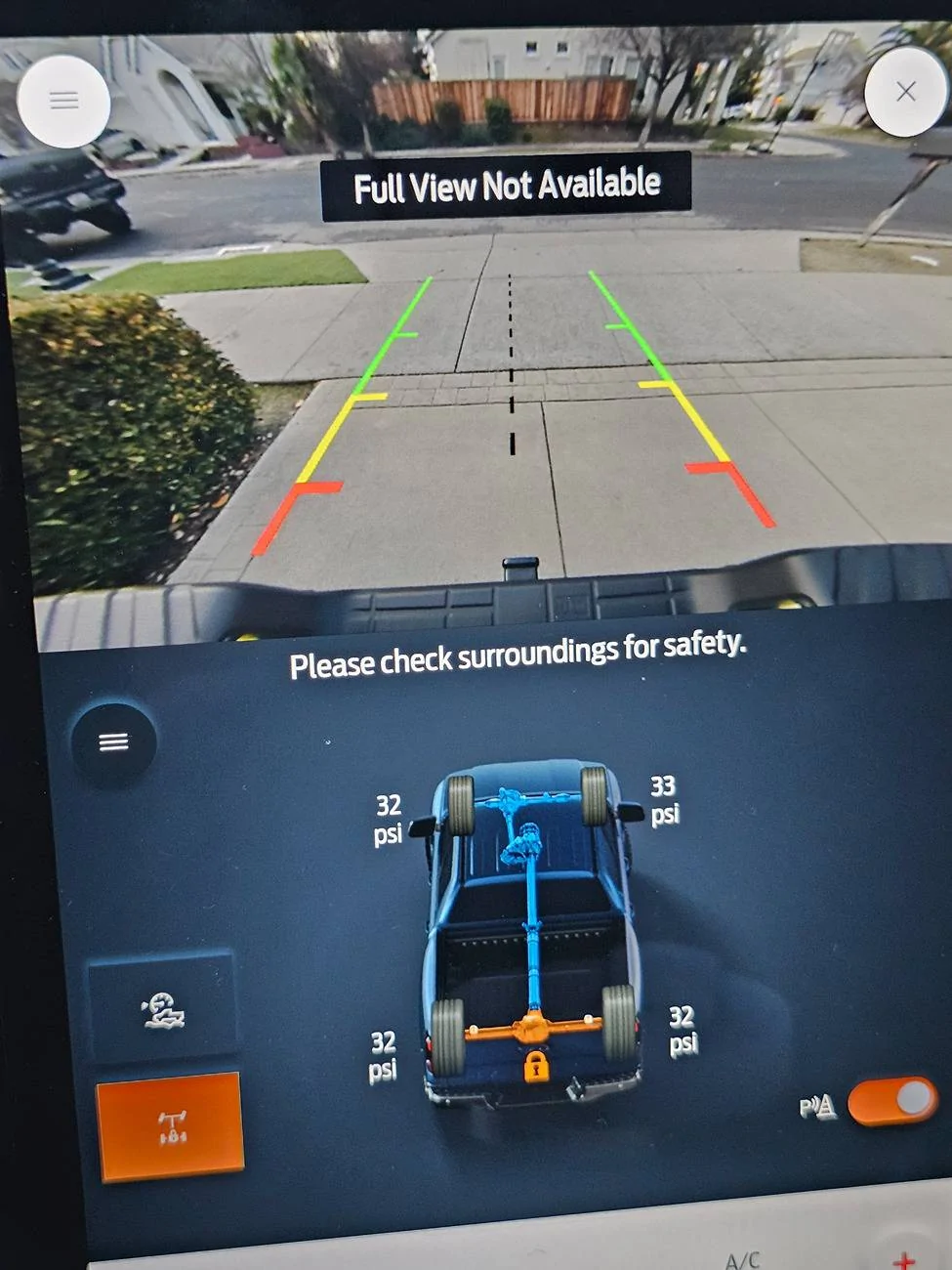

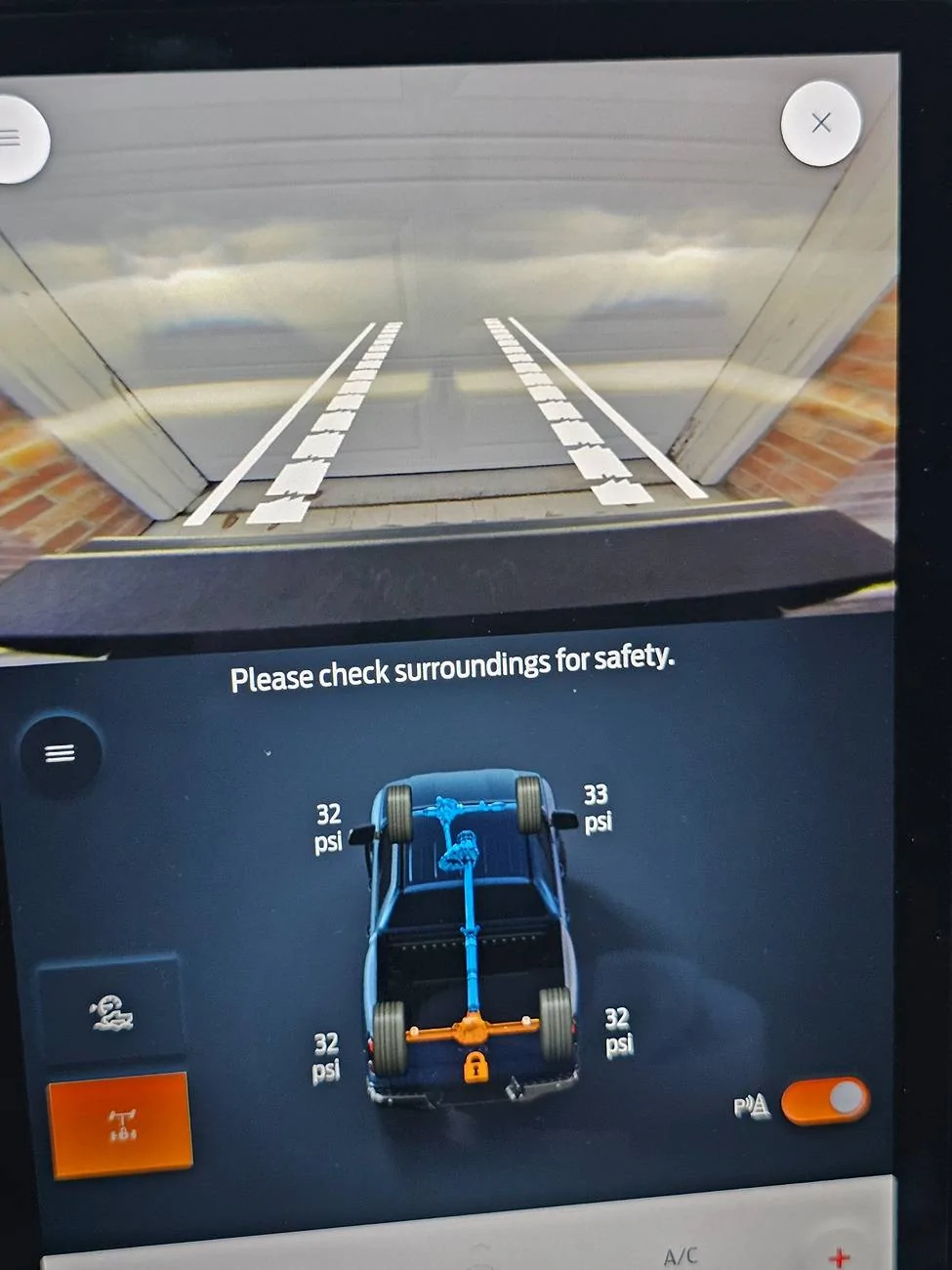

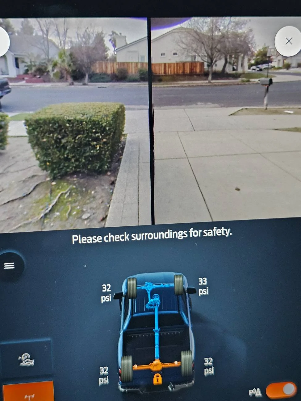

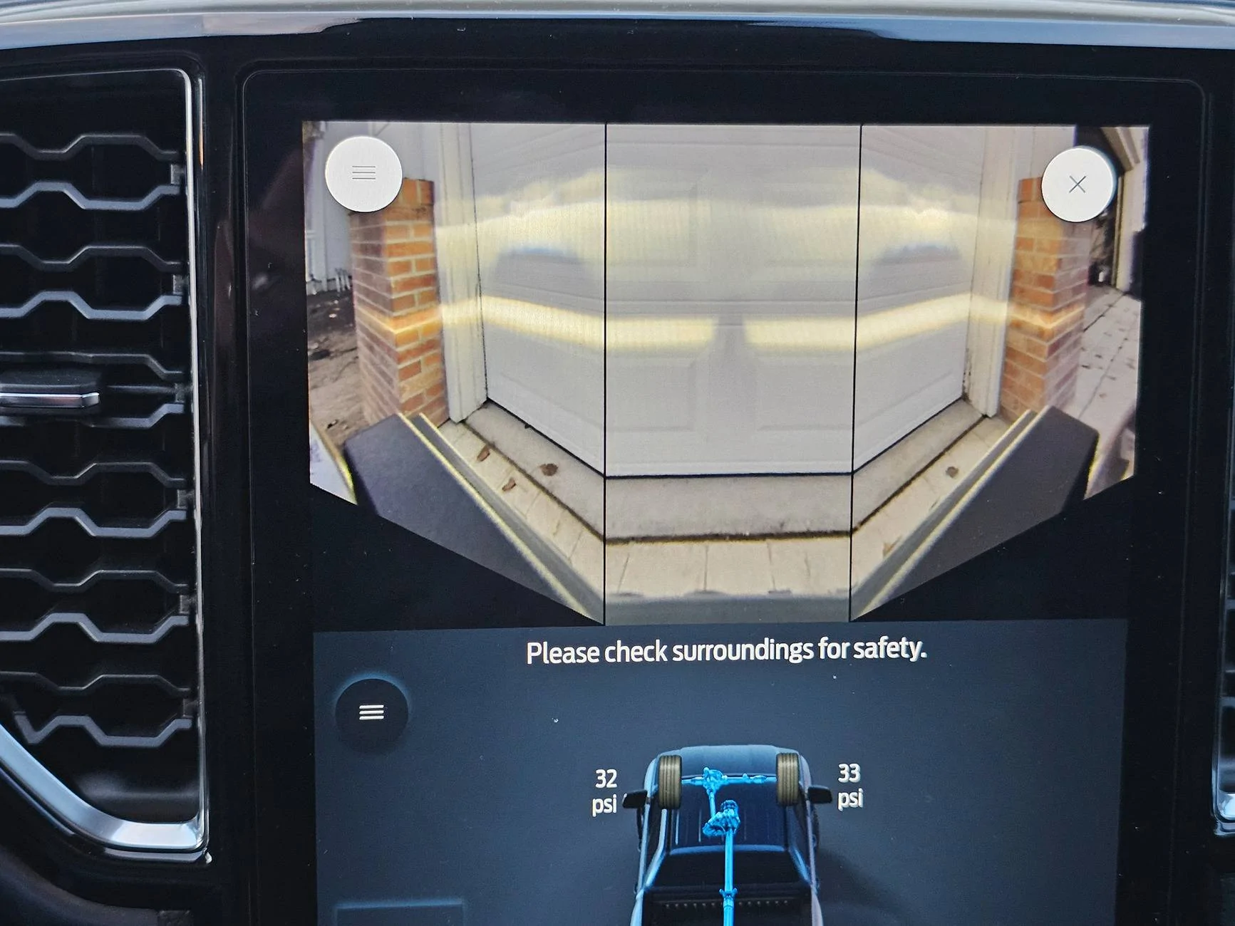

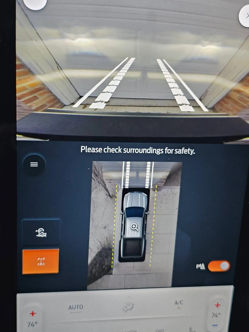

A warning about approach lighting if you didn't see the caution on the spreadsheet - it has been found this desentizes the touch free locking/unlocking of the door.
For Rock crawl, did you get the cameras to work as they do on a Raptor?
Haven't noticed any sensitivity change.
As for the camera views..
Ford Ranger FORScan NA Ranger 6th Gen (2024+) Crowdsourced Spreadsheet 20250107_165820
Ford Ranger FORScan NA Ranger 6th Gen (2024+) Crowdsourced Spreadsheet 20250107_165847
Ford Ranger FORScan NA Ranger 6th Gen (2024+) Crowdsourced Spreadsheet 20250107_165859
Ford Ranger FORScan NA Ranger 6th Gen (2024+) Crowdsourced Spreadsheet 20250107_165835
Ford Ranger FORScan NA Ranger 6th Gen (2024+) Crowdsourced Spreadsheet 20250107_165545
Ford Ranger FORScan NA Ranger 6th Gen (2024+) Crowdsourced Spreadsheet 20250107_165804
Ford Ranger FORScan NA Ranger 6th Gen (2024+) Crowdsourced Spreadsheet 20250107_165554
Can't say if they are any different than before the upgrade.

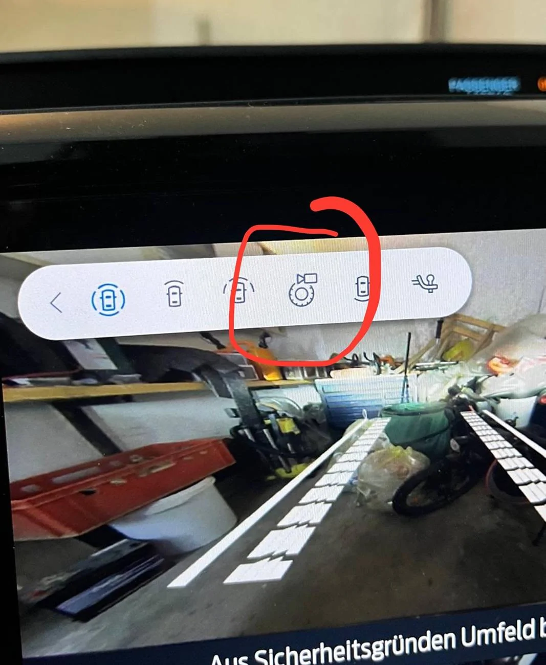

Somewhere I once saw the instructions on how to get rid of the “Full View…” message. I don’t remember which setting it was.
Has no one been able to activate the wheel camera yet? I have the symbol, but pressing it doesn’t do anything.

The Bronco has it. It displays the front wheels in split view. This was already discussed here in the thread, but without a solution.
Ford Ranger FORScan NA Ranger 6th Gen (2024+) Crowdsourced Spreadsheet IMG_3965
