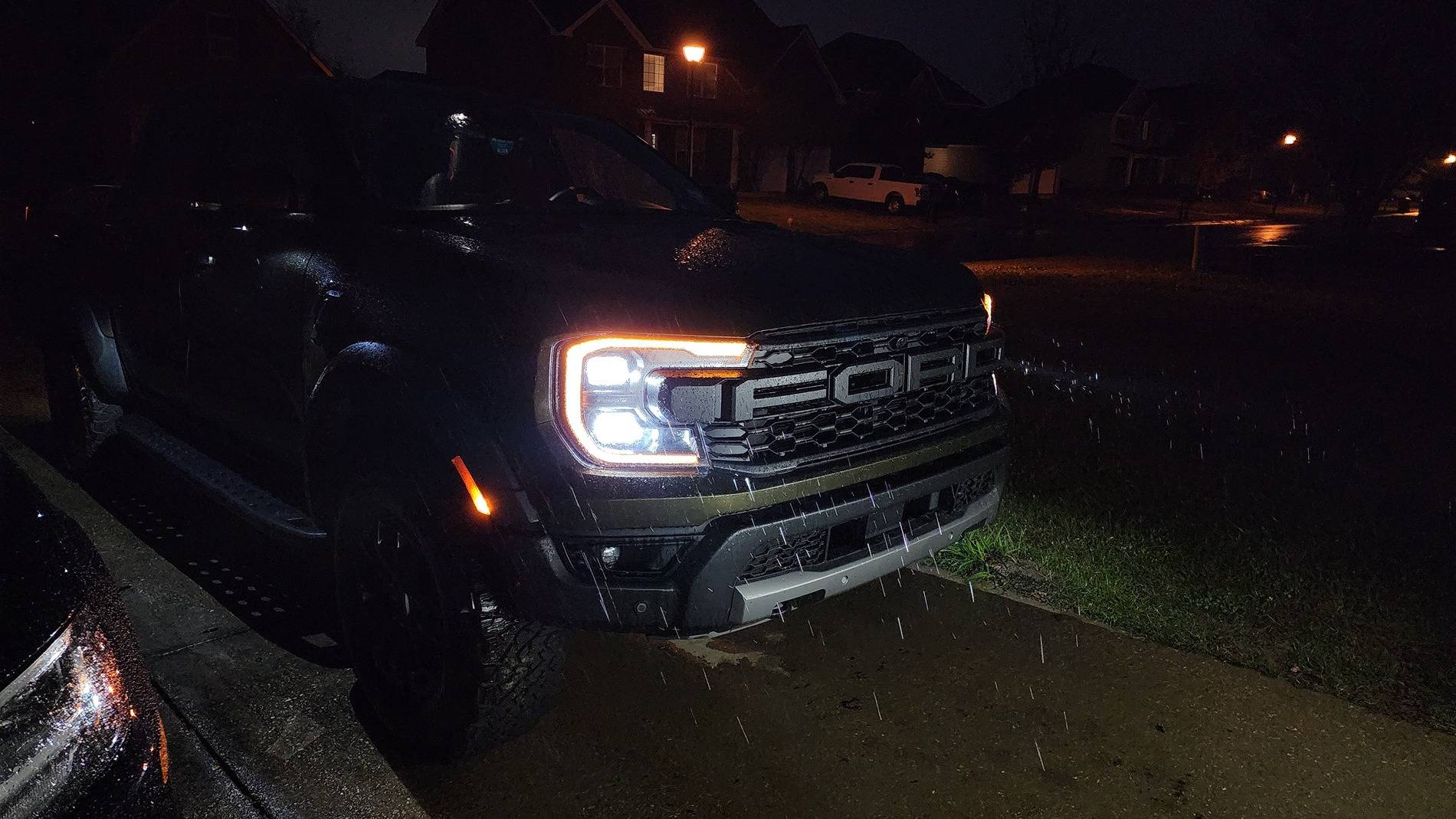

Just confirmed that the BCM asbuilt coding in 726-38-01 works the same for the Rangers as it does for the Explorers and F150s. This adjusts the brightness of the DRL C-clamps when they are in the "dimmed" mode. This is basically when the truck is parked and running, parking lamps, and low beams are on, or when the truck is unlocked. It doesn't look like it changes the brightness of the DRLs when the usual triggering condition is met (Truck in drive or reverse, autolamps are on, and low beams are off). I set mine to 4B along with my amber film to get the right balancewith the headlights on
Behavior is below:
726-38-01 xxxx **xx xx--
64 =100%
5A = 90%
4B =75%
32 = 50%
19 = 25%
0A =10%
