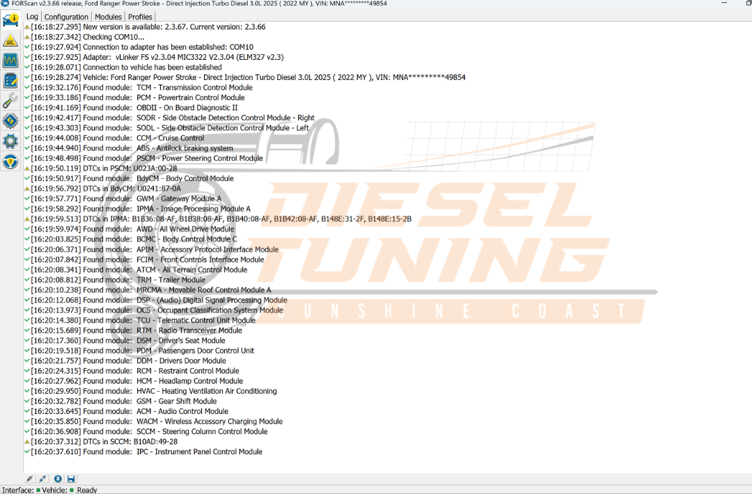

Tried enabling glare free high beams tonight on my 26 Raptor. Tried twice and each time I ended with 4 diagnostic codes, so I rolled back the changes.
DTCs were:
pscm - U023A:00-28 (lost communications with image processing
module A)
RCM - B00DF:4A-08 (passenger restraints disable switch - incorrect component installed)
HCM - U2101: 00-08 (control module configuration incompatible)
IPC - U0415:00-08 (invalid data received from abs control module)
Not sure what the issue is but it feels like something has to have changed?

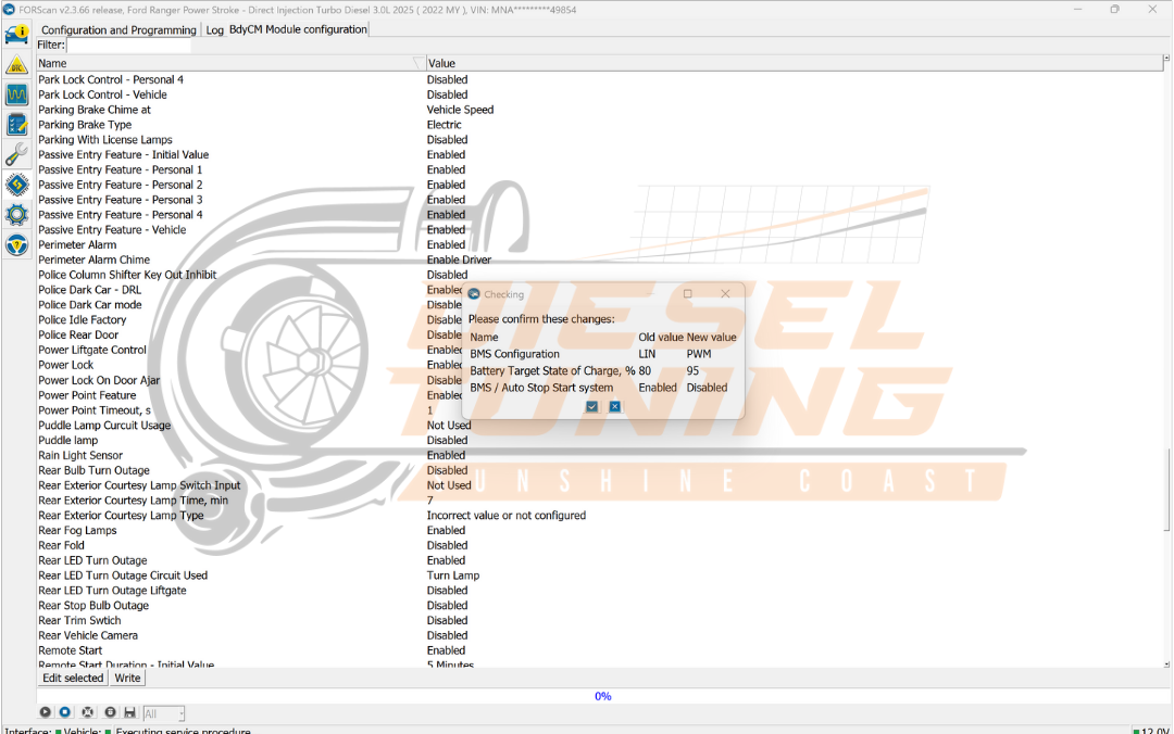

hi folks. just went through all 79 pages for the mods I can do for my new XL STX ranger. I noticed nothing was mentioned for actually disabling the start-stop function. Noticed the following from this site:
Disable Auto Start/Stop: Ranger & Amarok - SC Diesel Tuning
Step-by-step (1, 2, 3)

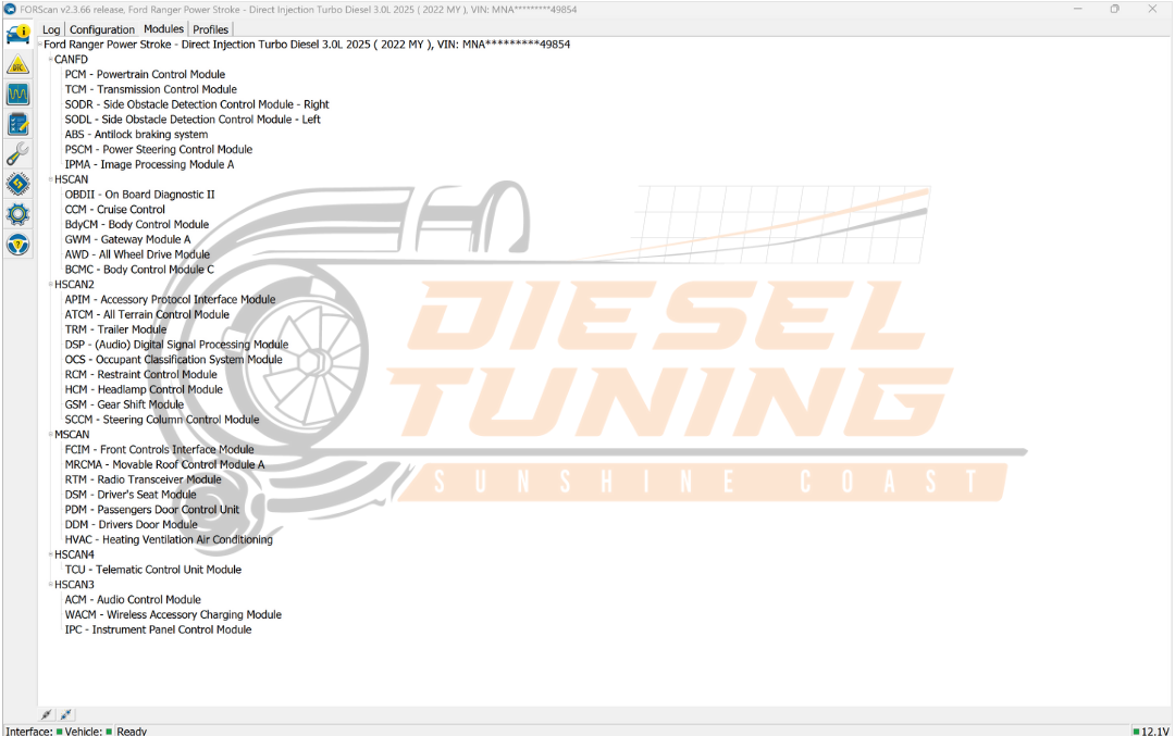

  1. Connect, scan, and confirm modules are available
    Plug in the correct adapter for your vehicle, turn ignition ON (engine OFF), connect in FORScan, and let it build the vehicle profile.
    Before changing anything, confirm the required modules appear in the list.
    Ford Ranger FORScan NA Ranger 6th Gen (2024+) Crowdsourced Spreadsheet 01-module-list
    Figure 1: Confirm all modules load before changing anything.

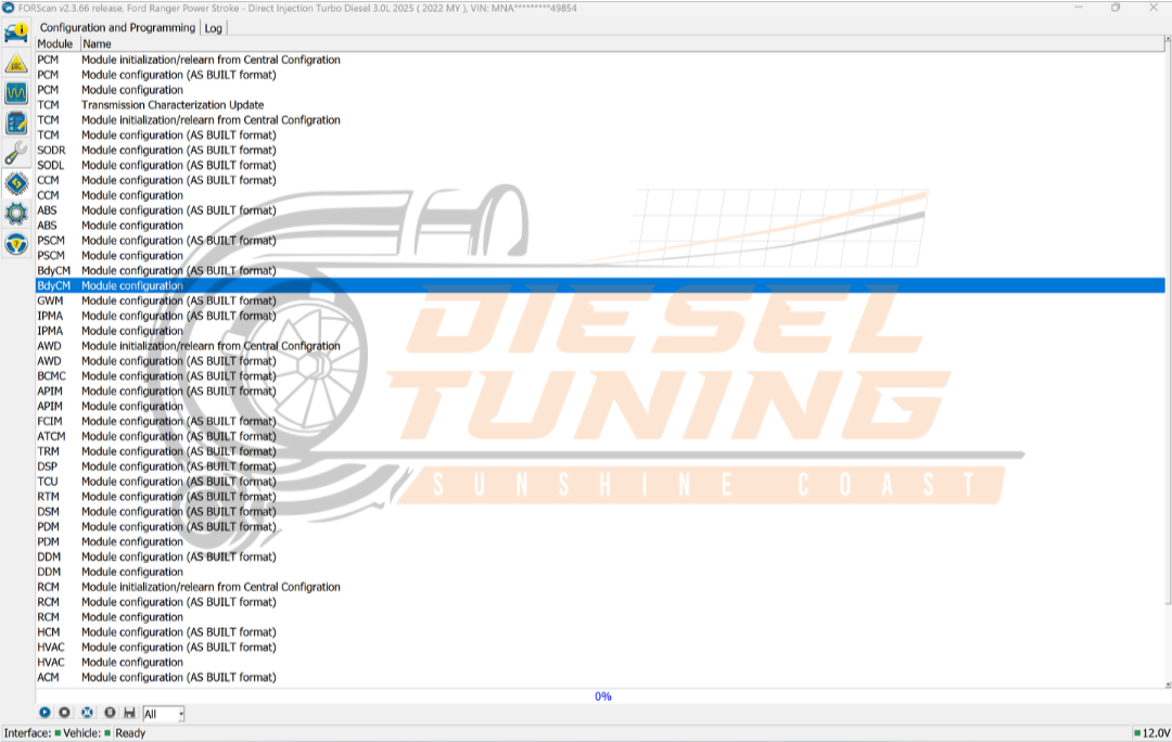

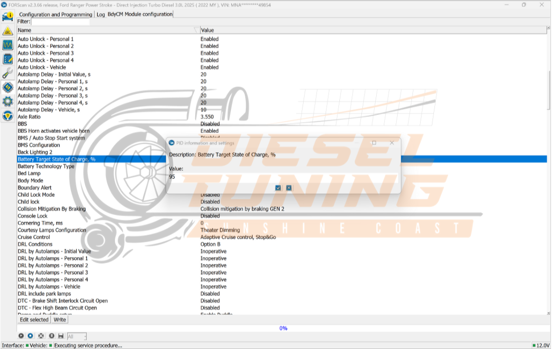

  2. Disable Start/Stop in BdyCM (Body Control Module)
    These are the key changes that disable Start/Stop logic and adjust battery strategy.

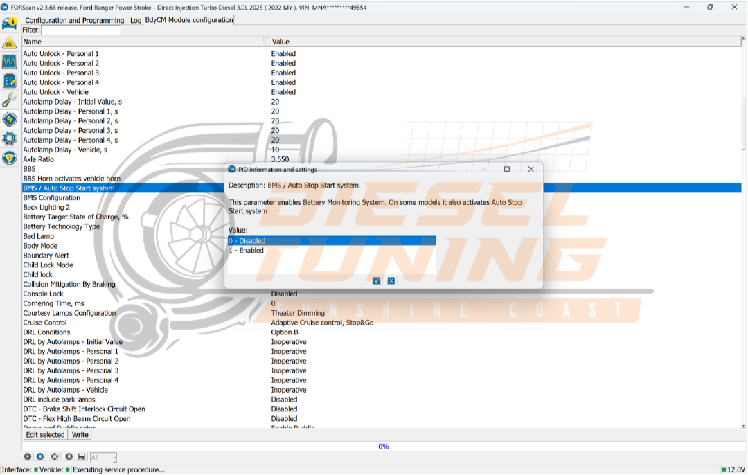

    1. Select BdyCM and enter configuration.

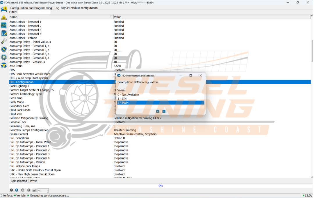

    2. Set BMW/Start Stop to Disable.
    3. Change BMW Config to PWM.
    4. Change Battery Target to 95%.
    5. Write changes and confirm.
  3. Ford Ranger FORScan NA Ranger 6th Gen (2024+) Crowdsourced Spreadsheet 02-bdycm-play
    Figure 2: Open BdyCM to access Start/Stop-related settings.
    Ford Ranger FORScan NA Ranger 6th Gen (2024+) Crowdsourced Spreadsheet 03-bmw-startstop-disable
    Figure 3: Set BMW/Start Stop to Disabled.
    Ford Ranger FORScan NA Ranger 6th Gen (2024+) Crowdsourced Spreadsheet 04-bmw-config-pwm
    Figure 4: Change BMW Config to PWM.
    Ford Ranger FORScan NA Ranger 6th Gen (2024+) Crowdsourced Spreadsheet 05-battery-target-95
    Figure 5: Increase Battery Target to 95%.
    Ford Ranger FORScan NA Ranger 6th Gen (2024+) Crowdsourced Spreadsheet 06-write-confirm-bdycm
    Figure 6: Confirm the changes, then write to BdyCM.

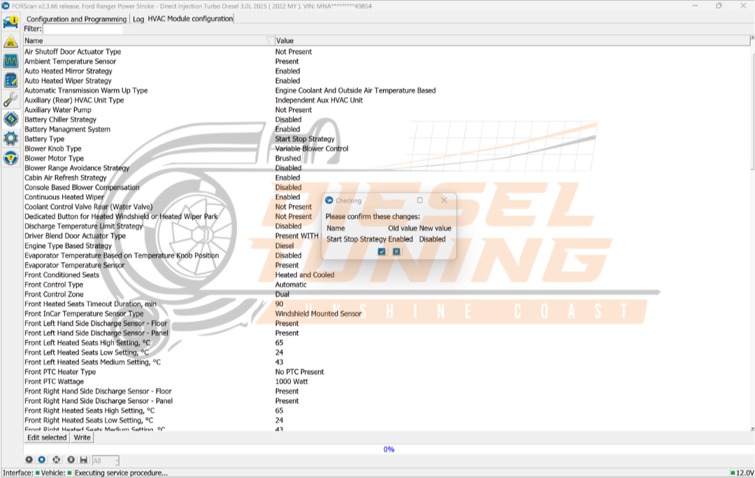

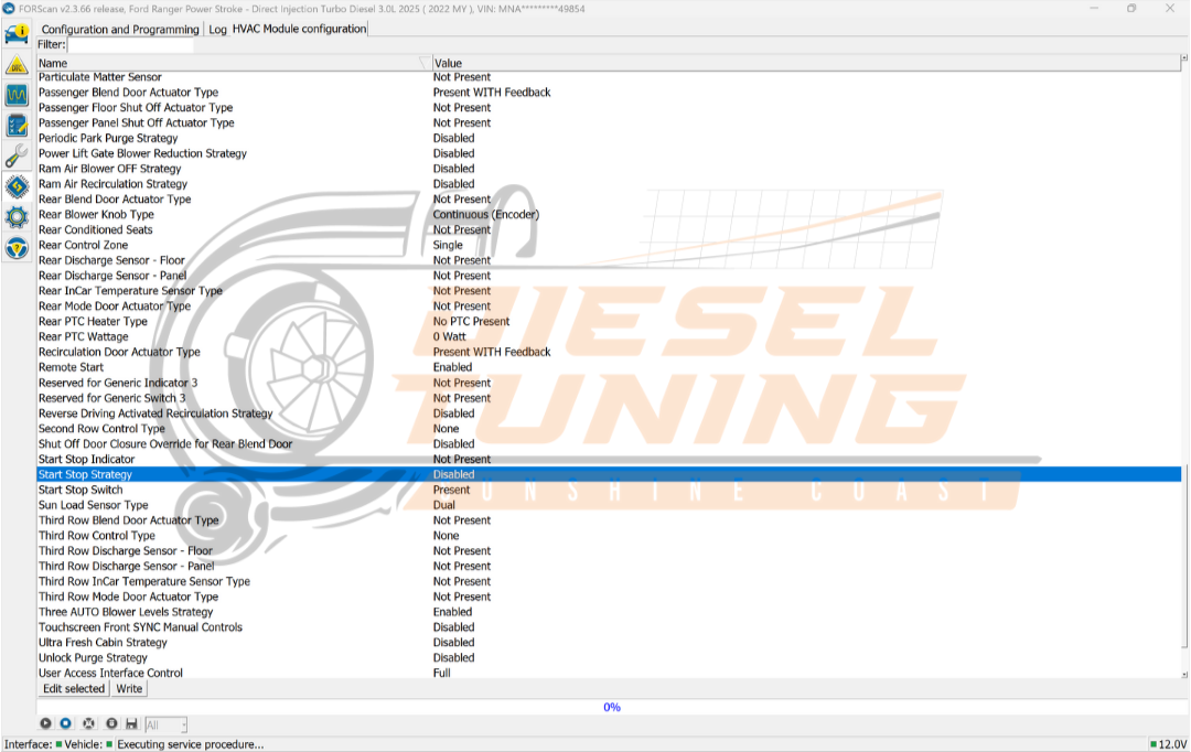

  4. Disable Start/Stop strategy in HVAC
    This step disables Start/Stop strategy inside the HVAC module so the system doesn’t try to influence Start/Stop behaviour.
    1. Open HVAC configuration.
    2. Set Start Stop Strategy to Disabled.
    3. Write changes and confirm.
  5. Ford Ranger FORScan NA Ranger 6th Gen (2024+) Crowdsourced Spreadsheet 07-hvac-strategy-disabled
    Figure 7: Disable Start/Stop strategy in the HVAC module.
    Ford Ranger FORScan NA Ranger 6th Gen (2024+) Crowdsourced Spreadsheet 08-write-confirm-hvac
    Figure 8: Confirm and write HVAC changes.

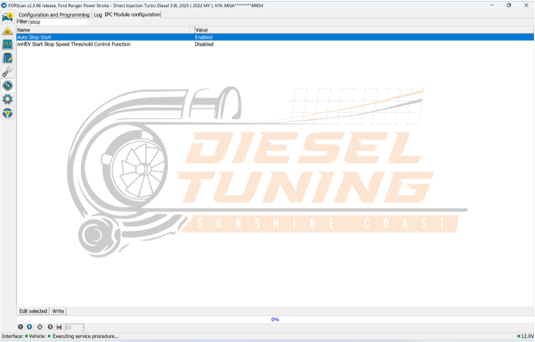

IPC (Instrument Cluster)
  1. Open IPC configuration.
  2. Set Auto Start Stop Enable to Disable.
  3. Write the change.
Ford Ranger FORScan NA Ranger 6th Gen (2024+) Crowdsourced Spreadsheet 09-ipc-auto-startstop-disable

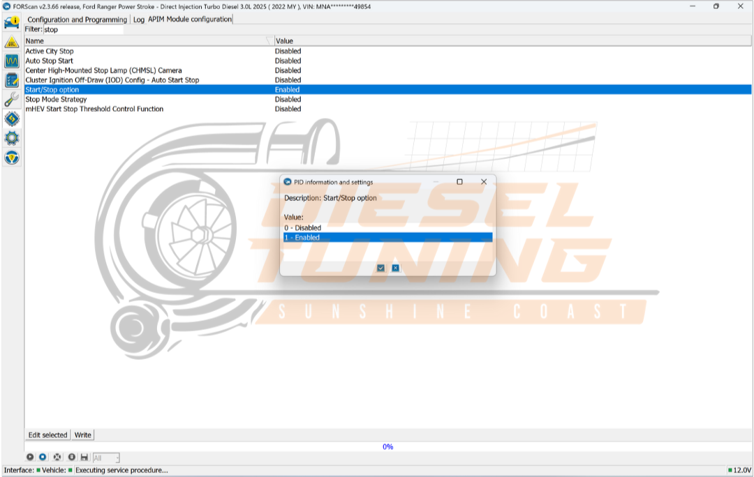

Figure 9: Disable Start/Stop prompts/indicator in the instrument cluster (IPC).APIM (Infotainment / SYNC)
  1. Open APIM configuration.
  2. Set Start Stop Option Enable to Disable.
Ford Ranger FORScan NA Ranger 6th Gen (2024+) Crowdsourced Spreadsheet 10-apim-startstop-option-disable
Figure 10: Remove the Start/Stop option from infotainment (APIM), if present.

For EU RR, just change BMS configuration to PWM and no ASS anymore.
Anyway, I got RA Ranger ASS eliminator and it works perfecly without affecting BMS config.

confirmed the stop-start has been disabled using the instructions I posted on my 2026 stx FX4 ford ranger with the 2.3L turbo.
I did get a error on step 4 for the HVAC controls, but still is disabled.

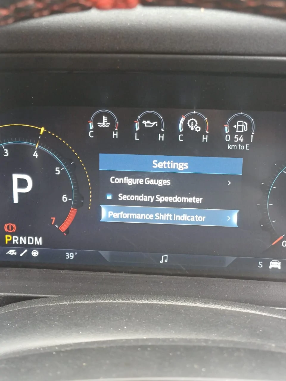

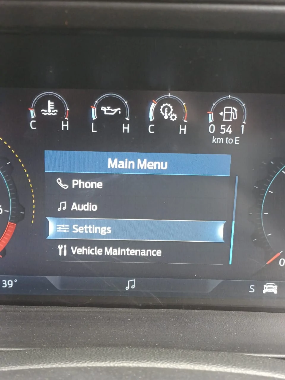

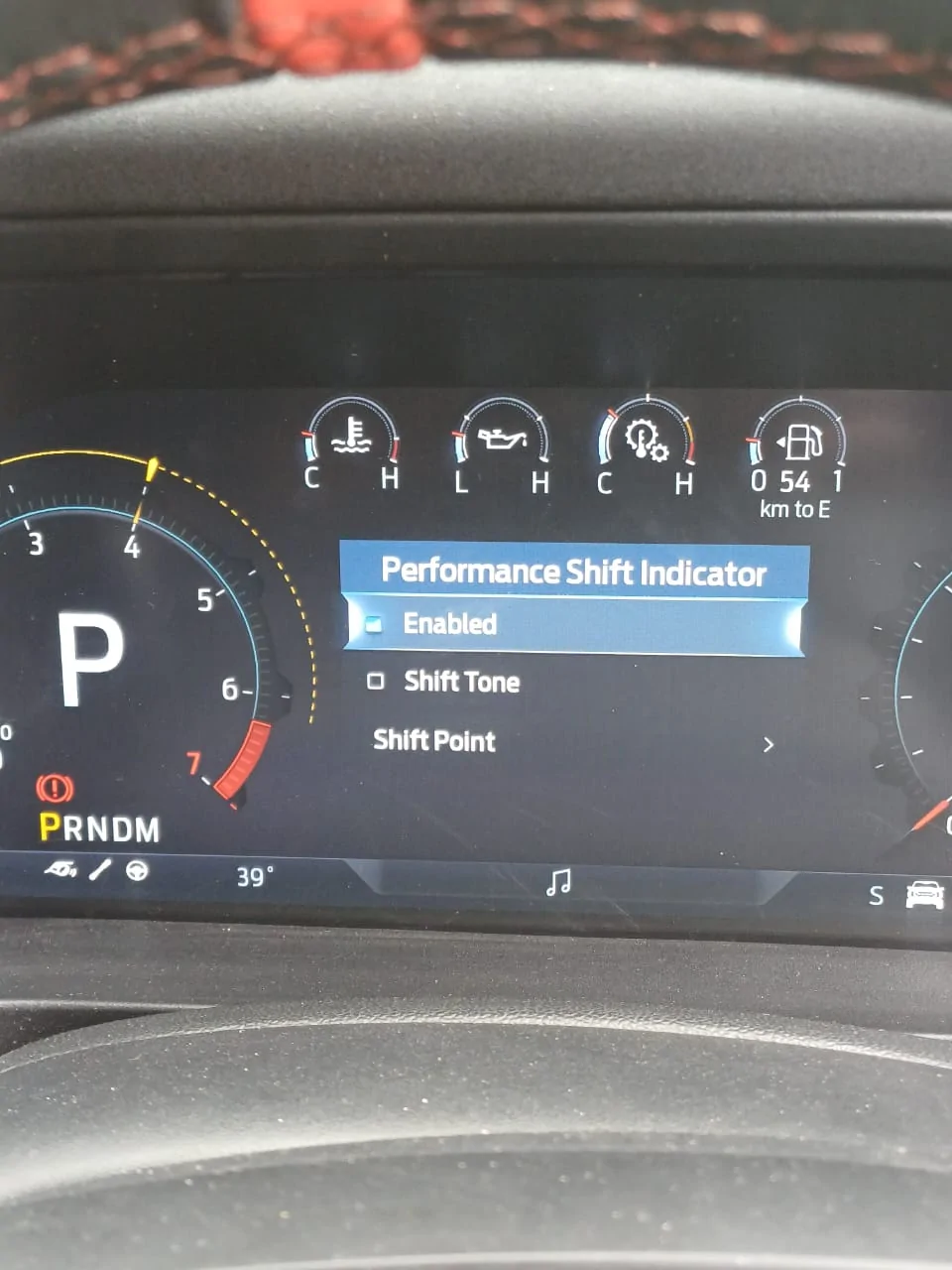

Apologies I just realised that you might be refering to seeing the gear number as oppose to just D right? Only way I've found is to press the + paddle shift to view temporarily
I thought you were referring to the performance shift indicator below
Step 1:
Ford Ranger FORScan NA Ranger 6th Gen (2024+) Crowdsourced Spreadsheet 1785264533752-xq
Step 2:
Ford Ranger FORScan NA Ranger 6th Gen (2024+) Crowdsourced Spreadsheet 1785264552455-jt
Step 3:
Ford Ranger FORScan NA Ranger 6th Gen (2024+) Crowdsourced Spreadsheet 1785264605394-z
HyperM3
Alex
Jan 11, 2024
632
572
Lawrenceville, NJ
Step 1:
Step 2:
Step 3:
Exactly. There's no way to stay in D and get the gear indicator in the dash like in S mode.
