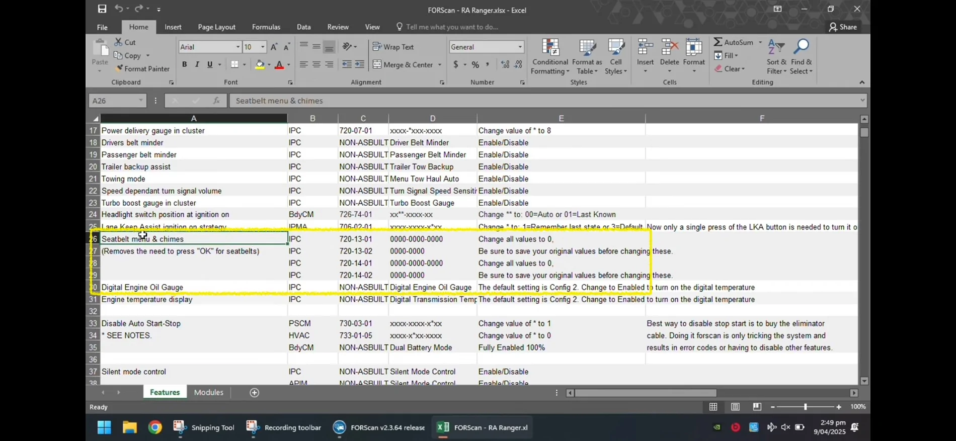

Forscan is a great tool that we as Ford owners are lucky to have access too! So far I’ve done….removed door chimes, removed “full view not available” in trailer camera view, added actually temp numbers to all fluid gauges, added temperature number to tire air pressure screen, removed check seat belt screen at start up added glare free headlight setting (that one is so cool!) and probably a few more!
If you get Forscan spend the $15 bucks for it! It helps with all the work they do on it.

I am confused. This is not our spreadsheet? And only as build? All of them?

No it’s not. It’s from RR owner on YouTube. And it works. Along with adding temperature to tires along with pressure and I added temperatures to all the gauges. So now the tires say 39psi 98 degrees. And for example oil temp shows the gauge and below it says 185 degrees.
