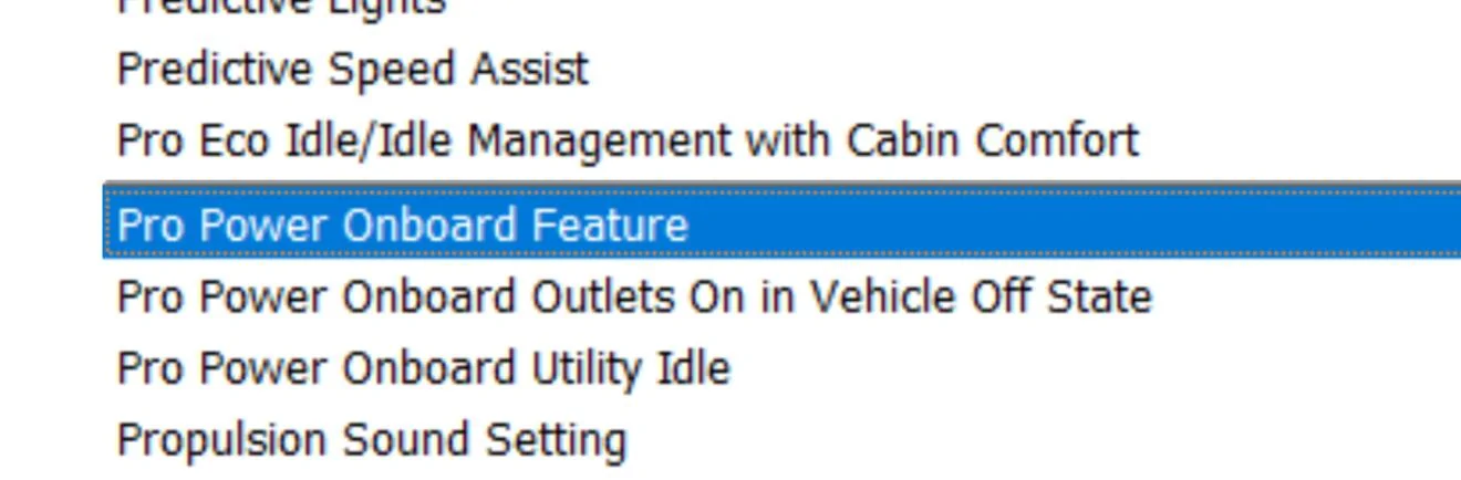

Other question: Does anyone know how I can set it so that the outlets in the bed have power even without the ignition on?
In the BdyCM, I can set the shutdown duration. I set it to 10 minutes for now.
Then there’s also something in the APIM called “Pro Power Outlet”… but I’m not exactly sure what that is.

I just followed the spreadhseet on how to turn thise numbers on

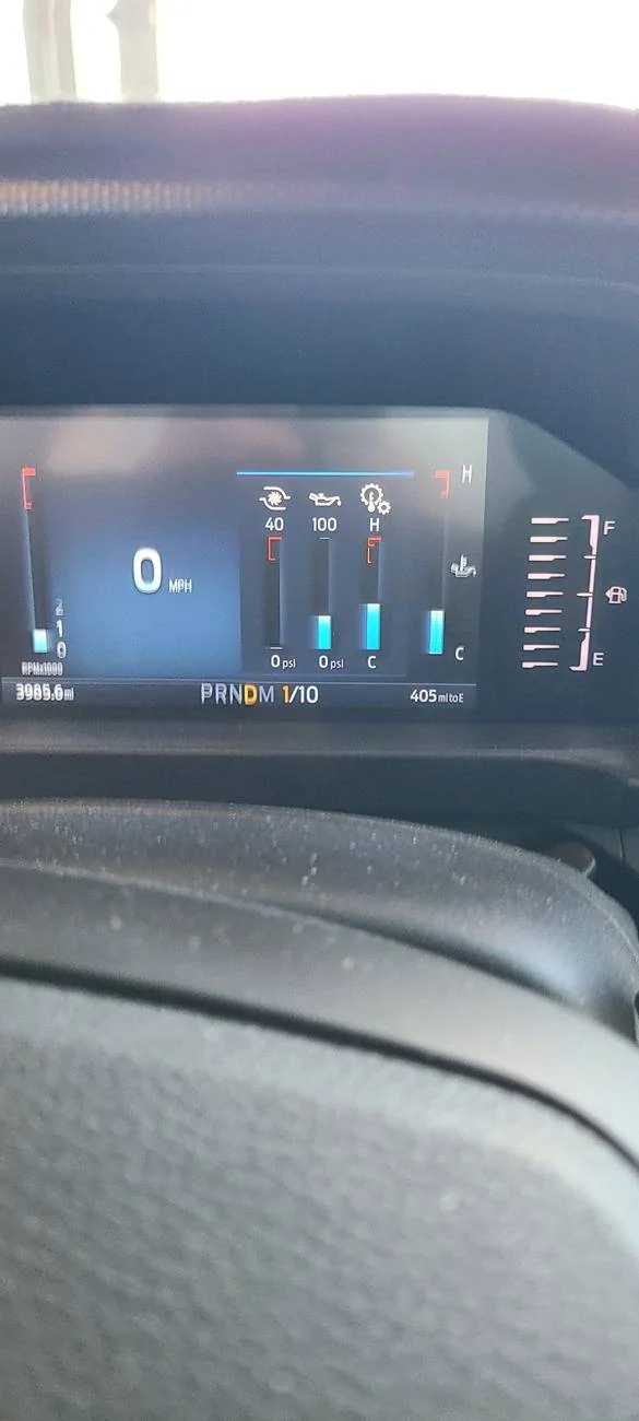

Which part exactly? What is the name of the 3 gauges?
These are the off-road guages.
The trans temp and and boost pressure will work but the oil pressure will only work with petrol variants. I've tried every combination for my diesel but cannot get the oil pressure gauge to work.
