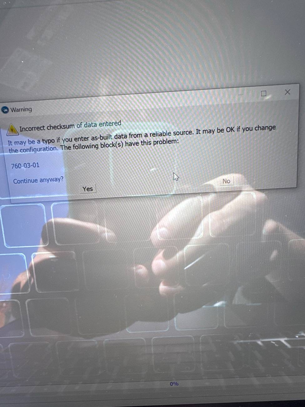

What is your original as-built for ABS
760-03-01?
760-03-01?
yes the block is 760-03-01 that I was trying to change and then the numbers after were something along the lines of 6B85-5B
TTA required reading the G-sheet section of the spreadsheet and changing the
760-03-01 xxxx XXxx to suit. I can help of you give me your exact original block code.
That would be awesome, currently have it in the shop for a axel issue once I get it out I’ll send a pic!

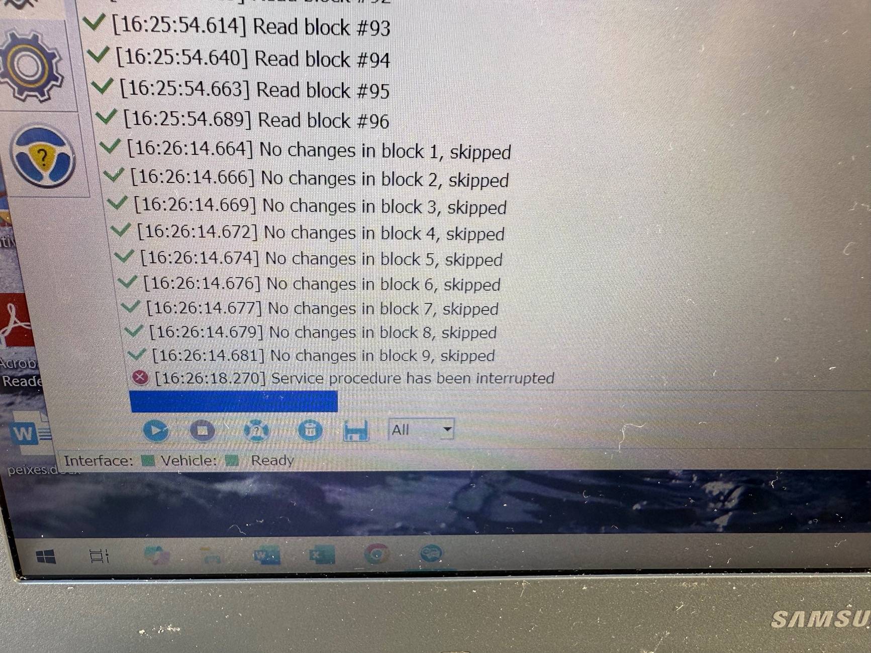

I'm having trouble writing on BdyCM Module in my friend's car. I have done it many times in my own car, but on his specific vehicle every time I try to write the changes on that module I get the "Service procedure has been interrupted" message.
Any ideas?
Any ideas?
What year is the Ranger you are trying to program? Are you running the latest version of FORScan? FORScan support told me that when upgrading you should delete your vehicle profile and rescan with the new version.
