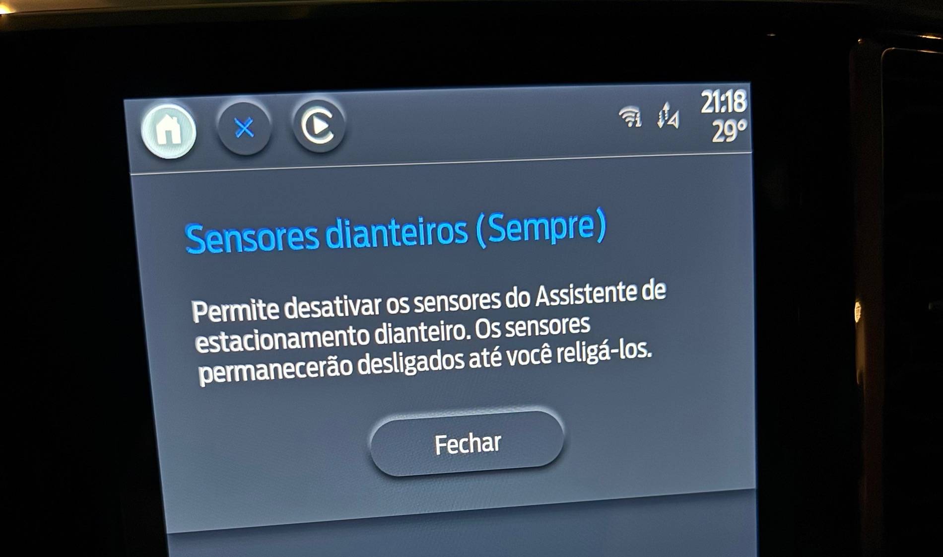

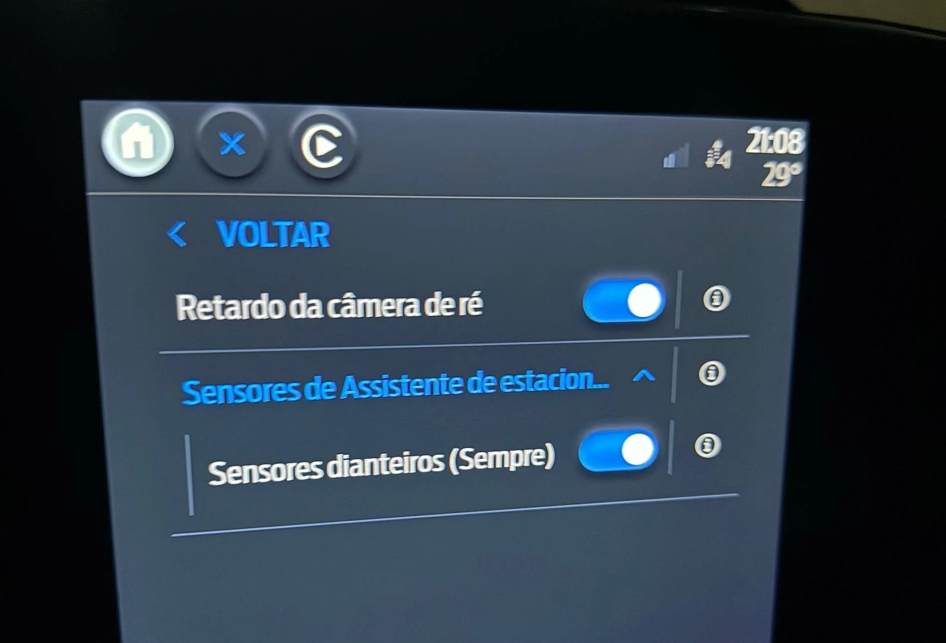

By messing around with the car settings on my central screen just found that the changes I've made in the other modules had some effect. Found that inside driver assistance it now shows the option to always activate the front parking sensors.
Ford Ranger FORScan NA Ranger 6th Gen (2024+) Crowdsourced Spreadsheet 1746193324948-93
"Front parking sensors (Always)"
Ford Ranger FORScan NA Ranger 6th Gen (2024+) Crowdsourced Spreadsheet 1746193337631-s8
"Allows you to disable the Front Parking Assist sensors. The sensors will remain off until you turn them back on."
Still trying to find a way to activate them without having the IPMA module.
