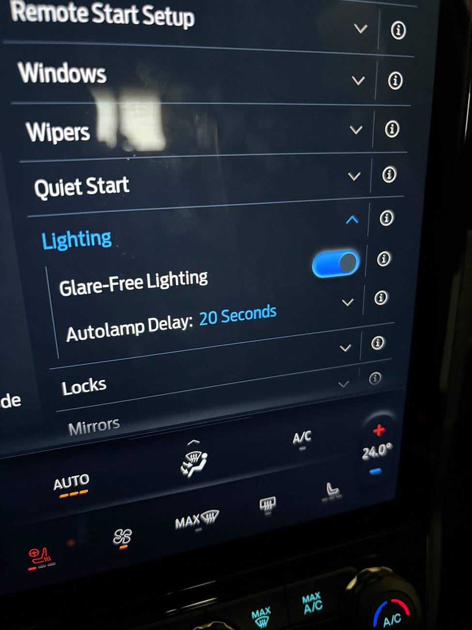

Is this still the correct procedure for fully turning on adaptive headlights? Any tips for how to use them, as in, do you need to have auto highbeams on, etc? Thanks.

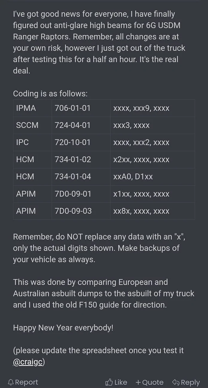

Finally coded this on Sunday and tested it on the way home from work last night. Worked amazing. It was so cool watching the lights turn on and off on the sides when cars were coming. Thanks again for posting this!

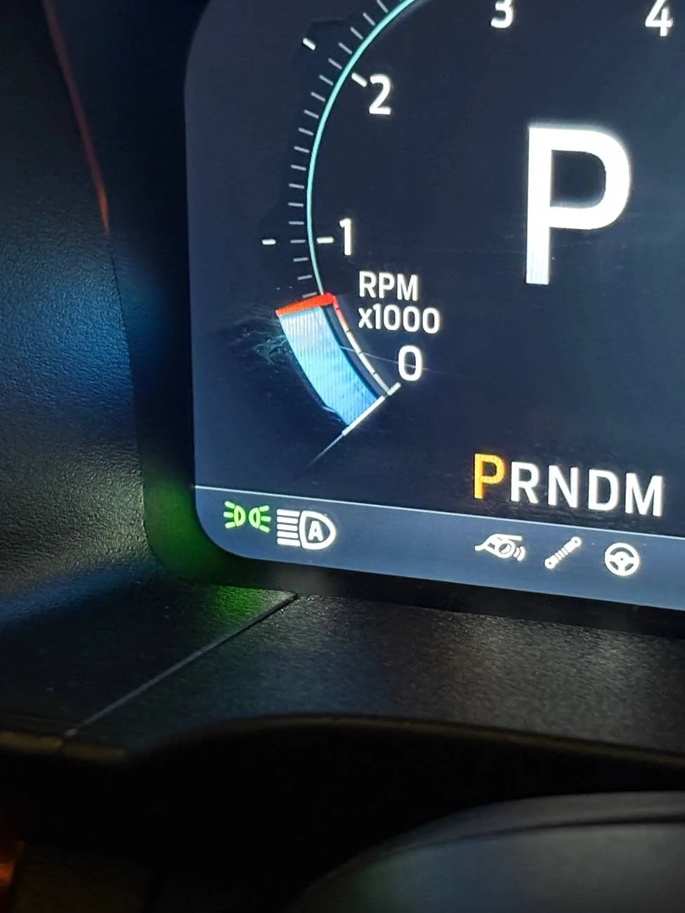

Followed this. Not sure if it’s working because it’s daytime. I had this on my bronco and i thought the “A” was green or blue (mines white)? That’s all I’m questioning now.
The white "A" is normal (that's how it is on my Raptor with the stock function).
The blue light will also light up next to it automatically.

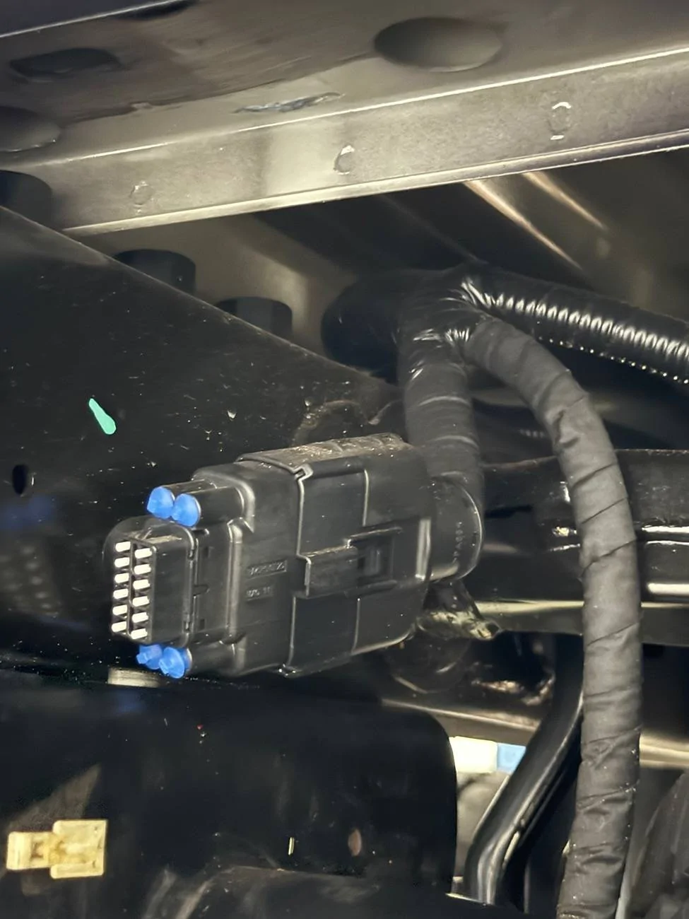

Last friday I installed a trailer hitch in my car and found out that even though it didn't come from factory, it has the electrical plug hidden there in the rear.

Now I just need to buy the wiring harness and connect it.
Why I'm telling you guys all this? Because this got me wondering if that would be the case for the front parking sensors as well, as my car doesn't have them. Maybe I just need to buy the wiring and the sensors and install everything.

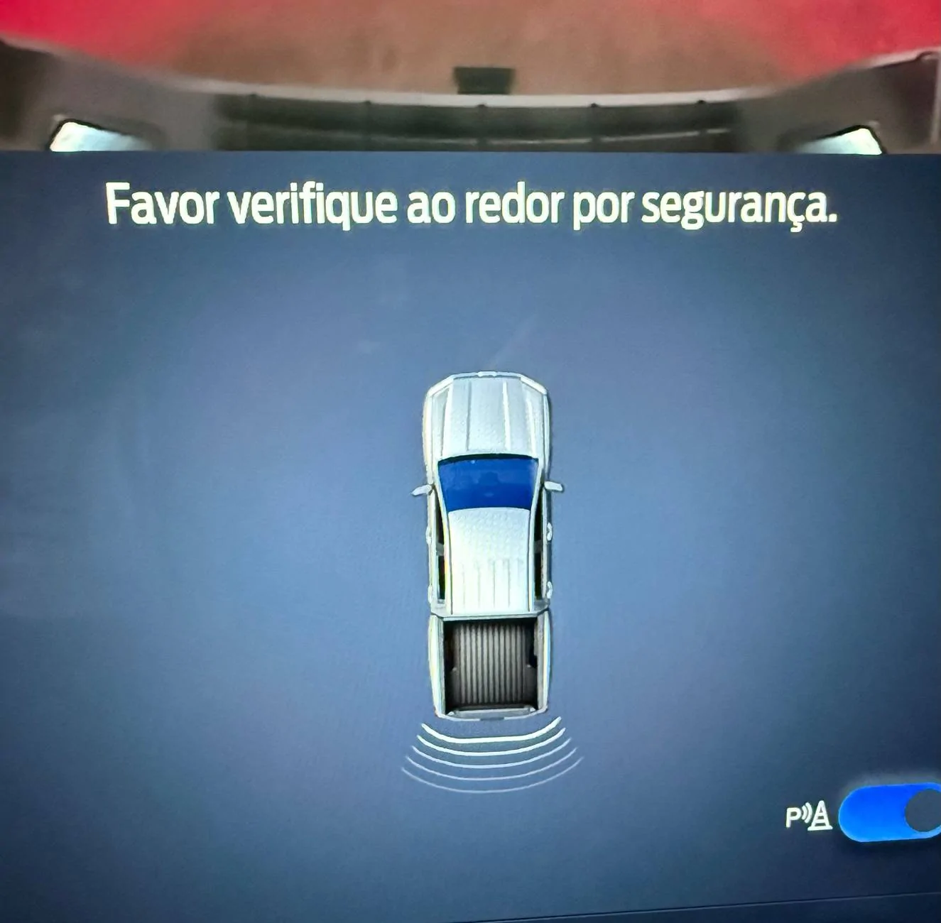

I already got the sensors and the wiring harness part numbers. But before buying it, I got into forscan to check if it would be possible to enable them. As it turns out, I found some things related to this in PCM, IPC and APIM modules. Enabled everything hoping I would get some kind of error message on my cluster telling me I had a problem with my front parking sensors. Got nothing. Put my car in reverse gear so maybe I would see the little waves that move and change color to indicate proximity in the rear factory system and also got nothing.

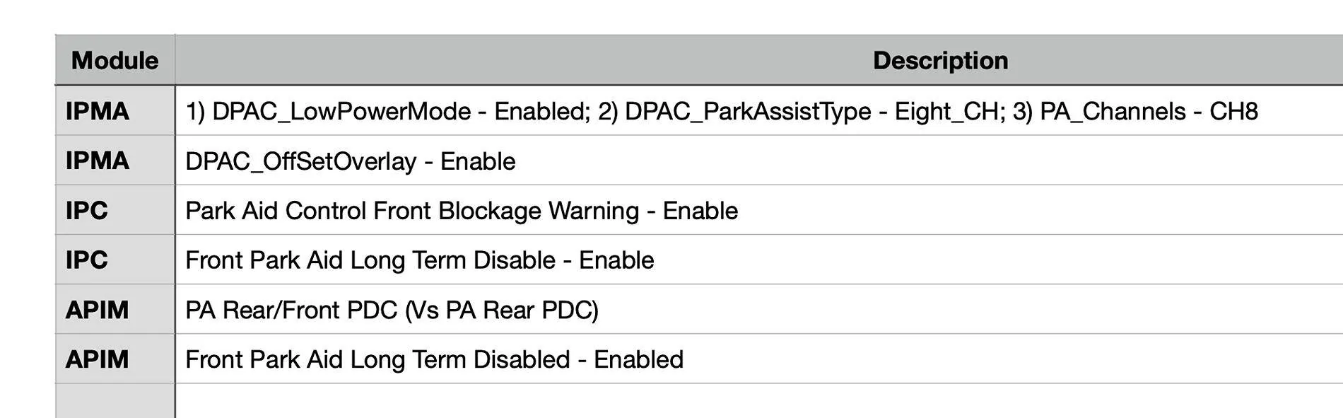

So I went googling on how to do it in other Ford vehicles and found some information on a F150 Forum and giving some instructions on how to do it. Thought that would solve my problem. I was able to do it all except the IPMA module ones, to change from 4CH parking sensors to 8CH. I can't find the IPMA module in my car. I'm not sure if it's something related to a software issue (forscan not recognizing this module) or a hardware issue (my car not having this module at all).
