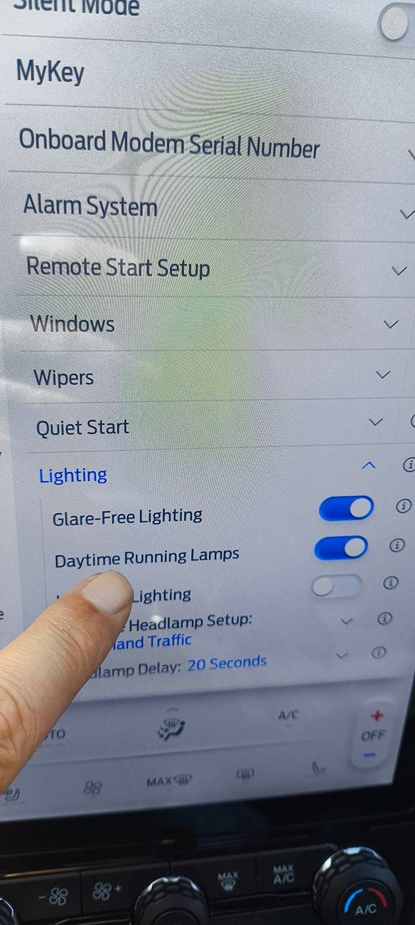

Hi All, I have a couple of questions I hope someone might be able to help me with! First of all I attempted to enable the DRL Control in the APIM which did work to the point the menu appeared in the infotainment screen, the strange part is it didn't do anything at all and the DRL's went from being constantly on to completely off regardless of light switch position or toggle switch in the menu. Due to this I disabled the DRL Control function and the DRL's started working again but only when the light switch is in 'Auto'. if I turn it to 'O' they go off now?! I actually don't mind this but I'm confused what made this happen as they were permanently defaulted to 'ON' previously....... any ideas? I also enable the 'Auto Lock Control in the APIM as suggested in one of the feeds and the option appears in the infotainment menu options but its greyed out and does nothing.... Any ideas on this also? Appreciate any help offered!

As far as i know, you have always been able to turn off DRL by simply turning the swich to off, as it was in my 5g and 6g ranger. The autolock control, and a host of othet options are only accessible with trans in park and parking brake on

On my European Raptor the daytime running lights could not be turned off, in any position of the switch (even on 0) : it is a European standard/obligation that the DRL cannot be turned off.
With forscan I activated the "control of the daytime running lights" in the APIM. A new one appeared and now :
- when it is on OFF the DRL do not turn on in any position
- when it is on ON they turn on but I can turn them off by putting the switch on 0, which was impossible before.
