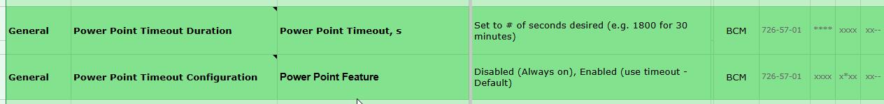

Can someone quickly remind me how to set it so that both the bed outlet and the interior outlets keep supplying power for about 10 minutes after shutting off the engine?
See Row 33 on the Features-Confirmed tab of the spreadsheet. It's called "Power Point" in Forscan in the BCM Module.
Ford Ranger FORScan NA Ranger 6th Gen (2024+) Crowdsourced Spreadsheet 1748533972701-k
