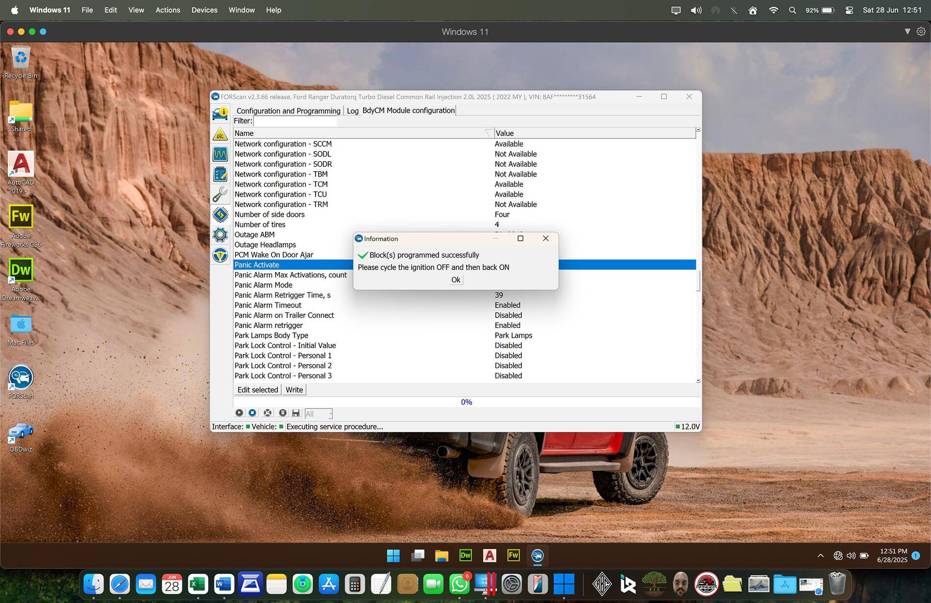

Guys, after a long time trying I was finally able to make the OBDLink MX+ work on my MacBook M2 running Windows 10 via Parallels.
The trick is simple: you can’t use Mac’s bluetooth. I bought a cheap plug&play usb bluetooth adapter, connected it to my Parallels Windows machine and it worked like a charm!
